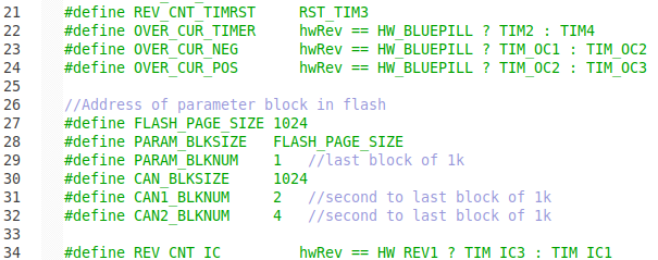

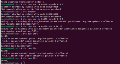

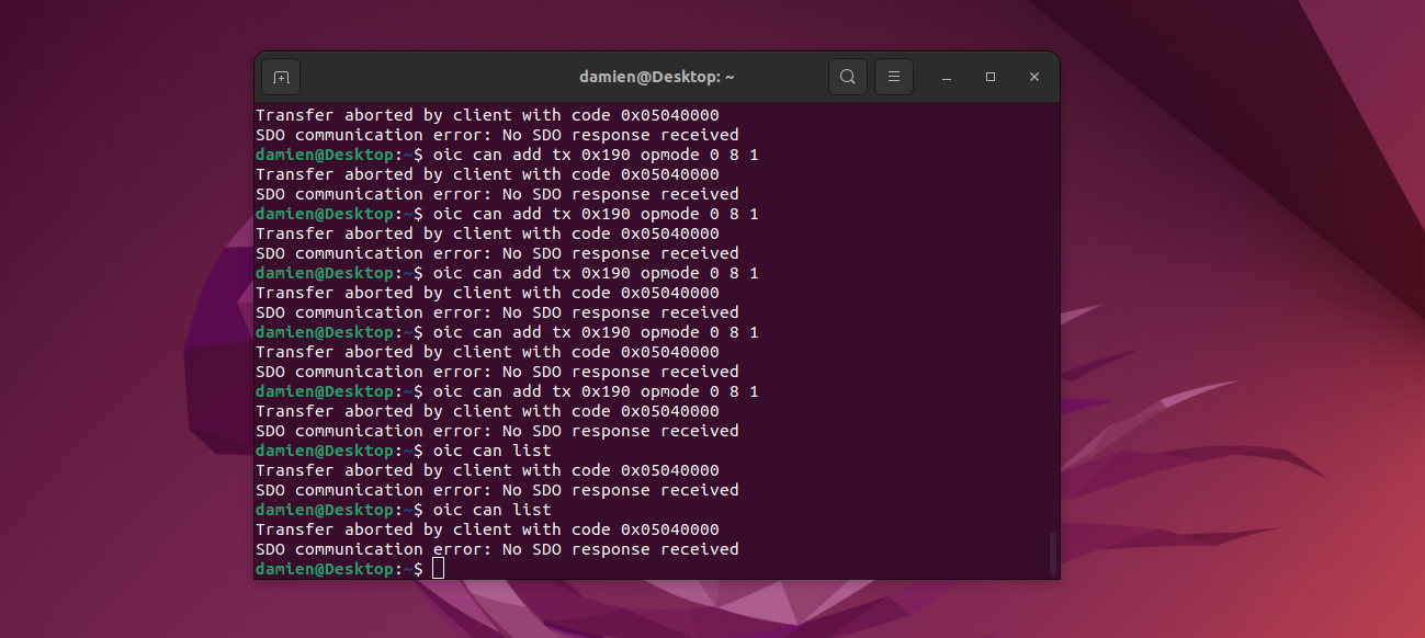

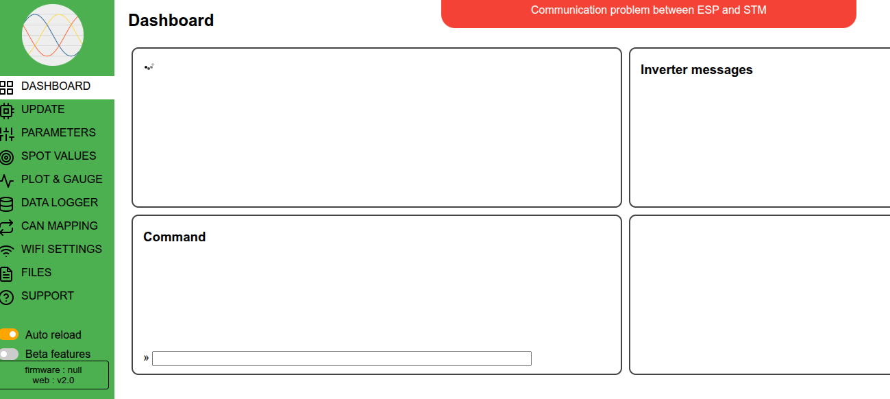

Just CAN1. Sadly no luck so far even on latest libopeninv. Same on the webinterface. I can map fine now and data is sent correctly but on power cycle all mapping is lost.
- Been thanked: 1913 times
CAN1_BLKNUM back at 2 and FLASH_PAGE_SIZE back at 1024?
- Posts: 4000
- Been thanked: 1115 times
Yep as far as I can tell am back to "standard".

So I am very very frustrated right now tbh. Five years of struggle is now coming down to this. I'm gonna walk away before I say or do something stupid. The core OI FOC runs that tesla motor so friggin sweet it sounds oem.....

1. Start openocd so that is connects to target
2. In Makefile CPPFLAGS change -Os to -Og and rebuild
3. Start debugging in CodeBlocks with F8
4. Set break point in parm_save() and check whether flash_erase_page() is called (it shouldn't)
Also check which address the parameters are saved to (return value of GetFlashAddress()
Likewise in canmap.cpp
You can dump said address by telnetting into openocd
and then dumping
Of course you need to use the address obtained when debugging canmap.cpp minus 0x08000000

I've been making progress of sorts with the CAN mapping issue (thanks for the STM32 board loan Damien).
The good news is that the M3_DU_experimental branch has working CAN mapping and param/map saving. This works via the ESP8266 serial web interface or openinverter_can_tool.
The bad news is I have not been able to replicate the failures as described above with any branch of the MG_DU or M3_DU code. The only fix the M3_DU_experimental branch required was to the LIN initialisation.
My M3_DU_experimental branch has binaries available which can be upgraded via CAN or serial. I have tested these thoroughly with opmode in "Off".

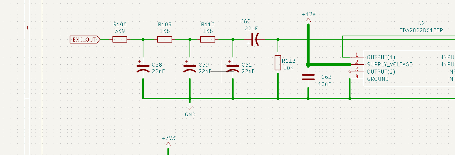

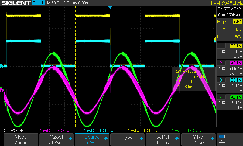

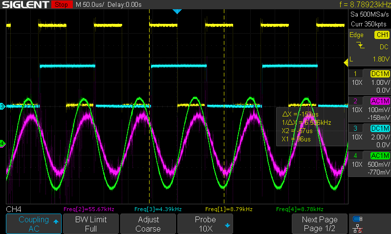

So, I've run into a bit of a problem. Got my test inverter rigged so it's happy to actually start generating PWM and hooked up a Tesla resolver. The stock code works fine but as soon as I apply the hack changes to get a 8.8kHz encoder running things start to go a bit weird. CAN SDO in particular stops. Looking at the changes more closely and the reason is obvious...they speed up the interrupt frequency from 4.4kHz to 8.8kHz. This works but leaves insufficient time for the rest of the system to function and things start breaking.
I think that the fix is going to be to refactor the encoder to use TIM6 or TIM7TIM5 to generate the exciter rather than GPIO toggling in the main control interrupt handler. I can't remember all of the ins and outs of how the encoder works so some investigation will be required. It may have HW implications so I wouldn't rush to produce a Rev3 board.

Thanks Dave. A, about a month away from a V3 board order anyway so no panic. That does help explain some of the weird behaviour.
Edit : The other option here is to stay with 4.4KHz resolver and dial back the exciter amplitude until it stops clipping?

It even ups the IRQ frequency from 8.8 to 17.6 kHz, each PWM period consists of an upcounting and a downcounting part to achieve symmetrical PWM. With a repetition counter of 0 you get an interrupt for both parts.
There's a good bit of hardware logic involved in how things work now, not sure if there'd be enough resources left to optimize it. Basically TIM3_CH4 is used to trigger the ADC conversion at a certain time after the exciter edge. Perhaps something could be achieved by generating the exciter edge with another channel of TIM3. Never looked into it as it just worked fine at 4.4 kHz

My thought was to get a timer (TIM5 I think) to generate the exciter square wave at 8.8kHz. This would be aligned with the current PWM interrupt generating the required output with no software input. I think the frequency and alignment means that it would have to be a separate timer rather than a spare channel on an existing timer. The encoder ADC capture would then function as it currently does but on every other cycle. The resolverSampleDelay might need some re-measuring and tweaking to work in this mode but it shouldn't need much.
This is similar to the way I have the TMS320F28377D set up in my C2000 inverter code. Unfortunately I've not really thought about STM32 timers for a couple of years and all the detailed knowledge seems to have leaked out of my brain. Need a bit of time to re-learn how things work and try some experiments.
I did have a cheeky thought about asking if we could use a PLL to frequency double the exciter output to achieve the same result with HW only.

Some good progress I think. I've managed to hook up TIM8 to output a 8.8kHz square wave on PC6. This is synchronised to the main PWM TIM1 which leaves the existing resolver sampling intact.
To set the scene this is what the stock stm32-sine firmware looks like: The yellow trace is R106 at the input to the exciter amp. The cyan trace is PD2/EXC_OUT (this is the same signal). The green trace is the exciter winding on the resolver. The purple trace is the cosine phase on the resolver.
You can see the time difference between the rising edge of the exciter PWM and the peak of the exciter output is 153 uSec (dotted yellow line cursor).
Looking at the modified firmware: The yellow trace is PC6 attached to TIM8_CH1. The cyan trace is PD2/EXC_OUT. The green trace is the exciter winding on the resolver. The purple trace is the cosine phase on the resolver.
You can see the exciter is running at 8.8kHz (yellow/green/purple) but the main loop (cyan) is running at 4.4kHz. You'll have to trust me but the PWM is running at 8.8kHz in both cases.
The amplitude of the exciter and resolver phases is substantially lower at 8.8kHz (the Y scale is different between the two traces). I think this is what we desire.
The resolver sample point is in a trough of the exciter rather than the peak (see cursor). This will mess up the syncofs but other than that should still deliver reliable angles I think. I don't understand why a higher frequency results in an exciter output 180 degrees out of phase.
Thus far I've just used an uncalibrated steel nut as my resolver rotor. I think the next step is to get the resolver mounted in my motor and try to get a plot of the "angle" as I rotate the motor. Thoughts?

The filter to make a sine wave out of a square wave has a phase delay.
At 4400 hz the phase delay is -164.5° so that's (1/4400)/360*164.5 = 103.85us
At 8800 hz the phase delay is -206.3° so that's (1/8800)/360*206.3 = 65.11us
this is from the center of the squarewave, but on your scope the measurement is form the leading edge. To compensate we need to add a 1/4 wavelength.
At 4400 hz this is 56.8 us + 103.85us = 160.65us
At 8800 hz this is 28.4 us + 65.11us = 93.51us
so the sample point at 8800 hz should be 93.5 us after the rising edge.
with changed filter this will be: 28.4 + 55 = 83.4 us
This data is from simulation so assuming ideal components.
