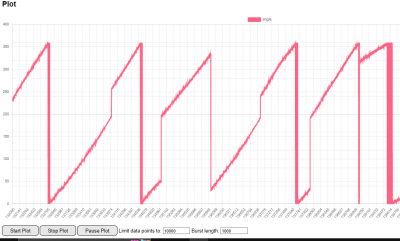

To go back to last known good, i loaded V4.90 sine software. MG2 turns great on 0.5 amp @ 90v
With my resolvers wired up I get this graph which to me looks close enough to Bigpies known good graph above, especially given motor is hand cranked to generate this.
When hand cranking the motor, it sometimes 'grips' and i get a resolver graph, othertimes it seems to 'let go' and i'm turning nothing. I wonder if sometimes the gearset turns one side instead of the other, its like a 3 way split inside if i understand correctly.
