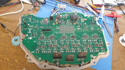

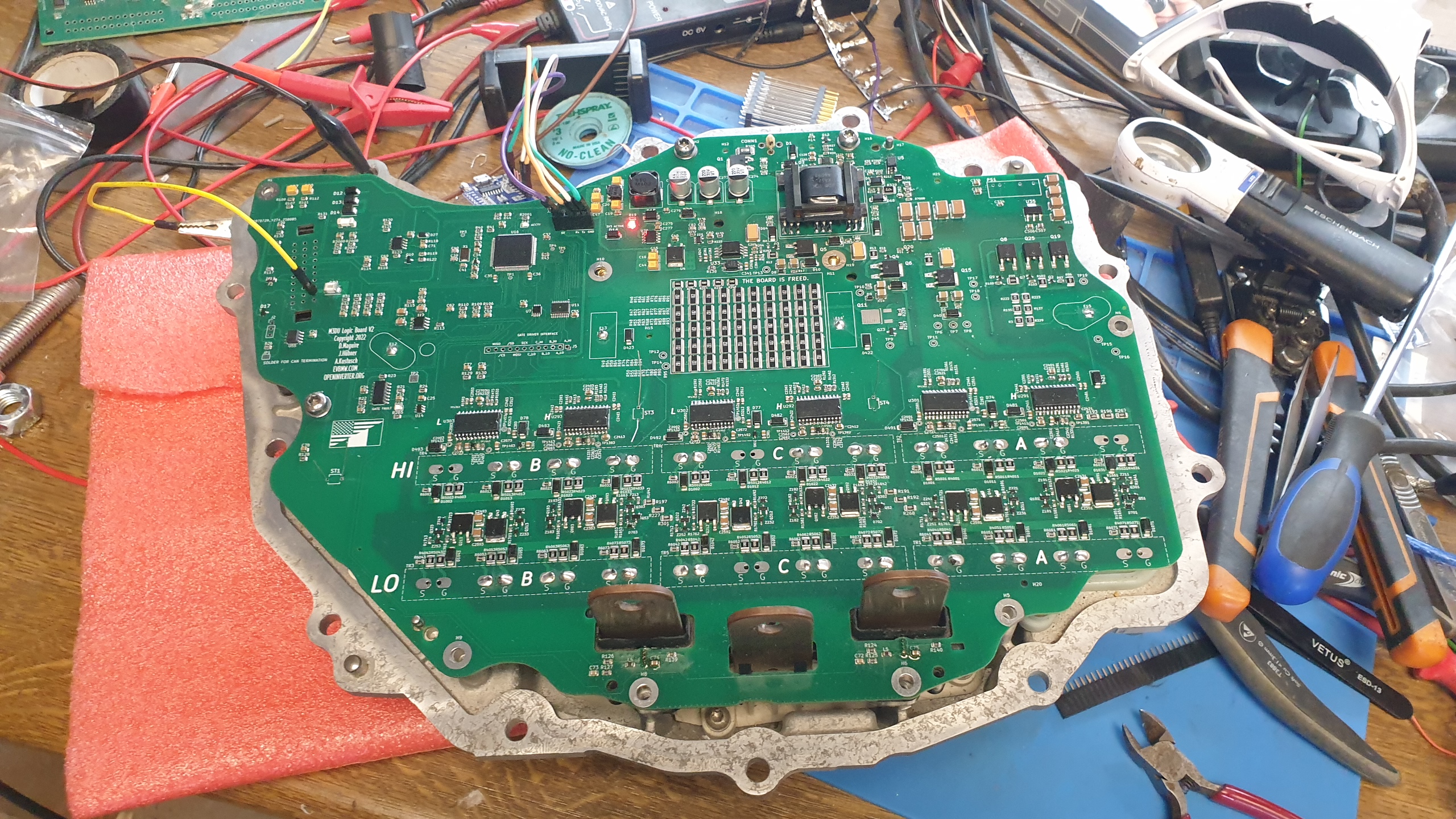

All gate drivers powered up, reset and waiting for spi configuration to be loaded.
- Posts: 288
- Has thanked: 69 times
- Been thanked: 88 times
Um. I dont think you need to be worrying about the spi configuration. That's looks to be all in place and working. Those chips are generally very unhappy until properly initialised with a working isolated gate supply. In my experience if the fault light is out the gate driver chips are happy or the power is off.Jack Bauer wrote: ↑Thu May 15, 2025 12:54 pm All gate drivers powered up, reset and waiting for spi configuration to be loaded.
If you're running the MG_DU branch code there's no reason it couldn't have just started working... I didn't check your schematic for any differences compared to the MG board. You might have just got lucky.

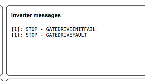

Can you check your error log for any GATEDRIVEFAULT or GATEDRIVEINITFAIL messages. Is it reporting 11 for the "hwrev" param? If so it's correctly identifying the TeslaM3 variant (HWREVS in param_prj.h needs updating to have the correct strings for the MG and TeslaM3).

Sorry Dave I should have said the gate psu is on and I just strobbed SD.

Every day is a school day it seems. Didn't know you could run the gate drivers without any config but the DS confirms this.

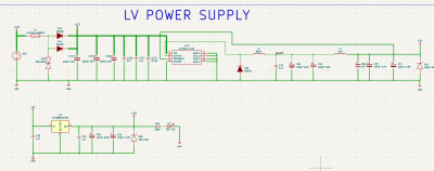

I've checked against your latest schematics and the code in the MG_DU branch stands, nothing has changed with the SPI and SD control that would break it that I can see. I don't see a ready signal on your gate PSU like the Tesla board has so you'll need to put in a delay before starting the gate driver. The current code tries to initialise everything immediately which won't work.

Yeah my initial modboard just ran them in default config as didnt have the spi worked out at that point. Sadly the good luck streak has finally ended. All the drivers fault as soon as pwm is applied. No doubt some error in the HW reverse engineering. I'll get spi coms running to try and narrow it down.

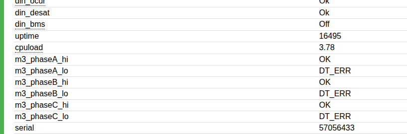

Well, good news is red light stays out and pwm reaches the drivers but they are not happy. Guess I'll have to go in and see whats annoying them. In related news the variant detection is really messed up and needs to be forced to M3 but thats a small matter.

Bother. That's quite a complete failure. You'll need to trace through the initialisation code to figure out which bit it is getting upset by. An SPI capture might be necessary to verify that data is going into and then out of the SPI chain. It should look like the captures you took way back on the Tesla board.

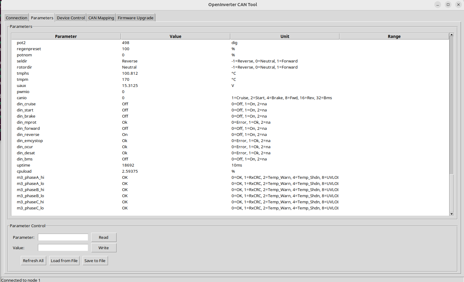

Also notable that reading out the registers after writing results in 0xAA for all of them. Perhaps it is indeed a timing thing.
One other thing that Damien wants to look into tomorrow is that the "STATUS1" is set to "UVLOH = VH undervoltage flag. It is forced high when VH is below VHoff threshold." and STATUS2 is set to "REGERRR", which can also be triggered by "– Isolated interface communication fails".
One hypothesis is that the VH is not at full level yet when /SD goes low and therefore UVLOH is latched.

No, it is returning 0x08 on STATUS1, 0x04 on STATUS2 and 0xE4 on STATUS3 (but the higher bits are unspecified).davefiddes wrote: ↑Sun May 18, 2025 9:49 am From what I can gather the initialisation is completing successfully and is reading OK status values from each of the STATUS1,2 and 3 registers (it returns 0x000C in all cases). I'm surprised it is posting GATEDRIVEFAULT or GATEDRIVEINITFAIL errors.
0x000C is the CRC of the NOP command that is sent on readout from the STM32.
