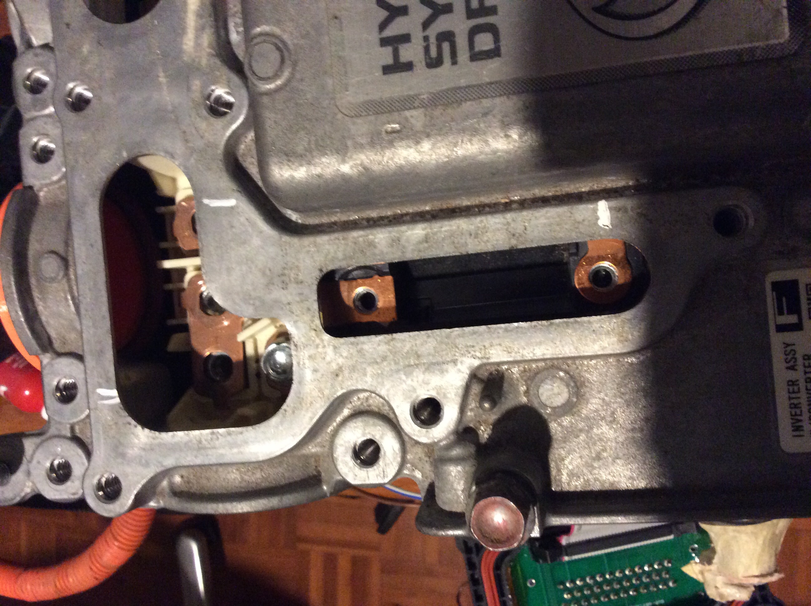

I am a bit suspicious that the inverter could be faulty as all of the HV cover plates had been removed along with what I assume was a fuse in the slot in the image. But Any comments or suggestions would be appreciated.

Hi, it is unlikely the inverter is faulty because it wouldn't have worked with sine firmware also. You need to watch Damiens FOC tuning video very carefuly and enter all the correct parameters. FOC need current sensors to be correctly configured and check if the new firmware still need "pinswap" option to tell the software on which phases the current sensors are (because toyota have current sensors on 'wrong' phases). Then you need to search for the correct resolver configuration with trial and error. And after initial test with the lightbulb when you have confirmed the inverter is not taking all the possible power it can get from the battery (light bulb not going full bright) you need to REMOVE THE LIGHTBULB to get the motor to do anything. Inverter will attempt to draw all the available power if current sensors are wrongly configured or inverter is faulty so with a lightbulb you check for that. After you have checked that then further the lightbulb will be starving motor from the Amps it needs. Sometimes helps if you have thin battery wires when testing. They will be sufficient to spin the motor but will fail if there is something wrong. I once observed my thin automotive wires evaporate in an instant when inverter attempted to pull all the power from the battery - it worked like a fuse.Ctwidle wrote: ↑Sun Oct 23, 2022 9:45 am I’m Slightly ahead of FFman. I managed to get good plots using sine firmware then switched to FOC (currently trying 4.96 after failing to get spinning with 5.20) Yaris inverter with Prius board, 120v and parameters as per Damien’s video. With iD 1 and iD 3 Motor twitches in opposite directions but doesn’t spin, 60w bulb glows slowly but not full brightness. Udc falls to around 5v on refresh with iDC -10.6, iL1 -34.9, iL2 -39.9, iD 0.75, i1 -55.7.

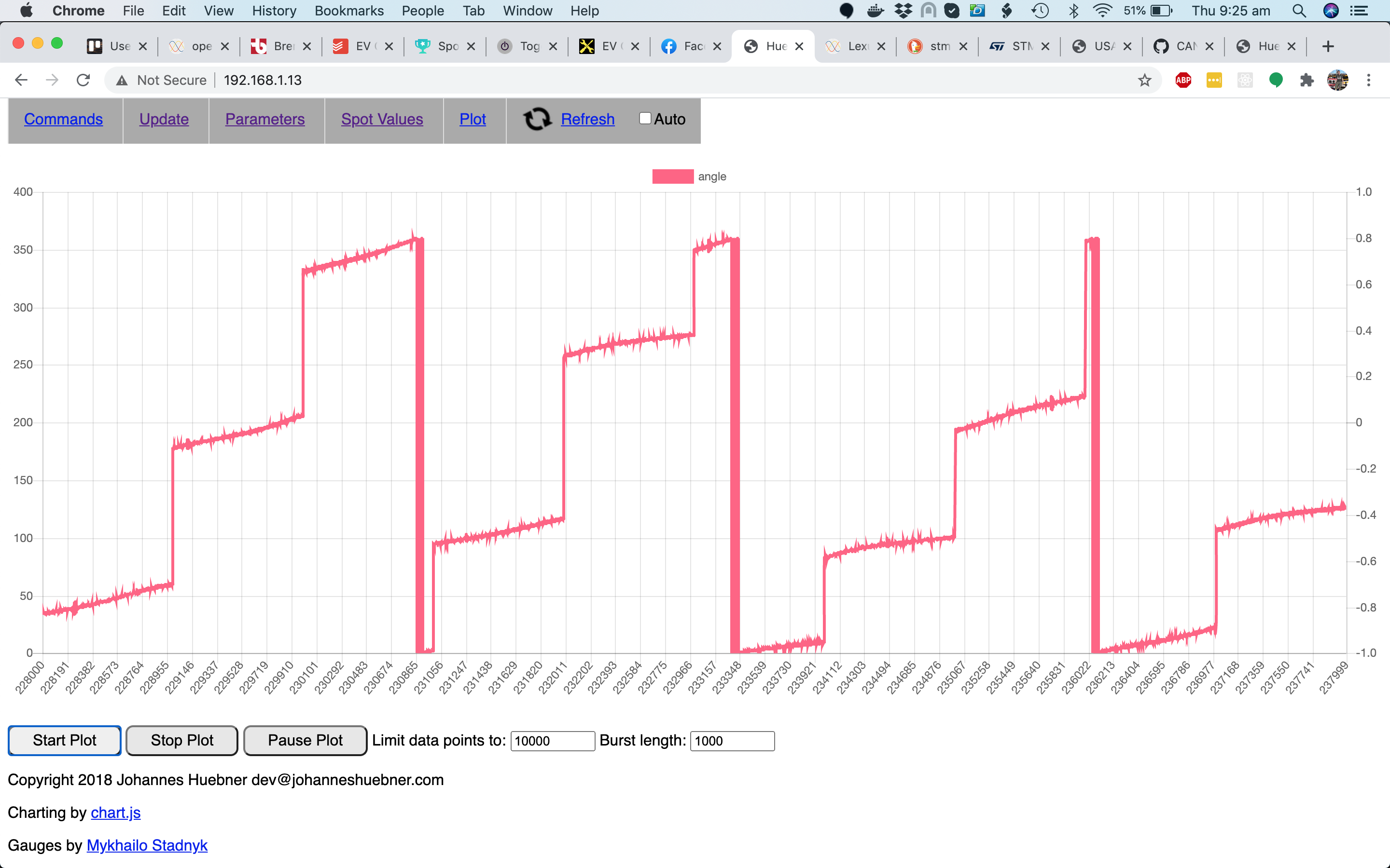

FOC tuning.
So since getting the mg2 spinning in sine mode i loaded the foc f/w and started following the long foc video damien and johannes put together.
I identified the resolver pairs and exciter, and verified exciter output with a speaker. I then tried all 4 combinations of wiring as Damien suggests. However it wasn't clear to me exactly what one is looking for, and what a bad set looks like.
If you look here https://www.dropbox.com/sh/046vu69fom3d ... rGIUa?dl=0 there is a shot of each graph from each combination and the one damien shows in the video (the one with no number). My number 2 looks the most like his, but do the others look wrong and to be excluded or am i not doing this right ?
On the basis i thought no 2 was right i moved on to try and turn the motor, so i set the parameters as per the video (though i note the earlier f/w shown in the vide might have different pin swap setups) inc set pinswap 5 , applied my hv with the bulb in circuit and set manual id to 1, then 2 up to 5 (using 70v). However, all I get is the lamp lights up, the motor does nothing. I'm reluctant to remove the bulb from the circuit until I get the behaviour Damien suggests at about 1hour 3 mins into the video.
What might i be doing wrong here ?

I'd try plotting again, turn the rotor slowly but smoothly if possible. You're looking for a saw tooth shape from 0 to 360 repeating.

OK - V1C board Prius Gen3 inverter and gearbox wired to MG2
Been through all the wiring again and checked the pairs etc (Pair 1 - encoder A & Sin, Pair 2 - encoder B & cos).
I downgraded to 4.90 FOC f/w figuring maybe if the latest version of sine f/w was broken in manual mode then maybe foc is somewhere too, and it seems the videos from Damien and Latuta are on earlier versions. Didn't seem to make any difference.
Results are pretty much the same as before, 4 graphs as shown:-
https://www.dropbox.com/s/yip2iv3dz8ug5 ... 1.PNG?dl=0
https://www.dropbox.com/s/jrvlouy11ek8y ... 2.PNG?dl=0
https://www.dropbox.com/s/u26poqy7751ht ... 3.PNG?dl=0
https://www.dropbox.com/s/68mc4nujufxkz ... 4.PNG?dl=0
Plots 2 & 4 are a mirrors of 1 & 3 in terms of the orientation of the teeth.
Do any/none look right ?

Not all graph is visible isn't clear if it has full 0-360 amplitude. So what is happening? Do you hear a specific sound that the motor is making as you try to spin it? Check if you have your settings right in encoder mode, pole pairs, pinswap. And did you wire resolver inputs correctly. Without correct feedback from current sensors and resolver the motor is not going to budge.

This is mine from when I was getting setup.
You can see it has a plot from 0 climbing up to 360 and dropping back to 0. If you're spinning it too fast or not using enough plot points you'll cut off bits.
sorry - yes each is swinging from 0 to 360, very little jitter at idle.
I have (names from memory):-
encoder - resolver
polepairs 4
respolepairs 2
pinswap pwm23
well that is the queston really - what is correctly. I identified the resolver pairs with the meter, then as stated above paired on the ampseal encoder A with Sin, and encoder B with cos connections. The V1c is slightly different to the version used in Damiens video so it was best guess but seemed to be confirmed by the russian diagram.
So when I turn on the 80v (lithium) HV with 100w bulb inline and step increase the manualid the light stays on and the motor does nothing. I believe the bulb should extinguish after a few seconds. I've upped the manualid to 5. Not tried with the bulb bypassed yet as it does not seem to be recommended at this stage.
appreciate the response.

Because your voltage is low the bulb is absorbing all the amps needed by the motor to spin. That's why it stays lit. I was not able to get my motor to spin with a bulb in line. Use a fuse on your battery side and try removing the bulb.FFMan wrote: ↑Tue Nov 01, 2022 10:53 am So when I turn on the 80v (lithium) HV with 100w bulb inline and step increase the manualid the light stays on and the motor does nothing. I believe the bulb should extinguish after a few seconds. I've upped the manualid to 5. Not tried with the bulb bypassed yet as it does not seem to be recommended at this stage.

Bulb needs to be taken out of series after precharge and you've verified you've got some current control otherwise you motor will either not spin or start to briefly then stop.

ok - so fired it up, precharged it then bypassed the bulb set manualid to 5 and got this
https://www.dropbox.com/s/wq0kdxznjvg91 ... 4.MOV?dl=0
this is using the pairs shown in the second graph.
Given my graphs were a little inconclusive, shall i just try each pair combination in turn to see if motor spins or is there definitely still a bigger issue ?
i've added a dump of my params in case you can spot anything. Deadtime is set to zero, i got the impression this was right for Prius.
