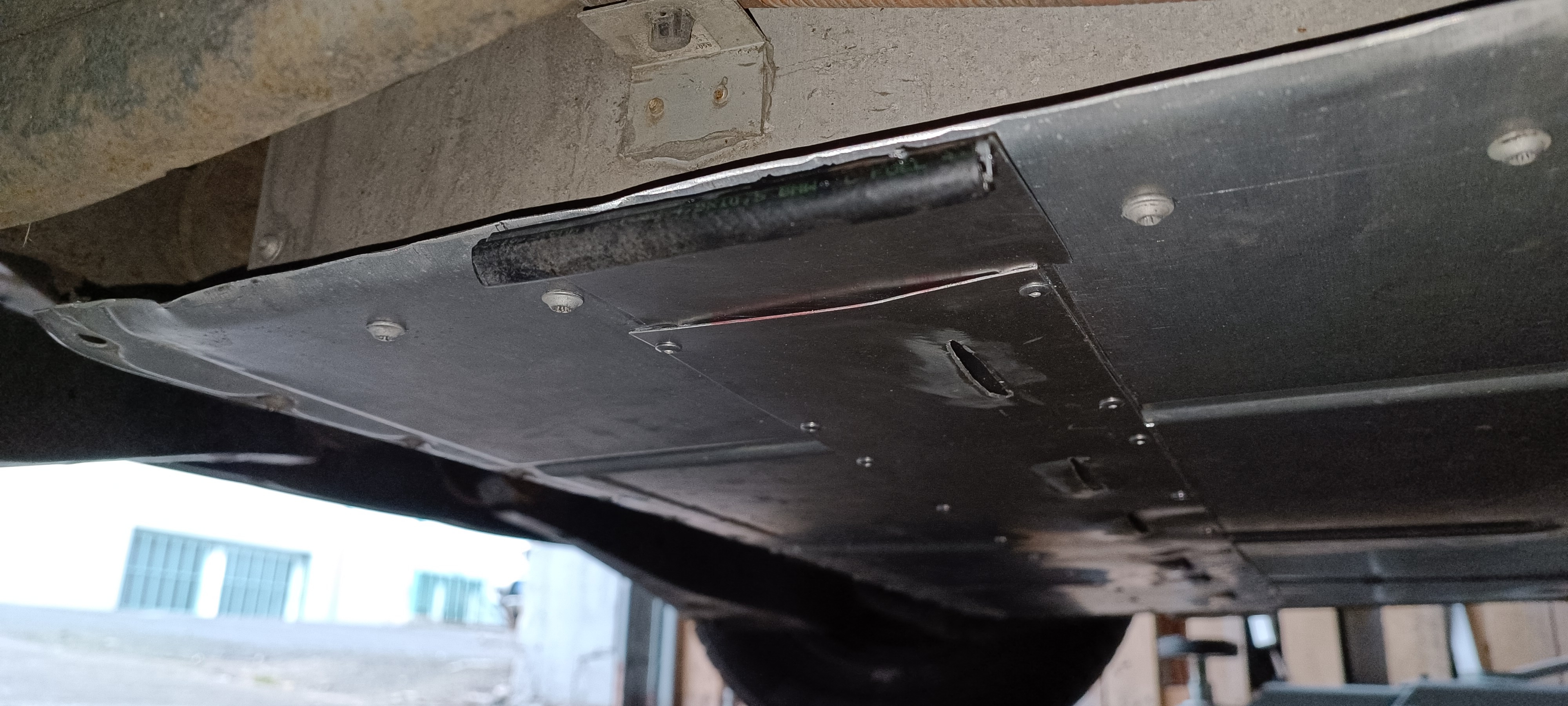

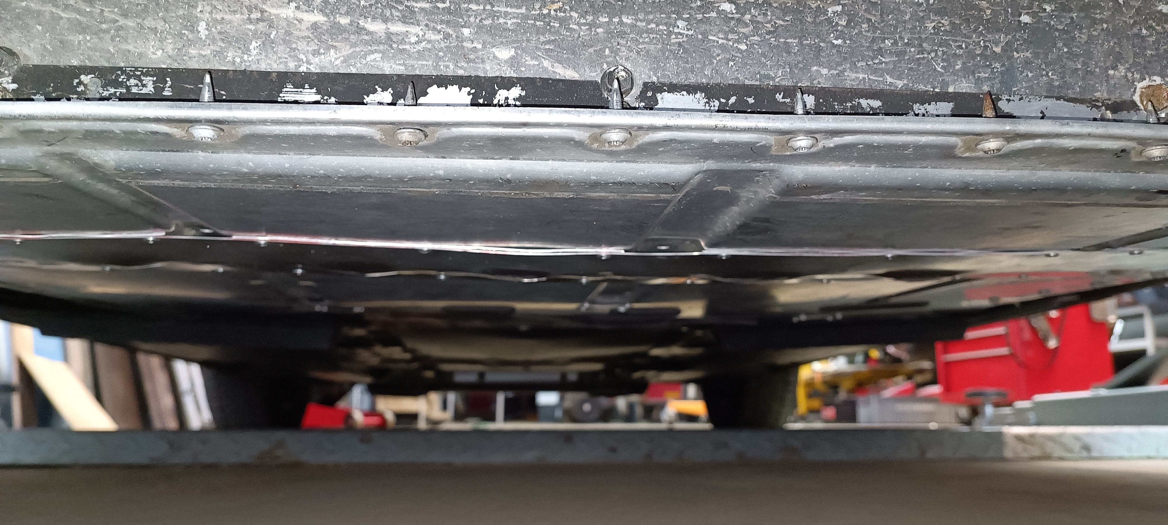

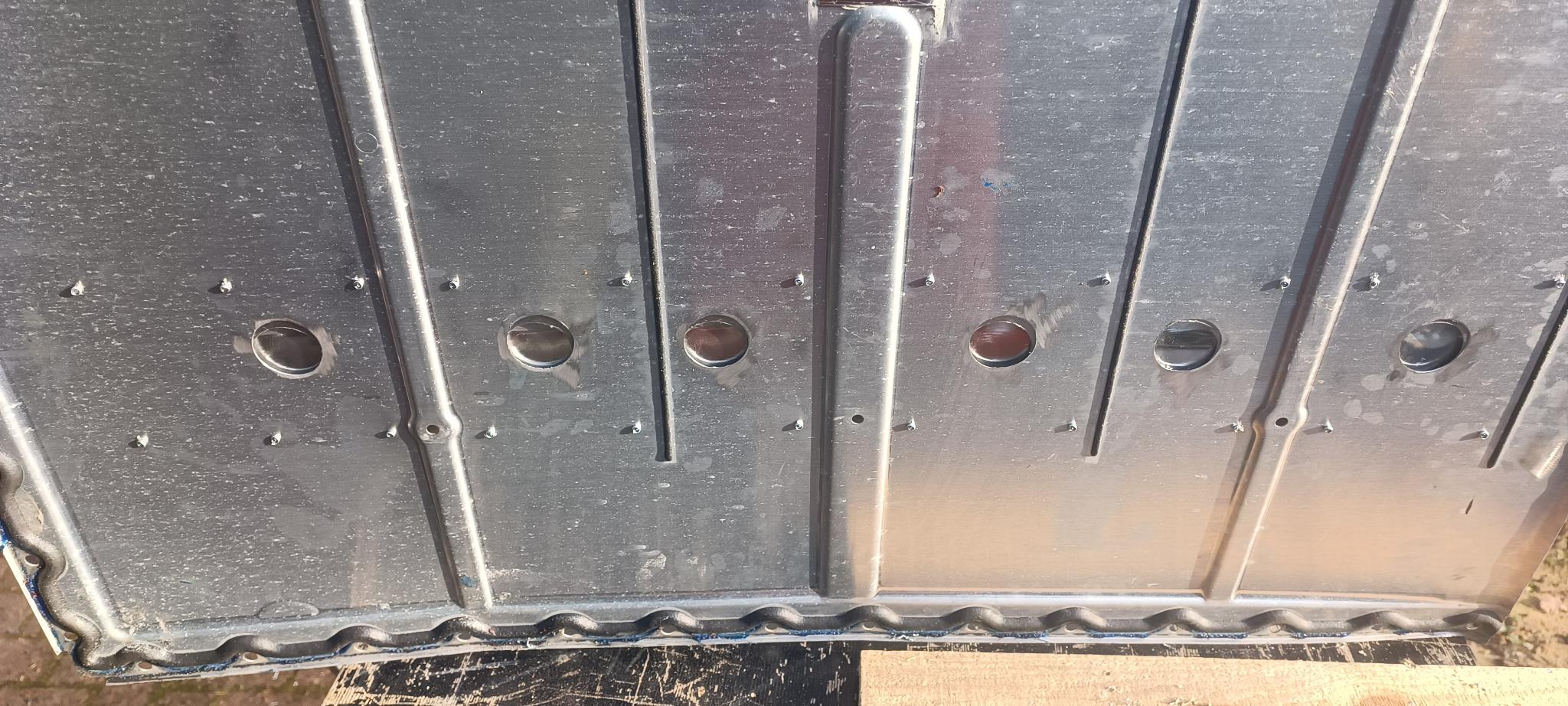

Small update on battery cooling. The fan proved not very effective so now I added air scoops. They can be closed off to prevent debris and water getting in on everyday driving and opened on longer trips with rapid charging. Test is pending.

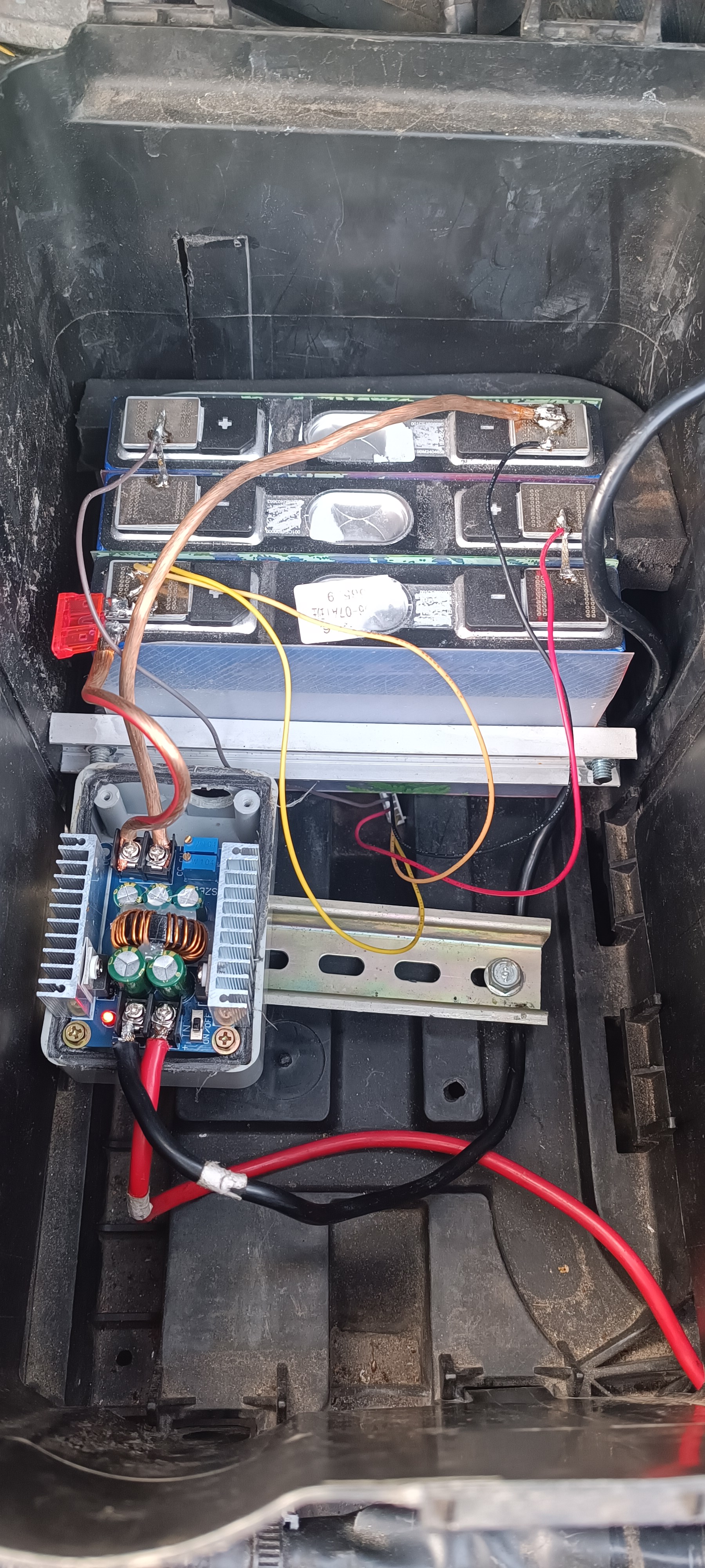

And finally installed this one:
These are 3 NMC 60Ah batteries. So they will sit at 9.5V when empty and at 12V when full.
I got a cheap CC/CV buck converter from ebay, supposedly up to 20A. It is a synchronous design, so not just a diode on the low side but a FET for both high and lowside. It still gets quite warm (70C) even though I set it to just 13A. The high side is always closed when there is no input voltage, meaning you get the full battery voltage out of the "input". So that is boot strapping sorted. I set charge end voltage to 12V or 4V per cell.
It is super small compared to the "80 Ah" lead acid battery and probably has twice the usable capacity. Now I also have space to mount some more terminal blocks on the DIN rail and get rid of my dodgy 12V junction box that just floats around before the battery compartment.
There are downsides of course. It is no longer a low tech solution, so if the buck converter breaks I have no 12V and the car is dead. Also it being an NMC battery it requires a BMS to keep it balanced and to prevent deep discharge.
I could have also gone for 4 NMC cells but was hesitant to run the cars systems at 16V. Also the Outlander DC-DC only outputs constant 14.3V. And if you wonder why these? Because I have them.
I still have the lead acid battery in the trunk in case something goes up in smoke
I also "hardened" the buck converter a bit by gluing down the inductor and properly bolting the FETs to their heatsink, they weren't sitting flush and one had a solder blob or something on its back. Finally soldered the on/off switch permanently on as these tend to fail over time when getting moist.

I have used 4S (used 18650s) on the motorbike for a few years now as the Kelly controller needed it. Plus, it's drain only / charged alongside the main battery. Considering downsizing it and just live with the 50-60% SOC with the DCDC's output voltage

Yes we'd be at 3.6V per cell. Maybe I can trick the Outlander DC/DC to generate a bit more voltage by spoofing the sense input a bit.

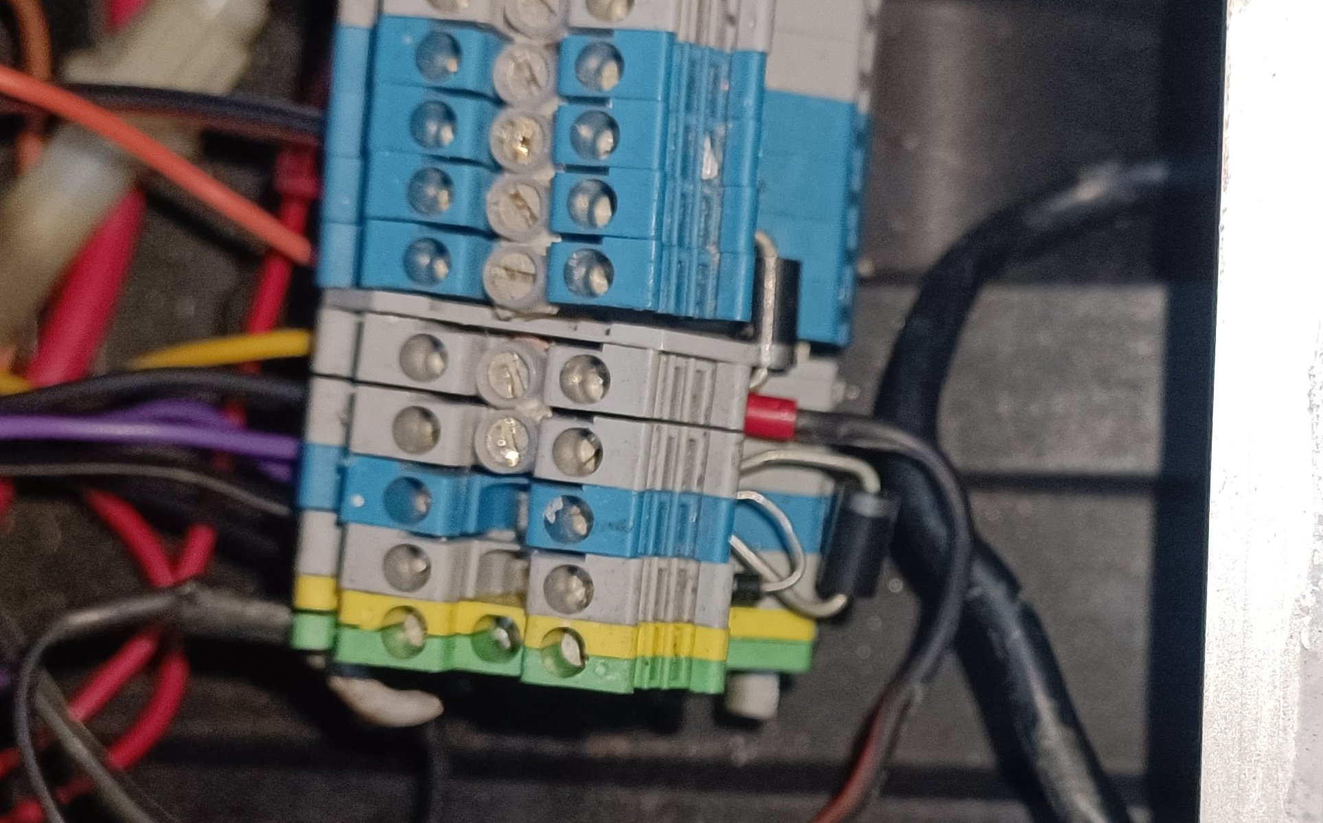

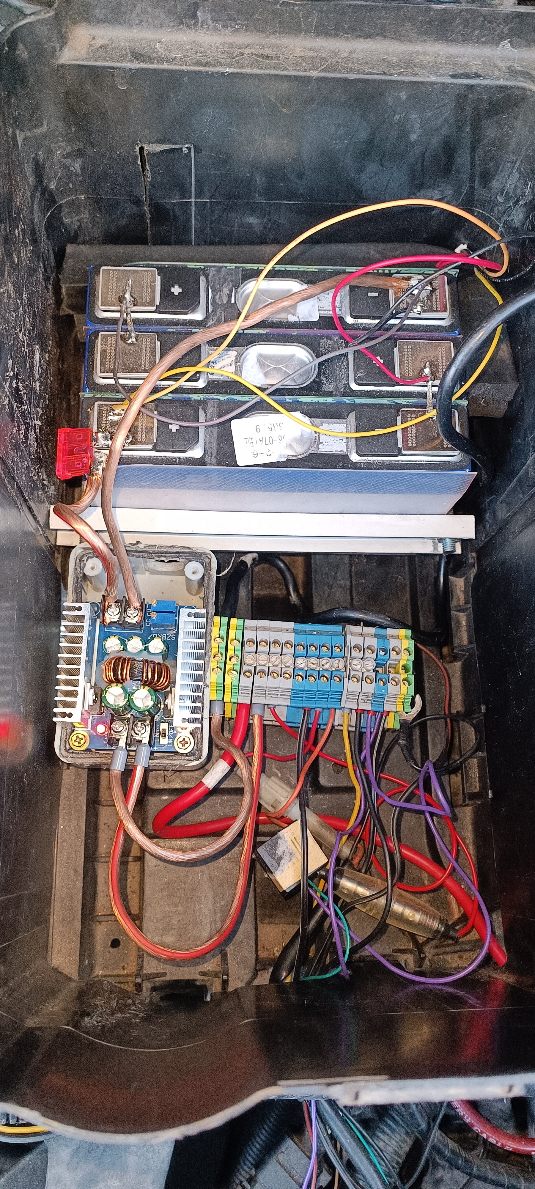

Today I rewired the various 12V circuits: GND, permanent 12V, ignition, charge OR ignition, rapid charge, charge OR rapid charge, GND
Diodes in the back. Just see something is bent here...

Got a chance to test my cooling scoops yesterday on a 350 km trip. Outside temp was 7°C so quite favorable. I drove 250 km then charged from 25 to 65% with 200A. Battery heated up to 44.5°C. I opened the scoops and after 50 km the battery had cooled down to 37°C. Then it started raining so I closed the scoops again. Now on the remaining 50 km the battery did not cool down at all!
So it looks they work rather well. Next test is a trip to 400 km away Dresden in June, so less delta T.

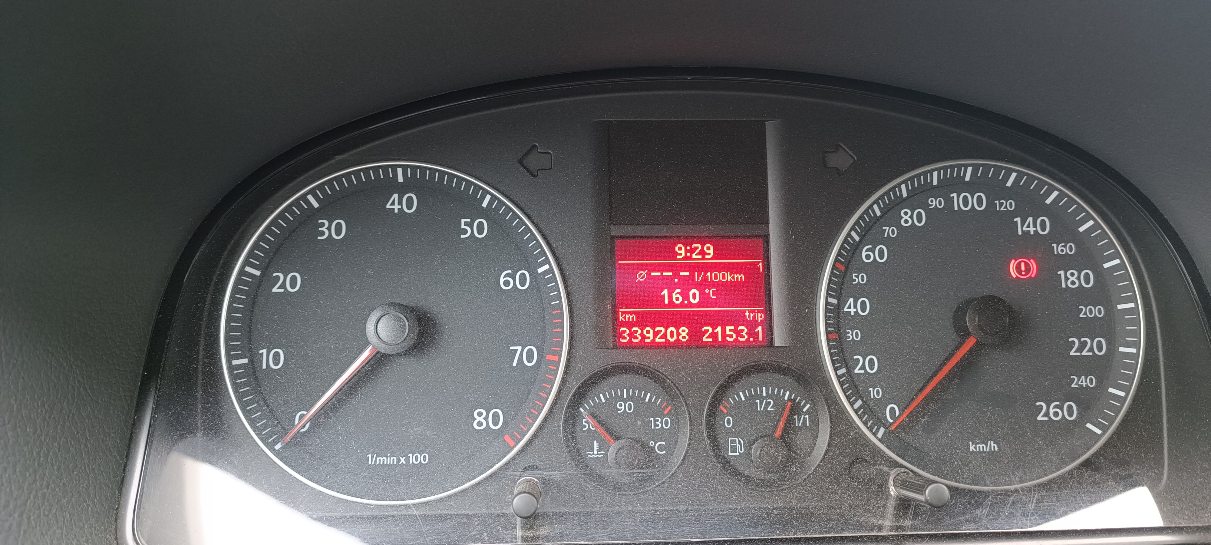

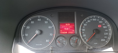

So in-between report of our long road trip that we're now eactly 2153 km into (currently at Dombås) Not a single problem on the drive train side but one problem on the CCS side as mentioned elsewhere: on the second day the auto-wakeup died so now I'm turning on Foccci by hand.
I'm inclined to think we're travelling rather cheaply: 78,47€ for 170 kWh of public charging accounting for less than 4 ct/km in energy cost. All other charging was free via Schuko. Let alone the CO2 footprint which is actually very close to 0 in Norway.

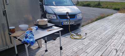

V2L is also playing nicely, have run our outdoor kitchen more than once:
Only need to make sure to wander off with the dog, it hates the noise of the induction cooker!

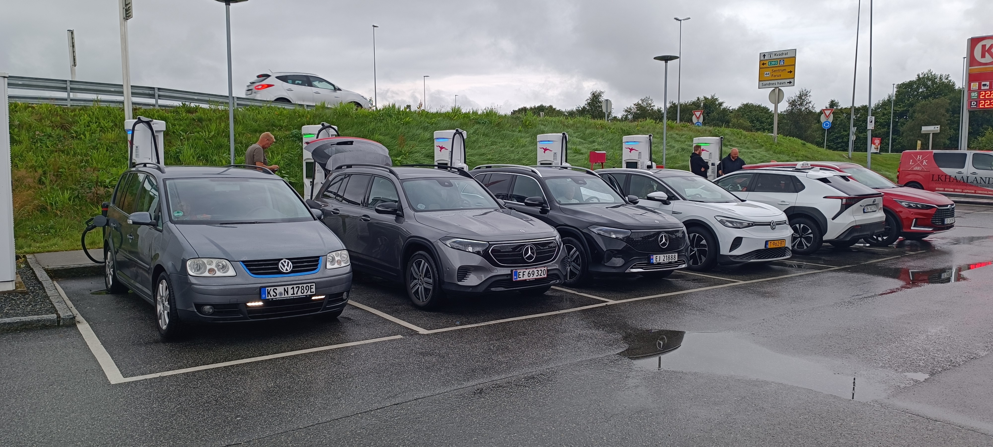

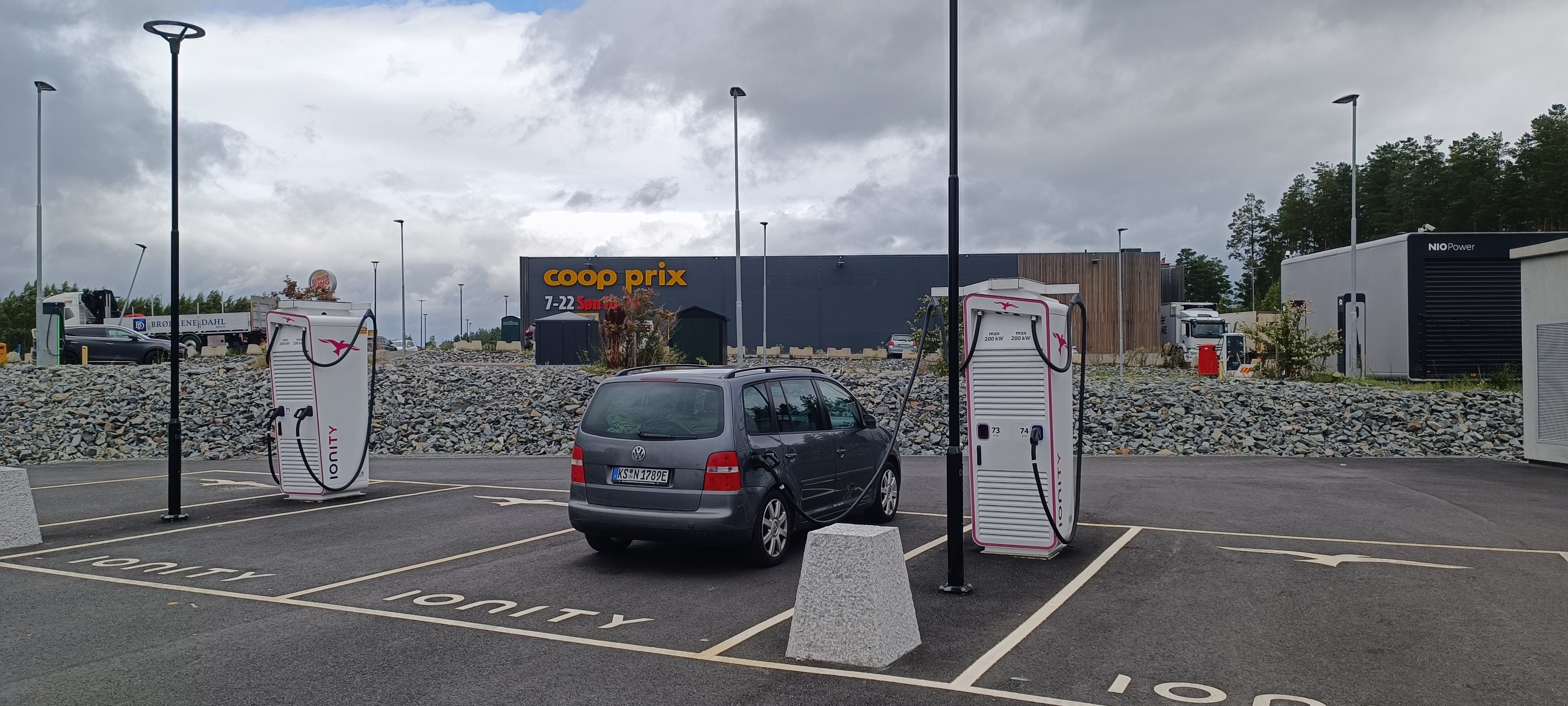

And we finish the trip with 4104 km.
Here I charge at Ionity Tangen, well known from Björn Nylands various tests: Lets re-evaluate
Ionity 82,78€ for 235 kWh (including sub fee) 0,35€/kWh
EnBW 24,67€ for 42 kWh 0,59€/kWh
EWE Go: 6,96€ for 13 kWh 0,52€/kWh
Fortum: 8,88€ for 16 kWh 0,55€/kWh
OK: 16,40€ for 45 kWh 0,36€/kWh
Others: 32.87€ for 78 kW 0,42€/kWh
That makes it 172.56 € for 429 kWh of public charging. The Ionity sub was kindof worth it but I think I'd ditch it next time. It's just too much incentive to queue up on their busy chargers rather than just using a random other one. The winner in subscription-less charging is OK in Denmark.
I didn't take note how much I charged from camp sites and other AC outlets but since the above works out to 105 Wh/km and the trip average was more like 150 Wh/km I'd say that was another 200 kWh that I didn't have to pay for.
EDIT: this would be roughly 630 kWh consumed. Had we used the Diesel it would have consumed 5.5 l/100km * 41 * 100km = 225l or 2250 kWh. That makes the EV 3.6 times more energy efficient. In carbon terms that is 225l*2,65 kg/l = 600 kg CO2 (from fuel alone, not accounting for average 20% in transportation and refining). In the Nordics it is around 40 g/kWh for 31,5 kg total - that is almost 20x less carbon emissions! Let alone all the nasty smelly stuff.
The last leg today was 550 km and despite high temperatures the battery never overheated! The trick: don't go deep and limit charge power to 50 kW or 133A. In addition I kept the air vent open all day and the fan running while stationary.

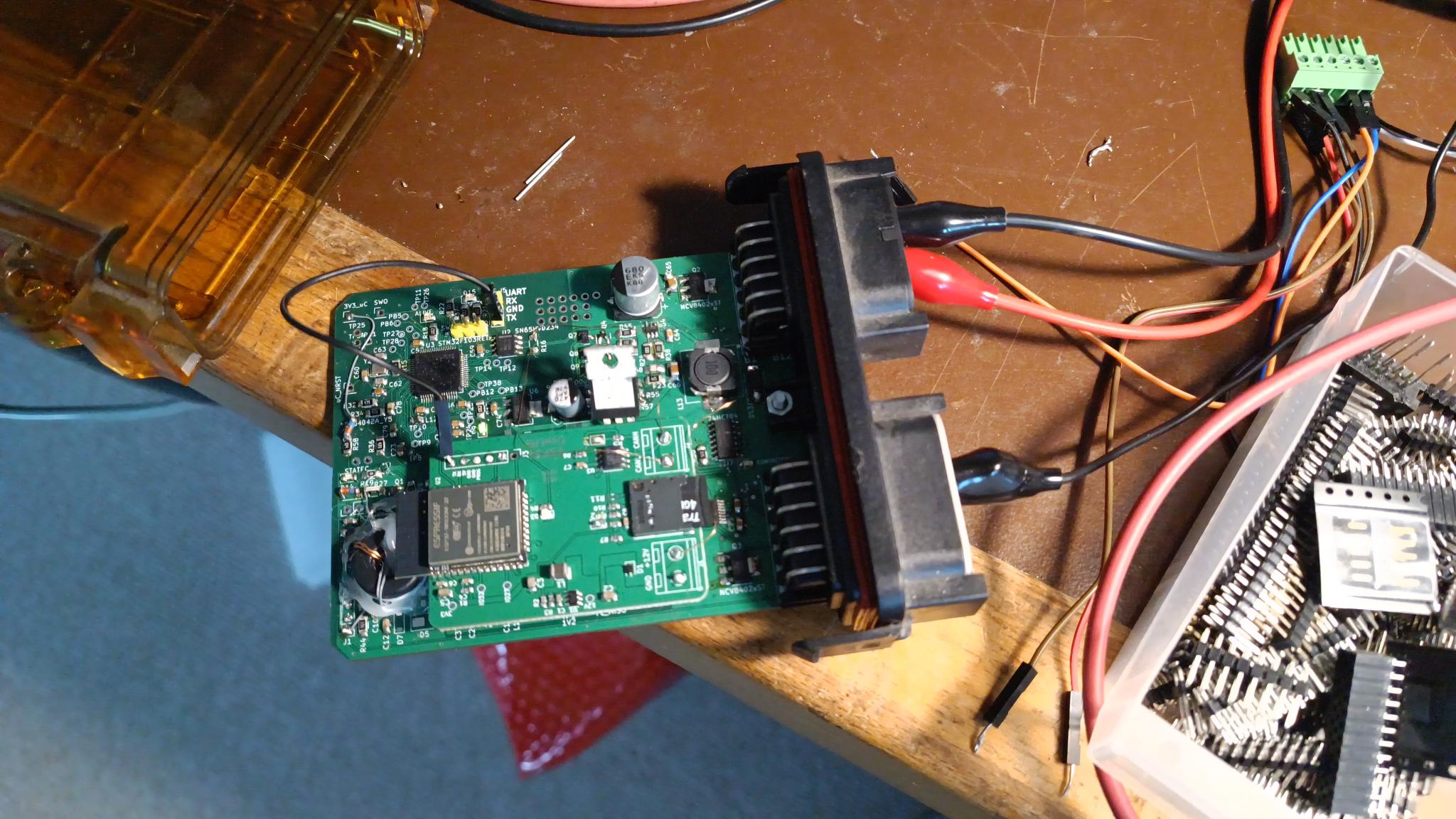

Fixed the Foccci enable FET again and this time added a TVS across gate-source. But I somehow suspect it could have died from overheating because it was very hot and the battery was hot as well. It only needs to conduct like 500 mA and is rated for 2.5A so not sure why. Also the gate voltage would be around -9V so good saturation. (SFP9510)
EDIT: I mean the weather was hot, not the FET
While at it I also stuffed an ESP module in there and modified Petes logging code to simply log Focccis serial messages to SD-card while no device is connected to wifi.
This also gives me a nice CAN bridge into the car.
