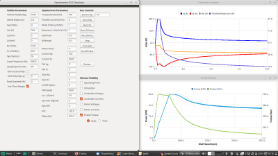

I have fmax set to 800, I've not logged what I manage to get it up to, again, I'll log it.

Assuming a 4 pole motor 800Hz would be 12000rpm, the simulation is only running to 3000rpm. If you let it run to a higher speed in the simulator you will see more power. The power should level out, probably by 6000rpm, when you hit base freq and enter the constant power region. At 3k you are still in the constant torque region.

4 pole motor, 12000 rpm is reasonable, motor rated to 14k so might up some more.

Ahh, ok, see what you mean now. The control loops aren't't looking too happy at higher speeds at all which code is that, guessing mine as it does tend to do that. If so it is worth dropping curkifrqgain or fwki to see if it helps.
Johannes new IIR filter version does seem to help avoid that control loop oscillation at higher speeds.

Just tried to reproduce and I can't get anything to stay stable in FW.
The thing that seems to make the biggest difference is Ld. I'm wondering if your bridge is under reading slightly, with a value of 0.16mH everything behaves much better and the power is back up to 75kW.
What is the resolution of your LCR bridge? If it is only 0.1mH then the actual inductance could have been up to 0.199mH??

It shows to 2 dp, one reading was 0.25 part way though a rotation, I also had a 0.13mH. Lowest was 0.10mH and highest was 0.30mH it was cheap so not expecting high accuracy.
I'm still running your code on the car and simulator for now.

I'd use 0.15mH for the time being, 0.1mH does seem very low. Any idea what frequency the Outlander OEM inverters run at?
It's been a while since I used the master branch on the simulator (I've been running the experimental branch) and It really isn't that good in terms of stability above base freq (not too surprising as it is essentially 5.20 code plus logging).
It would be worth moving either to Johannes latest (safest but no logging yet) or my experimental (untested but has the logging). As there is no rush on data I'd probably go for the former and hope that Johannes gets the logging going before we need it. Both options are better then the old code that you are currently running.

@johu - updating the simulator to support you latest code, all the mods are done but I don't seem to be able to reproduce your results. The plot which should reproduce the above comes out looking like this: Have you changed anything else that might affect this?johu wrote: ↑Sun Nov 06, 2022 3:20 pm More combined simulator and car tuning today (Prius that is). Today it seems simulator and car match up quite well.
I struggle to get more than 20kW constant power both in the car and the simulator: Controllers are very smooth now. The code is based on the recent github master commit, slightly modified for the simulator (e.g. export vlim). fwkp means filter constant!
The car starts out very powerful but quickly looses grunt above 40 kph. I saw 120A@360V which is a nice 43 kW. But then when at "speed", say 60 kph, I only see about 70A or 25 kW. So more than in the simulator but similar drop off. Any ideas how to obtain more constant power?
Had one uncontrolled regne event with some delay though, when coming off throttle at 100 kph
Edit - BTW - best to run with the extra cycle box checked as otherwise it doesn't accurately simulate the hardware PWM load delay.
Edit2 - Looks to be something to do with the IIR filter which is producing silly results but can't figure out what. Assume that 11 is right for vlimflt?

Yes I had changed something just for the simulator. Let me see:Pete9008 wrote: ↑Wed Nov 16, 2022 4:20 pm @johu - updating the simulator to support you latest code, all the mods are done but I don't seem to be able to reproduce your results. The plot which should reproduce the above comes out looking like this:

vlimflt=11 is good. I had tried with that delay checkbox + syncadv 10 and got some infinite currents. So disabled it and didn't investigate further.
Had that with Leaf motor and had to lower curkp from 150 to 60

Still a bit suspicious about the current sampling on low L motors. There were some very odd current waveforms in you early logs but not sure whether it was the card or real.
Edit - still also wonder whether adding transmission play to teh simulator would help with modelling those trips.

Thanks, that's fixed it. Could do with figuring out what the problem is or add some conditional compilation.johu wrote: ↑Wed Nov 16, 2022 5:18 pm Yes I had changed something just for the simulator. Let me see:simulator didn't like that.Code: Select all
/*if (frqFiltered < FP_FROMINT(30)) qController.SetMinMaxY(dir <= 0 ? -qlimit : 0, dir > 0 ? qlimit : 0); else*/ qController.SetMinMaxY(-qlimit, qlimit);
Running without it does make life a lot easier for the control loops but unfortunately isn't very realistic
Right, going to push the latest simulator code up to github then I can get to the stuff I meant to do this afternoon!

OK, latest version of the simulator that supports Rel 5.24 of the inverter code is now on github. Note the change in the above post that is needed to keep things happy.
Also note that this version will not work with previous versions of Johannes or my code!
