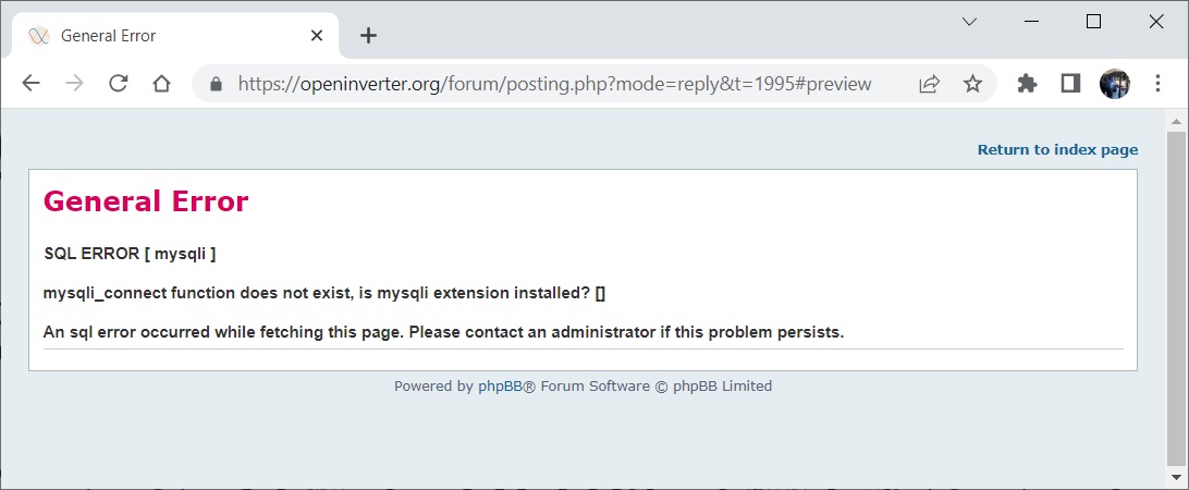

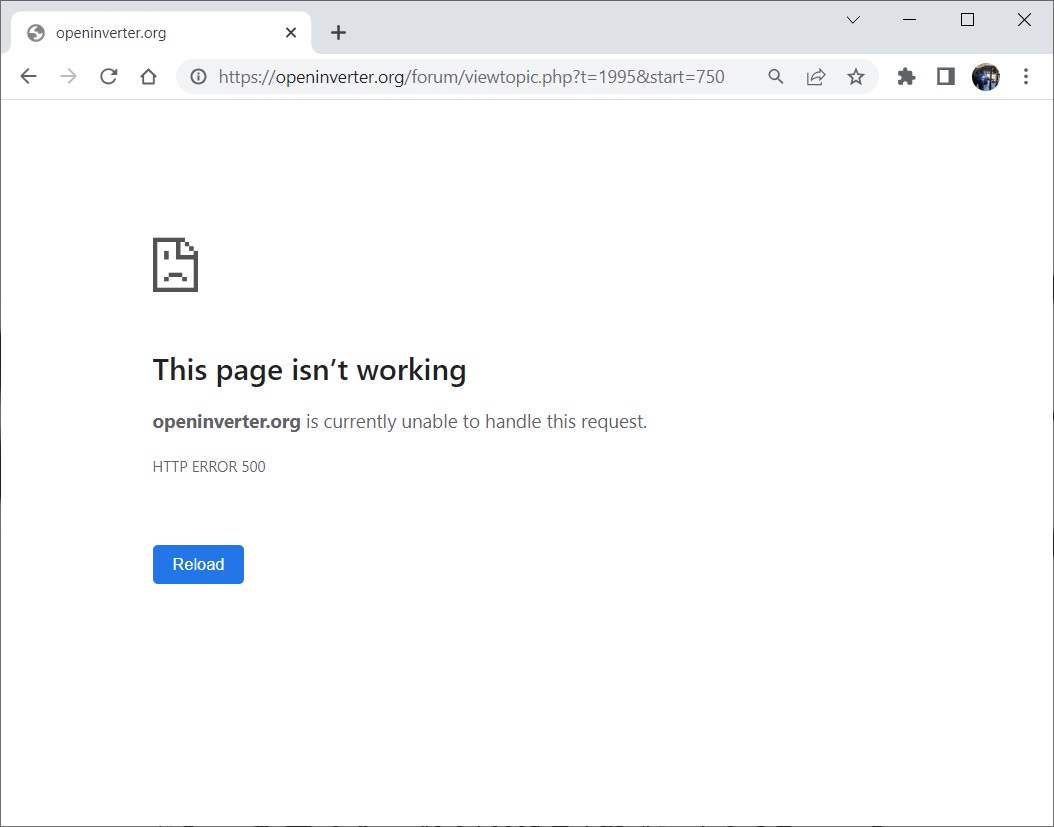

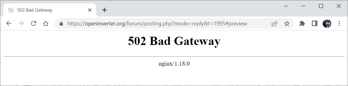

snap crackle pop, did I just break OpenInverter ?
Note To Self: cut back on the comedy
