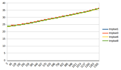

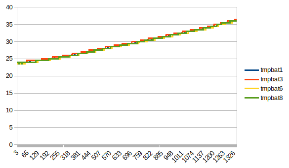

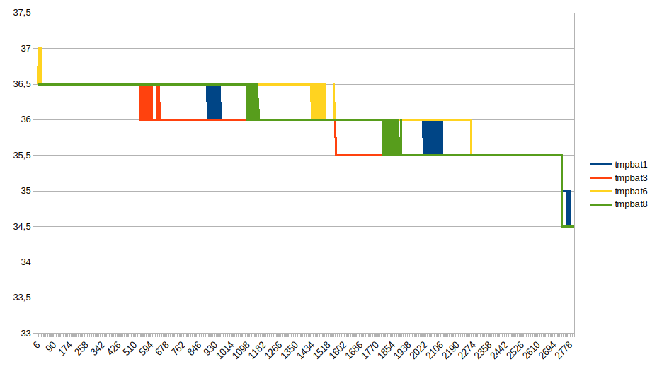

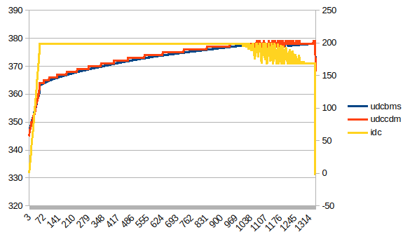

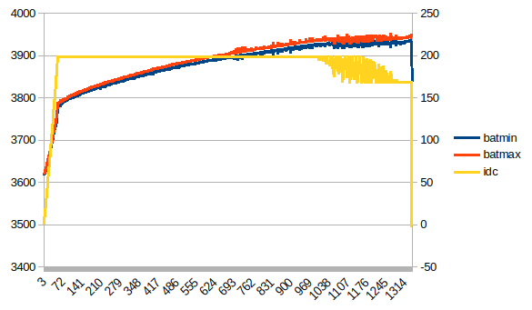

I decided this needs more data. So I went to a V4 super charger and charged for 10 minutes from 35 to 58%. Outside temperature was 23°C and fan running at full speed.
Raw data is attached, here is some plots
Voltage drop is lost in measuring accuracy. It was always less than 1V. You can see the CCS value only has 1V resolution, thus the steps.
Cell delta is adorable, never seen cells so well matched. Maximum was like 10 mV
Temperature rose from 23 to 37°C in said 10 minutes
The difference in voltage from 0A to 200A is 16V or 169 mV at cell level. That would be 80 mOhm for the whole pack and 0.845 mOhm per cell. Close to spec of 0.74 mOhm.
When turning off we see only 7V drop from 168A to 0A. That would point to half the resistance, 41 mOhm. Probably because we are now at 37 °C.
I remained stationary for a minute after charging and the temperature rise immediately stops or maybe increases by 0.5°C
So now we have lower resistance than assumed but higher temperature rise (despite fan) than calculated. Hmm
EDIT: wait, I charged at 200A not 185A. So 200²*0,08/(256*900)*15*60 = 12.5°C. Still lower though
I'm now recording the cool down over 2 hours with fan running.
EDIT: here is the cooldown over 80 minutes
test.csv
(227.23 KiB) Downloaded 630 times
2024-07-25 drive and charge.ods
(295.74 KiB) Downloaded 646 times

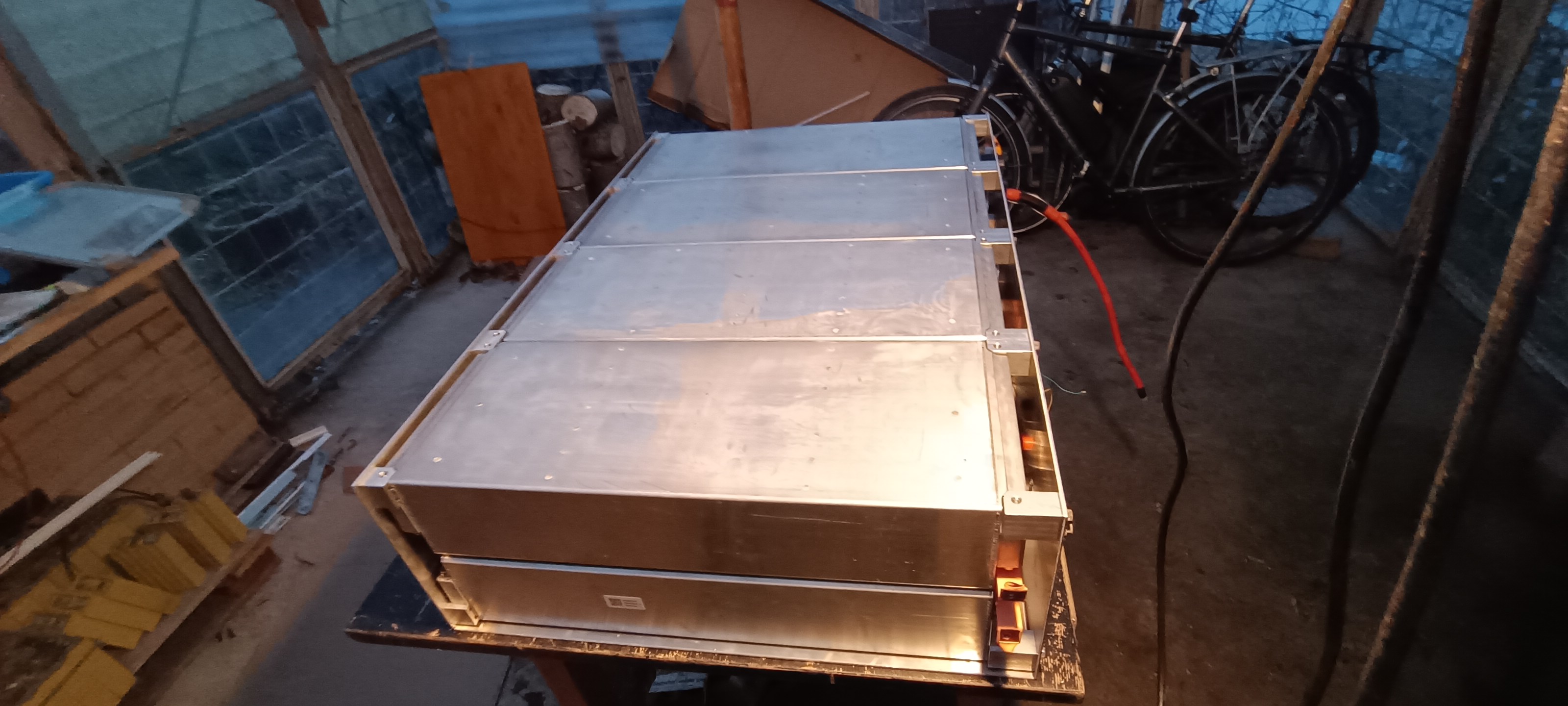

The battery box is aluminium. The plan was to do just that but I screwed up. The distance between the upper modules and the box is 3mm :? It's super hard to get everything out again.
The lower half I have more of a chance. They don't touch the cover plate at all. I would like to add something soft that conducts heat. That way if something hits the cover plate it doesn't immediately propagate to the module

We are now about 14 C measured compared to 12,5 C calculated, right ? What I gave you with 900 was the heat capacity for Aluminium . NMC s are in literature with 800-1000. I think measured current and voltage loss is better then internal resistance as this changes much more over time .
Other effect ist, where the temperature is measured. Maybe just 180kg needs to be fully heated until it reaches the sensors. Really depending on the internal design of the modules and the heat transfer between different layers eg cell chemistry and Aluminium housing.
Interesting to see , that for high charge power and short term , voltage losses are dominanting the convection.

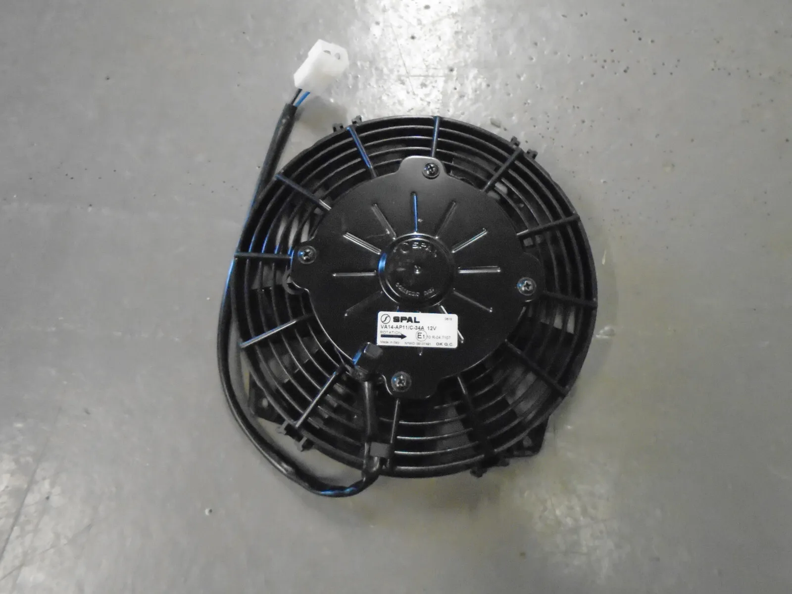

Yes 180 kg would be plausible as each cell is less than 1 kg and there are 192 of them.
"Flying Tools" youtube channel once ripped apart an MEB module and the modules are thermally connected to the bottom plate mostly. That is the issue:
I'm blowing in air through 2 small holes (40mm) where the middle BMS cables are and the air exits where the outer BMS cables are. A lot of the pressure leaks out elsewhere. Compared to the humongous air flow this fan generates only a tiny breeze is left on the exit pipes. Like enough to blow out a candle.
So issues
- Air flow limited by hole diameter
- Air leaks out before getting to the batteries (could be fixed)
- Air only flows via the top surface of the module that is not thermally bonded directly to the cells
- It's unclear where the air stream goes past
Mathieu already suggested to make vent holes in the back of the box to have a cleaner, higher volume air flow. I'm really afraid to add new holes and possibilities for water ingress though. Plus I might drill into the module when making the holes.

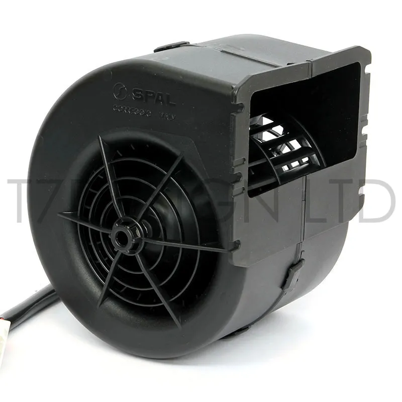

Or you could simply make the box sealed, cut some slots at strategic places in front and back and fit the blowers with some filter to your assembly. You would blow air INTO the pack, create positive pressure and dust and moisture would go out :).
I would imagine correct size of blower should be your veritable cabin air blower assembly! As it normaly comes with filter you could just use it with OEM channel if you have the space.
From your photo the sides are where the air should move unimpeded but i think you should make standoffs on the upper as well as lower levels. Even 3mm would help i think.
Some blower suggestion....
https://www.ebay.de/itm/201955251263?ep ... R-rnneKeZA

Suction fan example...you could use multiple fans...
https://www.ebay.de/itm/386324117630?it ... R9TD4-KeZA
