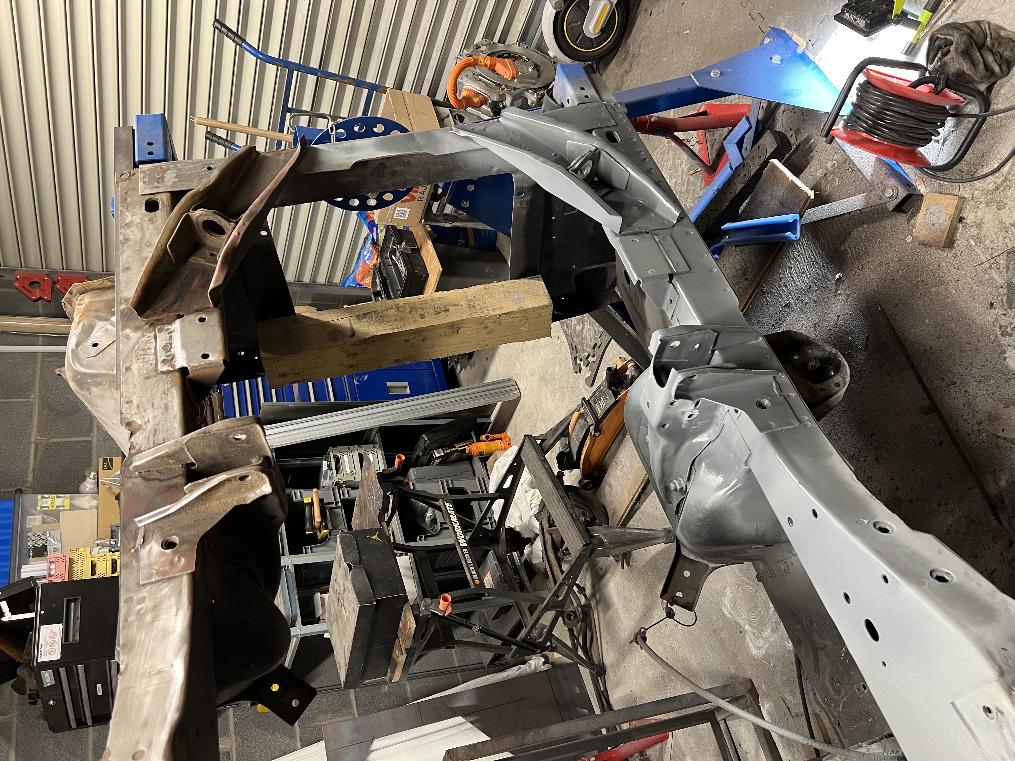

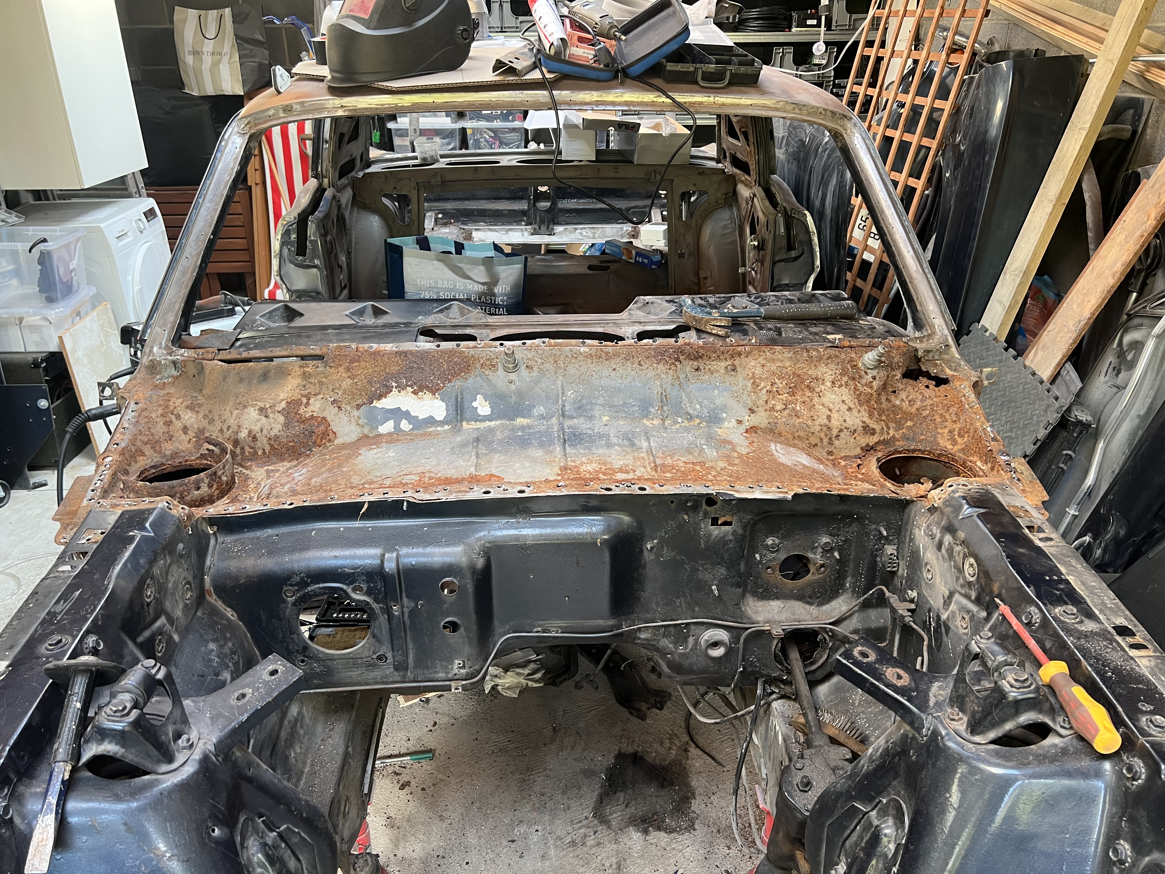

Cowl tank replacement.
Front inner fender cleanup.
Rear wheel arch cleanup.
Front frame rails

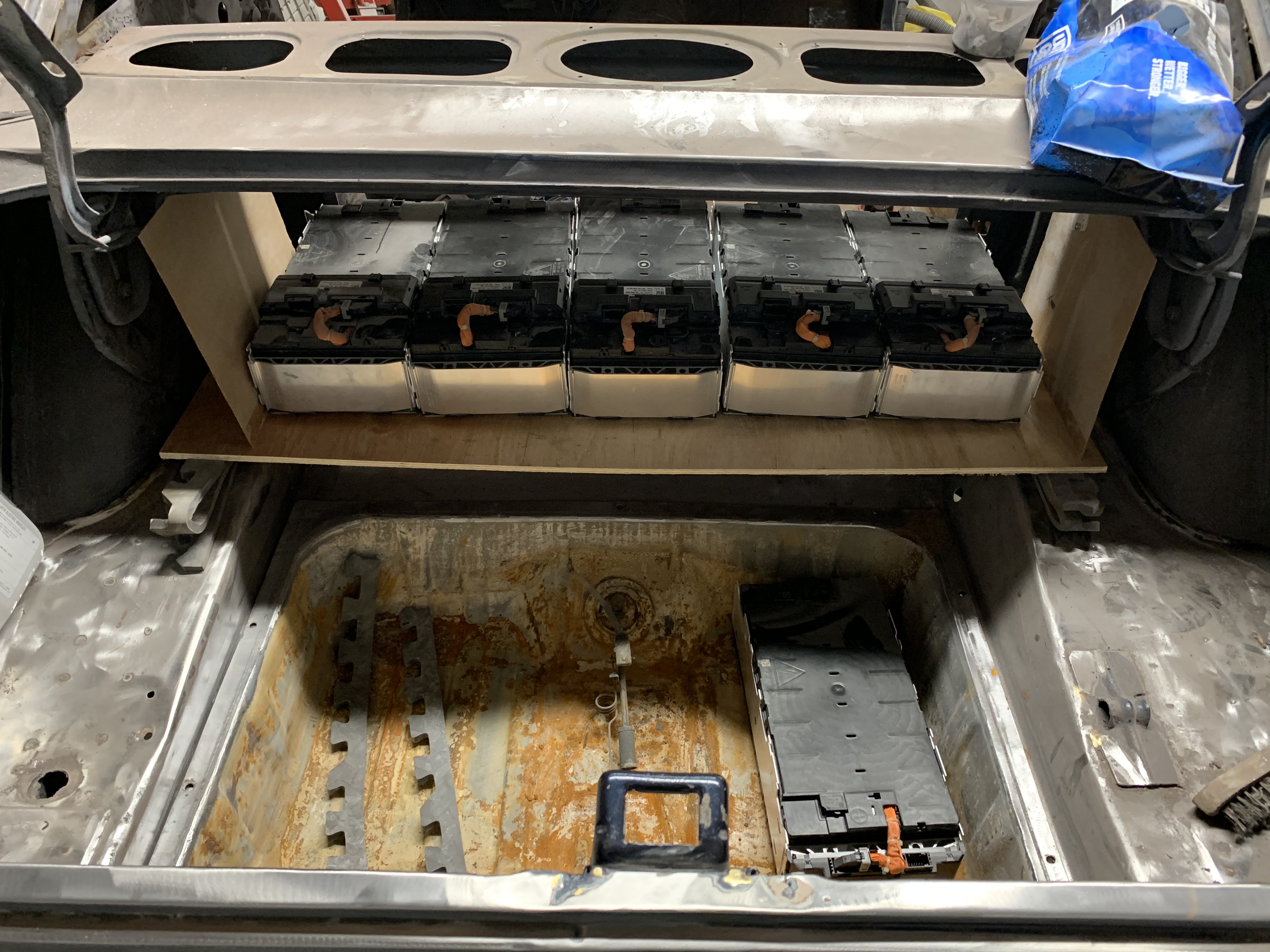

After lurking on some conversations in Damien's discord, I'm also rethinking the rear battery location. One thing that this car is notorious for is, when rear-ended, the fuel tank gets crushed. If I were to put the batteries where the fuel tank goes, there's not a lot of car to absorb an impact before getting to them. It's a shame, as the batteries fit so well into this space - it's like they're made for it. But there's only something like 300mm between the rear bumper and the edge of the battery box. So, instead I think I'll put them in the boot, behind the back seat, over the rear axle. When I looked at this before, I thought I wouldn't fit all 6 modules there. But, dumb dumb that I am, I didn't consider just putting them on their side. Then they fit easily. So, the plan then is to make up a battery box, probably out of aluminium, and crane it in whole. This also has the benefit of it being further into the car, and further away from wet.
I'll still finish and use the tub that slots into the old fuel tank spot. Instead it will now just house the OBC, rear HV junction box, charge controllers, BMS, and some other bits.

Re: [WIP] 1965 Ford Mustang
Posted: Sat Apr 06, 2024 7:26 pm
by Alibro
Looking good
Would it be easier to put a cage around the back of the car in the boot or behind the rear bumper to strengthen it rather than compromising the battery position?

Alibro wrote: Sat Apr 06, 2024 7:26 pm Would it be easier to put a cage around the back of the car in the boot or behind the rear bumper to strengthen it rather than compromising the battery position?
In the long run its probably just easier to relocate the batteries rather than trying to add strength to rear of the car. They will actually fit quite well above the rear axle too as it turns out.

Correction, the rear-most point of the car is about 150mm from the edge of the fuel tank area. So, even worse than I thought.
Posted: Wed Apr 10, 2024 9:40 pm
by rstevens81
From someone who has quite literally driven himself nuts worrying about battery placement .... Rember the batteries are not as explosive than than petrol. For what it worth either (a) put them above the rear axel bits obs quite a bit of weight high up or (b) place them in the fuel tank area but put them side ways in an arrangement of 2x2 that way the connection goes in a circle and the cables can't really short out in event of a big shunt.
The thing to rember is that even with relatively recent cars upto the early 2000s had fuel tanks located behind the rear axel on the crumple zone (vauxhall omega is a good choice) and also rember that r100 only specified that a crush test is required if it's less than 300mm from the furthermost rear (or forward edge)
edit: slept on it a bit ....and changed my advice...since you can fit them above the axel do so, i would get some threaded rod and use these.

Edit 2 this is how I would arrange batteries above the rear subframe frame rather than on their side stack them up...this gives you lots of space that you will need for fuses and contactors etc (the sbox is a bit weak to be reused really)
Posted: Fri Apr 12, 2024 3:44 pm
by chrskly
Thanks for the input, it's a big help :)
Yeah, the more I think about it, the more the batteries-over-the-axle option seems like the better one. Like I say, I had sort of discarded the idea early on. They didn't seem to easily fit above the axle and the dimensions of the fuel tank lined up so well. It's your classic "if I fits I sits" situation.
I don't think I had considered arranging the batteries the way you're suggesting. Which is surprising as I have pages and pages and pages of scribbles of different configurations for the front box :) I have max 280mm of height above the axle. It might be a little less as I'm not confident in the accuracy of that measurement. The BMW PHEV modules are 105mm tall with the CSC clipped to the end and 125mm tall with the CSC clipped to the top.
CSC on top => two modules tall = 250mm
CSC on end => two modules tall = 210mm
Both options are fairly tight, but possibly doable.
Not that it makes any difference, but there is a little error on your drawing. The battery terminals are always on the same side as each other. So, I just drew it out again, just to double-check. Basically just the 4<=>5 link (on your diagram) is on the other side.
Min dimensions of CSC on top => 753mm wide, 360mm deep, 250mm tall
Min dimensions of CSC on end => 800mm wide, 360mm deep, 210mm tall
I'll have to factor in enough gaps to fit everything together, plus the battery box material itself.

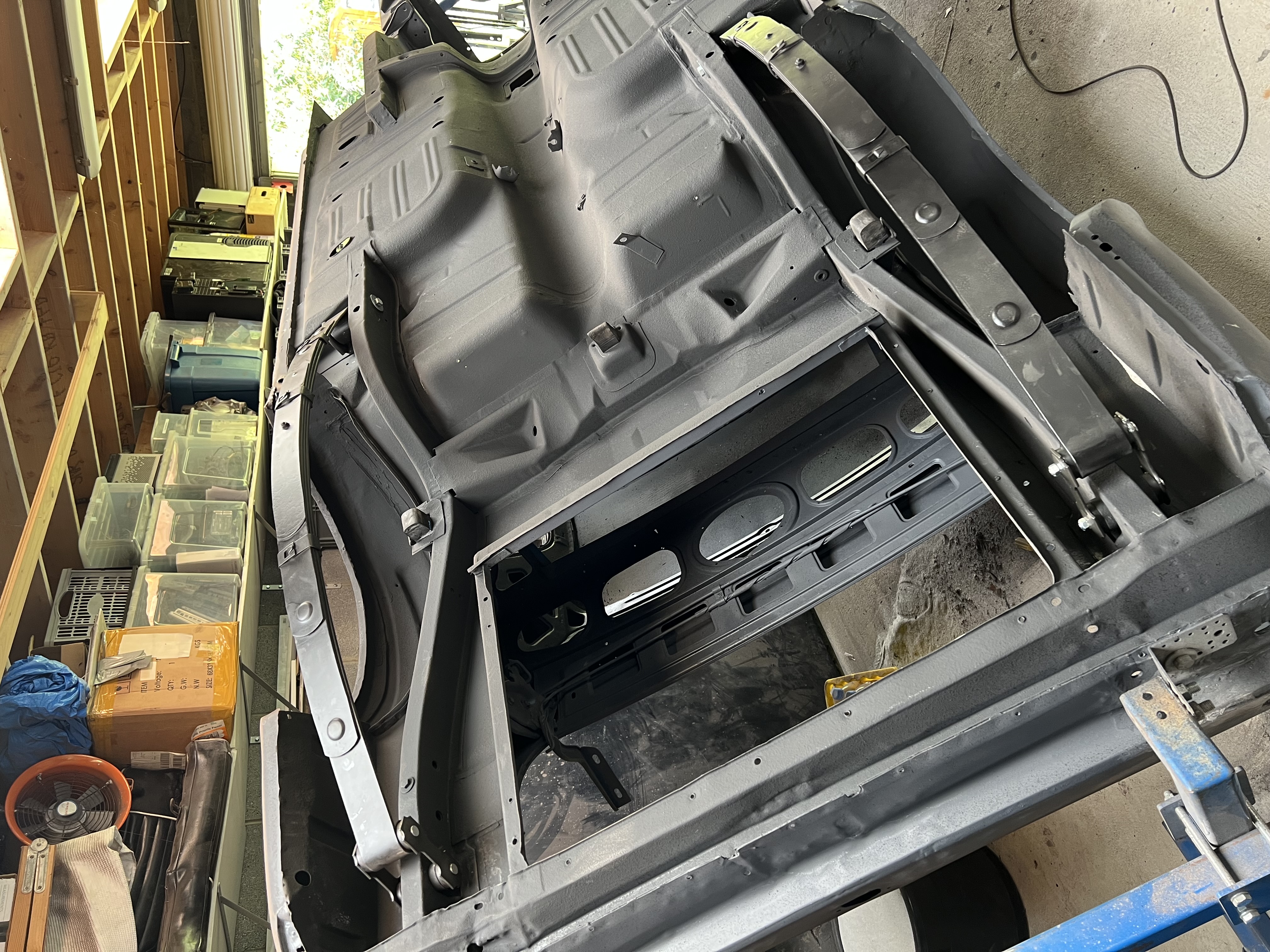

That’s it. I can’t take it any more. I’m just declaring the rust repairs as done. They’re not really done of course. But, for my sanity, I’m just calling them done. The doors still have holes in the bottom, I’m sure the inside of the front fenders have at least some surface rust, and some hard to reach areas in the cabin need at least a quick spray with rust converter, but the chassis itself is essentially rust-free and sound so I’m calling it.
Undercoating
I wasn’t sure how I was going to finish off the underside. To be honest, I sort of made it up as I went along. I knew, at least, that I would be topping the zinc primer with a two part epoxy paint. That seems like the standard way to go. I then opted to run seam sealer over the paint. But somehow I ended up buying white seam sealer and that looked a bit odd against the grey epoxy. It’s all on the underside so it should massively matter, but, in the end I decided to go ahead and shutz the whole bottom of the car to finish. I’ll get an extra layer of protection out of it and it makes it all the same consistent colour.
I’ll also need to wax the inside of the frame rails at some point before having the car out in any wet weather. But that will be pretty simple to do.

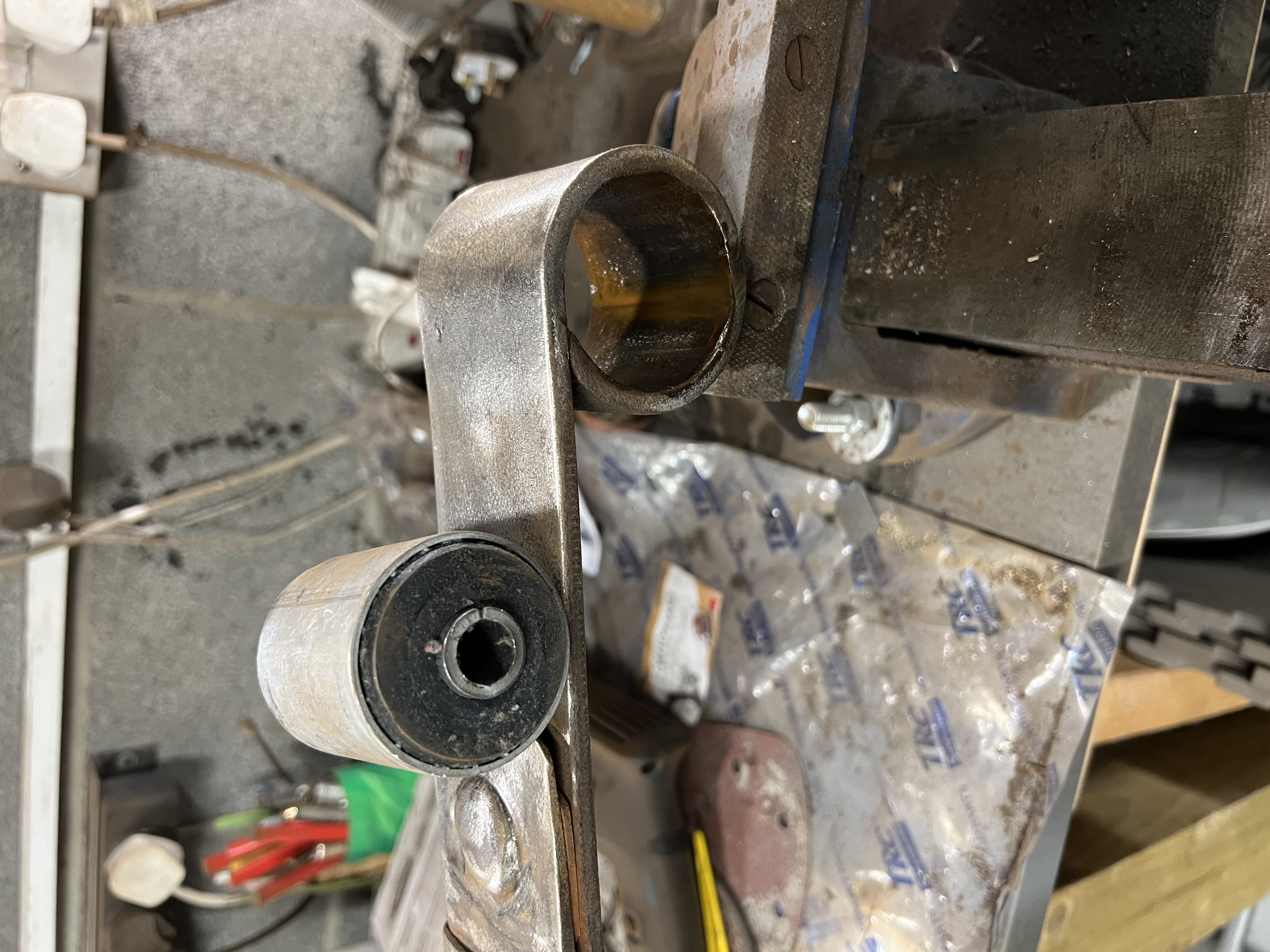

Leaf springs
The front bushings on the leaf springs have a metal tube running through the middle. The mounting bolt runs through this metal tube. When the tube/bolt start to rust, they can get fused together. This is exactly what happened in my case so I ended up having to cut the bolt off and replace the bushings. For one of them, I couldn’t get in with my angle grinder so ended up sawing it off with one of those hacksaws where you can stick the blade out the front. Sore shoulders were had for a while after that.
I don’t have a press, so, to remove the old bushing it was just a lot of hammering with a lump hammer and a chunky chisel. Getting them back in was a lot easier. I could just about fit the end of the leaf spring and the new bushing in my vice and just slowly press it in.
I cleaned up the leaf springs with a polycarbide disk on my angle grinder and painted them up with some high temperature paint - I read somewhere that you should use VHT paint on springs.
The rear of the leaf springs use a shackle set up. The old shackles were in pretty poor shape, so I got some fresh ones. It was just a case of tapping in the new bushings, then bolting the shackles in (after applying a little grease).

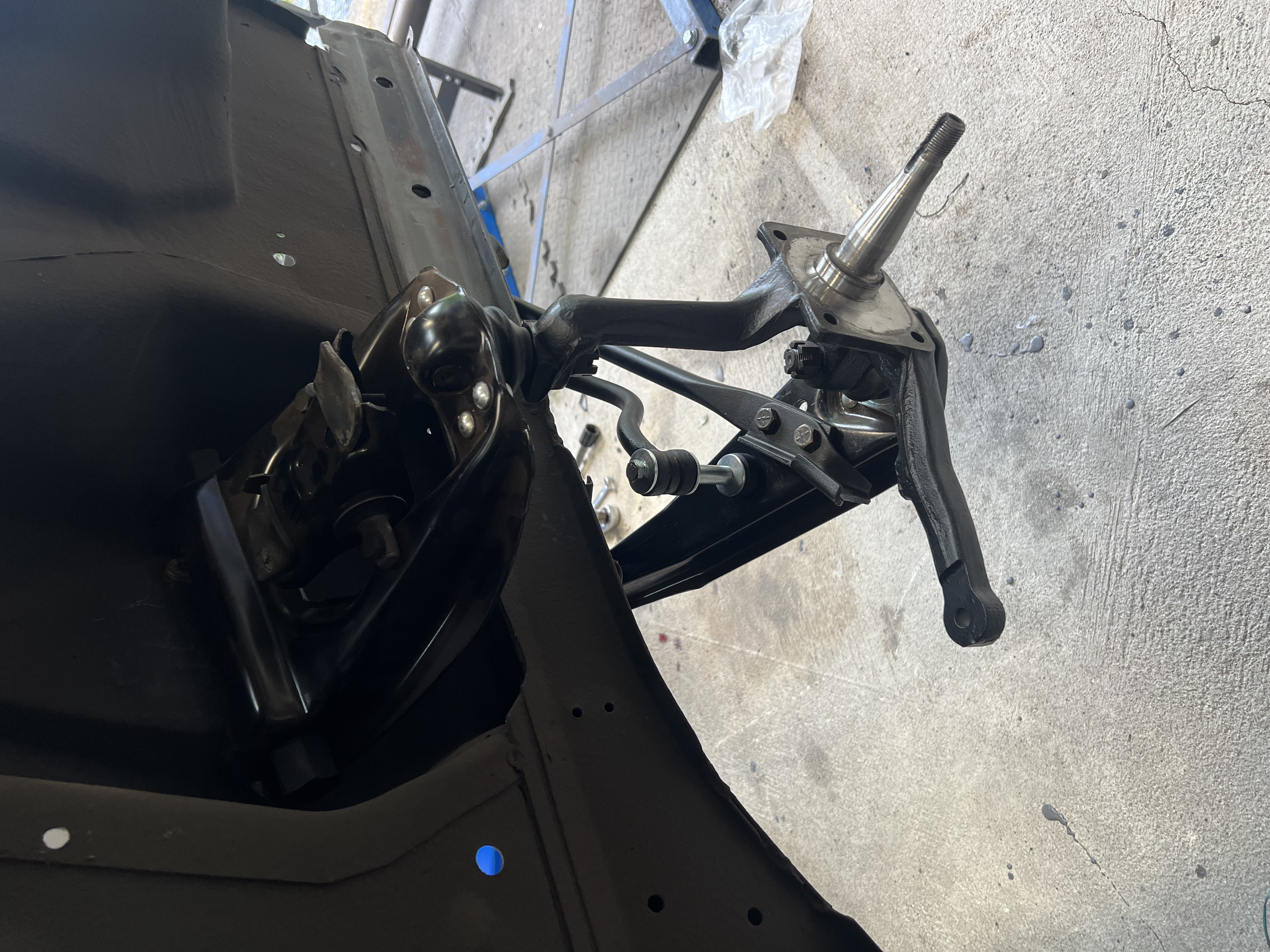

Front suspension rebuild
The front suspension got a lot more attention. This is what it looked like at the beginning. All of the bushings were totally perished and in some cases were literally crumbling.
I tried to keep the original upper arms and just replace the ball joint. There was a ’tear’ in one of the upper arms around where the ball joint attached. I tapped this back together and welded it back up. I got replacement ball joints, but they ended up not fitting. I also discovered that the hinge/arm that the upper arm sits on was quite badly worn down. So, I ended up just getting whole new upper arms for both sides.
The ball joints on the lower arms can’t be replaced - they’re held on with some sort of a rivet type fastener. So I just had to replace the whole arms.
The sway bar end links also had to be completely replaced. The bushings were literally crumbling.
But the rest I kept and refreshed - sway bar, strut rods, springs, spring covers, spindles, steering stops.
