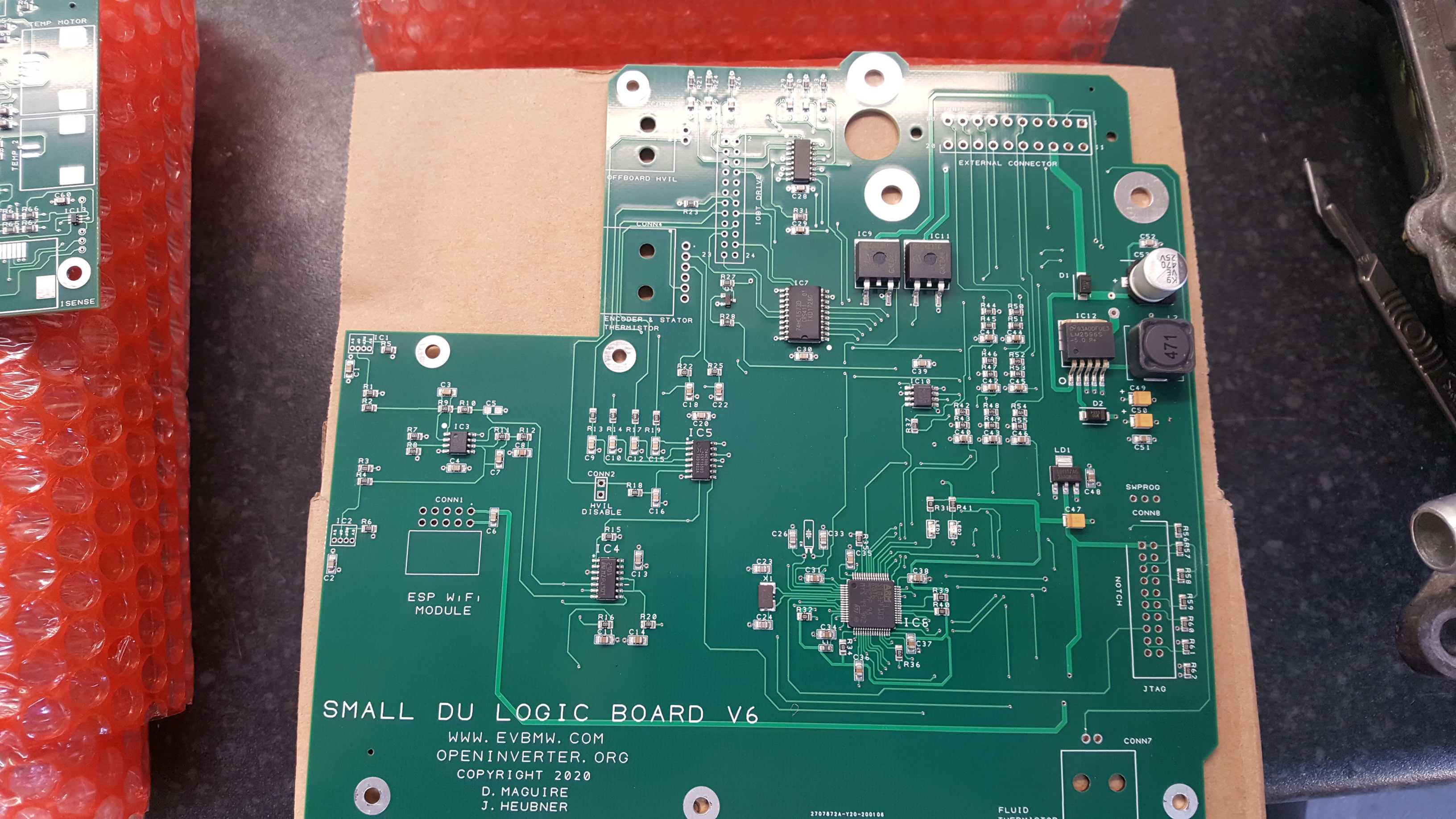

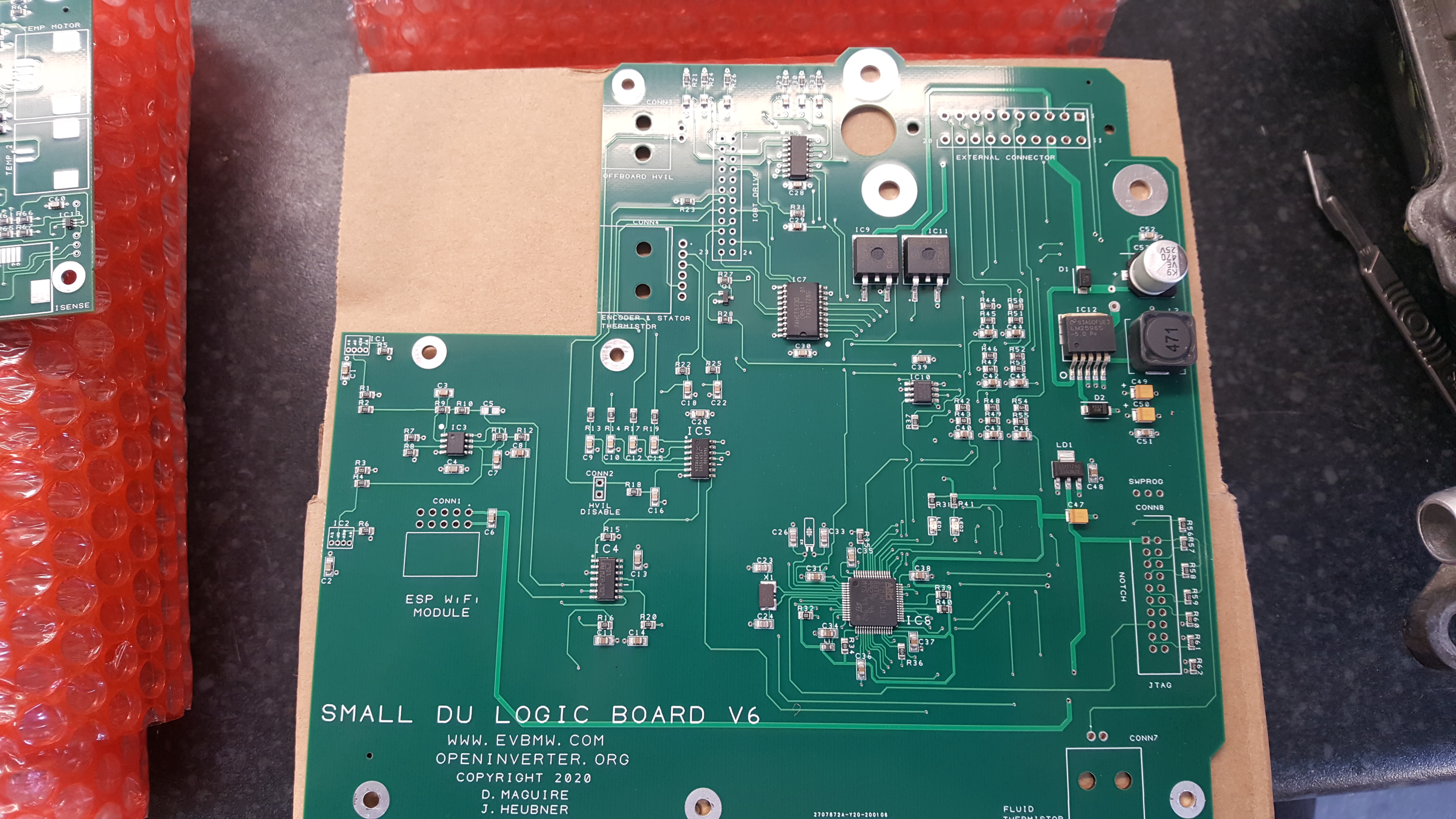

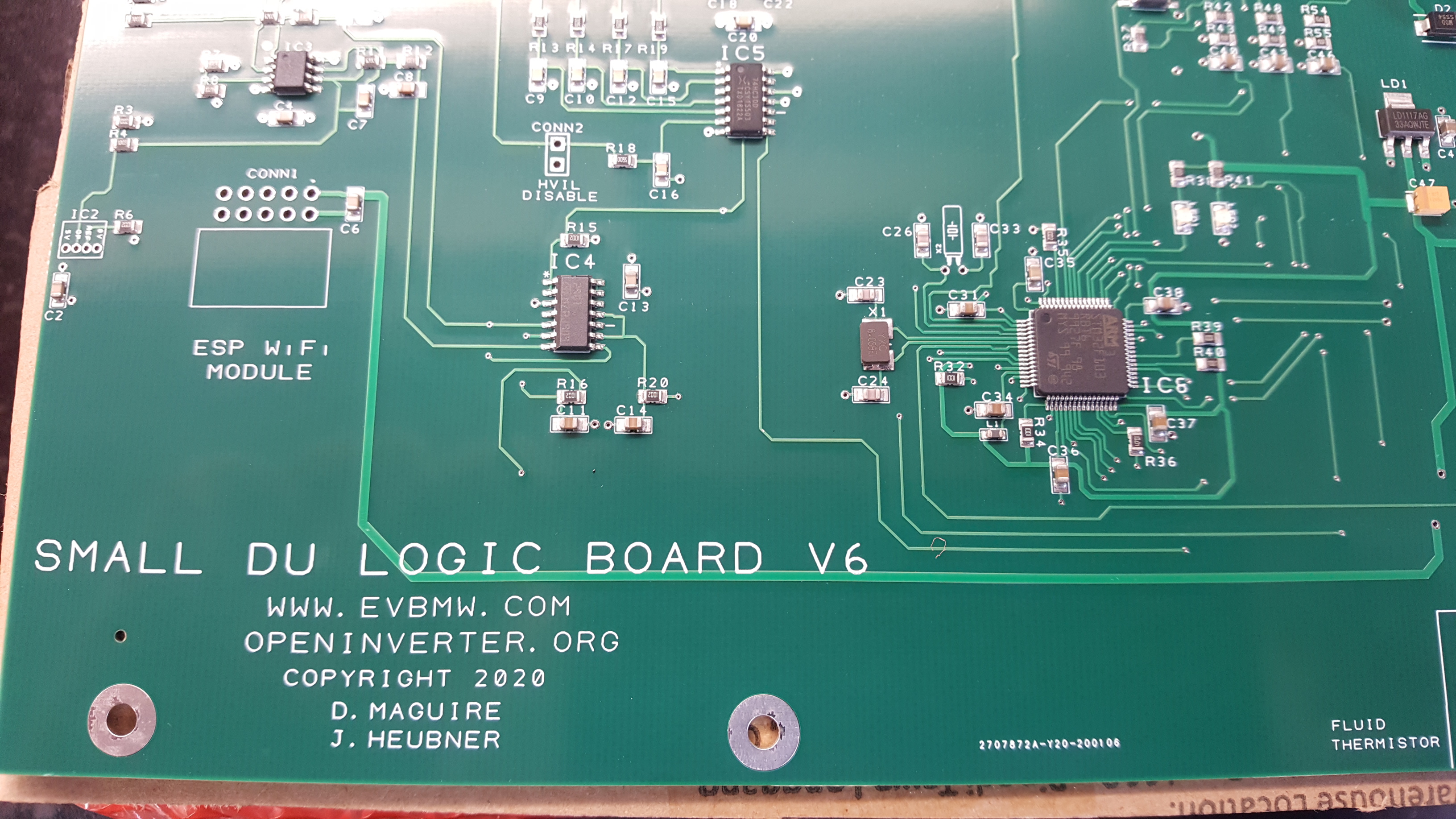

First batch of prototypes have arrived from JLCPCB. Initial observation is that this is top tier board building. As good as anything I have ever seen in my career and better than anything local who have charged a hell of a lot more.
I'd like to appeal for some calm in relation to the whole JLC build. I won't be responding to anymore "DAMIEN! WHEN ARE YOU RELEASING THE JLC BOM AND PLACEMENT FILES!" type of emails or messages on here or otherwise. The boards will be tested. Errors if found corrected. Webshop and github will then be updated and videos made. The vast majority of people are great and appreciate the effort involved but some seem to think I'm their personal design engineer. Newsflash! I'm not.
Now in relation to the webshop we'll be making a few changes. There will be three tiers of board available to buy :
1) Board direct from JLC as I receive them with listed smt placed, unprogrammed and untested. This will replace the bare boards currently on sale.
2) Board direct from JLC as I receive them with listed smt placed, programmed but untested. This gets around the need for programming the micros.
3) Board with all components both listed smt and non listed smt and through hole placed, programmed and tested.

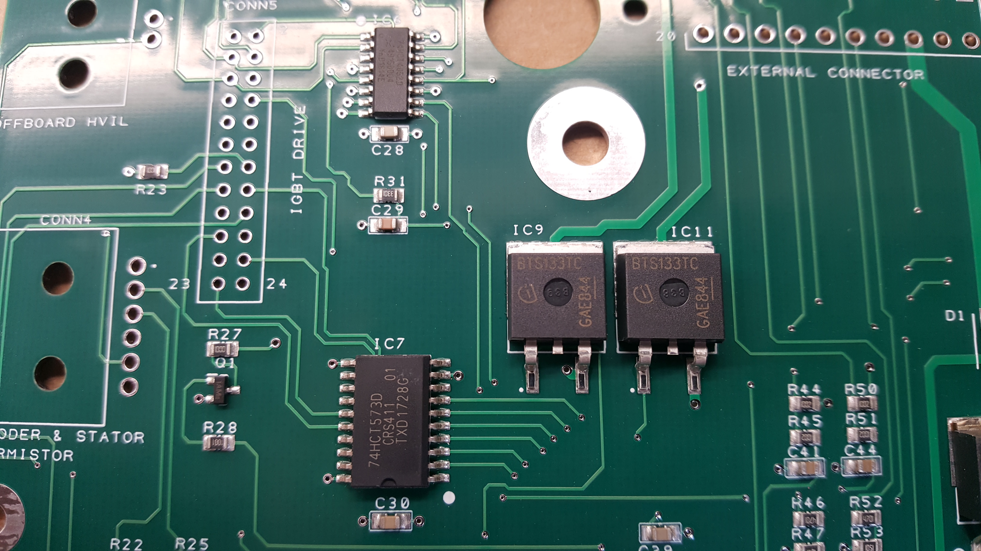

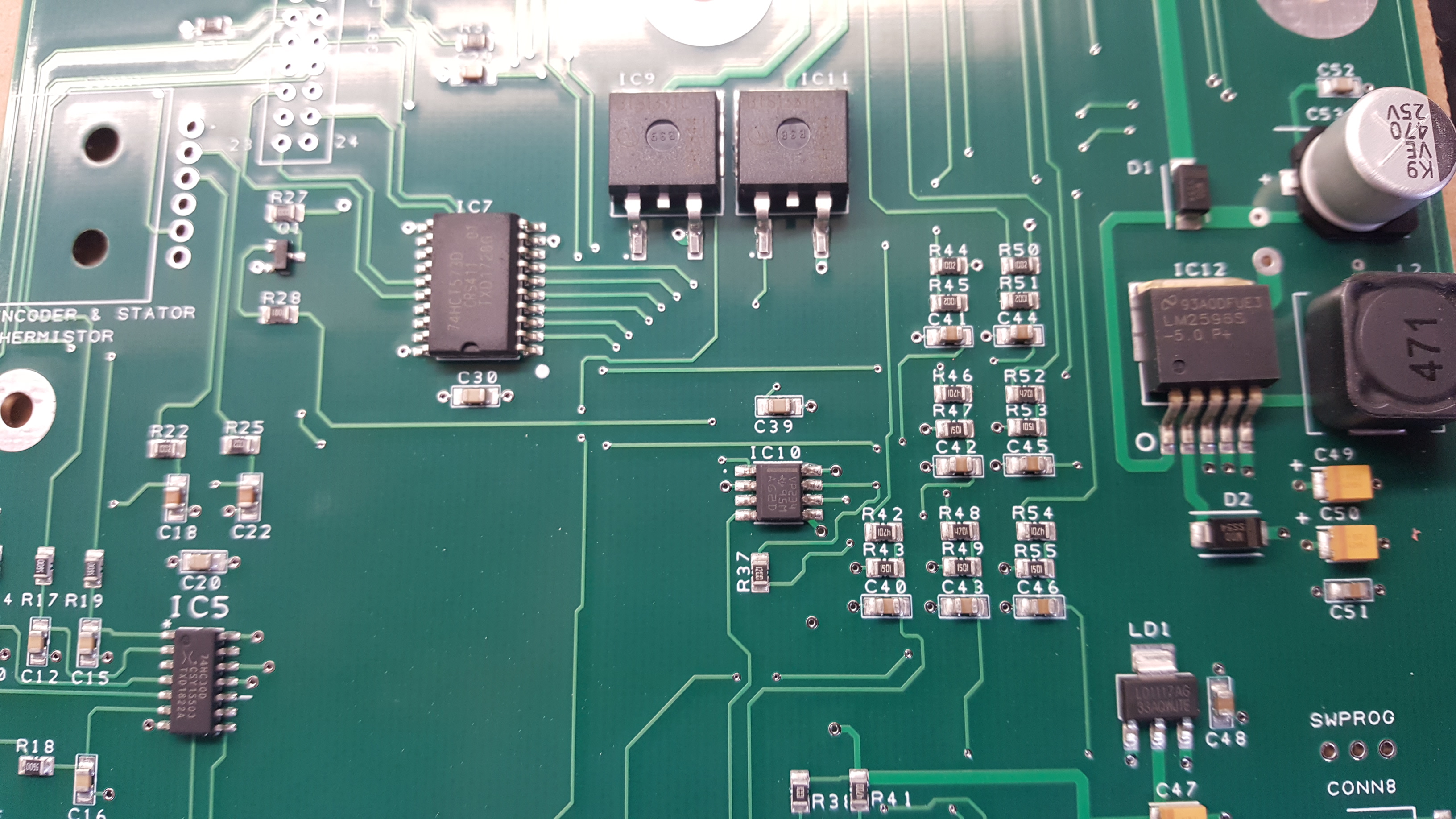

Bench tests on the V6 SDU board from JLC complete success.
A few errors on my part :
1) D1 and D2 incorrect polarity
2) C5 (1nF) missing from bom.
Next up testing in an inverter then up for sale:)

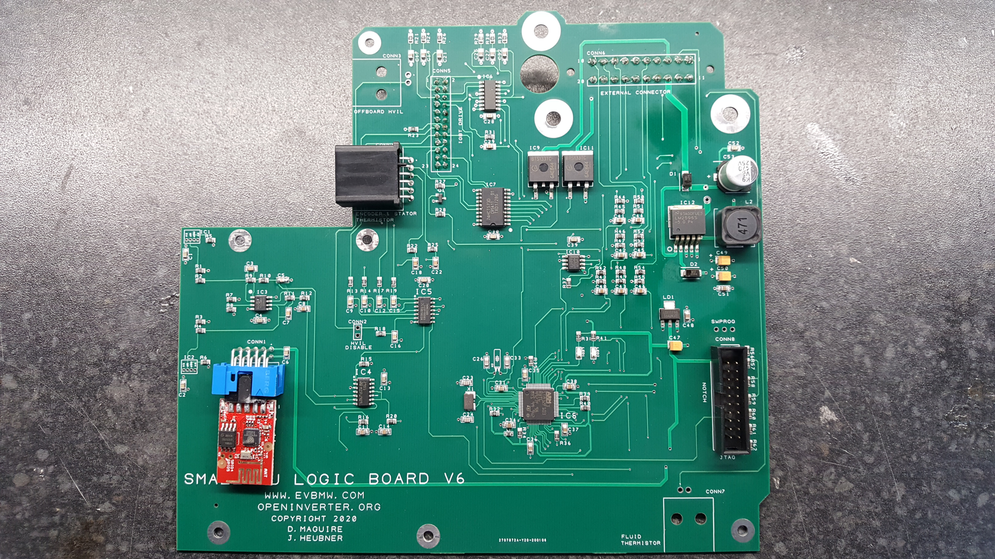

In advance of releasing the new boards for sale (with significant price drops) I decided to make a video detailing exactly how support works for Tesla and other logic boards from the evbmw webshop. I would encourage anyone considering a purchase to please view this video and ensure you are comfortable and familiar with the support structure around these products.

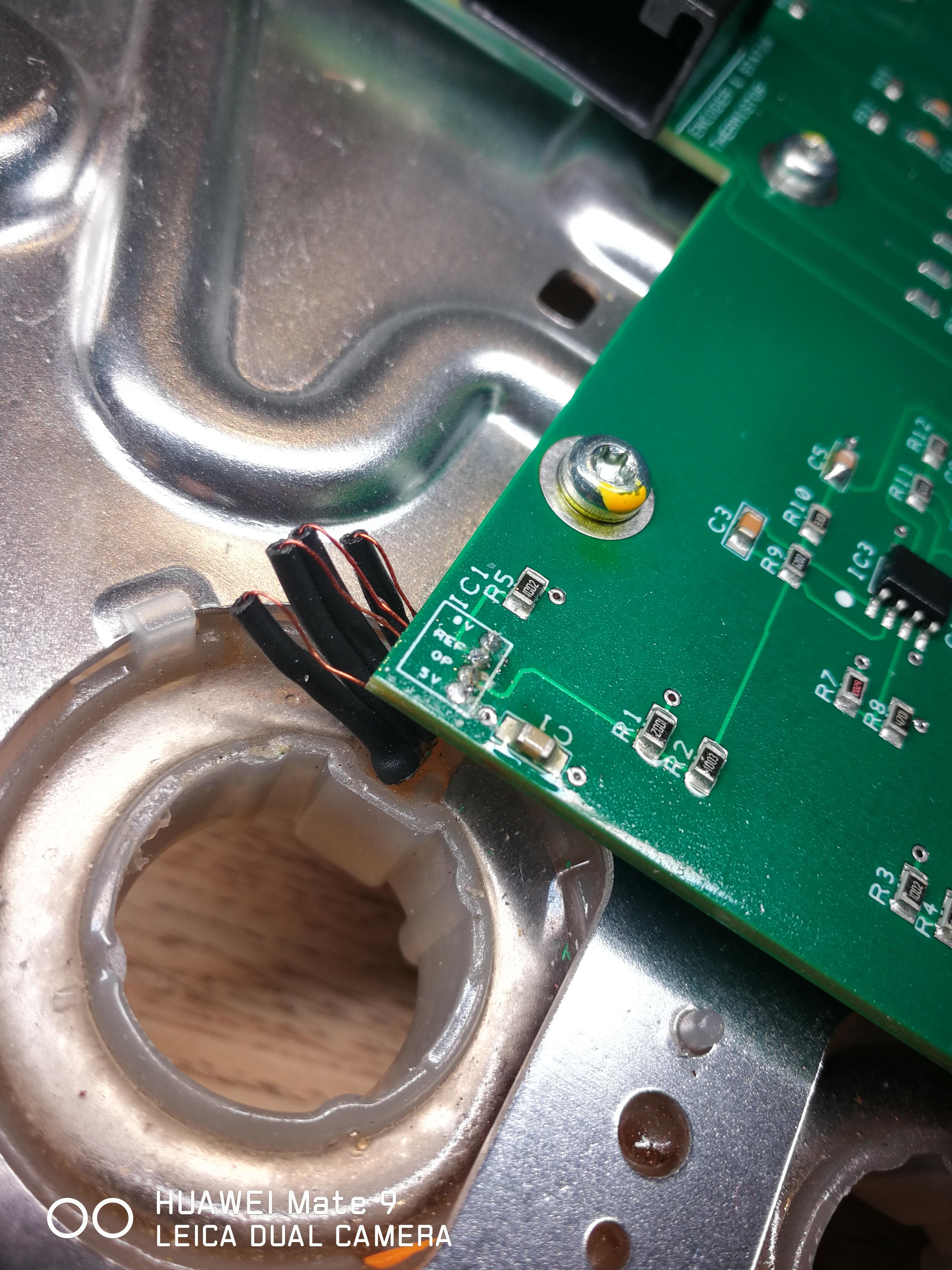

- nesto1972
- Posts: 48
- Joined: Sat Jan 11, 2020 7:14 pm
- Location: Austria
Re: Tesla Small Drive Unit Support Thread
Ok i bridge HVIL and tryed again but din_ocur still on error.
Inverter is only on 12 Volt and not connected to Motor or encoder ,no HV!
The messages are:
(1) warn:PWMSTUCK
(10) warn:HICUR0FS1
(10) warn:HICUR0FS2
(501)Stop:Precharge
Are the HICUR0FS the sensors? i checked again one coil is 3.75kohm the other around 12kohm!#
The pins of the sensors i extended after 1 hour of trying putting back into the wholes!
So should i continue with building low voltage side for testing or is this a major problem wich have to be solved first?
The messages are:
(1) warn:PWMSTUCK
(10) warn:HICUR0FS1
(10) warn:HICUR0FS2
(501)Stop:Precharge
- Posts: 4000
- Been thanked: 1114 times
Use a dc voltmeter to check you are getting 5v to the current sensors and getting 2.5v out from them both.
- Kevin Sharpe
- Posts: 1339
- Location: Ireland and US
- Been thanked: 10 times
I'm not aware of anyone having these problems (I've assembled a few SDU's) and I suspect something else is going on
- Posts: 4000
Also, check the value of ocurlim.
- nesto1972
- Posts: 48
- Location: Austria
I measured on both sensors the same!
5V: 5V
OP:2.5V
REF:0V
5V:0V
ocurlim: minus 1200 A
led 1is blinking,led2 on
5V: 5V
OP:2.5V
REF:0V
5V:0V
