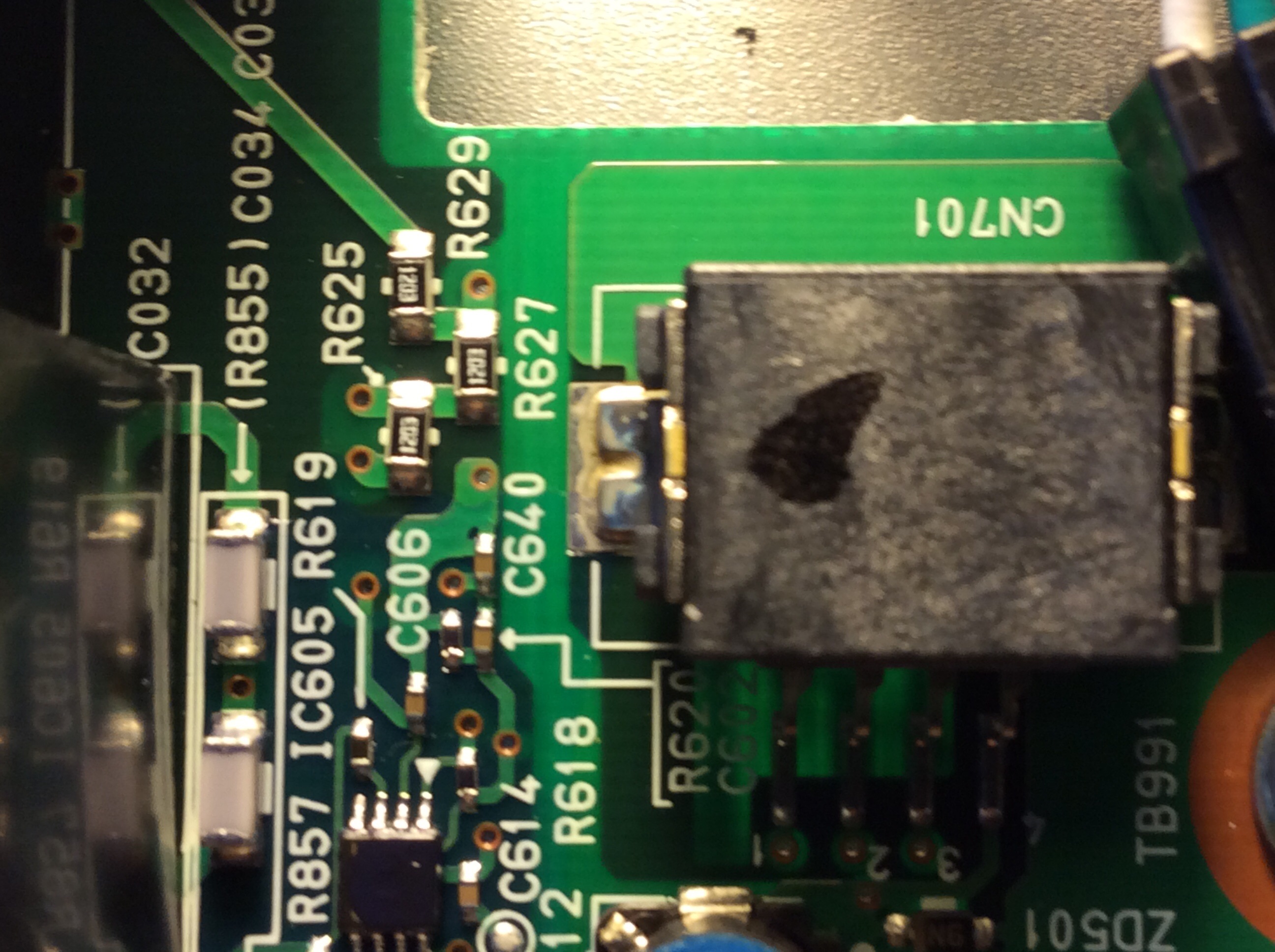

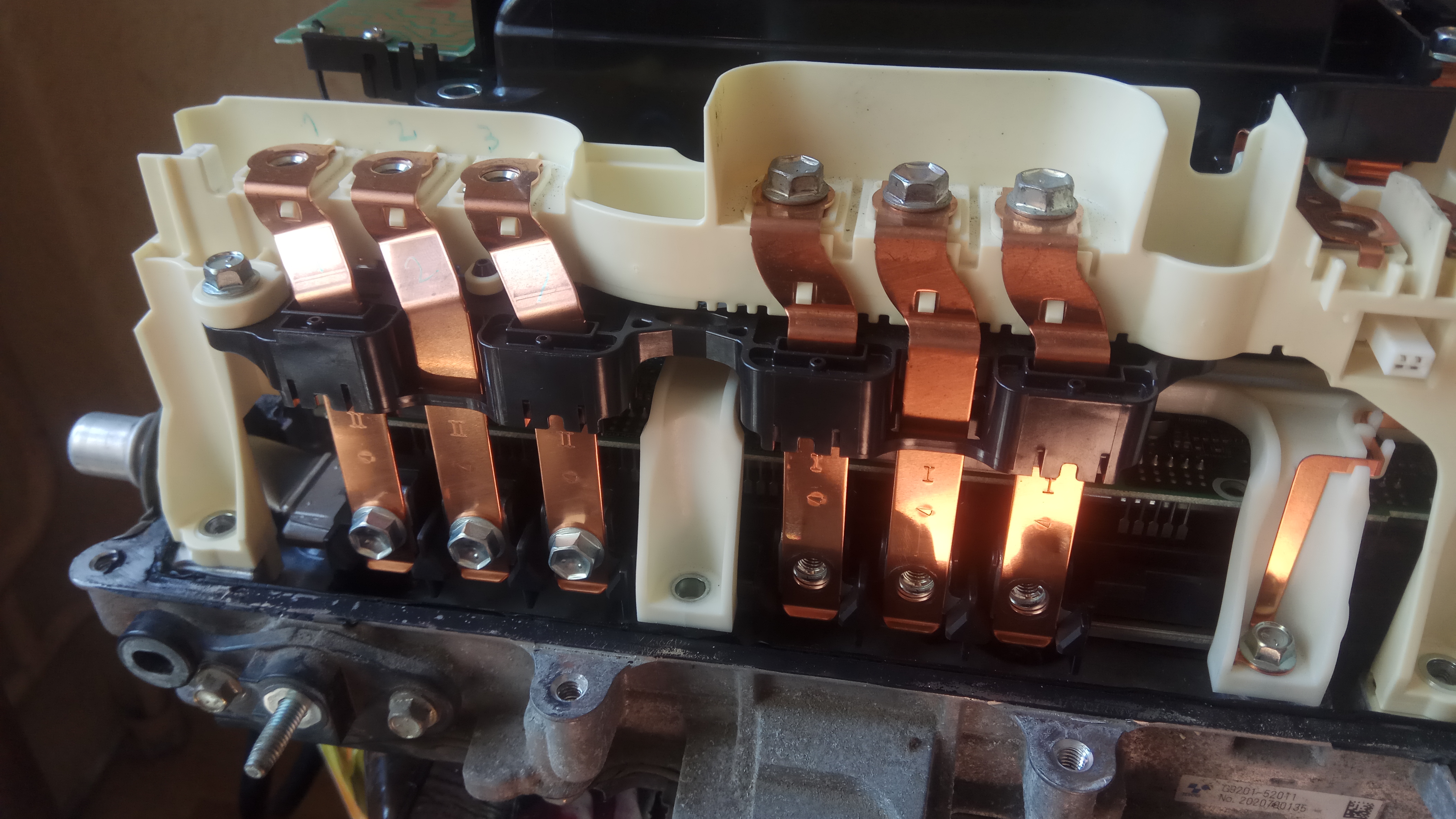

Hello comrades. Please tell me where on the inverter U V W? In my photo 1 2 3.
I cannot spin the motor and determine the sine cosine of the resolver.
In sine mode, it spins, but in foc it just barely twitches and immediately the light is on. I tried all pairs of resolver. Motor - MG1 from Prius11.
Battery 110V via light bulb (40w 220v)
Another question - is it normal that the angle goes through two cycles from 0 to 360 on the chart in one rotation of the motor? (I tried different combinations of pairs of fields, I was not able to match the cycle of the motor and resolver.)

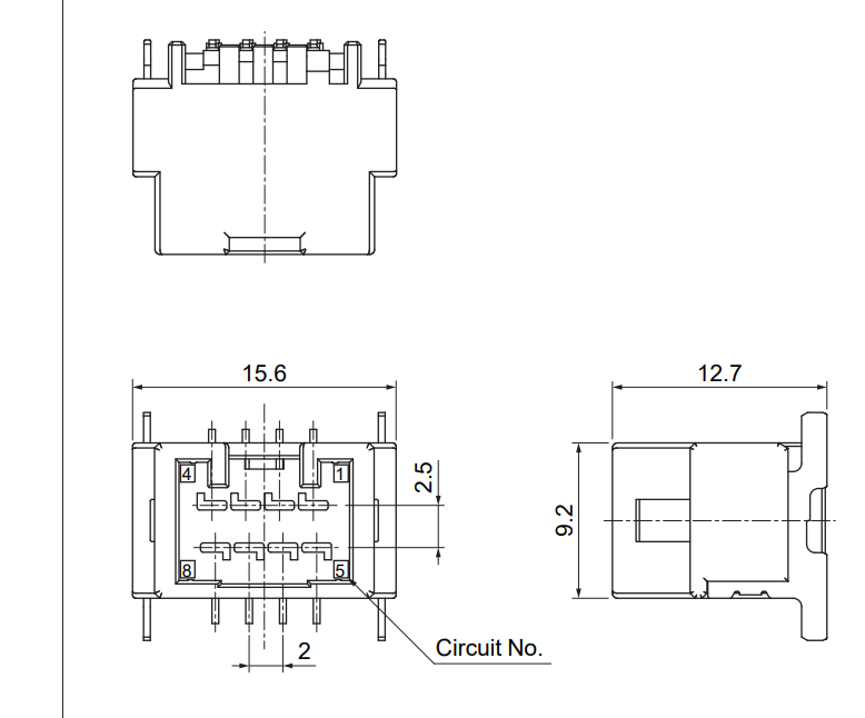

Does anybody get the Block IV to work well? How the MG1 curSens connector notch should be placed? As marked on the board or rotated?

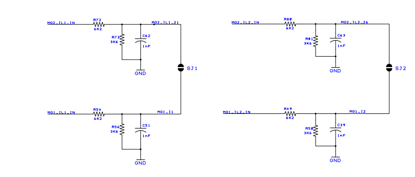

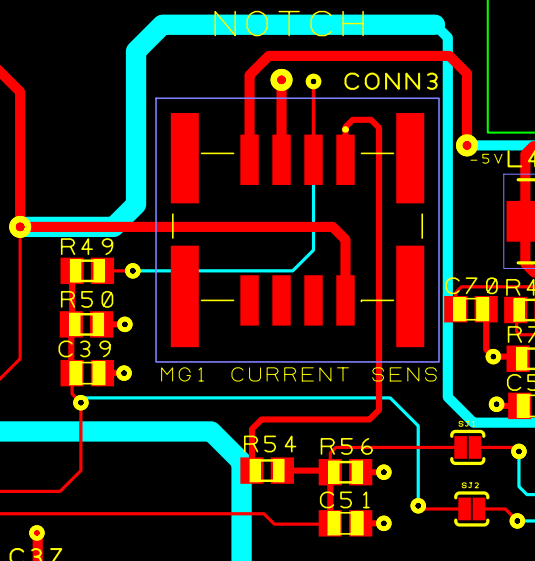

chuuux wrote: Fri Jul 23, 2021 8:03 am Does anybody get the Block IV to work well? How the MG1 curSens connector notch should be placed? As marked on the board or rotated?
I have not run the Block IV board my self but starting with Damiens github for the block IV, linked below, and then looking in the schematics and PCB for the MG1 current sensor connector, CONN 3, BM08B-CPTK-1A-TB.
https://github.com/damienmaguire/Yaris- ... are/Block4
CONN 3, schematic
CONN 3, schematic
MG1_IL1_IN connected to R54
Follow conductor from R54 to CONN 3, pin1 at upper right corner
Then in the connector datasheet:
https://www.mouser.se/datasheet/2/564/eCPT-334507.pdf
Upper right corner is pin1 with this orientation

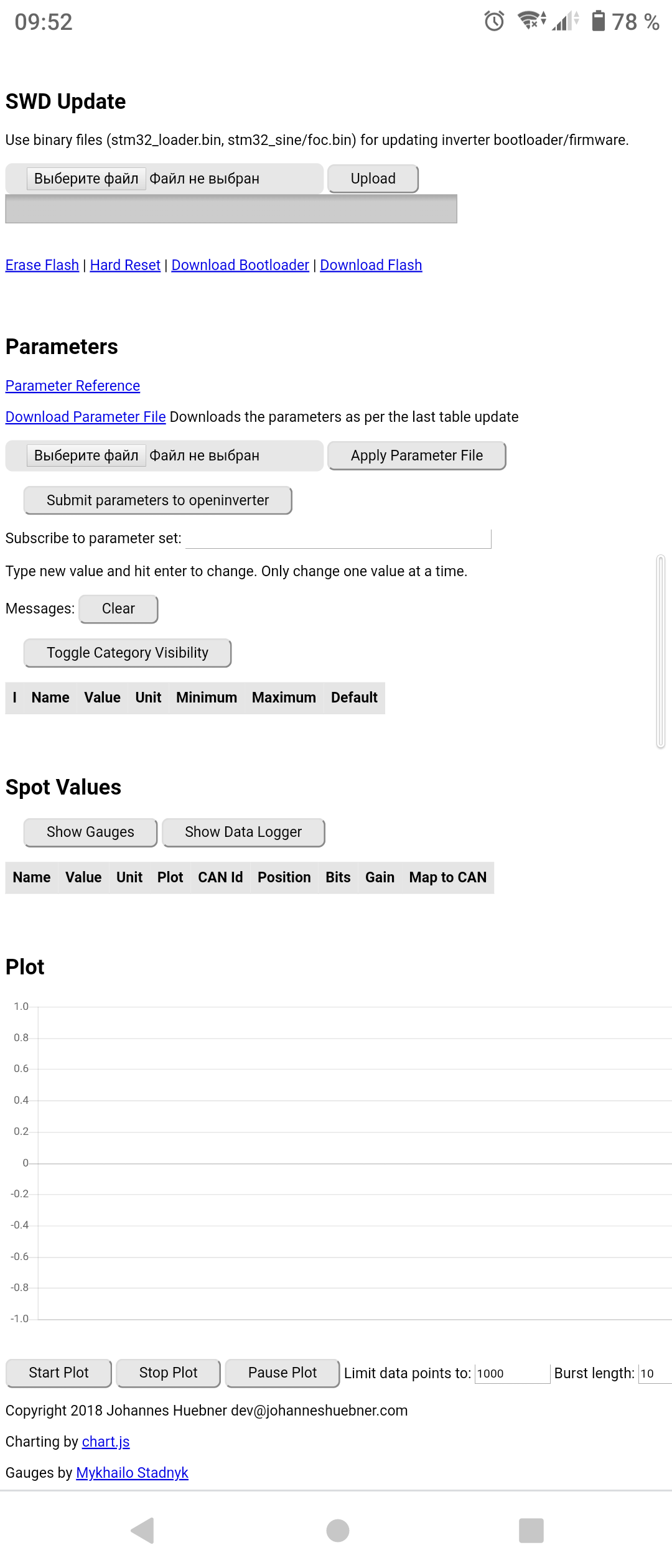

I try to solve the issue. When I'm connecting the Wemos as the altermative wi-fi module (without Olimex) logic board supply current increase over 1A and the Wemos becomes increadibly hot quickly but works.

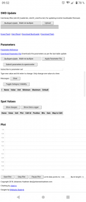

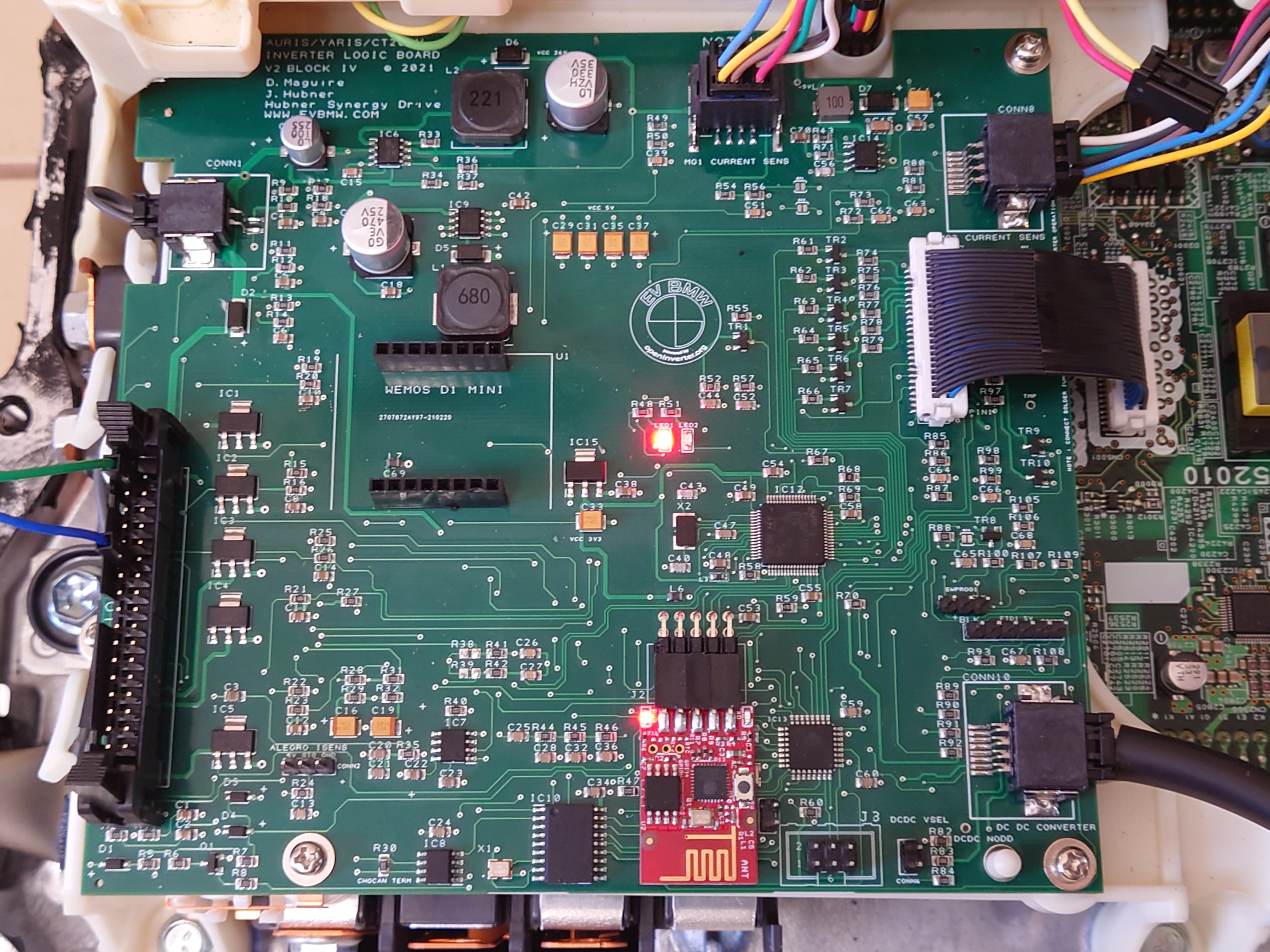

chuuux
Posts: 68
Joined: Fri Mar 12, 2021 5:11 am
Location: Ural
Re: Toyota Auris and Yaris Inverter Logic board
Post by chuuux »
konstantin8818 wrote: Mon Jul 26, 2021 6:19 pm
chuuux wrote: Sun Jul 18, 2021 8:34 pm Hi. Did you find it out?
Hi. At the moment I'm tooooo busy at job. No time to visit forum. Damien answered he forgot jumpers, so removing resistor is the way to switch to resolver. I haven't time to work with the board at the moment as well.
Thanks for reply.
Unsoldered them.
Anybodody know why the web-interface doesn't show any parameters from the inverter? It looks empty.
I've checked all the voltages on the logic board, flashed the board (led is blinking), flashed the Olimex.
Wi-fi is connecting only in Static IP mode, phone and PC can't get the IP-address in DHCP mode.
What should I check?

Posts: 100
Location: Ural
Has thanked: 15 times
Been thanked: 16 times
Post by midway »
Most likely, the file system is not flashed into the wi-fi module. Or there is no connection with the Stm32 processor.
Step by Step using Arduino IDE
Add https://arduino.esp8266.com/stable/pack ... index.json into Additional Board
Go to Boards -> Board Manager and install ESP8266
Extract the esp8266-web-interface software to your Arduino projects directory
Create a new folder named data
Move all files except FSBrowser.ino to the data folder.
Choose Olimex MOD-WIFI-ESP8266 as the board
Upload the code using the Arduino IDE
Use 'ESP8266 Sketch Data Upload' from the Tools menu, this will upload the files in the data directory to the ESP8266.
