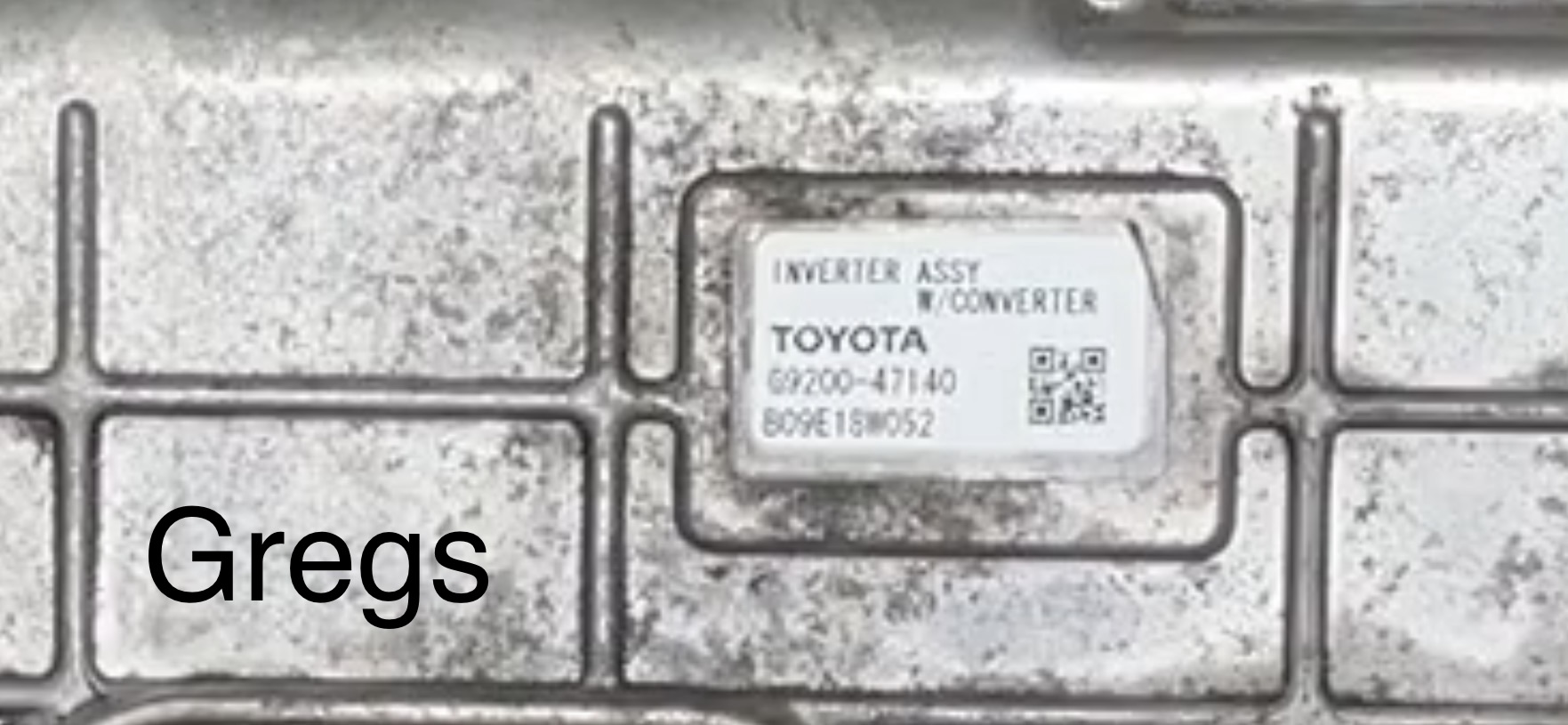

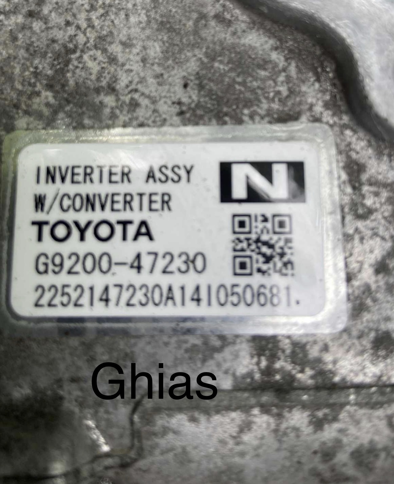

tom91 wrote: Thu Jan 08, 2026 6:43 pm Is all the 12V to the inverter via that relay?
If the issues remains like it does need to confirm what inverter Greg has in his rabbit and what firmware was used as a base for testing on it (yes I did write it but its a while ago).
Yes all the 12 volts is via the relay to the inverter.
The two inverters
Greg thinks that it was either version 2.17 or 2.19 with a in between custom release that you sorted out for him.
Thanks Tom

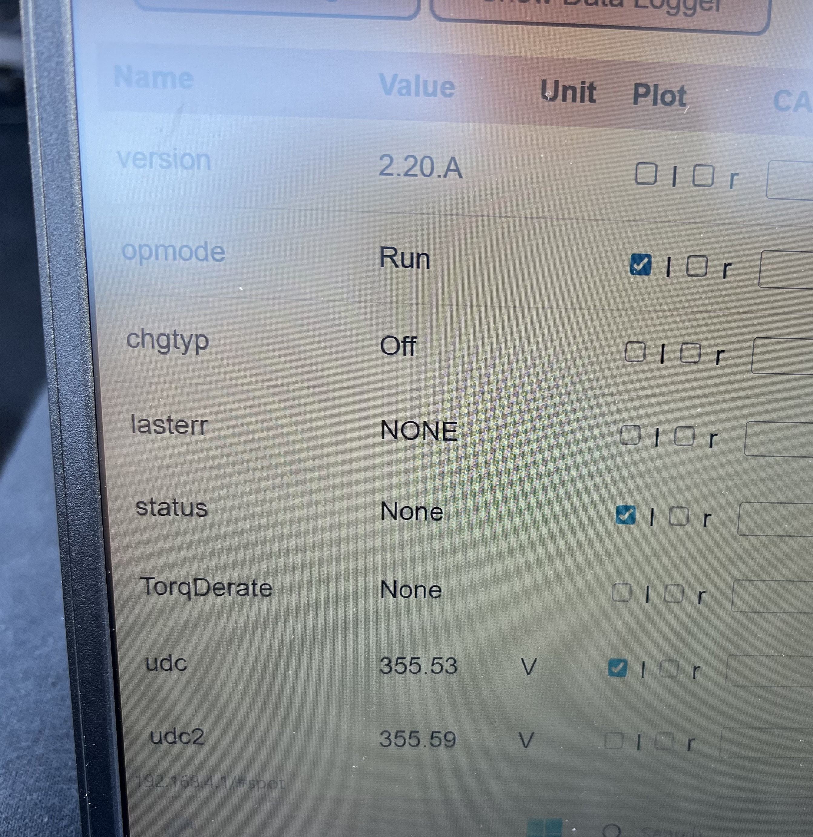

I sent 2.20A logs and parameters to perplexity.ai to see what advice could be had.
This is what I got…
Is any of it worth trying/following up on?
With a Prius Gen3 inverter and BMW safety box, the fact it ran on 2.15A but not on 2.20A almost certainly points to a configuration / input‑mapping change rather than a hardware fault.​​

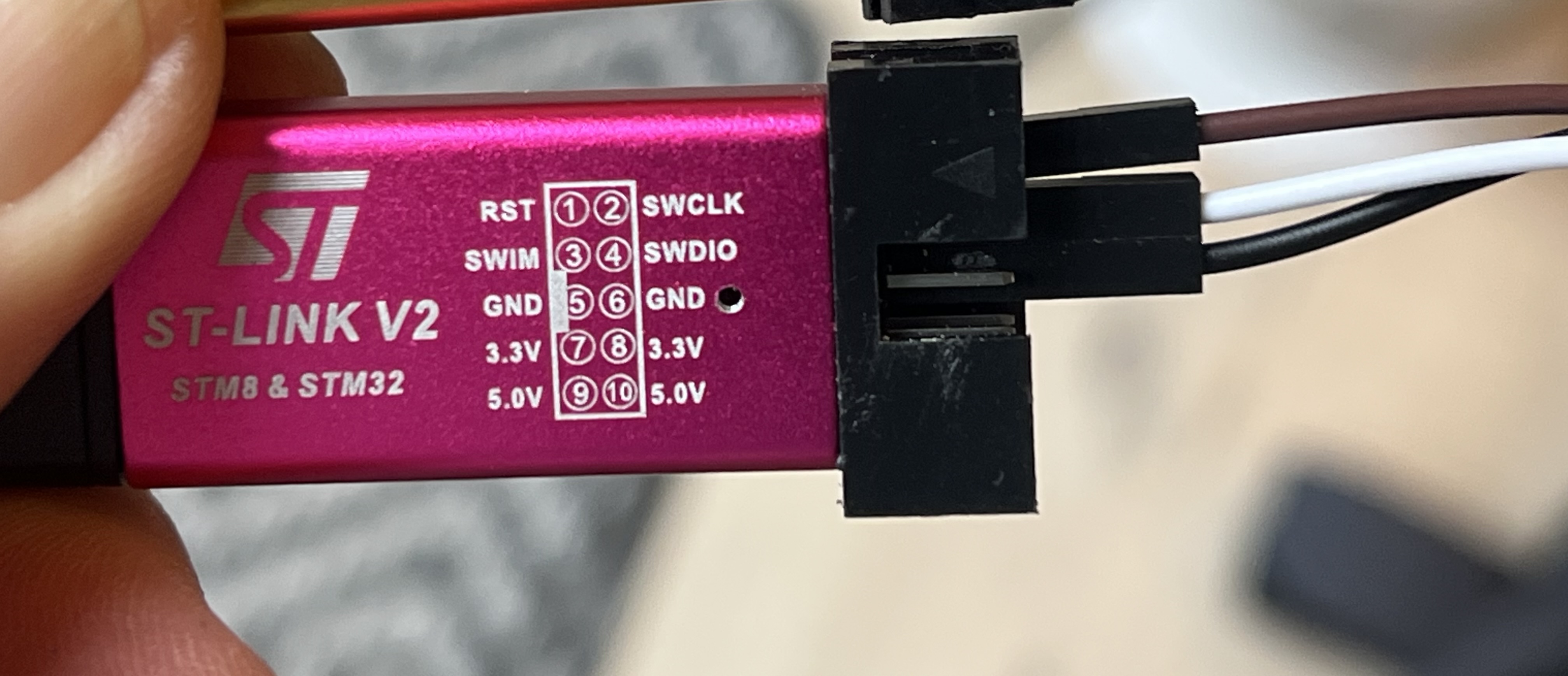

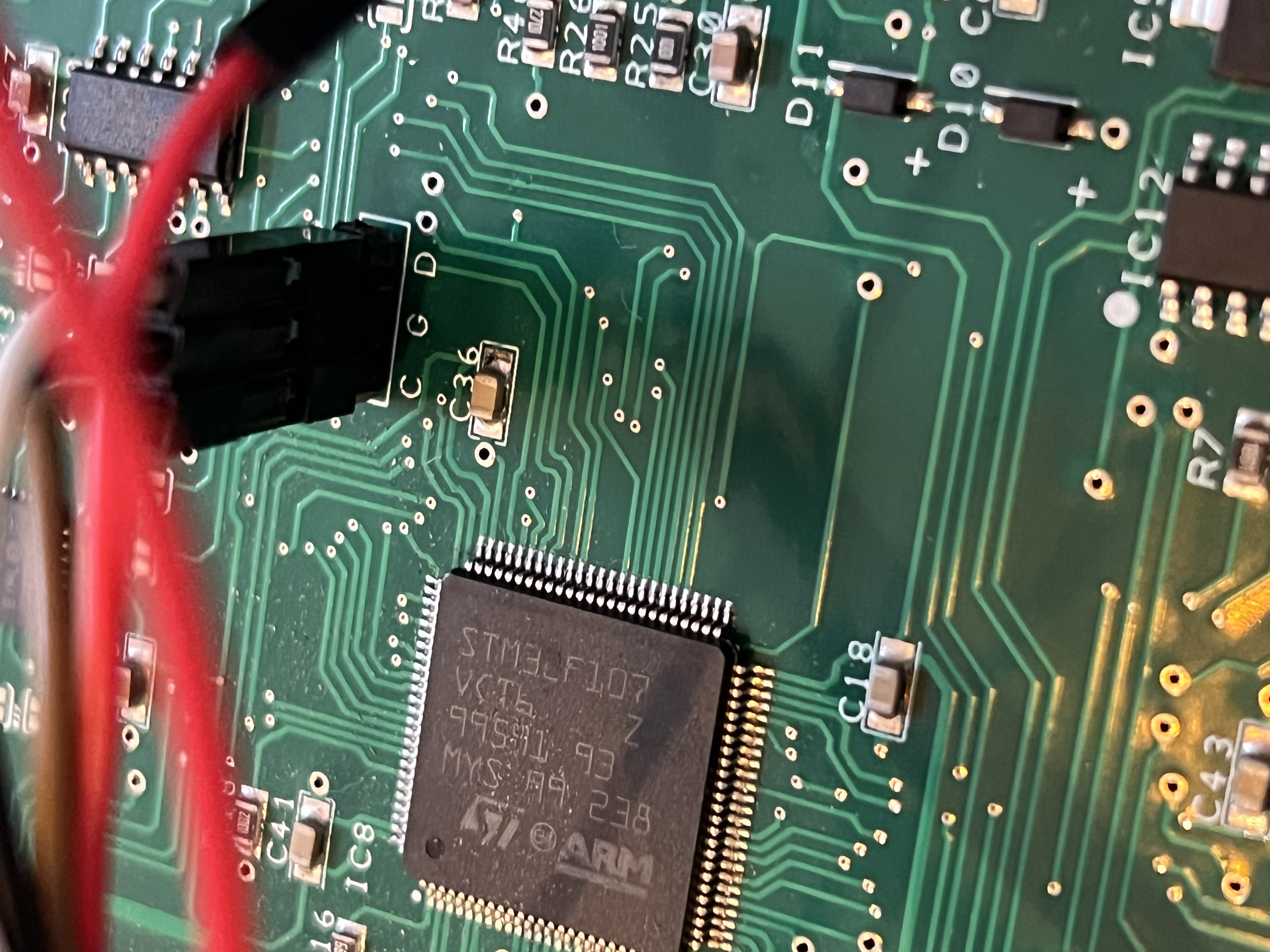

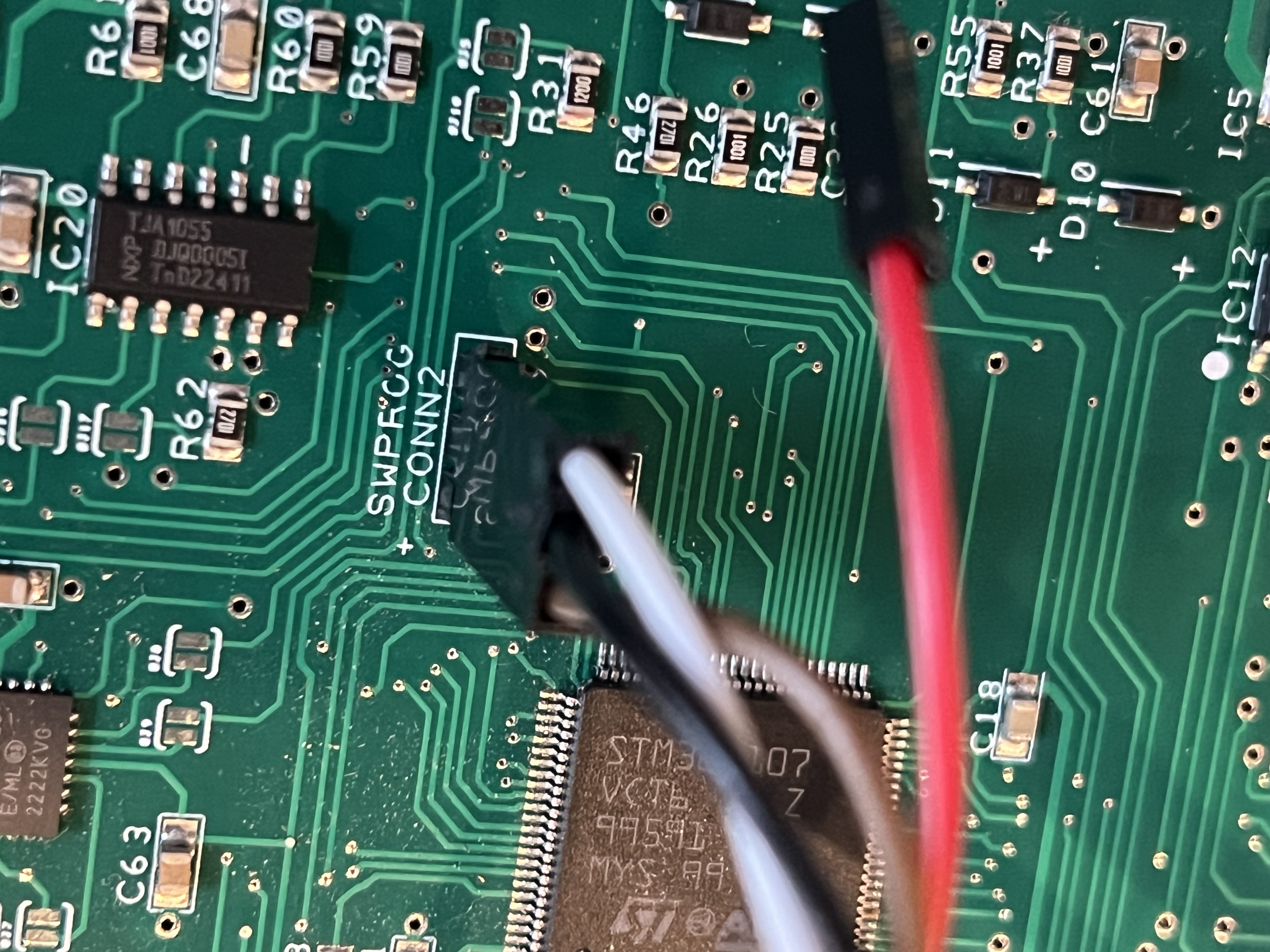

Thanks, Greg suggested that I check if my HSDN wire from the inverter is connected to, he thinks it goes to the Park signal from the transmission safety neutral.
How would I go about checking this out?

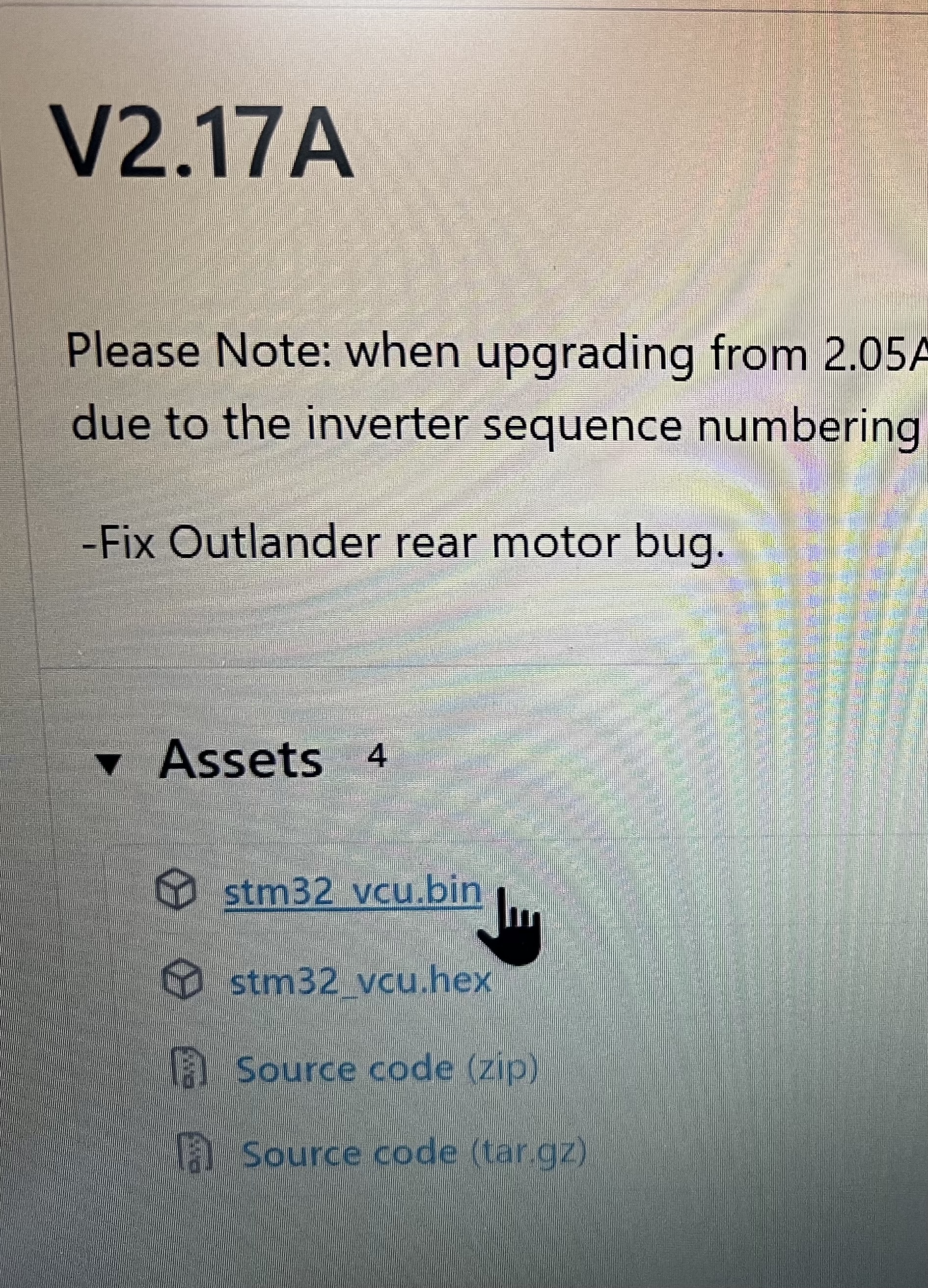

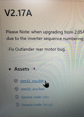

Please try version 2.17 https://github.com/damienmaguire/Stm32- ... /tag/2.17A
I can spin you a "testing version" that reverts one change made between V2.17A and V2.20A just to review if that helps.
Since you can now use an ST-Link it makes this easier to do without bricking your Zombie.

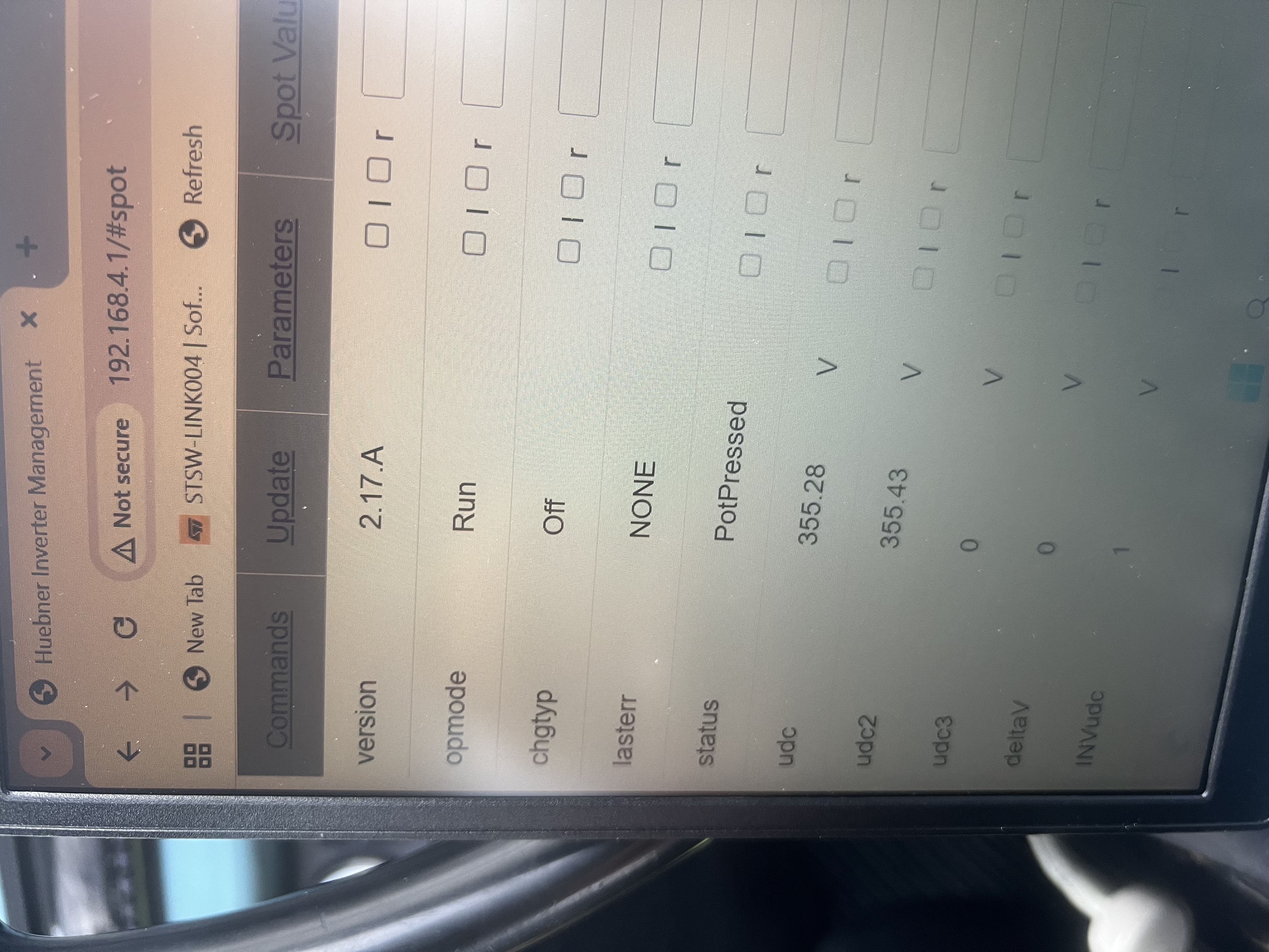

So I upgraded to 2.17A and it showed up in spot values as 2.20A!
Selected Prius 3 and restarted Zombie.
Selected manual and BMW Sbox… looked like it wanted to run but doesn’t
move.

Please try flashing V2.17 with the ST-Link

Used the hex file and uploaded 2.17A.
Changed parameters;
auto to manual, BMW Sbox, Prius 3
It moves! 🙂
Will go for a drive later and get some logs

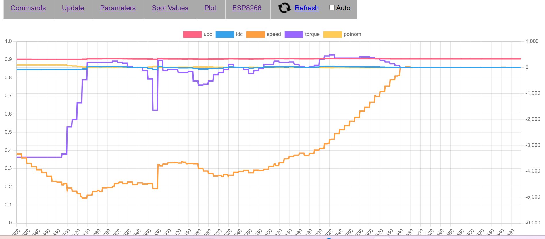

Posts: 2962
Has thanked: 328 times
Been thanked: 847 times
Re: Unlocking the power/torque of Prius gen 3 drive train?
Your logs are very short so not alot to see beyond you can drive it and command torque.

Hi Tom, got the bin file but it didn’t upload so I’m going to have to ST link.
Would you please resend the hex file as I couldn’t find it?

Went for a drive on V2.17A and plotted this 🙂

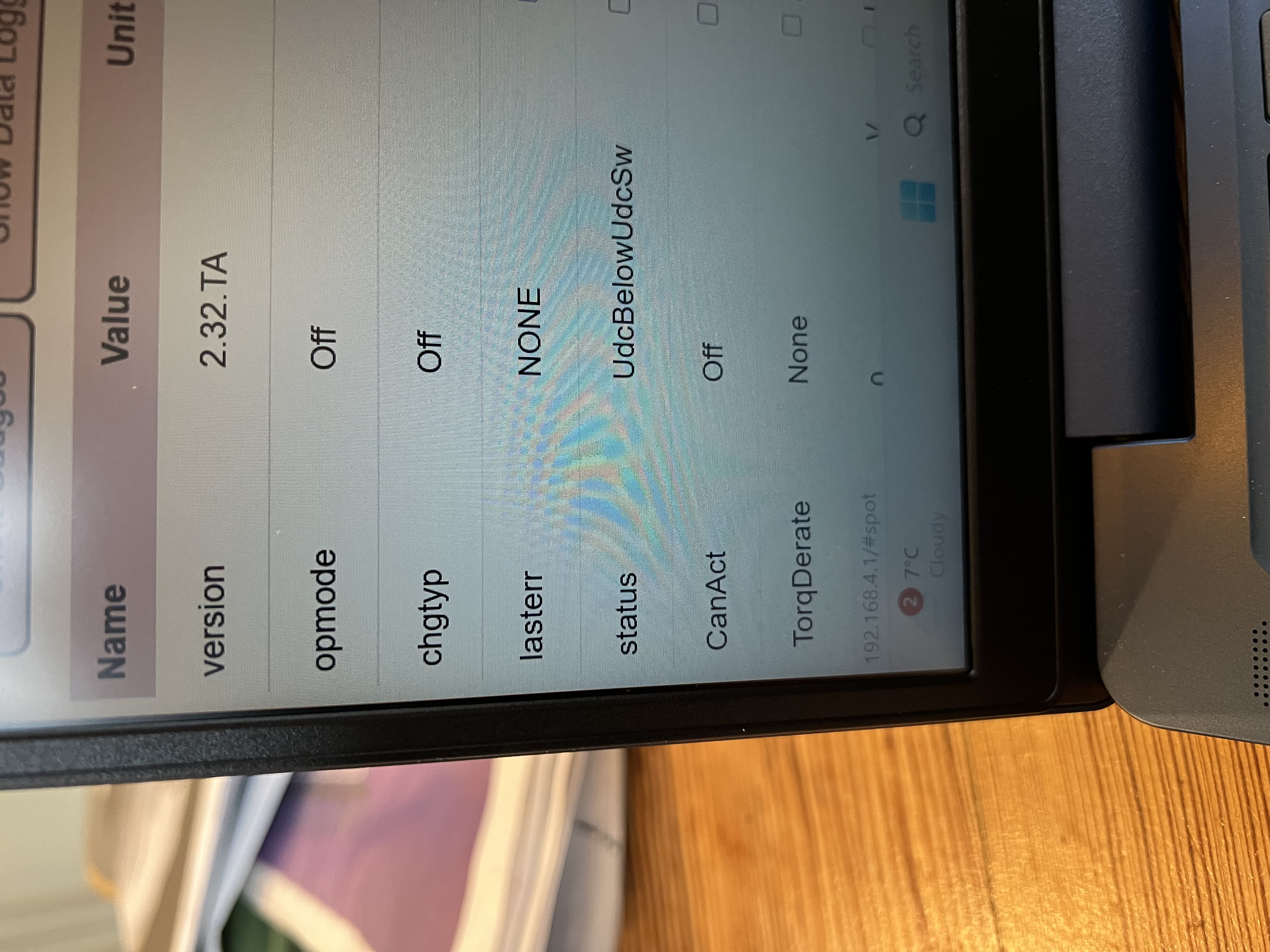

Hi Tom, will you please resend the V 2.32.TA HEX file as I don’t seem to be able to find it and I’m bricked again?
Cheers Les
Ghia66
Posts: 170
Has thanked: 749 times
Been thanked: 65 times
Post by Ghia66 »
Installed and changed parameters Prius G3 and BMW Sbox.
It works! Thanks Tom you are a genius!
