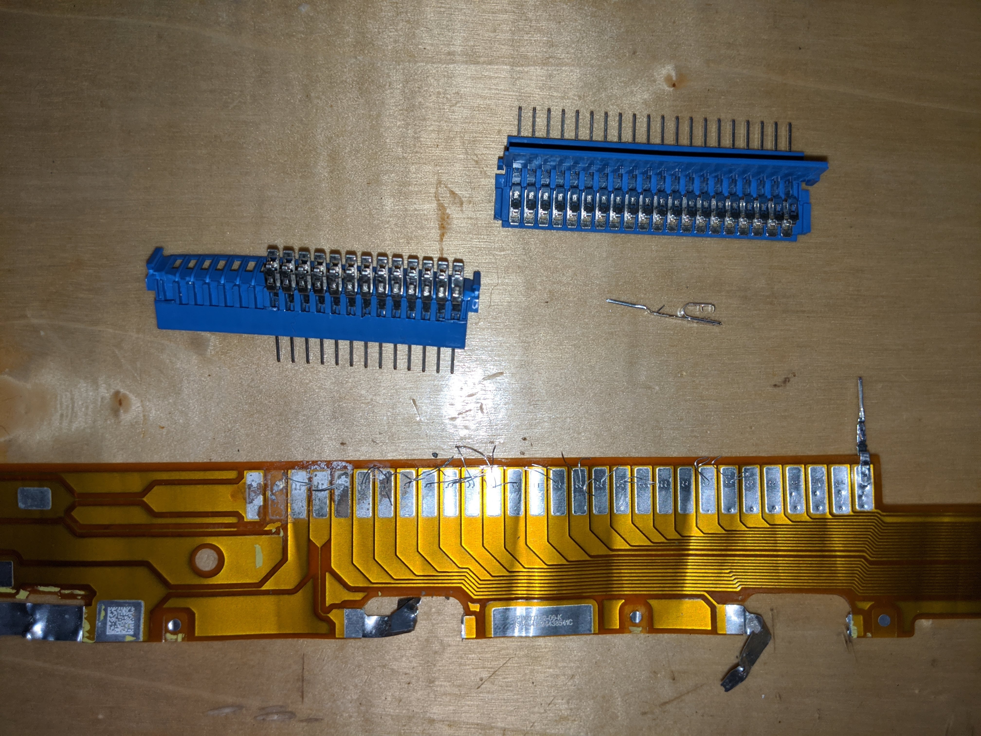

I thought I would share this here, as an aside replying to the prior discussions about using edge connectors with the flex pcb cables on these modules. This is a photo of a partial solution, tested on a spare flex PCB from eBay.
As excited as I am following the developments towards decoding the Tesla model 3 BMS, my final pack assembly is happening in the next month, and therefore I am going with an off the shelf BMS... in order to simplify the wiring process I have been searching for a solution for connecting to the flex PCBs directly, and this is what settled on.
The blue connector is an Amphenol Flat Flex Connector (digikey PN 609-2193-ND). The contact is ideal, a very secure flat crimp insulation piercing design, but they are only available in 2.54 mm spacing connectors, while the Tesla flex PCB is 3.5 mm spacing. Therefore my plan is to remove the contacts from the connector and solder the pins into a PCB laid out for the correct spacing, designed to connect the flex PCB pads to a board mount connector for the BMS cell tap wires. The PCB will slide in behind the flex cable and provide a rigid backing for carefully crimping each contact.
Hopefully this helps someone! When I finish the pcb layout and test the boards, I will post the eagle and gerber files online somewhere to share them.

I would prefer to solder additional cables to the original board to use any BMS. Later, when the BMS has hacked, you can remove the cables and reactivate the tesla boards.
