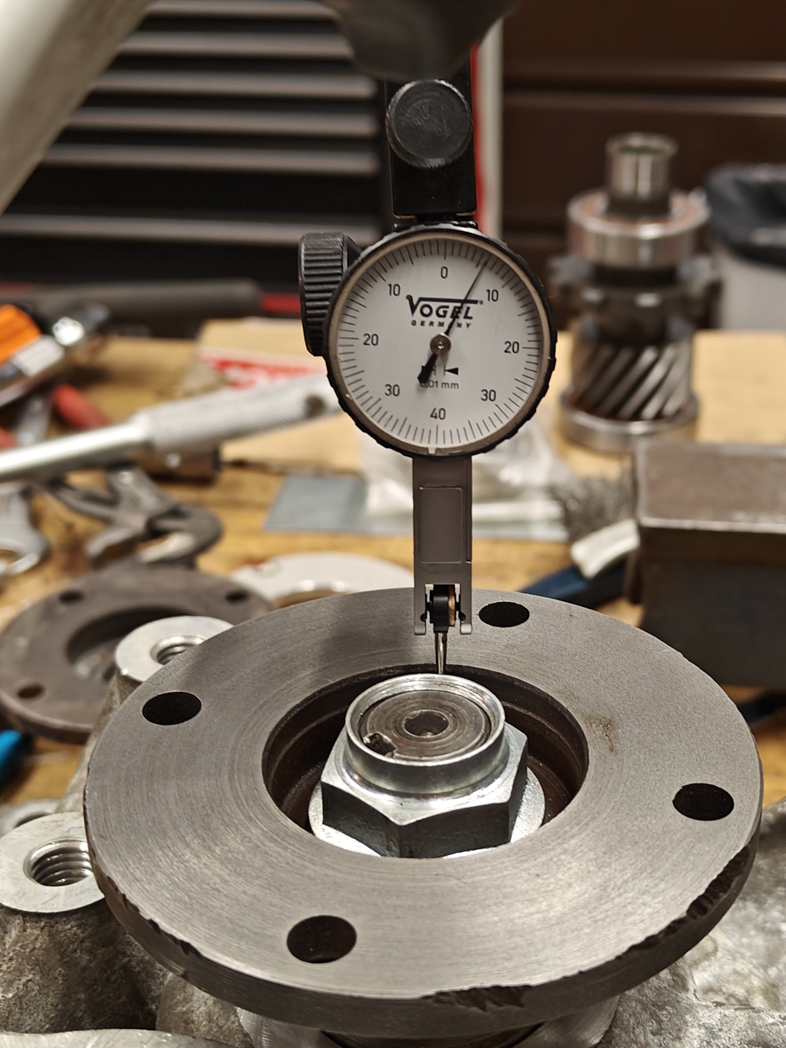

Pinion flange out on the second half of the Leaf case
Had to make a sleeve to match Leaf bearing size
This one has a lesser case of the weeble wobble. Dial indicator zeroed to minimum and here the max

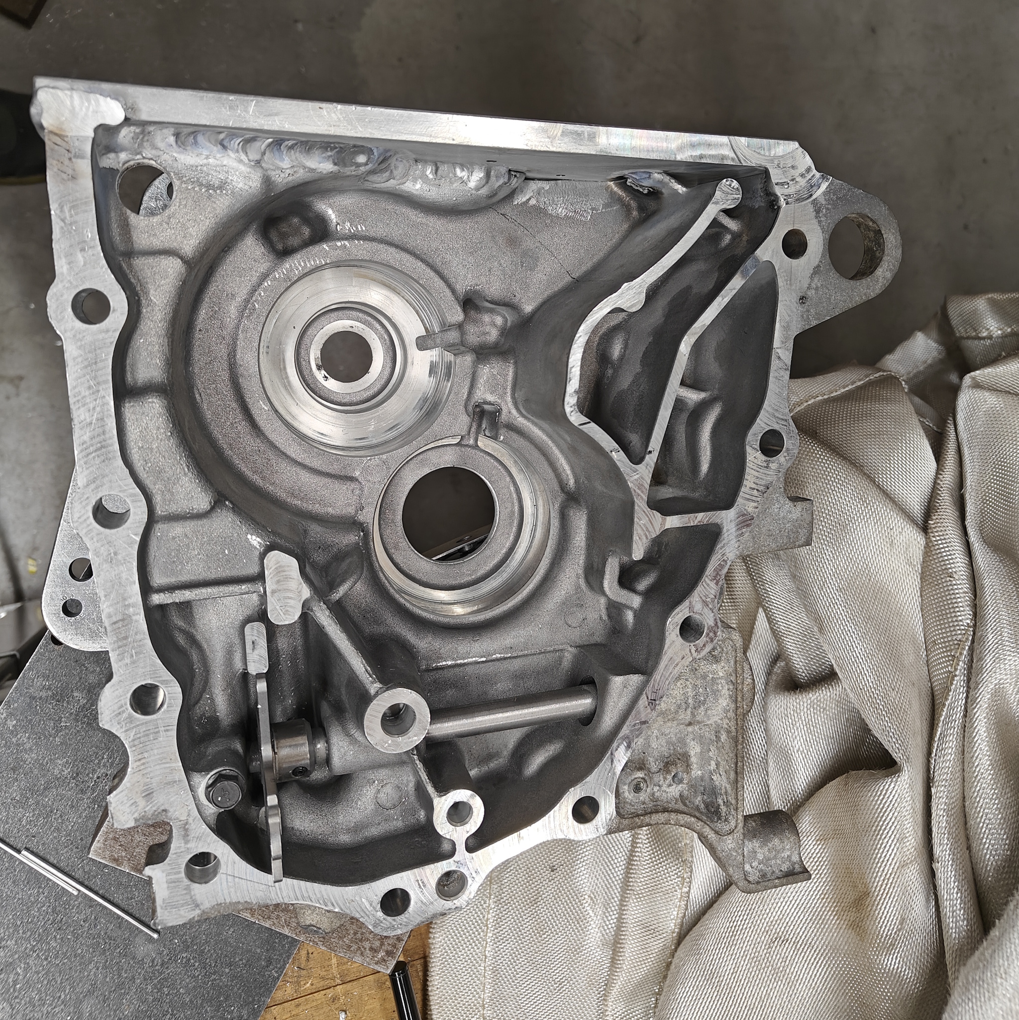

There even should be room for a longitudinal support beam to reduce the back and forth movement of the Leaf stack
Test fit to see whether the case was chopped from the right place and that there is clearance
Then recently on the table, it has been welding
Welding
And welding
This should keep the oil in, so I can have the Leaf mechanikal park lock mechanism and the bearings in a proper oil bath.

nice work. looks like you still have provisions to interface to the intermediate gear if you wanted to.
i have a case cut roughly the same, but planning on welding a splined shaft of the intermediate shaft to direct drive the rear diff in a truck. when welding up the case, did you assemble the 2 halves, with the added material to get the matting faces to fit properly, then weld or did you post machine them?
Re: [DRIVING] Project Rising Sun: Suzuki SJ410k meets Leaf full stack
Posted: Sun Oct 19, 2025 7:28 pm
by J0hannes
Bratitude wrote: Sun Oct 19, 2025 7:08 pm nice work. looks like you still have provisions to interface to the intermediate gear if you wanted to.
Thanks!
I left material on the halves and still need to machine the surfaces to make it fit.
I figured that if I would have attempted to weld it assembled, I probably would have ended up needing to machine these somewhere anyways.
Yeah, actually thought about it that way, if it would still feel like I need more gearing, I could also use the intermediate shaft as output :)

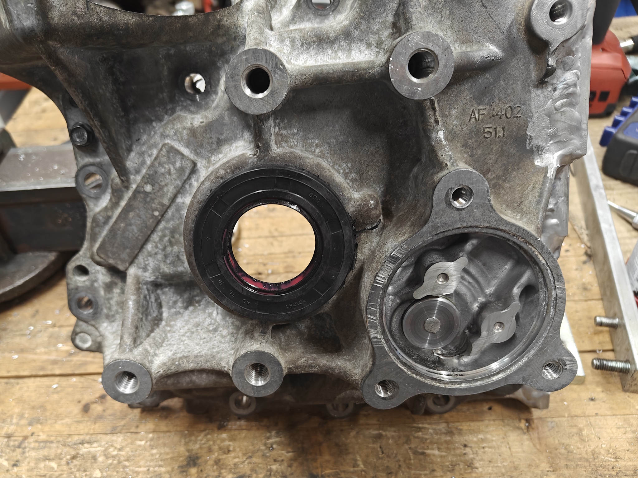

Added a connector for breather line
Eventually figured out that the bearing size matches Suzuki differential pinion seal OD on the other end of the motor intput shaft, so ended up boring out the whole end
Plugged the intermediate shaft hole for the carbon contact
Now the circlip stopping the bearing has double duty as the seal rests against it fron the outside. Noticed that not all year models have this circlip, but the machined groove for it seems to be there
Measured the oil needed to fill case to about the bottom level of the input shaft bearings and put the numbers somewhere I can find them when needed :D
This was a really thick seal, so thick that it actually rests against the shim plate I added for the longitudinal support mounts
Machined a pocket to an otherwise unmodified pinion flange, now the flange neck goes further down and meets the bearing inner race (and makes a proper contact on the seal)
A mock up of the longitudinal support, to give an idea. Should mount up nicely to the transmission mount location
Case closed :D
