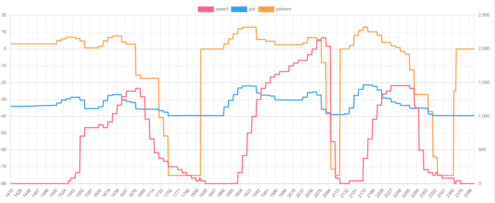

Could be! Though I don't understand that graph. Would be nice to have one line for speed, one for pedal pressed % one for actual throttle % (ranging from maxregen eg -70% to max throttle 100%).muehlpower wrote: ↑Sat Nov 18, 2023 11:33 am That's exactly what I suggested here: viewtopic.php?p=59989#p59989

Mane2 is focused on the throttle transition at low rpm and has a flat regen over that.
Muehlpower is talking similar but instead of the regen being flat, it tapers regen up with speed.
2 similar but different things that I think would be great additions.
I think you'd have to define a regen low taper speed and regen amount, high regen taper point (max rpm) and regen amount. If you set both low and high regen amounts the same is flat with speed. Could cover both a consistent regen amount and a speed variable regen that way.

I don't understand your graphic either. I only do regentravel linearly depending on the speed or RPM, up to an adjustable speed. Above it remains at the set value. This means, as in my graph, if regentravel is set to 50% and regenRPM is set to 100km/h, everything above 100km/h accelerates over 50% pedal travel, and everything below that is regenerated.
At 50km/h acceleration is over 25% and deceleration under 25%. At 2km/h acceleration is over 1%, deceleration under 1%, etc. At any speed, full acceleration is at 100% pedal travel, and at 0% the value set with ofthrotregen is reached. Of course, everyone can choose the values themselves.
you write
So I added config parameter for speed (maxregentravelhz) where regen is in full power regentravel is at max. It grows linear when approaching defined speed and it goes to zero only when fully stopped.
EDIT: regen % is always at full power - it's only regentravel which gets adjusted. regenrampstr still works. You can see regenrampstr effect in picture where yellow line starts to go closer to 0% after being negative.
That's exactly the same, only regen% is of course not always full, but rather the value set with ofthrotregen.
you write

Ah, now I understand what Muehlpower graph shows. I was reading it wrong, I thought those lines presented different regentravel setting and got confused because of that. It's actually one set of parameter showing how regen and throttle acts on different speeds. Makes sense now.
Seems like it's pretty much the same thing. Just different views of the same idea.

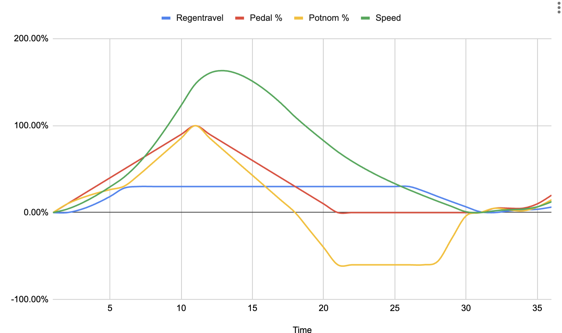

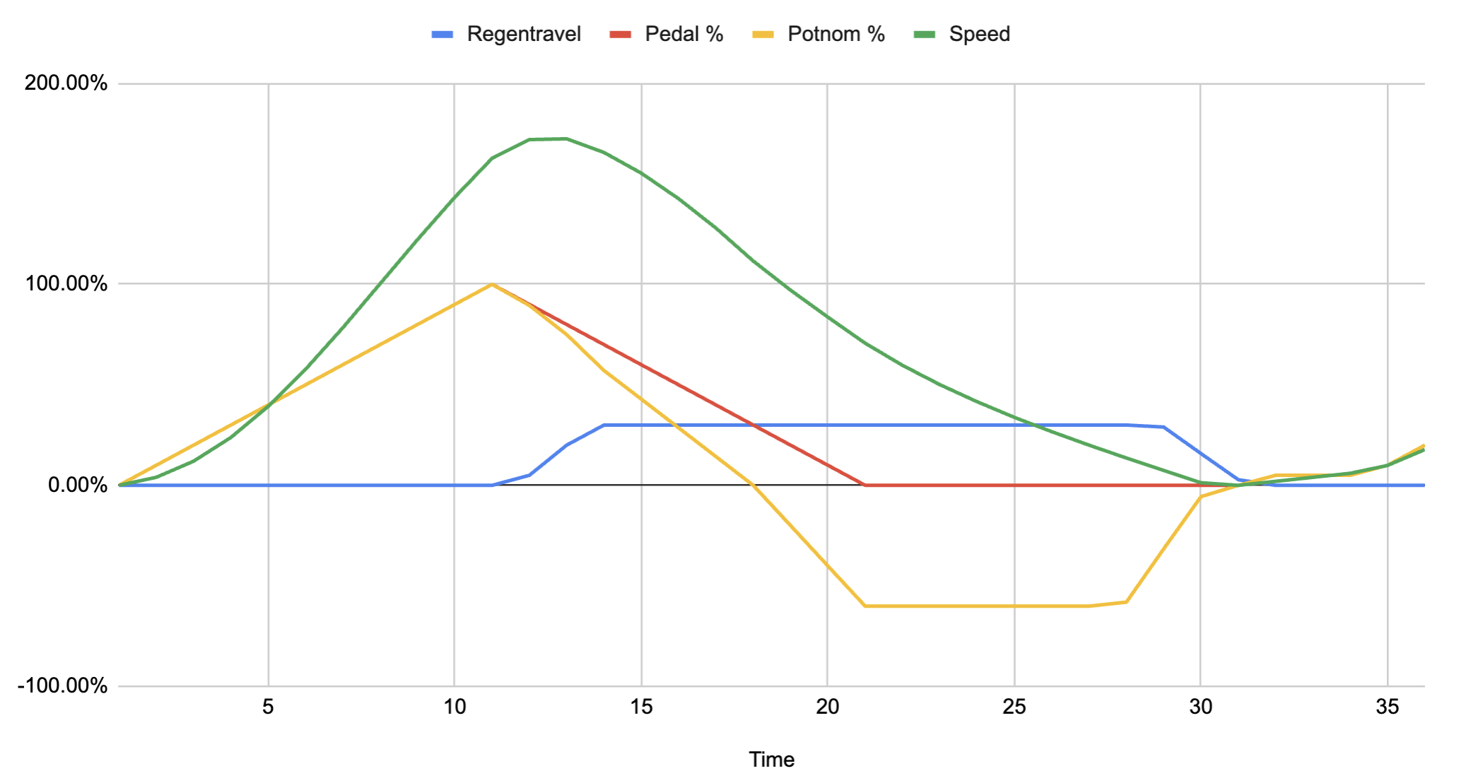

I ran my small simulation with both implementations. To spot the differences, easiest is top copy both to text editor, in different tabs and cycle them.
What happens there is that you press the accelerator from 0% to 50% and then slowly lifting off the pedal until stopped. Then two last values are when car starts rolling down the hill, without accelerator pressed - and then slightly applying throttle.
First one is using this
Second one is using fixed regentravel until car is stopped:
I agree that what muehlpower proposed, is way more simple way to do it, and works very well too. Only difference here is that you get stronger regen with the fixed regentravel and more control for regen but also you need to push bit more on the accelerator to get going again. Both implementations have their advantages.
float brknomDynamic = MIN(brknom * rotorfreq / maxregentravelhz, brknom);Code: Select all

Here's a side by side output for easier reading. potnom1 = "speed based regentravel" and potnom2 = "fixed (only increasing) regentravel until stopped".
In this output, first line shows car doing 67kmh and lifting off the pedal slowly. When the speed slows down to 24kmh, you start to see differences. "pedal" showing the percentage of pedal pressed. hz just show the rotor frequency, for easier tracking when "regen ramping down" (regenrampstr) start to have effect.
Potnom2 gives you stronger regen on slower speeds and more control over as regentravel stays at 30%.
Potnom1 is more linear, as the regentravel shrinks by speed, thus making slow speed regen bit lighter. This can be a good thing, as it seems that numbers decrease more linearly, and it's harder to notice the regenrampstr taking effect.
I like the simplicity of the potnom1 and also the fact that on slow speeds, accelerator goes faster on the throttle side. But it remains to be tested, which feels better in real life. I think there will be difference also in what people prefer. If you like how ICE cars act, you might not like strong low speed regen. In that case, the potnom1 version is probably for you. For more EV style and stronger regen on low speeds, potnom2 -version might feel better.
I flashed the "potnom1" version to my car now. Got my LDU working again too, but unfortunately there is ice and snow out there and with summer tires, there is no business to do any driving. So I can't really say which one feels better yet
Would be nice to have both implementations in firmware and you could switch the version from web interface parameters. Should I do pull request for that? Would that be interesting? There could be 3 versions. One for the original implementation (with dead zone) and these two different ones.
Params: regentravel=30.000000, regenrampstr=50.000000 brkmax=-90.00 brknompedal=-90.00
km/h: 67 hz: 187.5 pedal: 42.0% potnom1: 17.1 potnom2: 17.1

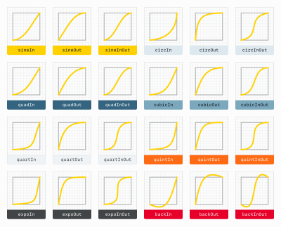

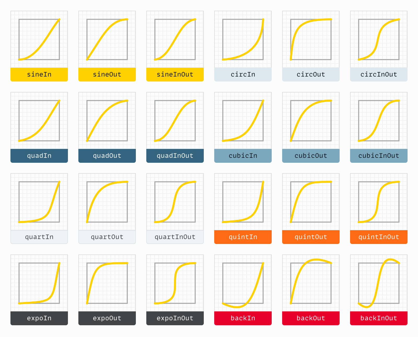

I started playing with the idea of ramping down regentravel on "potnom2" -version, when rotor hz hits the regenrampstr hz. This way, you can utilize the regen area further than just speed based, and still have strong regen if wanted. I experimented few curves, like expoOut and results are interesting!
So, when accelerating, regentravel area grows exactly the same way, linearly on both implementations. But when slowing down, you can see the benefit.
This is linear speed based regentravel version (aka potnom1)
and here is version that ramps down regentravel with a expoOut curve:
This second version - using curve - is smoother and giving stronger regen and more control on low speeds. Regen hits -43 on this second version where on the linear speed based version, it only hits -34.
Different curves can be applied. This expoOut is quite extreme, and regentravel goes to zero only at the very end but makes a good example. Attached different curves for ramping down the regentravel. Those curves ending with Out work the best here.

I was bothered by the fact of that non-linear acceleration - as increasing regentravel creates this slope. I think different OEM cars have done this differently. For example BMW seems to have done this "slope" way (non-linear) but I feel Tesla has linear.
I combined the speed based regen with my previous code where I tracked pedal history. So acceleration is linear until you start to lift. When lifting, regentravel gets created. This way, you can have linear feel when accelerating, and creating that regen-slope happens where you don't notice it. I also ended up removing that curve that I mentioned above, as it's effect was actually minimal.
Here's how it works:
And for comparison, this is speed based regen.
Big difference here is linearly increasing throttle (potnom) and stronger regen on slow speeds (see 25km/h potnom on both).
I feel this might be it. Any thoughts, worries or comments?
Params: regentravel=30.000000, regenrampstr=40.000000 brkmax=-60.00 brknompedal=-60.00

Same examples with graphs.
Notice the yellow line (potnom) in speed based image, potnom grows pretty awkwardly and non-linear fashion. You will feel that at some point the acceleration picks up quite quickly, when regentravel has grown to full.
Also notice the blue line (regentravel), for example around time 29s. In speed based you have just few percentages of regentravel to control low speed regen compared to other graph, where you have stronger regen lower speeds and more control over it.
Here's the one with regentravel growing when lifting accelerator and decreasing regentravel linearly when hitting regenrampstr (hz).
Here's the version with just speed based regentravel. Parameters: Regentravel 30%, regenrampstr 40hz, brkmax & brknompedal -60%.
With latest stm32-sine release (v5.32.R), blue line would be at 30% constantly and pressing accelerator the first 30% of travel, would give you negative or 0 potnom and potnom would grow and decrease linearly after that.

Attached a plot from my test.
Not related to code changes - but if you're wondering - wheel start rotating only when potnom is higher than 6%. I've tried to overcome this by increasing ampmin to 18. But increasing that closer to 20, it starts to accelerate by iteself .. so I had to tune it down from there. Not sure if this is a issue for everyone, or just me? So even with zero deadzone code, it requires some 5% pedal pressing before anything happens. I'ld like to get rid of that if possible..?
