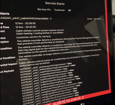

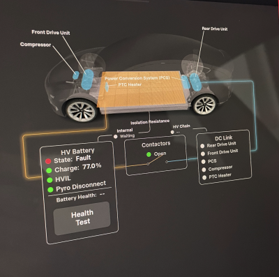

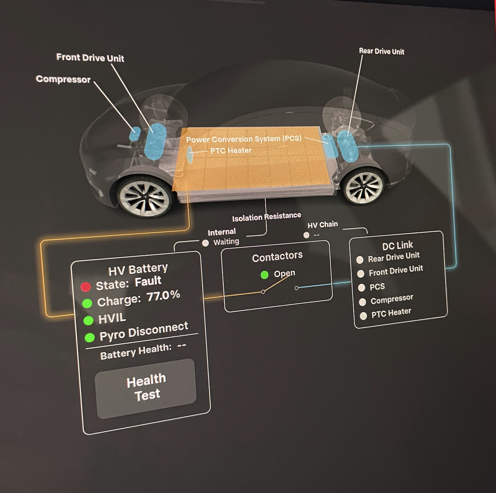

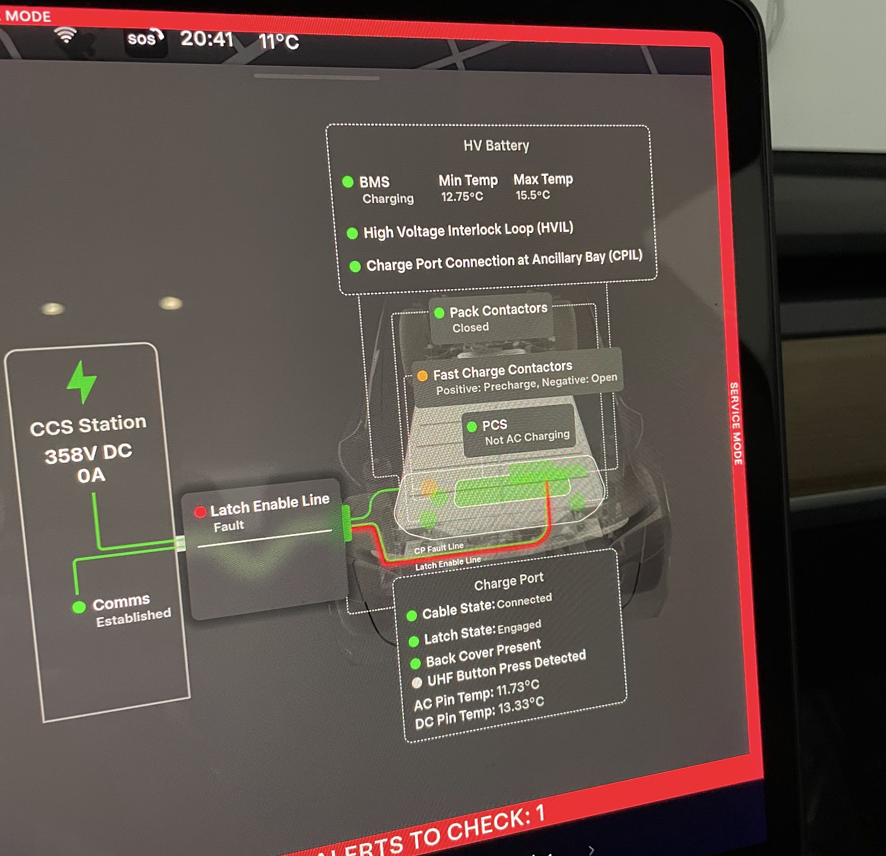

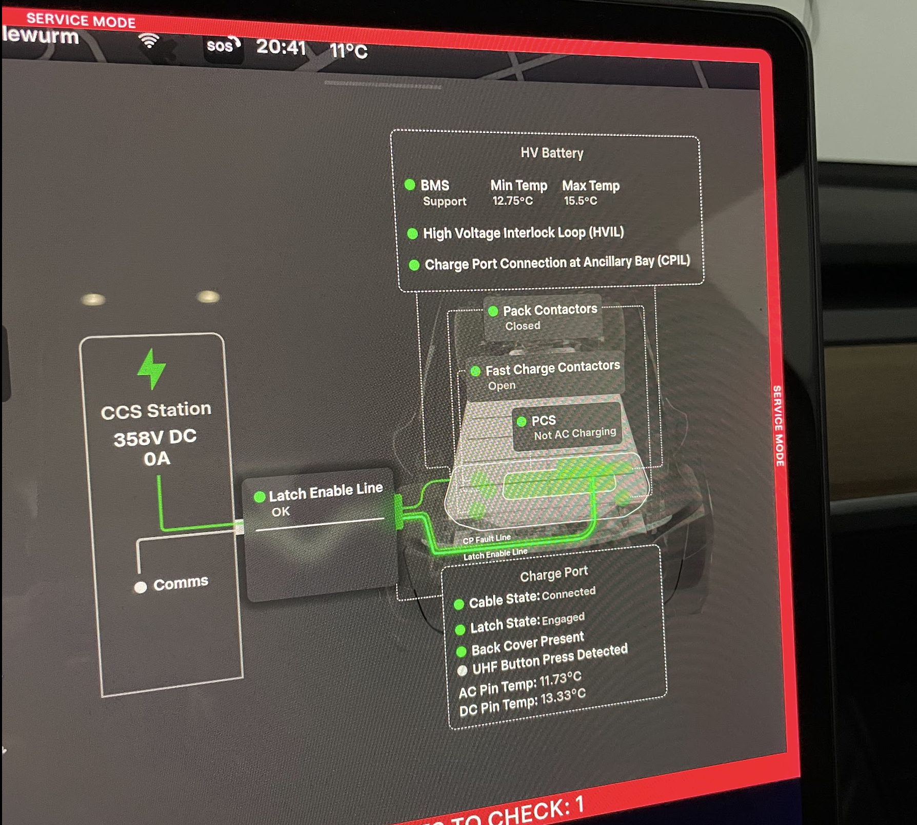

I managed to talk to a Tesla Model 3 2019 (EU). Alas it did not close the contactors, that is, I did not measure any voltage on the DC pins. pyPLC logs attached.
The car also has a "hidden" service menu, with information about the HV state. Apparently it opened the positive contact for precharging, but closed after a few seconds (~20?).
Although it says the "CCS Station" provides some voltage, I think it just shows what pyPLC answers it.
By the way, is this expected? Car sends this voltage via a PreChargeReq:
"EVTargetVoltage.Value": "3550",
And pyPLC answers via a PreChargeRes
"EVSEPresentVoltage.Value": "358",
why 3V more?
Up next I'm gonna try to provide a voltage somehow. I'm thinking about a step-up converter that charges a HV capacitor up... happy to hear some ideas on this front :)
2024-11-08_204120_evse_tesla_model3_tcpdump.pcap.txt
(699.79 KiB) Downloaded 591 times
2024-11-08_204120_evse_tesla_model3_tcpdump.log
(548.2 KiB) Downloaded 578 times

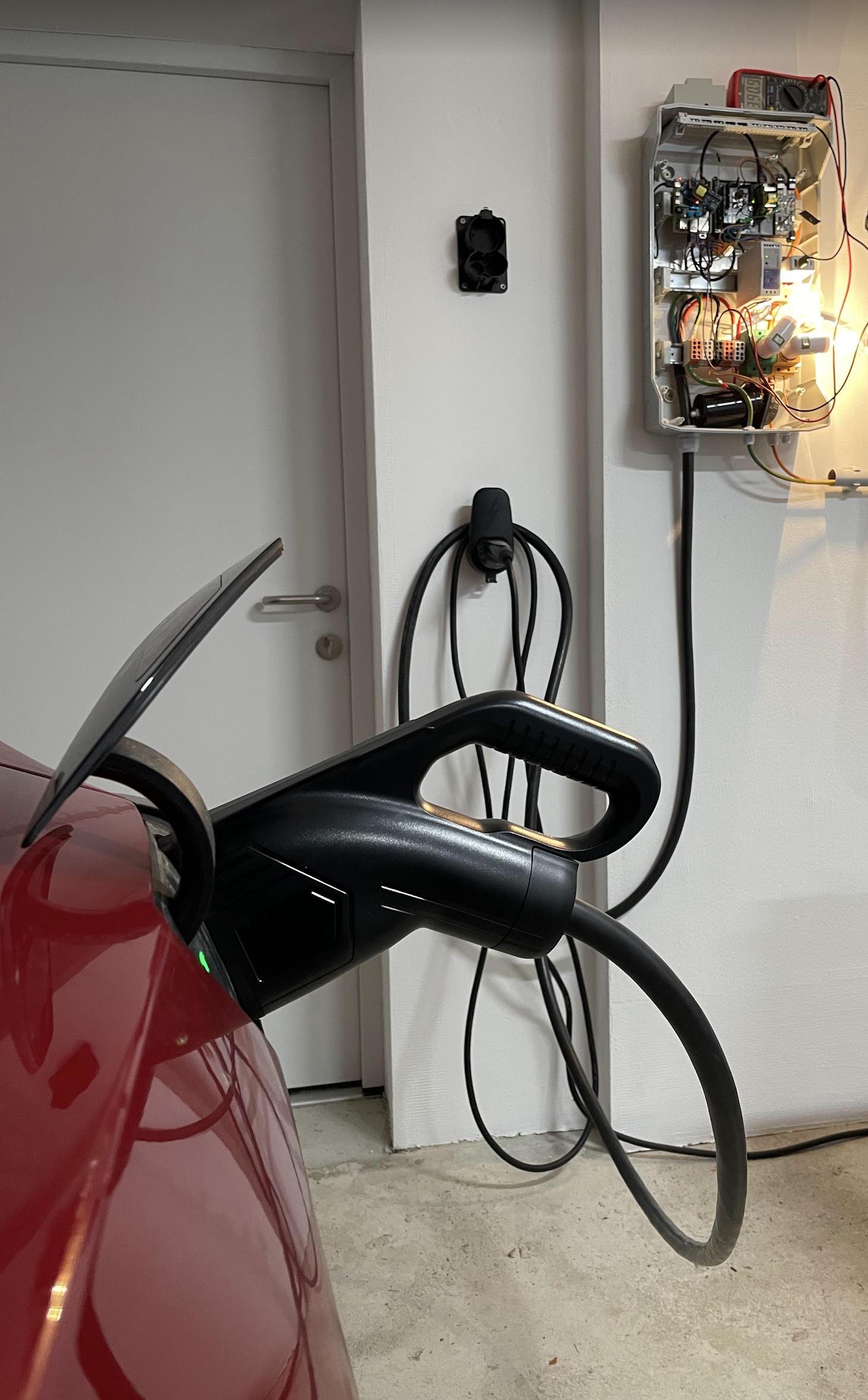

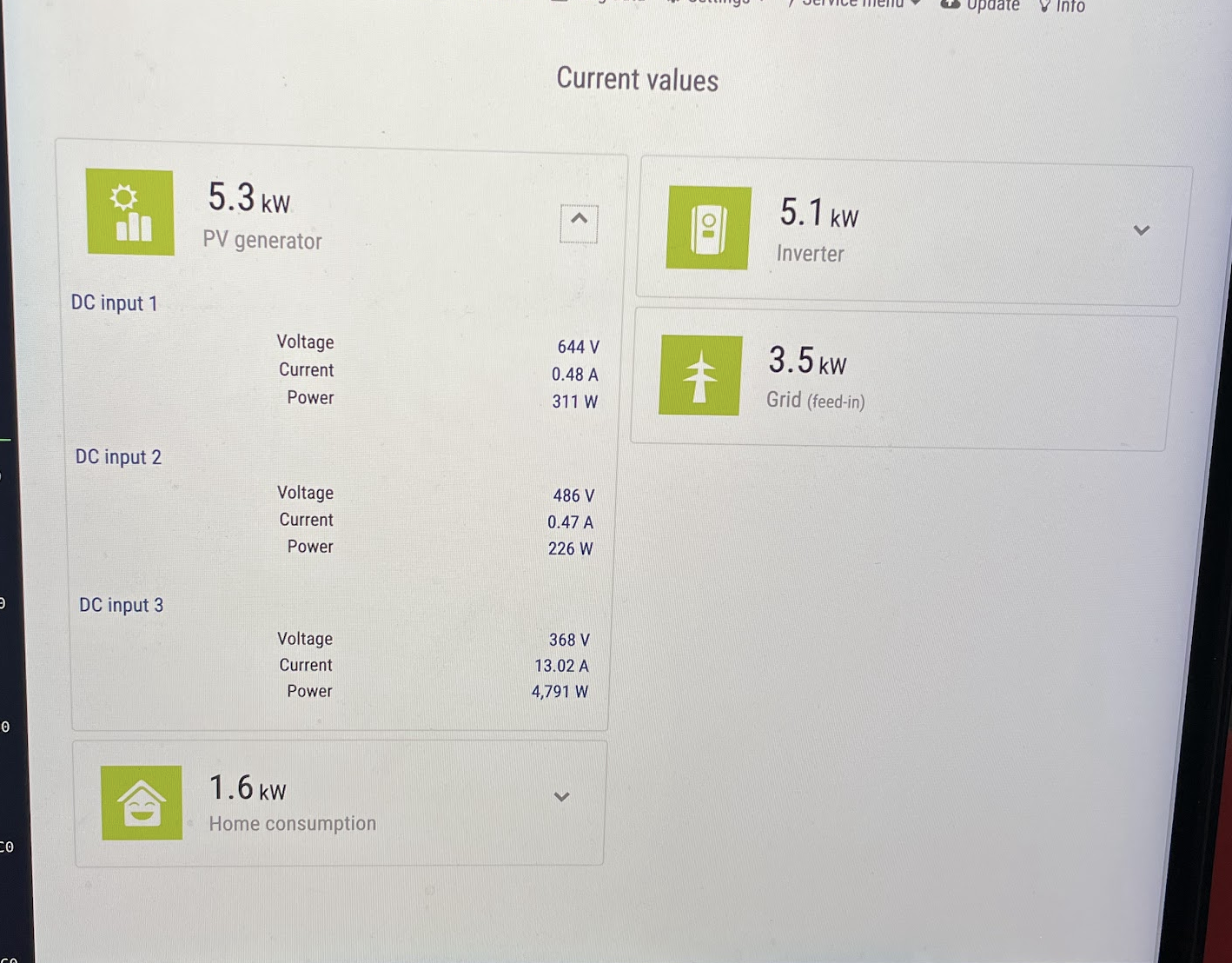

I indeed having some success here with this step-up converter: https://www.amazon.de/dp/ B07KG4RR74
I attached it to the 5V pin of the Raspberry Pi and adjusted it to output roughly 400V. When attaching the CCS plug it drops down to ~350V and the car was not happy with it. You could hear the contacters switching, but some welding warnings popped up.
Then I adjusted it to 430V... and the car was happy with it :)
There is light! Already for ~30min :-) Next tasks are to run some cables to the inverter in the basement (a Kostal Plenticore Plus G1), and put a precharge circuit between. The communication already works... hopefully I can do the first test run next weekend.

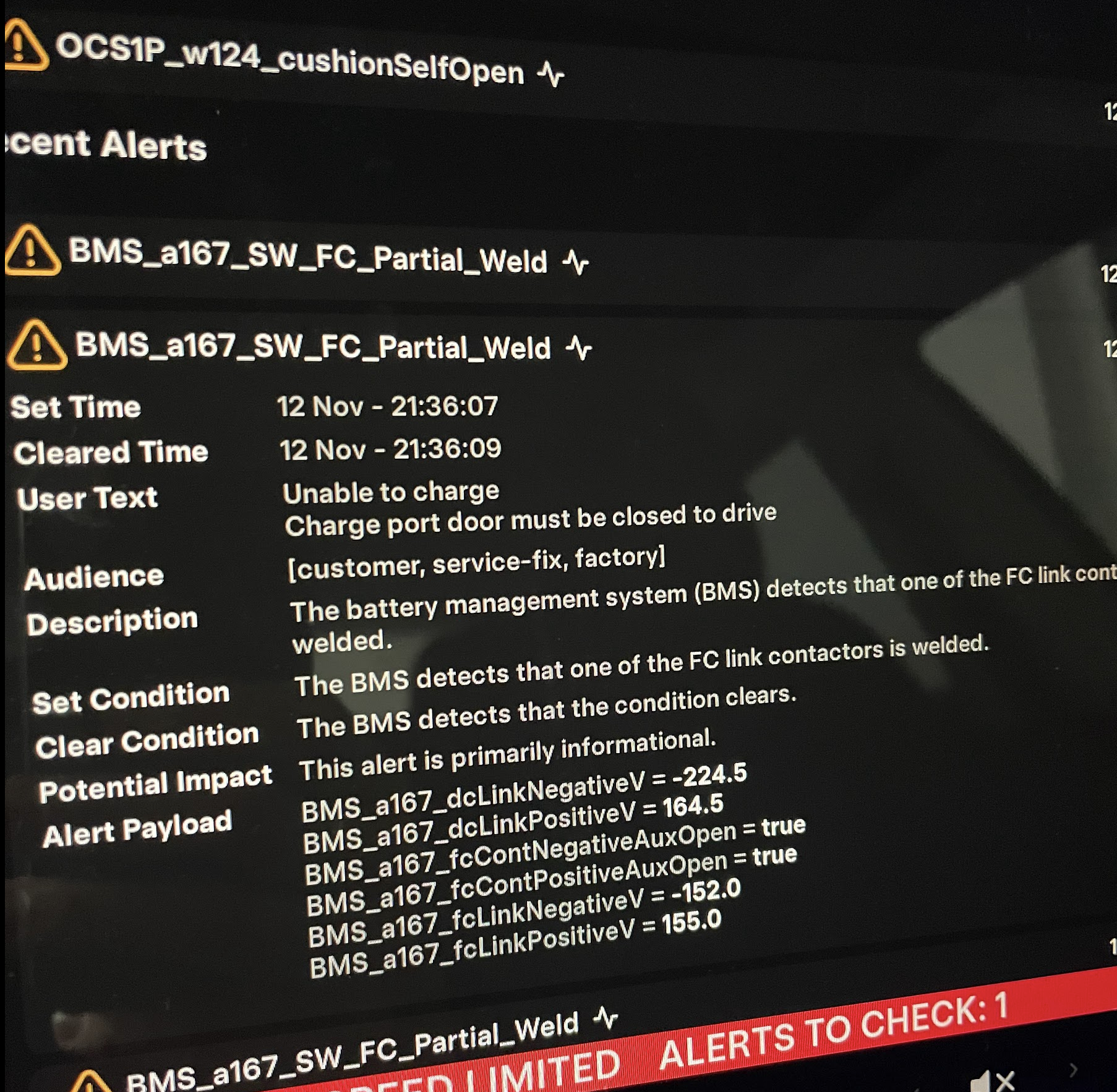

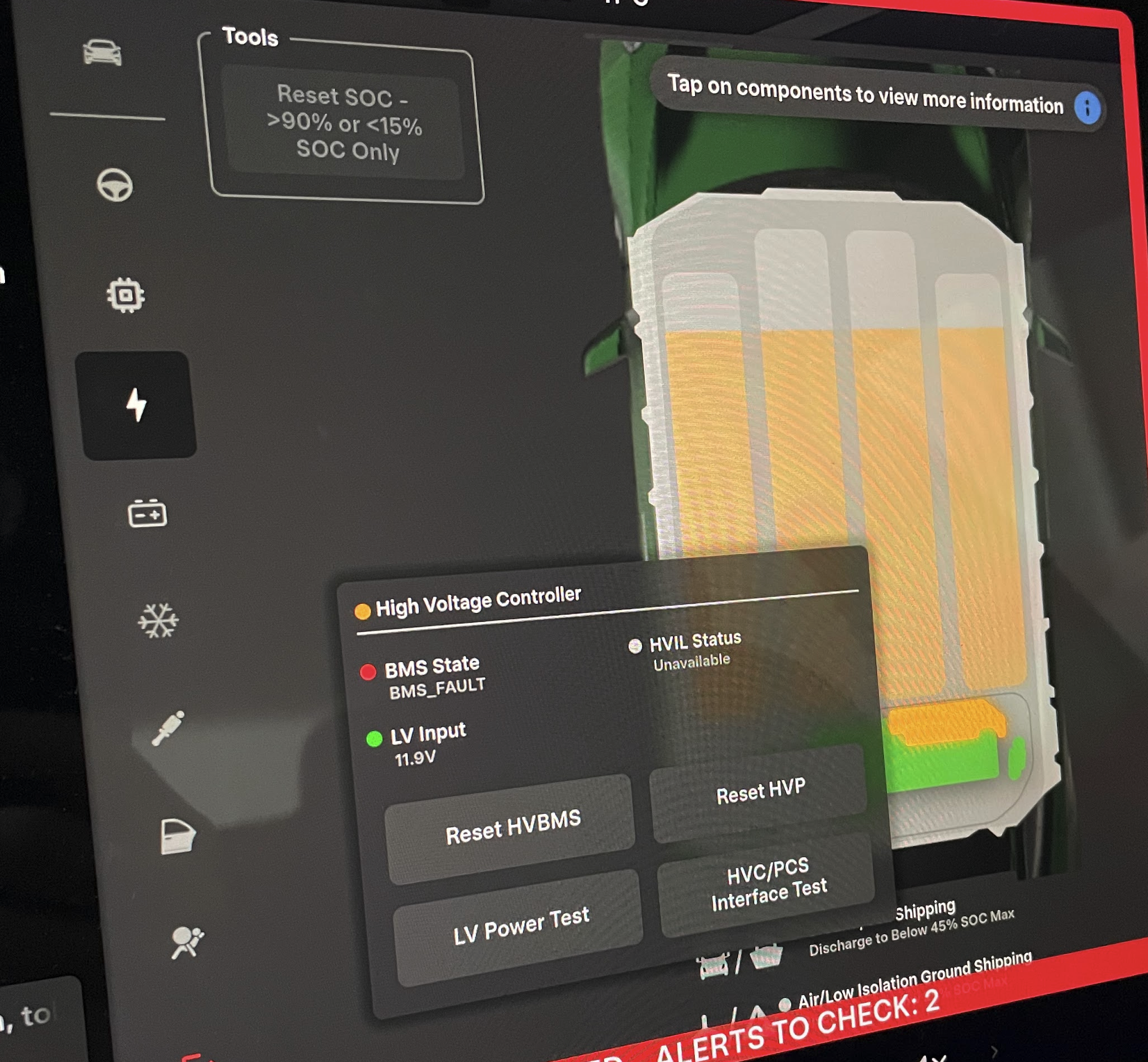

uhi22 wrote: Tue Nov 12, 2024 11:03 pmHopefully the "welded contactor" is just a false alarm.
Yeah, I'm a bit worried about the nature of this. I didn't mention it in my previous post, but initially I just had the step-up converter on the DC +/- lines, and once the contacters closed I switched the flip on the light bulbs (with HV rated protection of course). So at the point of closing the contactors there wasn't any load connected.
After the first discharging session of around ~40min, I aborted and then tried to restart it, and failed with a BMS_a168_SW_FC_Full_Weld (alas I didn't capture the additional info box :-( ), and the car shut the HV system down. Additional errors popped up, like car is not drivable, HVAC not available, etc.
Anyway, the surprisingly easy fix was to press the brake pedal and then the HV battery was back. And I also stopped at a supercharger today, and everything is fine with the fast charging contactors. Phew :)
So I would like to understand the nature of those welding warnings/errors. My hope is that the step-up converter outputs a rather ugly signal and that might interfere with the welding detection of the BMS? Does anyone know how welding detection is usually implemented?

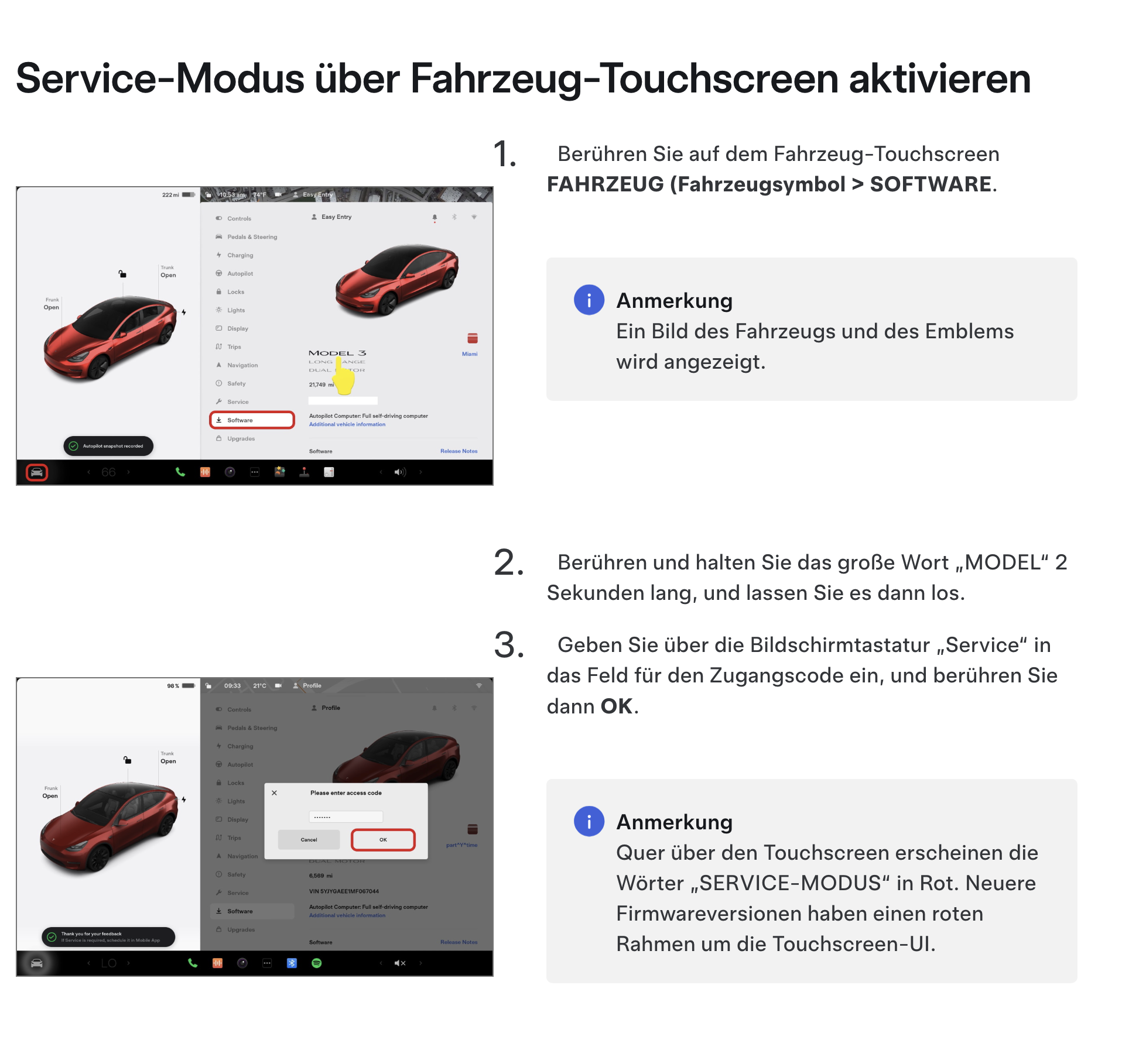

uhi22 wrote: Tue Nov 12, 2024 11:03 pmHow difficult is it to come to this screen? I guess the one or the the other guy would find this helpful.
Not difficult at all (in Europe at least?)

From https://service.tesla.com/docs/Model3/S ... 78AB2.html

Top, thanks.
If I would have the task to implement a welding detection, I would look in which states there should be no voltage on the CCS port at all. This is in the time *before* the car sends the CableCheck request and "after* it finished the CableCheck request, and *before* the PreCharging and *after* the WeldingDetection request. If the voltage on the CCS port is higher than let's say 10V in those states, I would treat this is error, because the contactors normally are perfectly isolating.
Now, if you connect your DCDC before the vehicle expects any voltage, it is a "natural" consequence that the car complains about "welded contactors". It just is not aware that somebody comes to the idea to connect an external voltage, and so it misinterprets the situation as "my contactors are bad".
I guess no real problem, and luckily it heals quite easy.
To do it the "clean way", we need a software controllable supply, which turns the voltage at the right moment to the right value, as pyPLC demands it.

That makes perfect sense, thank you!
I'll try to hook up a relay that enables the step-up converter at the right time. It provides the voltage pretty quickly, so maybe that's good enough timing wise.
lewurm
Posts: 30
Joined: Mon Jul 17, 2023 1:41 am
Has thanked: 41 times
Been thanked: 21 times
Re: Drawing power out of CCS port (V2x, inverse charging, bidirectional CCS)
Post by lewurm »
Quick update: I attached the 5V power supply to a relay of the Raspberry Pi I'm using, and came up with this quick hack: https://gist.github.com/lewurm/e994ae4d ... 55e465ca61
So basically the step-up converter gets enabled on the first PreChargeReq. And indeed, that makes the situation much better, not a single welding warning today! Phew :-)
But: For PreChargeReq the requested voltage by the car is, I guess, the current voltage of the battery pack. SoC was 38%, and the requested voltage 352V. Once precharging is successful, the car sends a CurrentDemandReq with EVTargetVoltage of 423V (which also matches the EVMaximumVoltageLimit). I was able to tweak the step-up converter with its poti so that I reached a voltage that both requests have been happy with. Otherwise it could happen that either (1) precharging never succeeded, and the car aborted the communication after a few seconds, or (2) precharging was successful, the car starts to send CurrentDemandReq messages but aborts the charging quickly after a few seconds.
Later into the evening, the SoC was at 35% and 332V requested for precharging and I didn't manage to find a good sweetspot anymore. But anyway... it sounds like I really need something that I can control the voltage with precisely. Before I get into that, I'll try to do a "two staged" setup with the step-up converter: the first relay having a resistor inbetween so that its input voltage is a bit lower, and the second relay the regular 5V voltage directly from the power supply. So hopefully I can get good values once for PreChargeReq and then for CurrentDemandReq this way. FWIW the response time on the output of the step-up converter is pretty quick once voltage is applied on its input.
Another good news: I managed to see the correct voltage on the Web UI of my inverter (a Kostal Plenticore Plus) coming from the car! Alas I messed up pre-charging (I realized it too late that it actually precharged, aborted too early... tried again, but at that point the inverter already considered the battery as "deeply discharged"). I wanted to redo the experiment of course after restarting the inverter, but couldn't get pass CurrentDemandReq anymore. For another time :)

The next obstacle is my inverter (Kostal Plenticore Plus). The guys over the battery emulator discord have been very helpful, but I'm still not able to convince the inverter to start (dis)charge. Well, except for one accident: I disabled the battery setup in the Web UI of the inverter... and you must know that the battery inputs are the same as for a potential 3rd solar string. So the inverter happily considered the car battery as a solar string and started pulling with maximum current (13A).
I let it sit like this for ~15min, the car didn't complain. So I'm calling that a partial success :)
