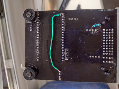

I did have to put a jumper in.
It doesn't have any analogue inputs, but you could add. You could also change the code to not require any current/voltage monitoring and trust the values the charger is saying, if you so wished.

Bigpie wrote: Sat Sep 14, 2024 9:15 am I did have to put a jumper in.
Oh what is the resistor for?
Edit I just saw its on the CAN so its likely a 120 ohm resistor right?

Posts: 1779
Has thanked: 83 times
Been thanked: 428 times
Re: ESP32 Based Chademo
It is a can terminator on the second can

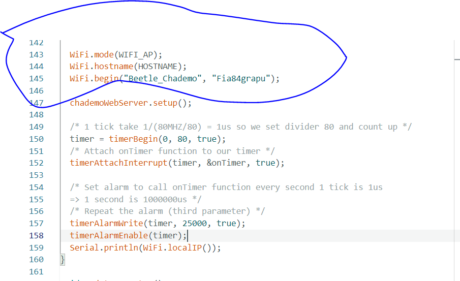

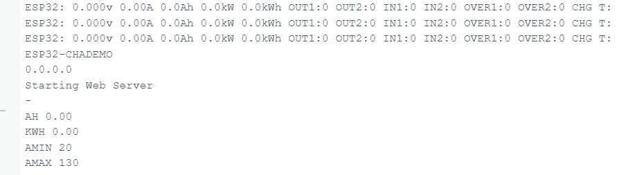

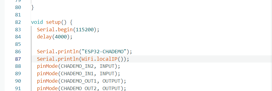

Bigpie wrote: Thu Sep 12, 2024 5:56 am If you connect to the ESP32 wifi network and the ip address will be 192.168.4.1
Ok back to this. I think I found the problem. Is default IP for ESP32 should be 192.168.4.1 But mine is not defining the default serial.
I added this in the INO file.
And got this in the serial printout on the Arduino screen.
Anyone know how to add a set IP address?

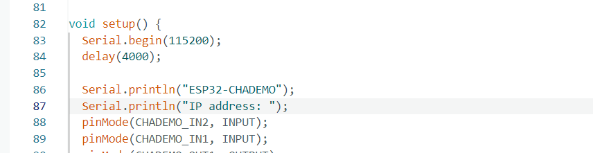

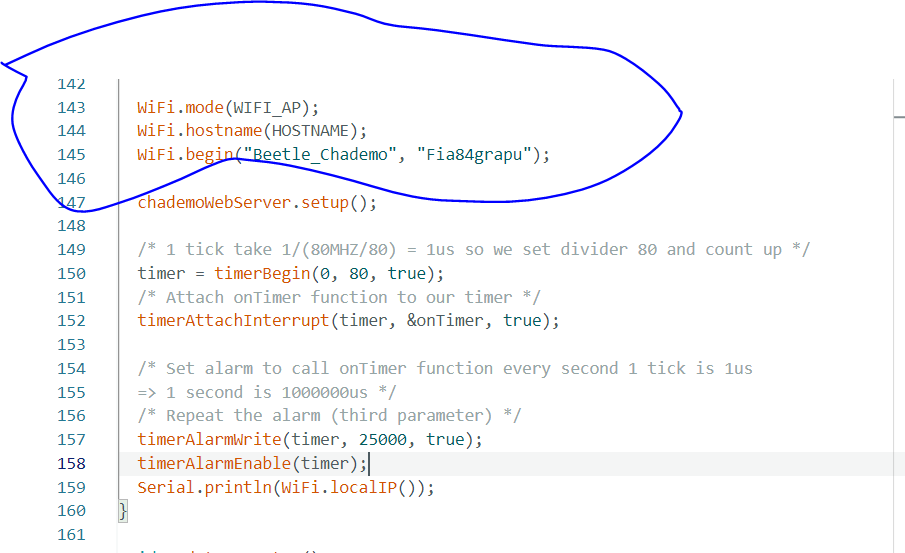

Arlin wrote: Sat Sep 14, 2024 8:40 pm Ok back to this. I think I found the problem. Is default IP for ESP32 should be 192.168.4.1 But mine is not defining the default serial.

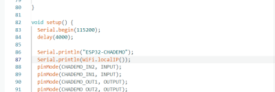

And changing it to this.
I got this.
Posts: 2418
Location: Bristol
Has thanked: 209 times
Been thanked: 576 times
Wifi starts further down. so only have it print the IP towards the end of the setup() section.
Arlin
Posts: 29
Joined: Fri Oct 15, 2021 8:22 pm
Has thanked: 8 times
Post by Arlin »

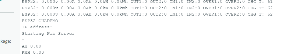

Tried it this way as well. Still 0.0.0.0
Also do I need to change WiFi.begin("Beetle_CHademo", "Fia84grapu"), to something else?
-Arlin

Oh how to get the Web page to load from my PC so I can set the settings etc.
royhen99
Posts: 261
Location: N. Wiltshire. UK
Has thanked: 22 times
Been thanked: 133 times
Post by royhen99 »
Assuming you have the the same version as on github, connect your wifi to ESP32-CHADEMO, password ChadMeO.
Then access the web page at 192.168.4.1 which is the default IP address for the ESP32 web server.
