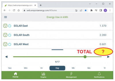

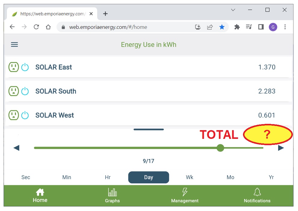

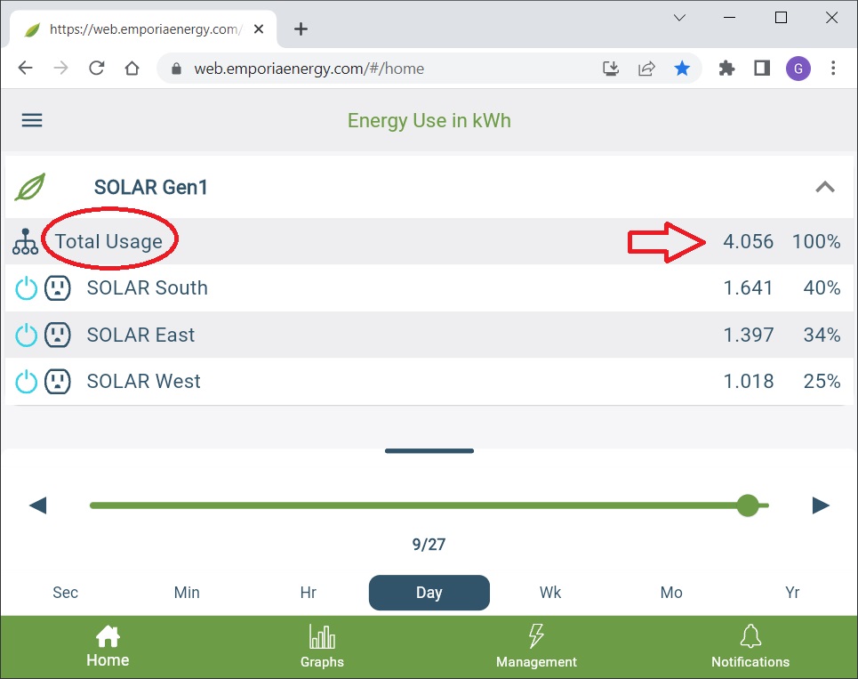

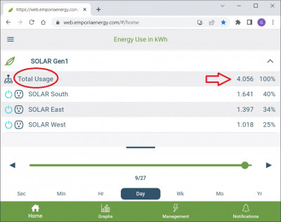

alright, so the first problem is there is no aggrreggatted (sp?) TOTAL

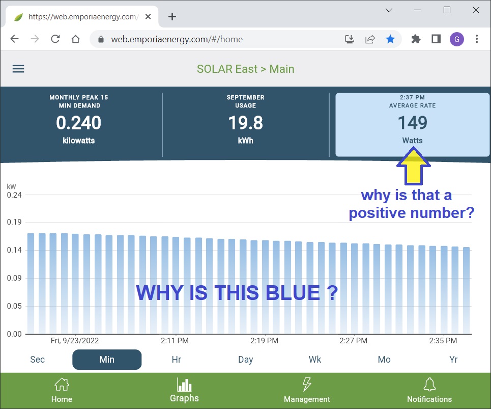

Re: The Greg's Grid Tie Solar Project

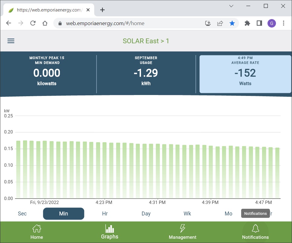

and the second problem is the Smart Plugs display our hard earned solar production as usage aka consumption

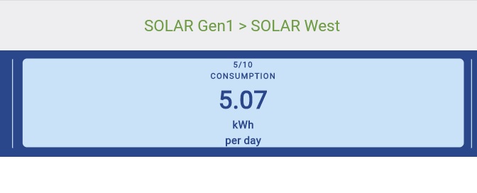

note the graph in green as in solar production "saving the planet and such"

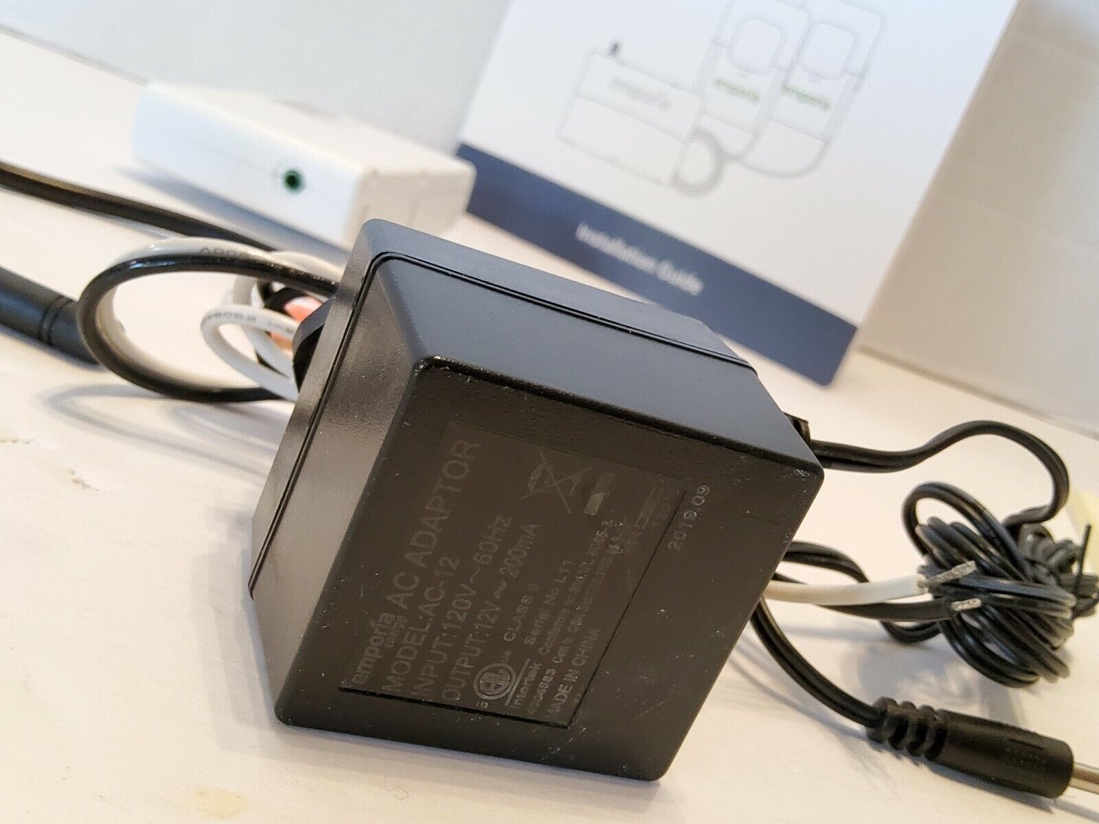

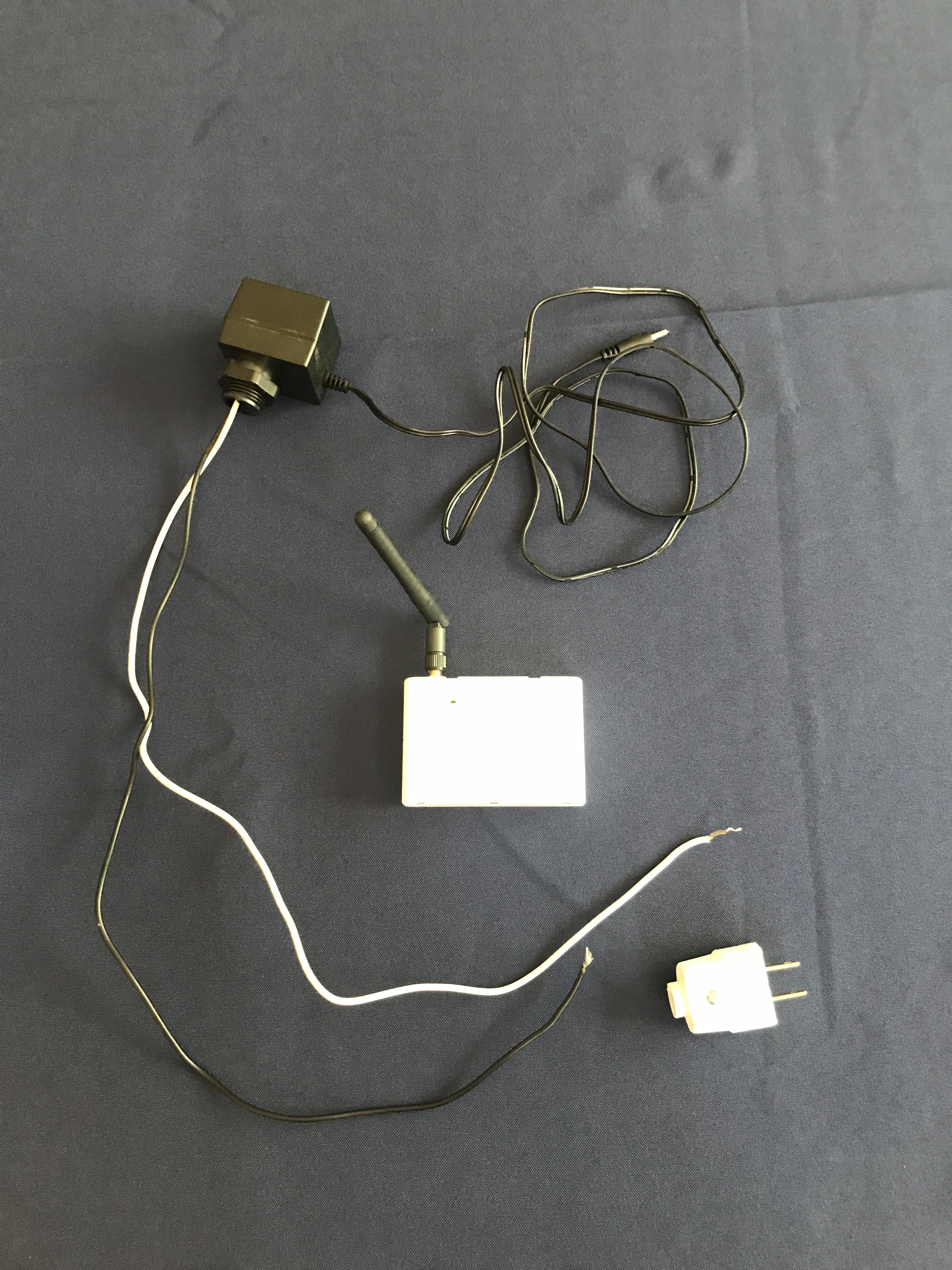

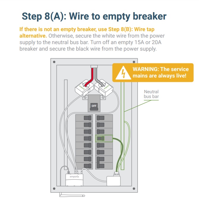

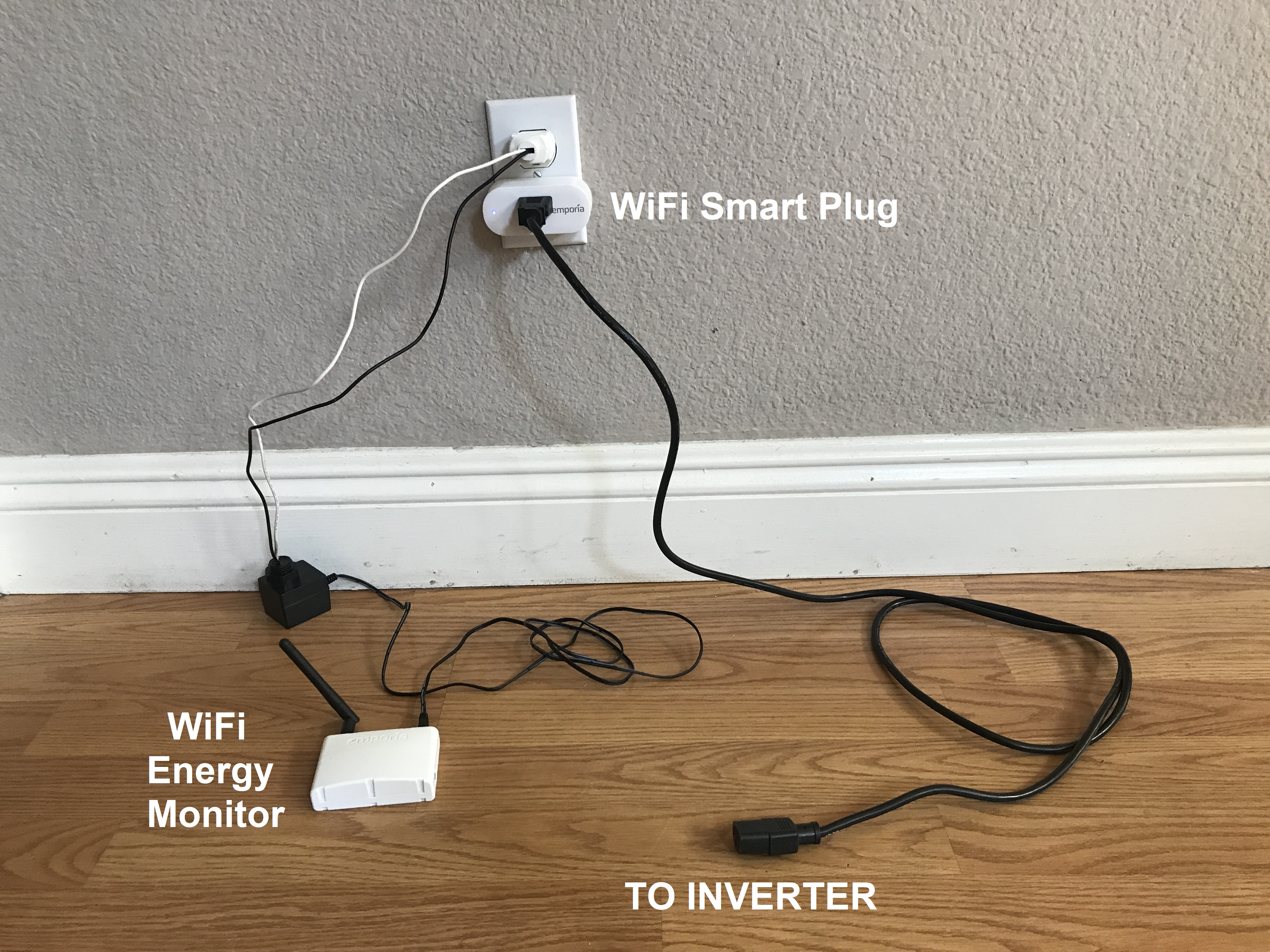

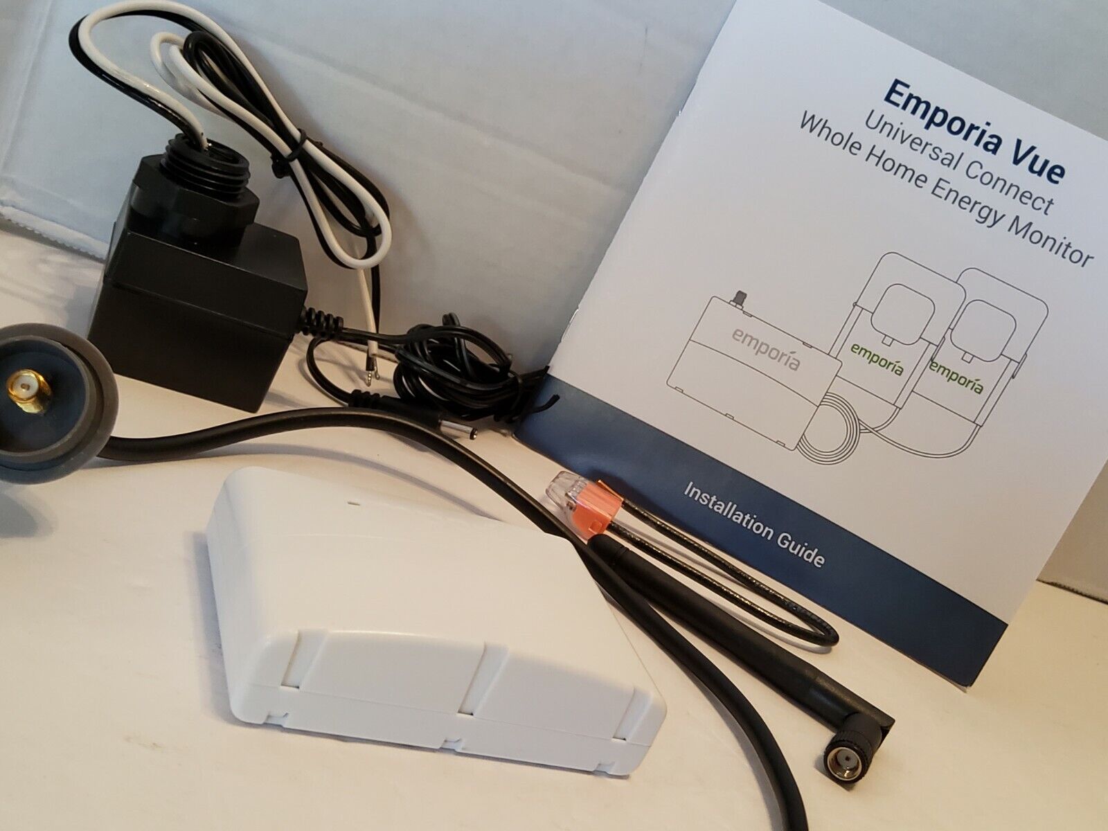

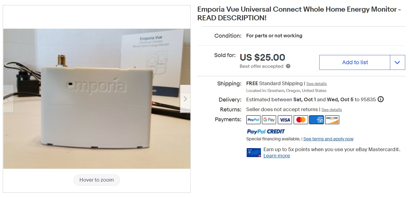

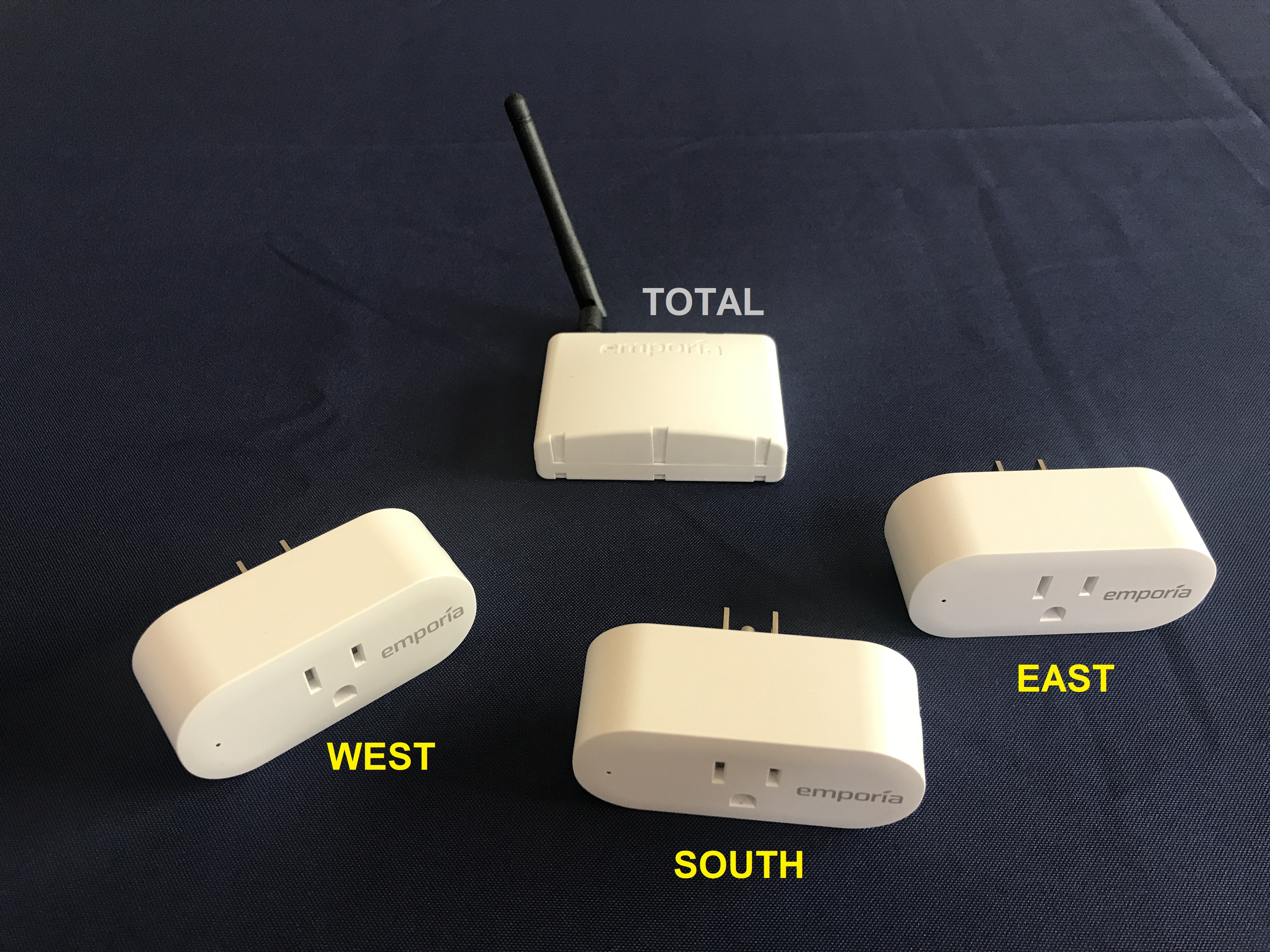

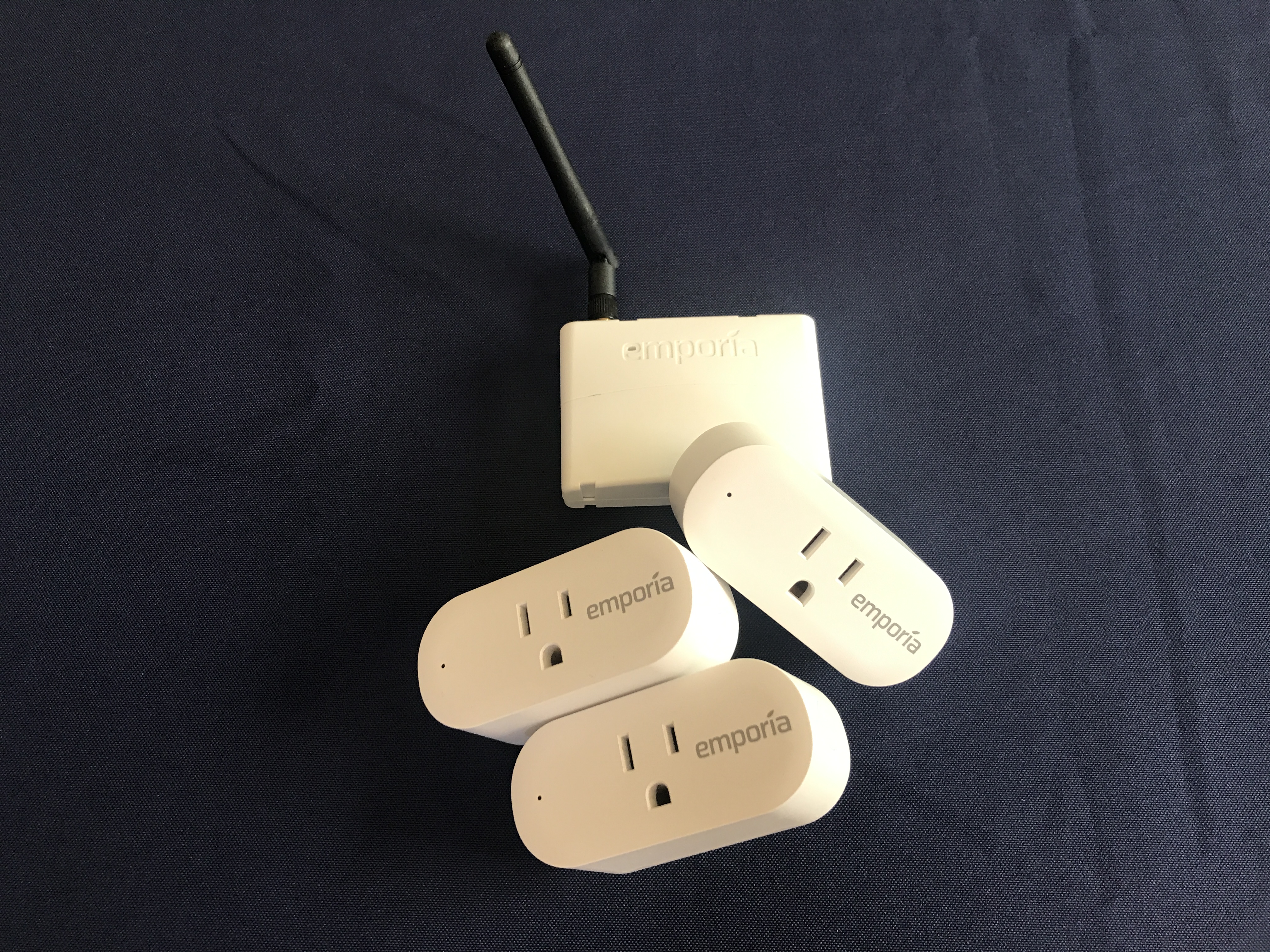

in order to do so in addition to the Smart Plugs one per inverter plugged in to the wall sockets I went out and bought this Emporia Vue WiFi monitor (this is Gen 1, but it does the job) on eBay for $25 bucks, and all I got was the little white box just the monitor well technically and it's power supply, but no additional current sensors at all
the idea is that when you have a Vue monitor you can then nest the Smart Plugs under it, and this aggregates the totals by default
so normally you are supposed to shove one of these white boxes into your electrical panel and wiretize it to one of the breakers, but that's not how The Greg rolls

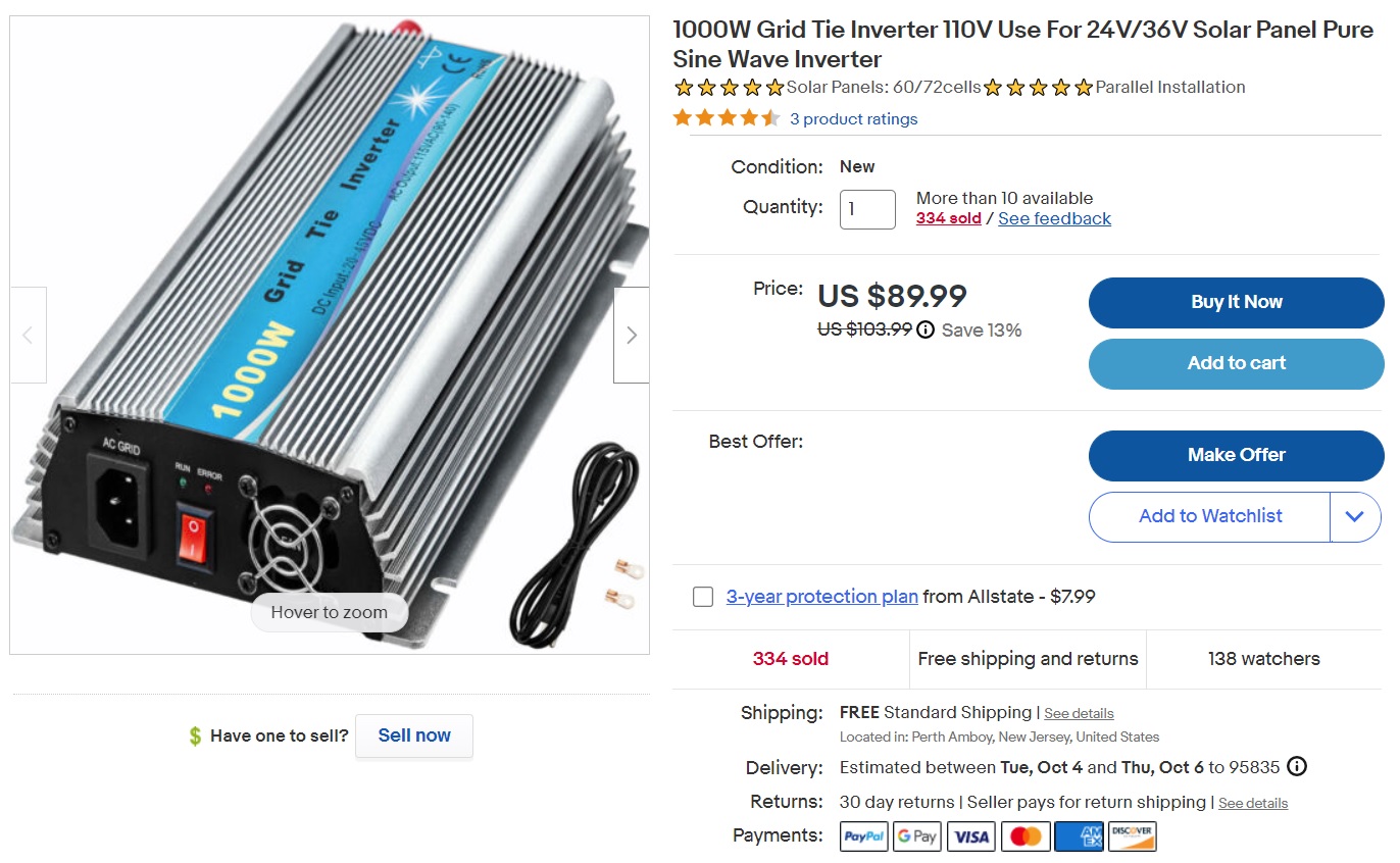

wow just came across this listing on eBay for one of these 1000 watt inverters and what I like about this one is that it is the higher input voltage range, this is one lesson I learned that if I was to do it all over again I would buy in at the 24 volt system instead of the 12 volt, its more efficient and you can use thinner aka higher gauge solar panel wires or make longer runs
anywho anytime the listing says Best Offer I [wait for it] ... send them a best offer, ha ha so I would offer them $75 and see what they come back with
this is NOT my listing I am not vested in this at all, just trying to help you out if you are interested in playing with one of these animals

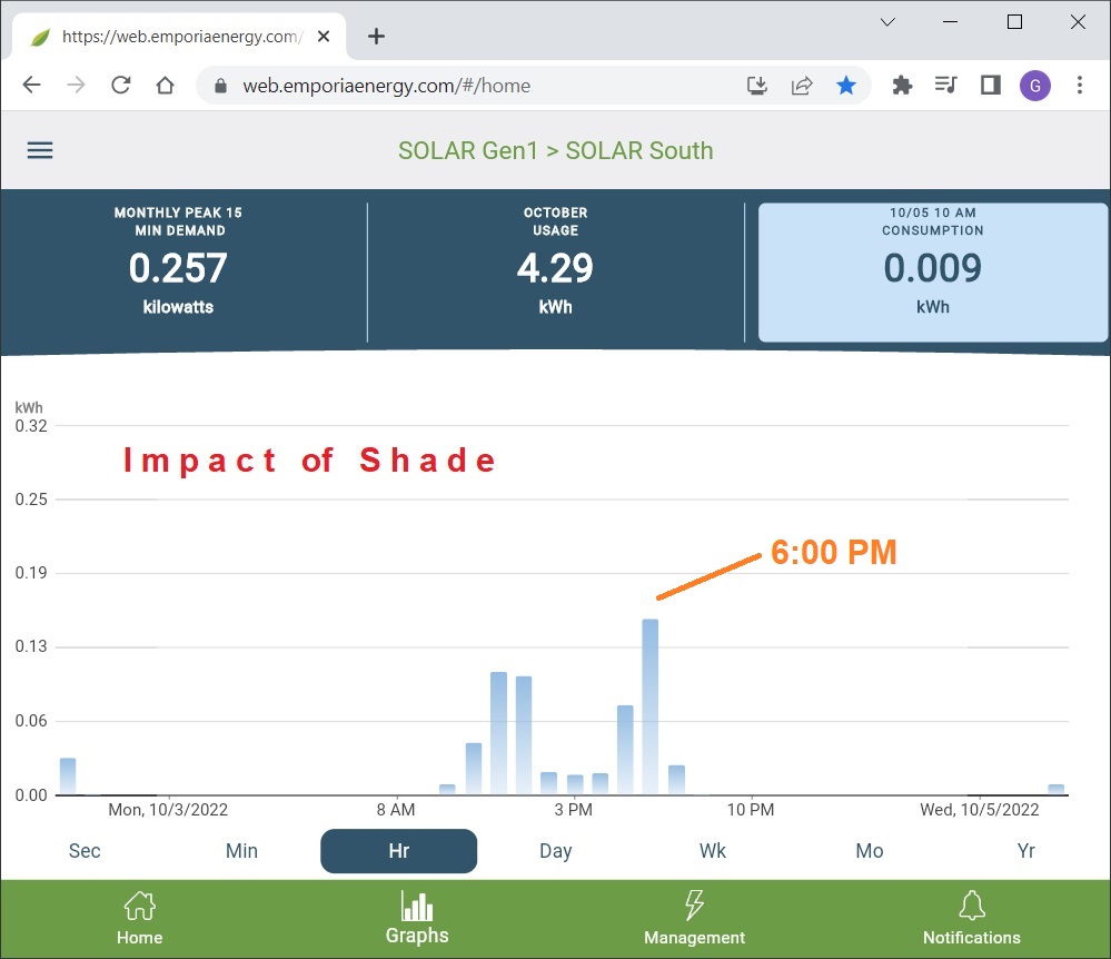

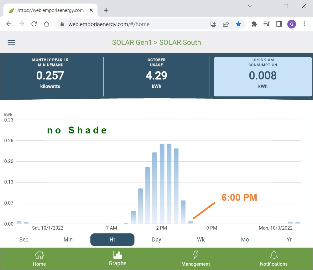

so just documenting the impact of shade on the same four 100 watt panels originally pointed South that I rotated West to capture the sun later in the day and unfortunately a large tree is in their path now
Pointed South no tree in the way
Pointed West with a tree in the way

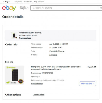

Welcome to Solar Summer 2023 where The Greg will be upgrading his 100 watt 12 volt solar plates with 200 watt 24 volt ones
I may have said this before but in case I didn't the arbitrary magic number for solar panel cost in my brain is $1.00 dollar per watt. So I don't want to pay more than $100 dollars per 100 watt solar panel, and in this case I scored these 200 watt solar panels for $185 bucks each on eBay, using the Gregonomics Method [ Contact seller and say I will buy 5 if you offer a 10% discount, the worst they can say is NO ]

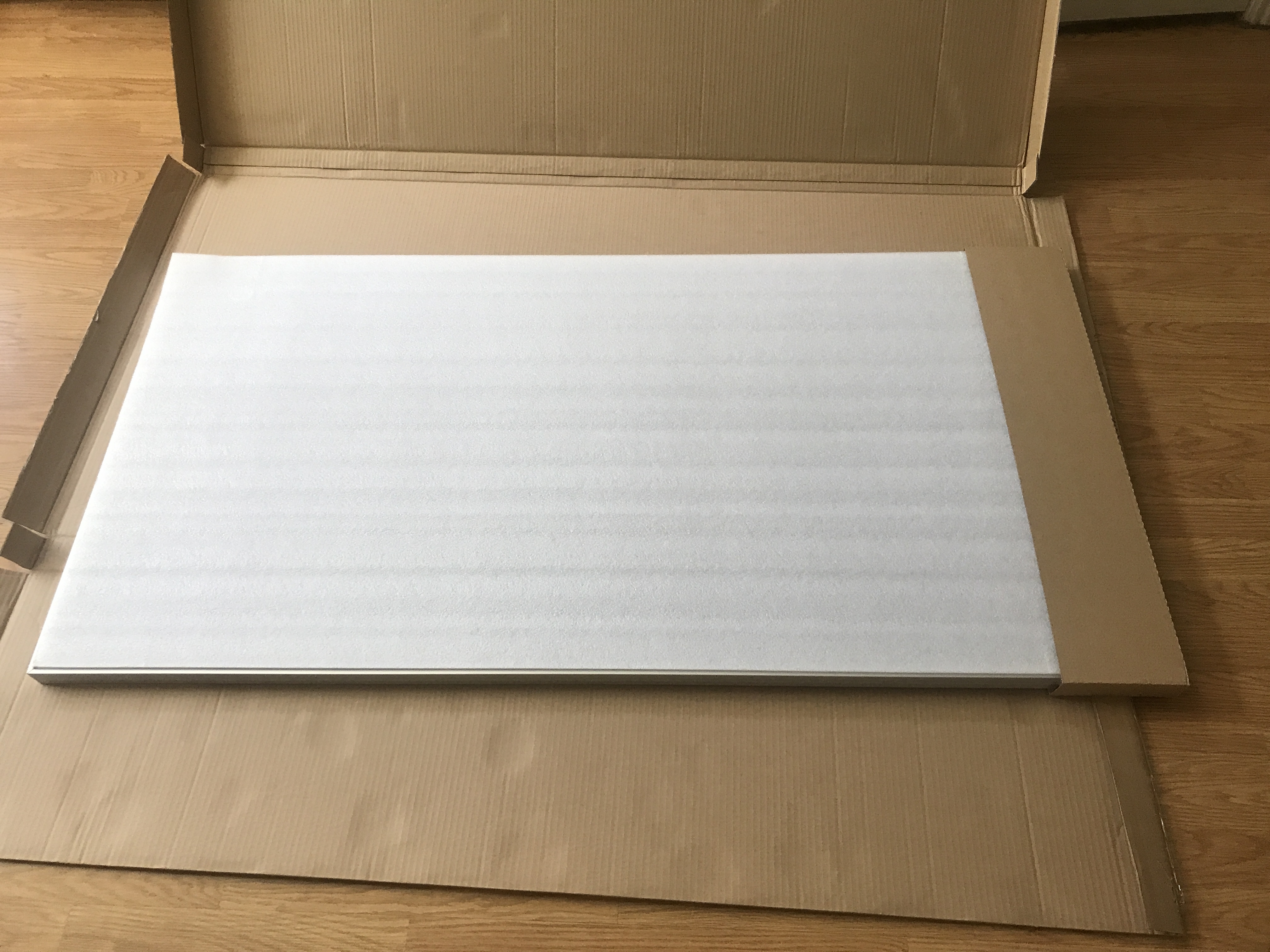

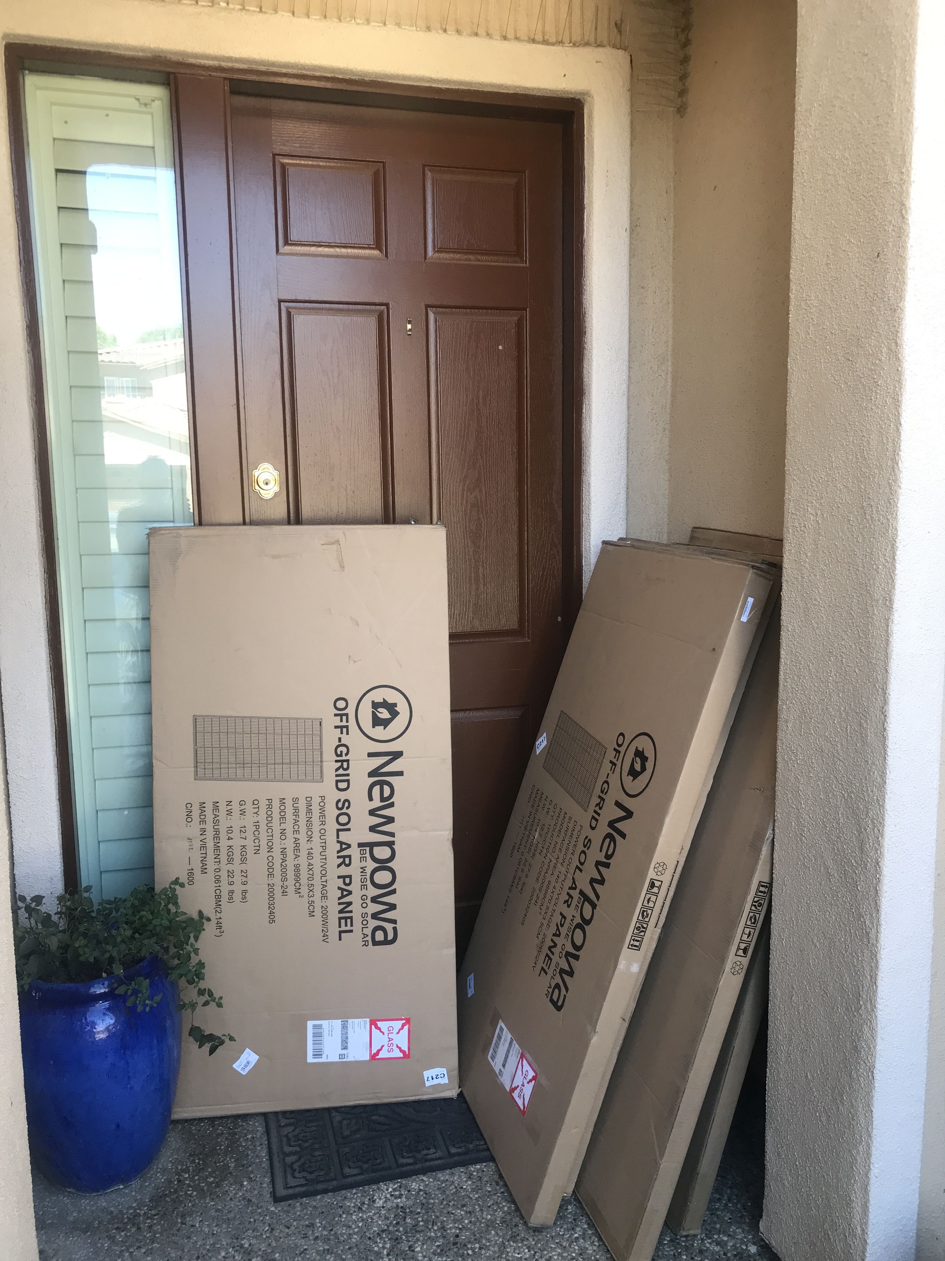

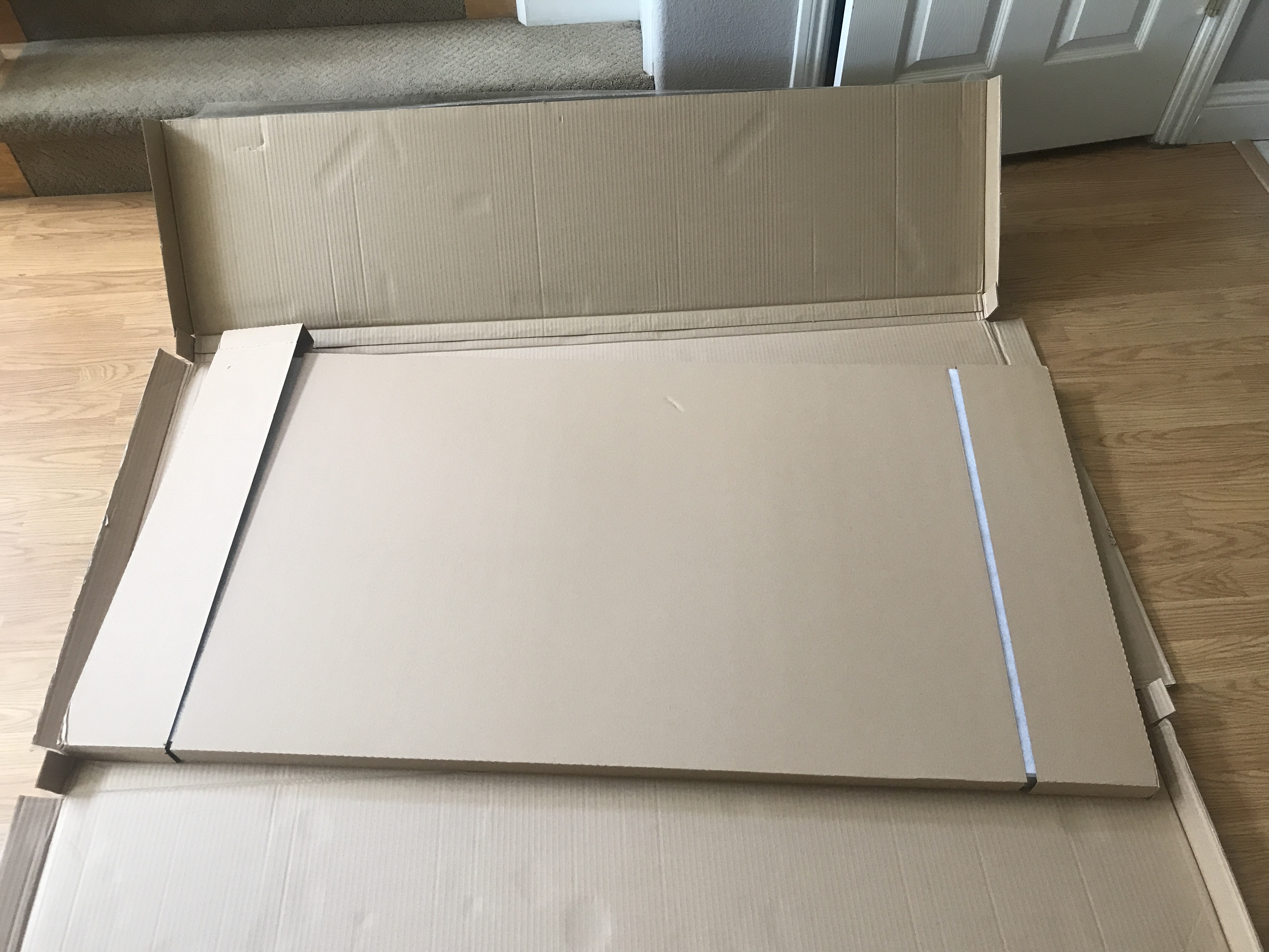

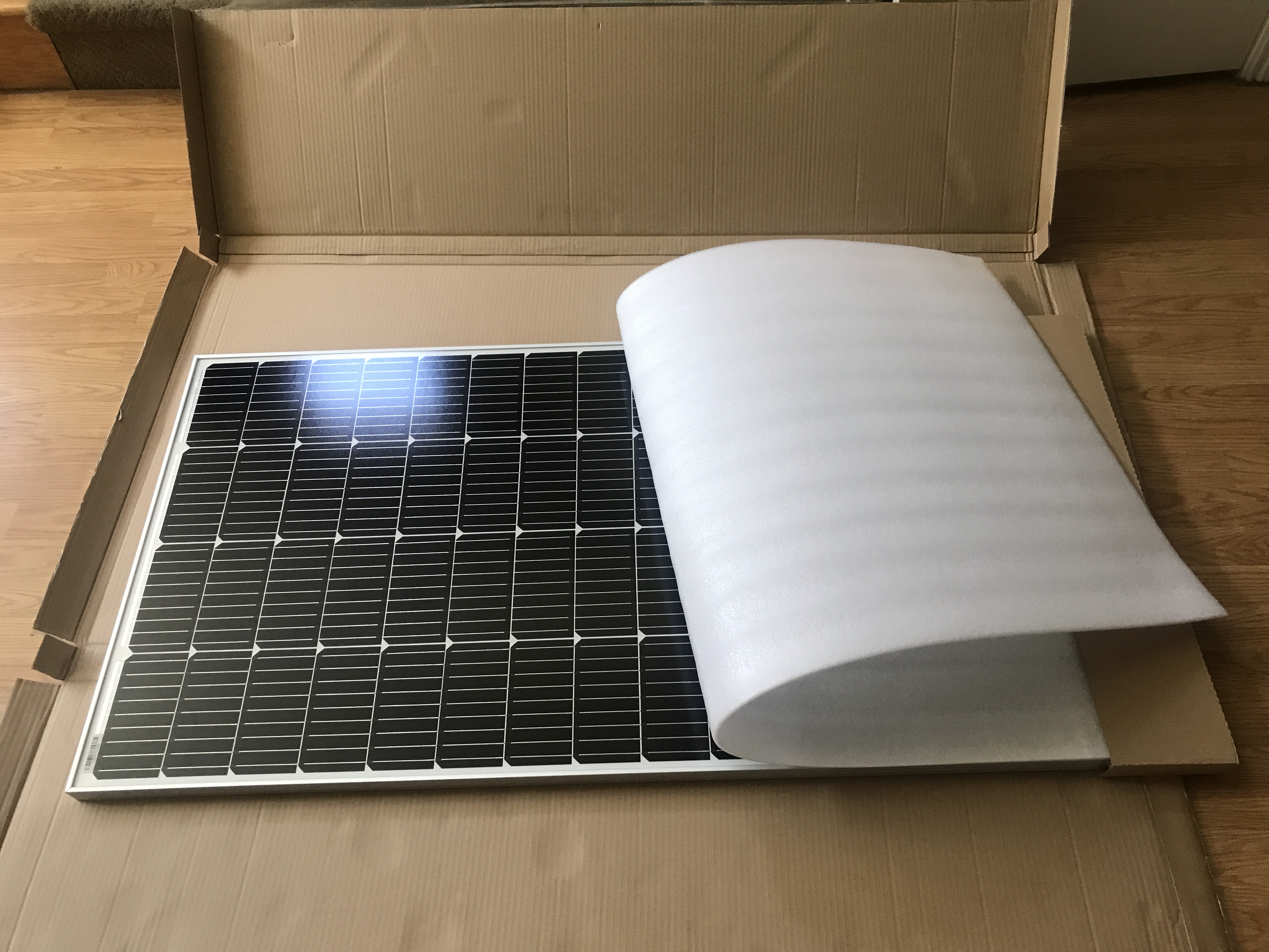

sometimes you can get an idea for the quality of the product by the way it is packaged, and Newpawa did a great job of tucking them in
- Gregski
- Posts: 2876
- Has thanked: 530 times
- Been thanked: 1194 times

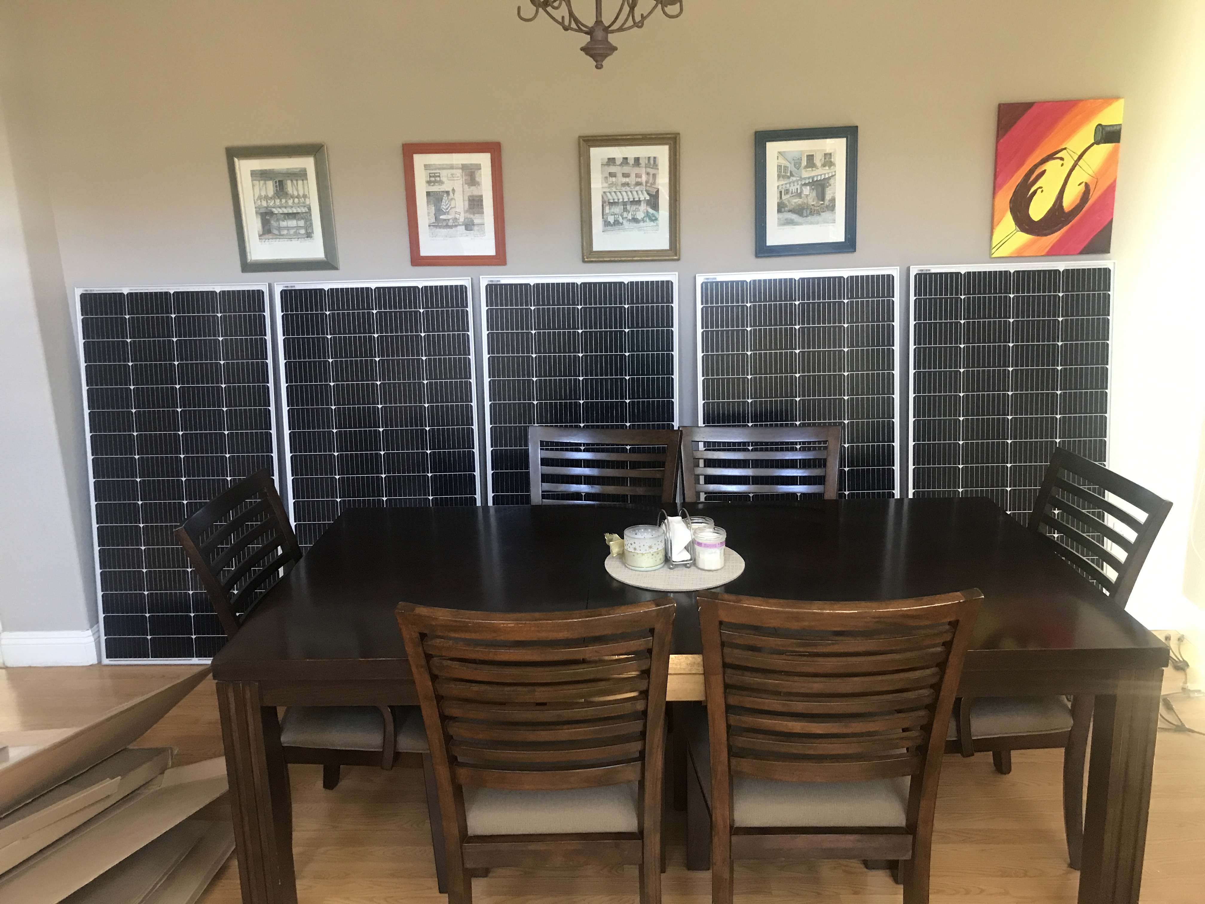

Wow, they are a perfect fit !
Top Tip for the Young Padawans: I don't like to install my new solar panels right away, I treat them like gold fish and first allow them to acclimate to their new surroundings. Usually the garage will do, but the wife insisted we put them on display in our fine dining room, and who am I to argue.
Eat your heart out Elon Musk, the Gregsta Powerwall

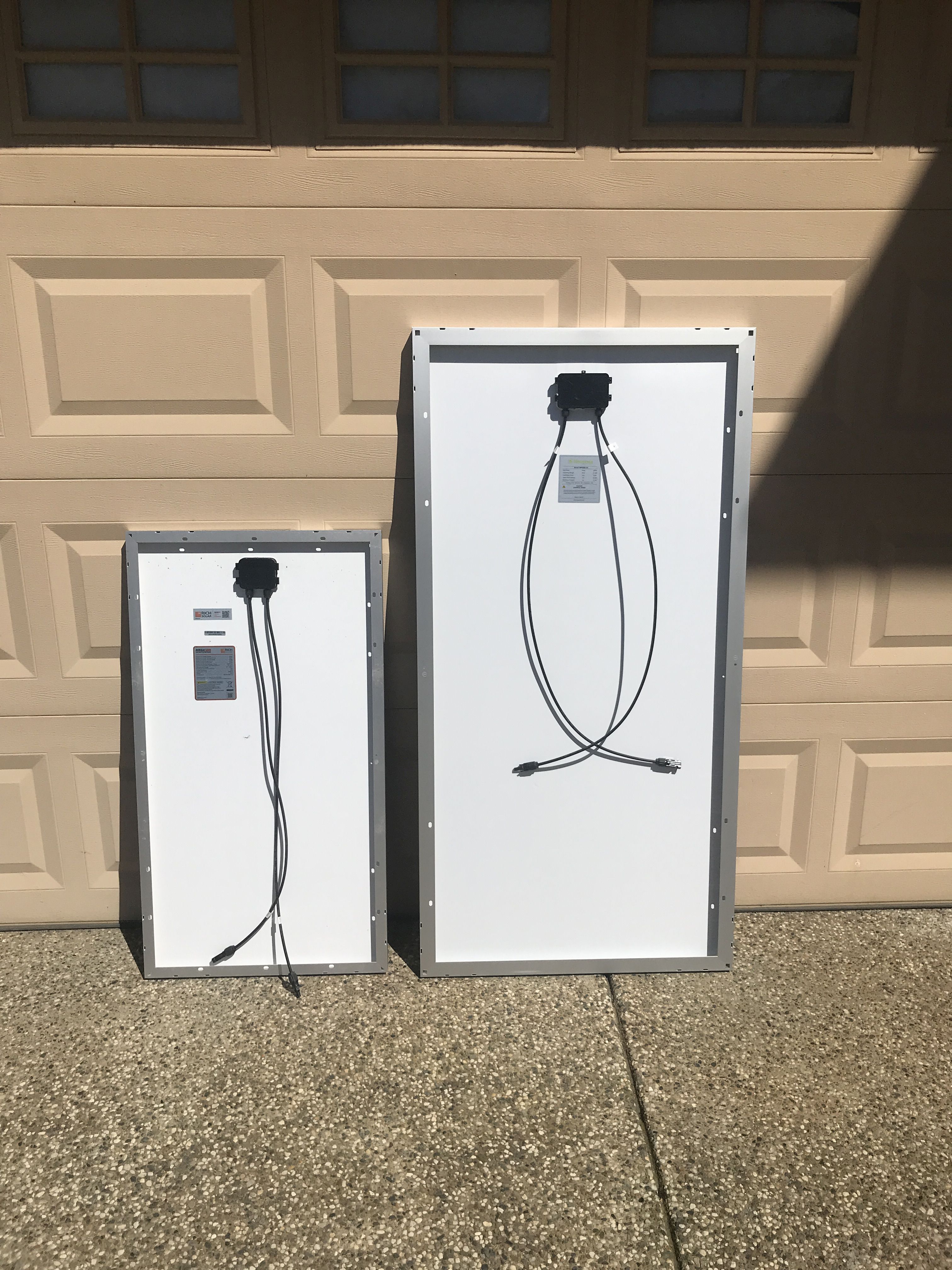

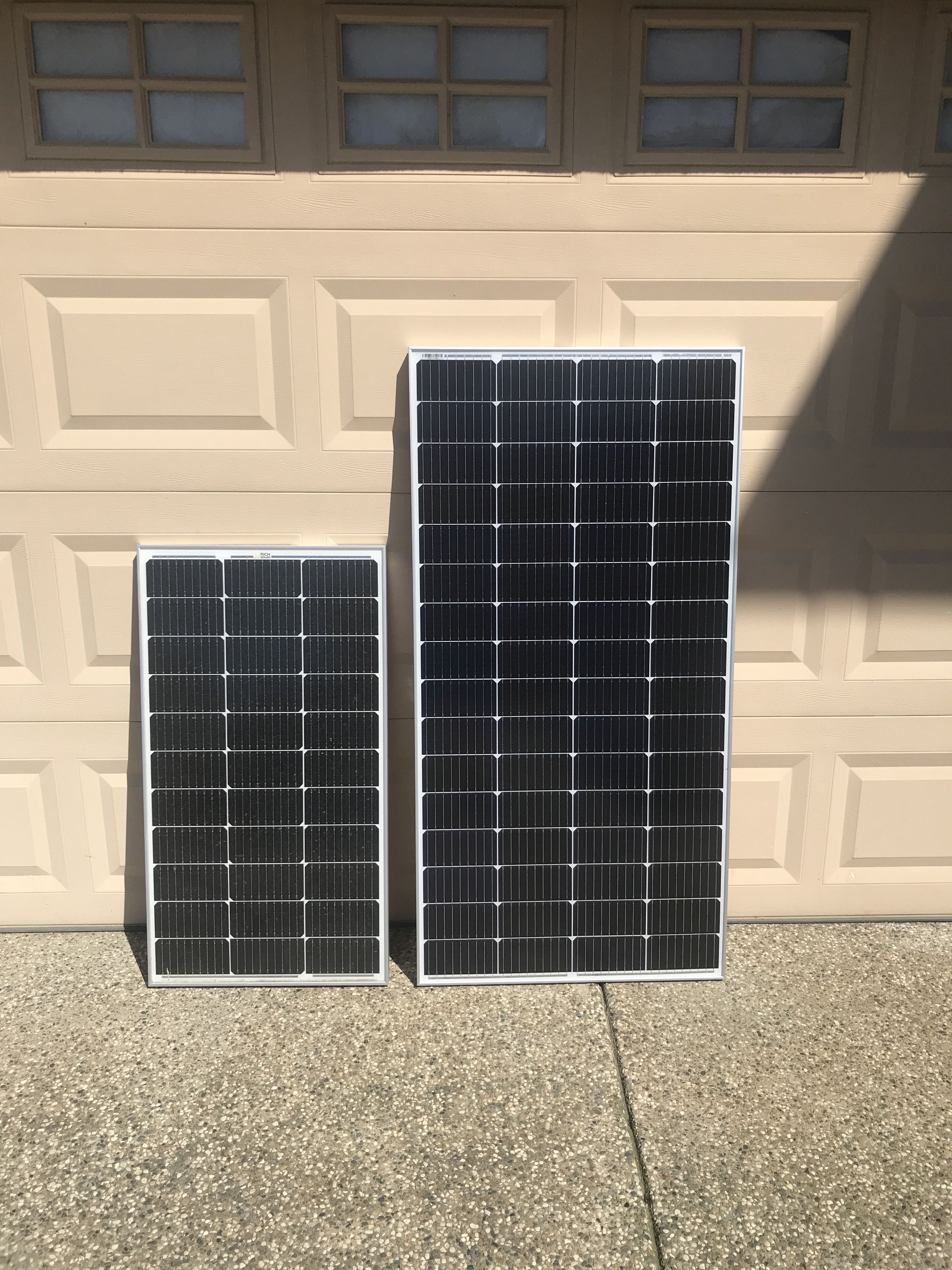

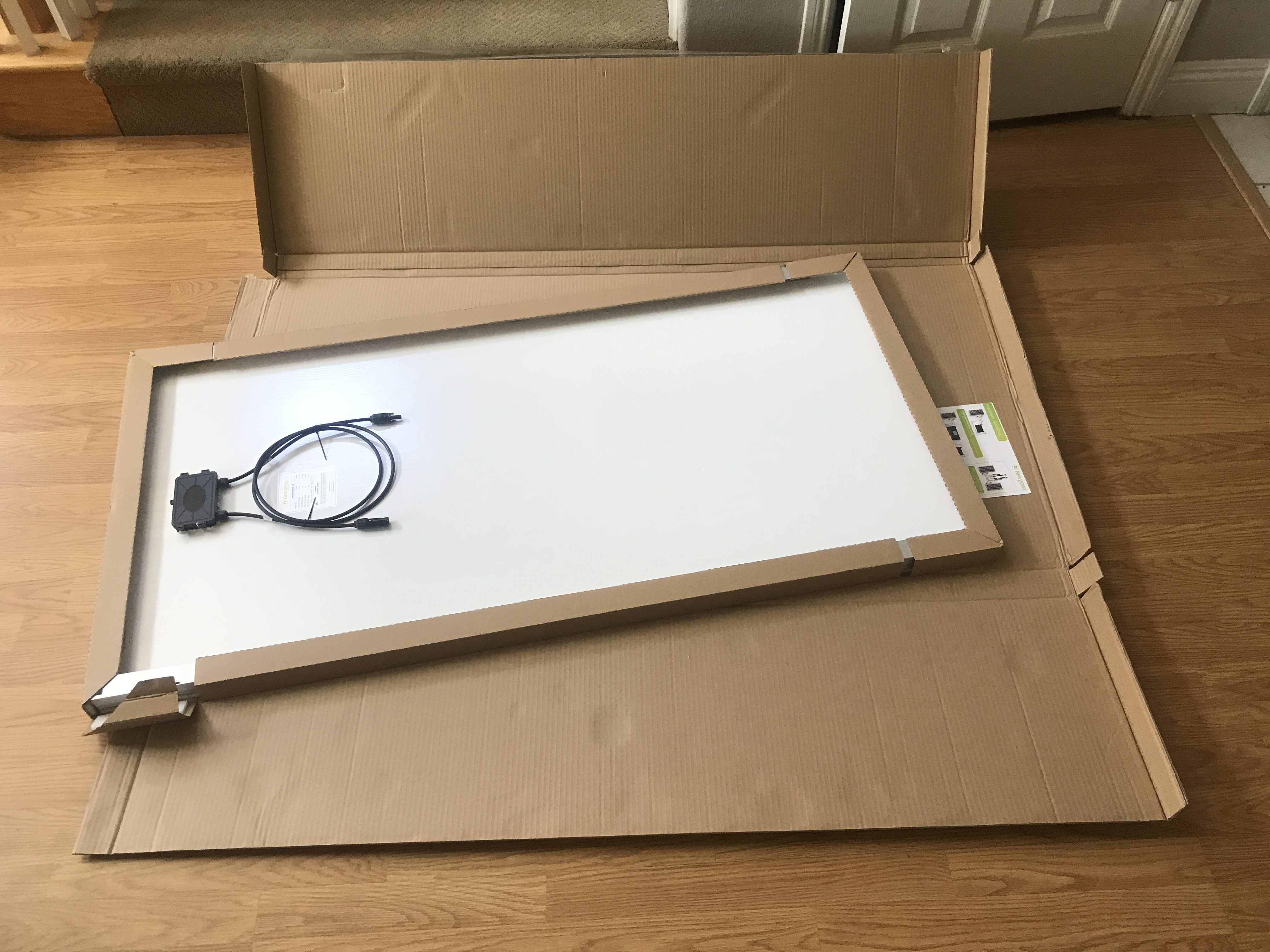

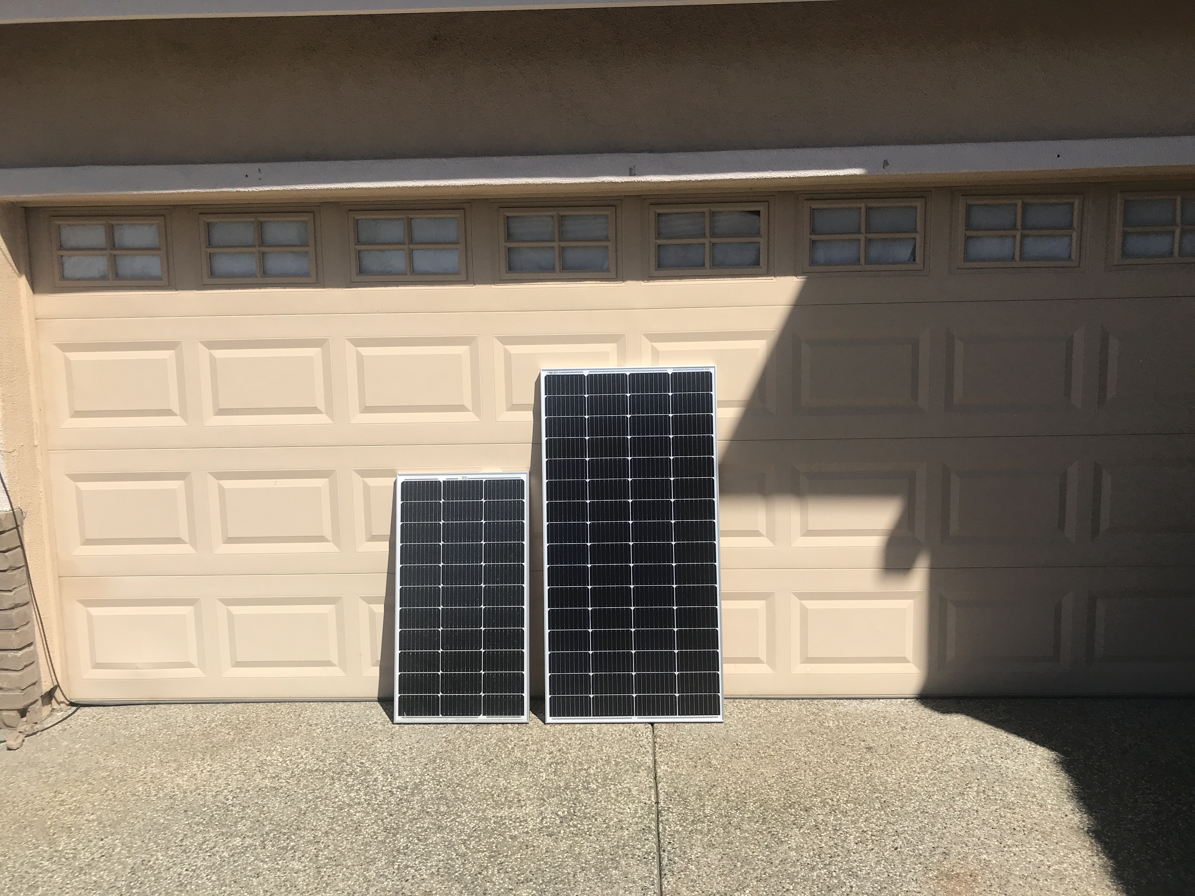

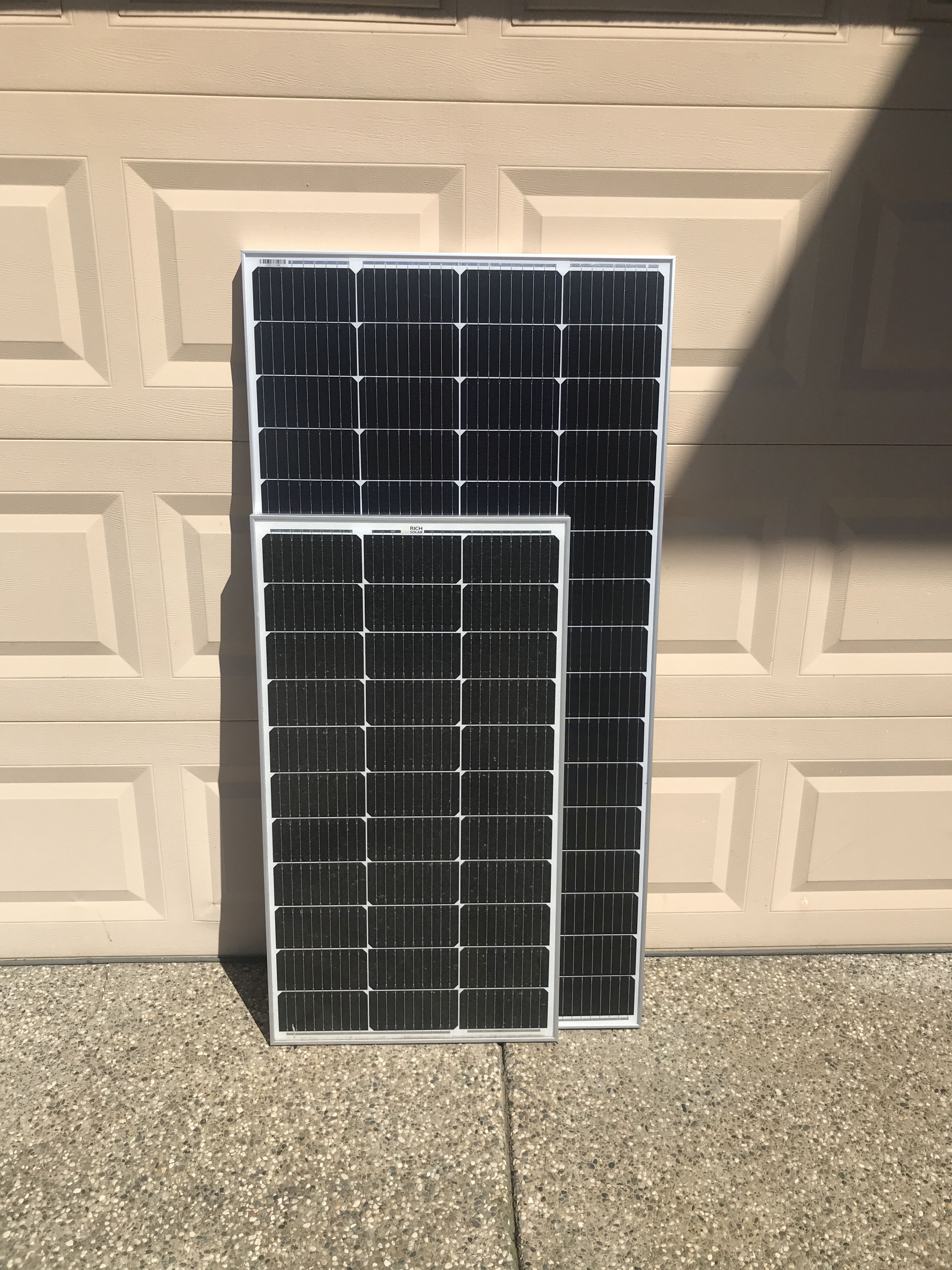

alright it's SCIENCE TIME

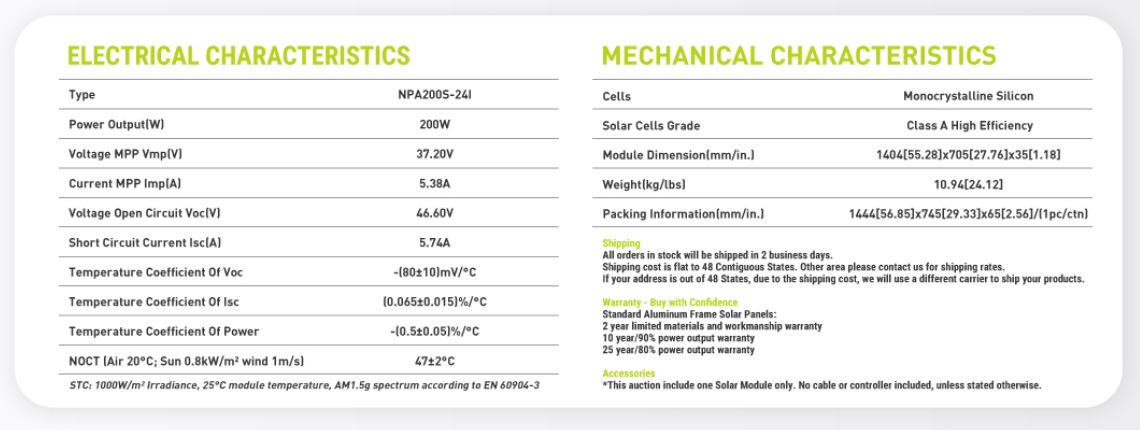

and I'll be honest with you I feel a little duped, the 200 watt panels are just twice as big as the 100 watt ones, I was expecting more better efficiency out of a similar foot print, filing this under Lessons Learned !
the little guys have three rows of eleven 3x5 cards, and the big panels have four rows of sixteen, so not quite double but double(ish)

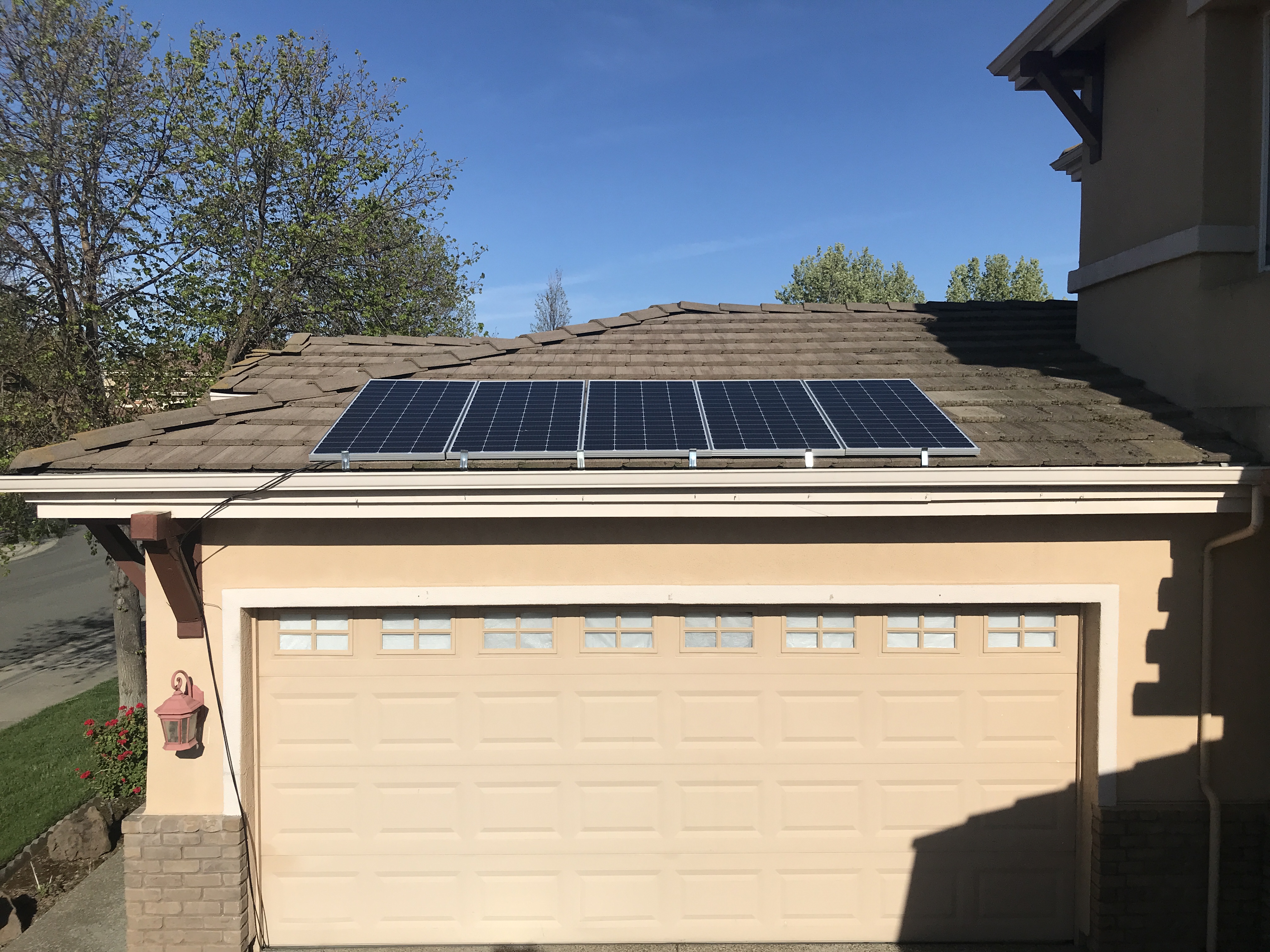

Rome wasn't burned in one day, ok need to do a Home Depot run for some more of them "Quick Release" metal brackets
- Gregski
- Posts: 2876

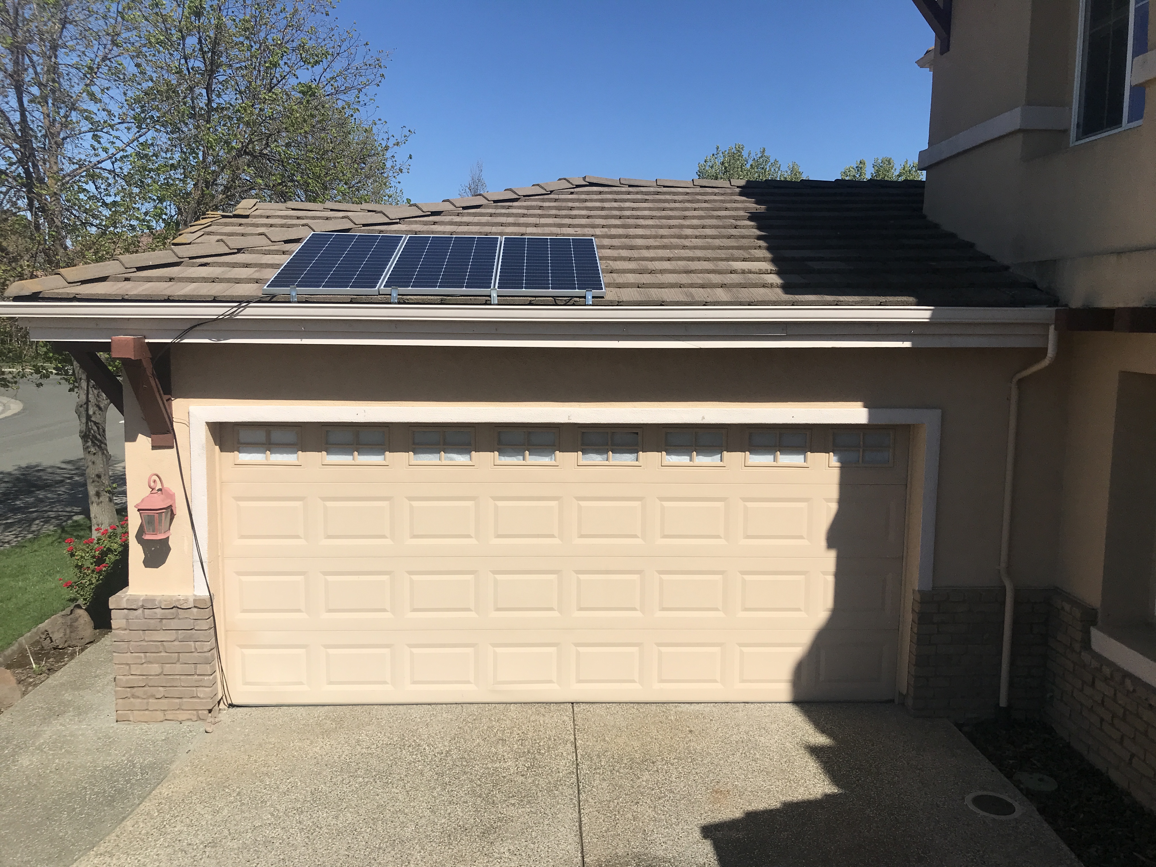

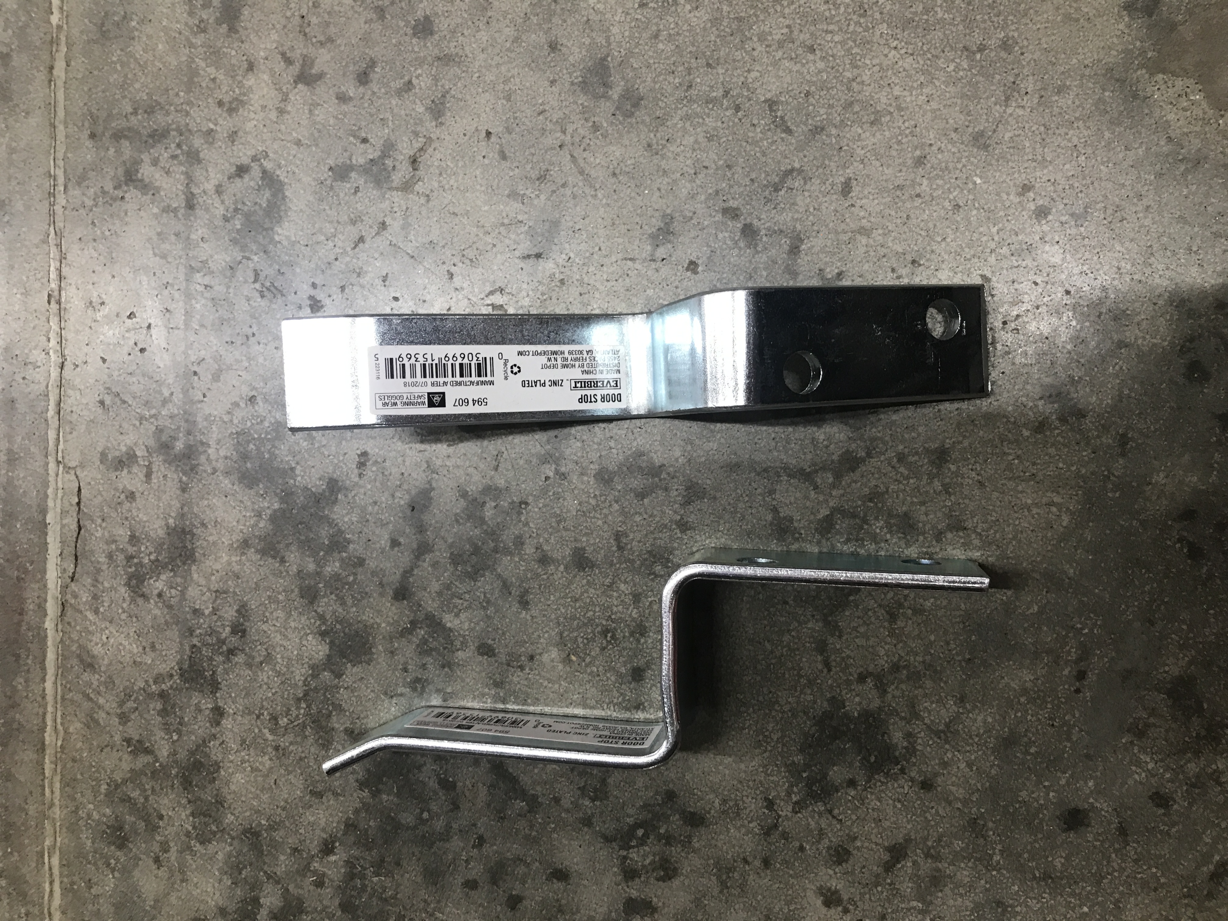

and there it is One Thousand Gigawatts of Power for just under $1,200 bucks
here's the brackets I used, they used to be $4 bucks now $6 and now HD gives you less metal
adding this update from the future in here so you know how this system is doing/performing, in mid May of 2023 it is capturing 5 kWh of sun per day, that makes The Greg very pleased
it is important to note the following imperfections of this system
- it is deliberately pointing West instead of South (the more ideal direction)
- the panels are not adjusted at the ideal angle they are just laying on the pitch of the roof
- the house casts a shadow on at least one panel for the majority of the day
- as I write this the panels are dusty and dirty from the last rain
