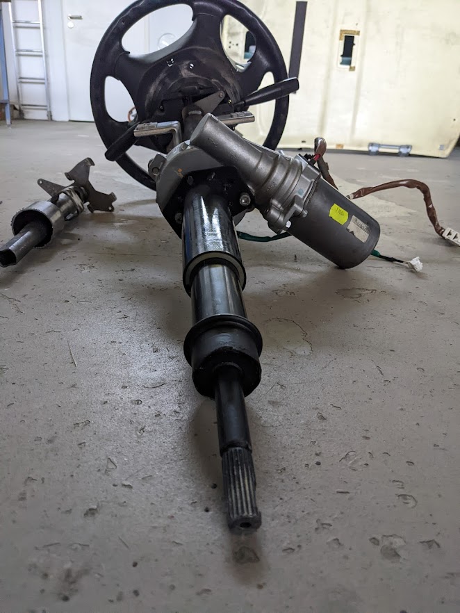

Bratitude wrote: ↑Mon May 09, 2022 12:54 pm
Was it just hard to source a electric Subaru steering rack?
They are like legos…
Never thought of that - did you use one? Do they fit in the older models?
Re: Subaru Impreza 96 - AWD with 2 Outlander rear motors
Posted: Tue May 10, 2022 7:56 am
by Zapatero

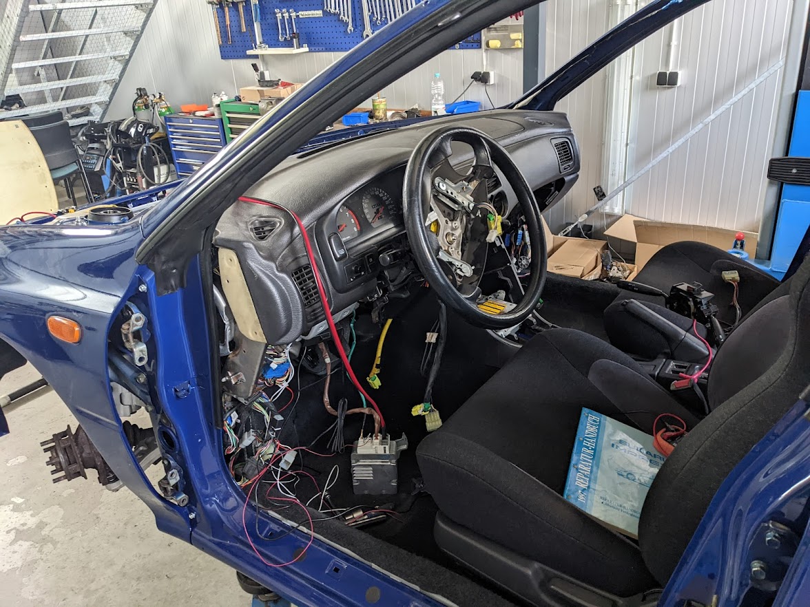

Before and After, allthough i already took the original column apart.
It's in the car, but there's still a lot of work to do:
The Impreza is getting closer to be back on it's wheels:

Zapatero wrote: ↑Tue May 10, 2022 7:53 am
I swaped power steering racks in to cars with a 20 year gap, that being said after a quick search it dose look like the newer EPS racks have a different mount.
Your Prius eps should still maintain good road feel and makes open pilot easier to set up

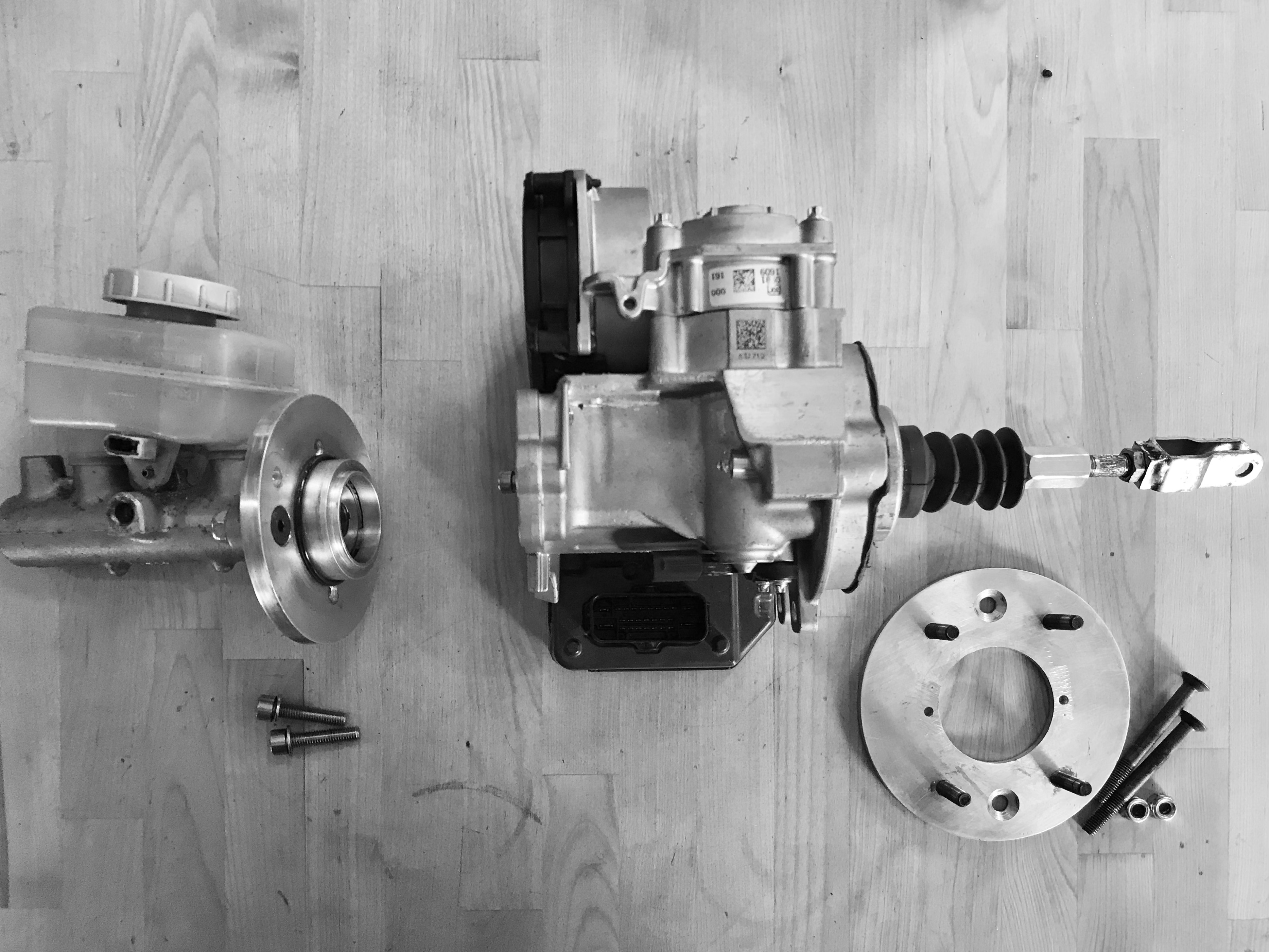

by EV_Builder
Brakeing is done with a servo, electric motor, assisted master cylinder. So your ABS can stay. It's the vacuum servo etc. what can go.

I made some adapters for my Ibooster to fit a Subaru master cylinder, and to bolt up to my pedal box

Bratitude wrote: ↑Wed May 11, 2022 9:52 pm
260C62D2-E05E-4655-939A-D68A1EF10BB7.jpeg98957C7D-C0E9-4993-946B-96C7F29AD665.jpeg701F4853-9440-4BB2-97CA-75E3C59AB921.jpeg
Awesome! I'll see how i can mount the brake booster with as little effort as possible.

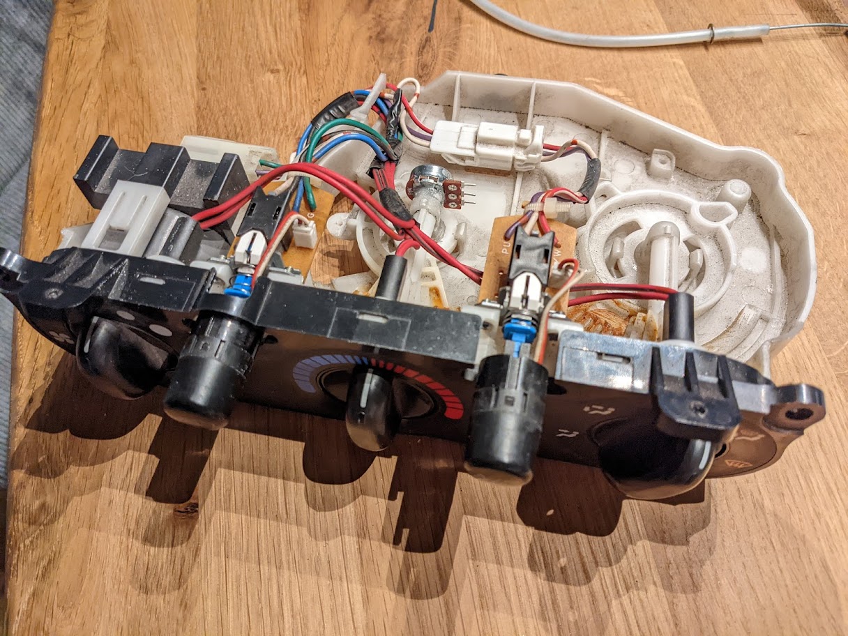

Something else i did was installed a potentiometer to my HVAC unit. Johannes had the idea of using a potentiometer and convert the value to the canbus so the AC or the heater run in variable stages due to the input.
Before
After

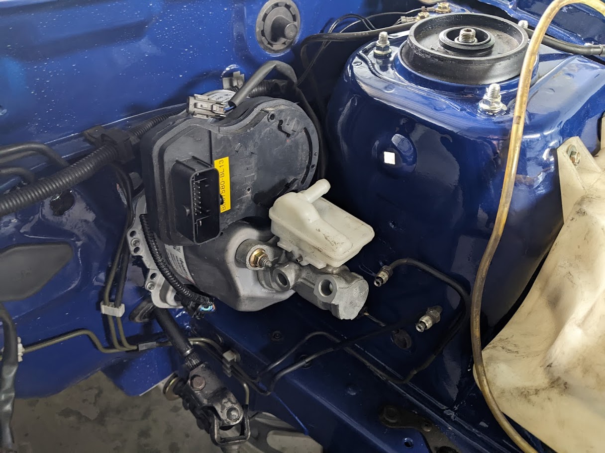

The Subaru is back on it's own wheels:
The iBooster is in the car and fits perfectly well.
Anyone ever controlled the iBooster via CAN-Messages?
Ground Clearance is alright, though i'm going to fabricate a tiny skid plate:

Which booster did you buy? And dit you kept your MC?
Posted: Tue May 17, 2022 9:32 am
by Zapatero
EV_Builder wrote: ↑Tue May 17, 2022 3:23 am
I have a honda 2018 iBooster - hopefully the can messages will be the same like with the tesla iBooster.

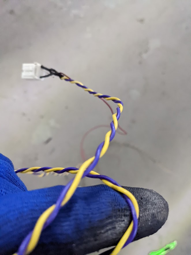

I found out that i can make twisted pair cables easily - did the first one by hand and it took me forever. With the power drill it takes 5 seconds
Nice, twistet pair can bus cables
On This End there's the plug for the prius power steering

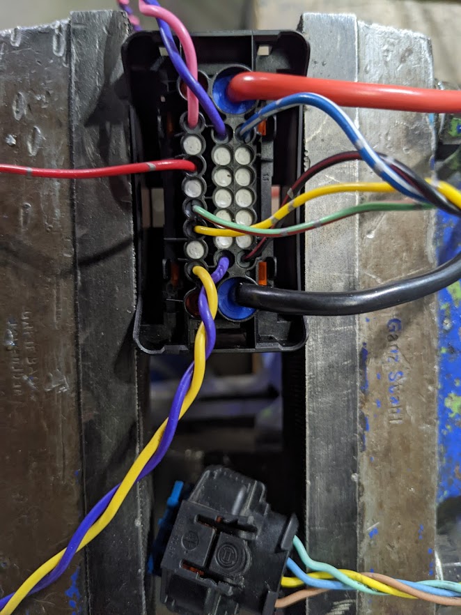

I crimped all the cables for the iBooster plug. I'll connect both can bus systems of the iBooster as i have two can bus systems in my car anyways.
Finished plug
