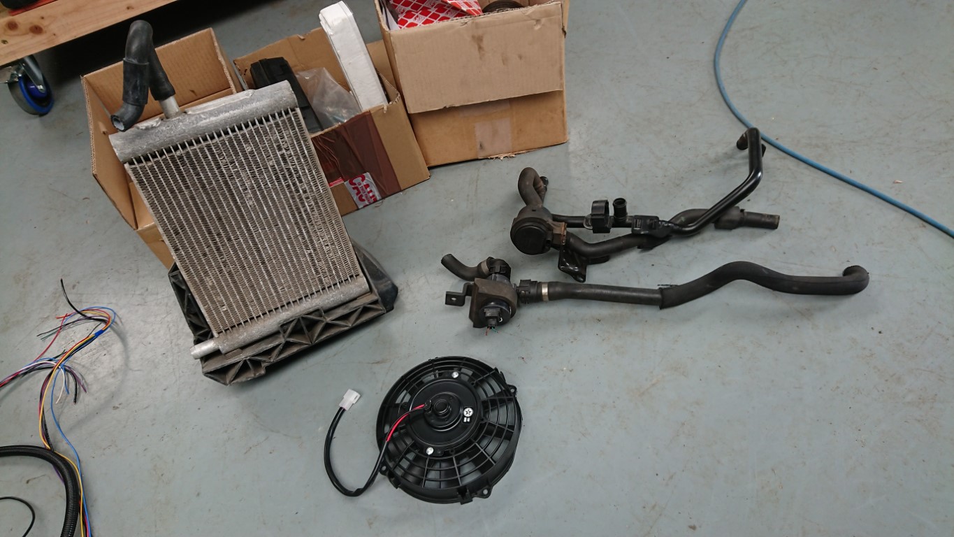

Cooling System:
Settling on two coolant loops to cover both drive and charge modes. The RR has a neat auxiliary radiator tucked in front of the drives side front wheel so got a second one of the same radiators and two 8" pull fans , a set for each loop. Originally fit the BMW coolant pump but veering towards using two smaller units to start and see how they perform. They need a bit of a clean and tidy!
