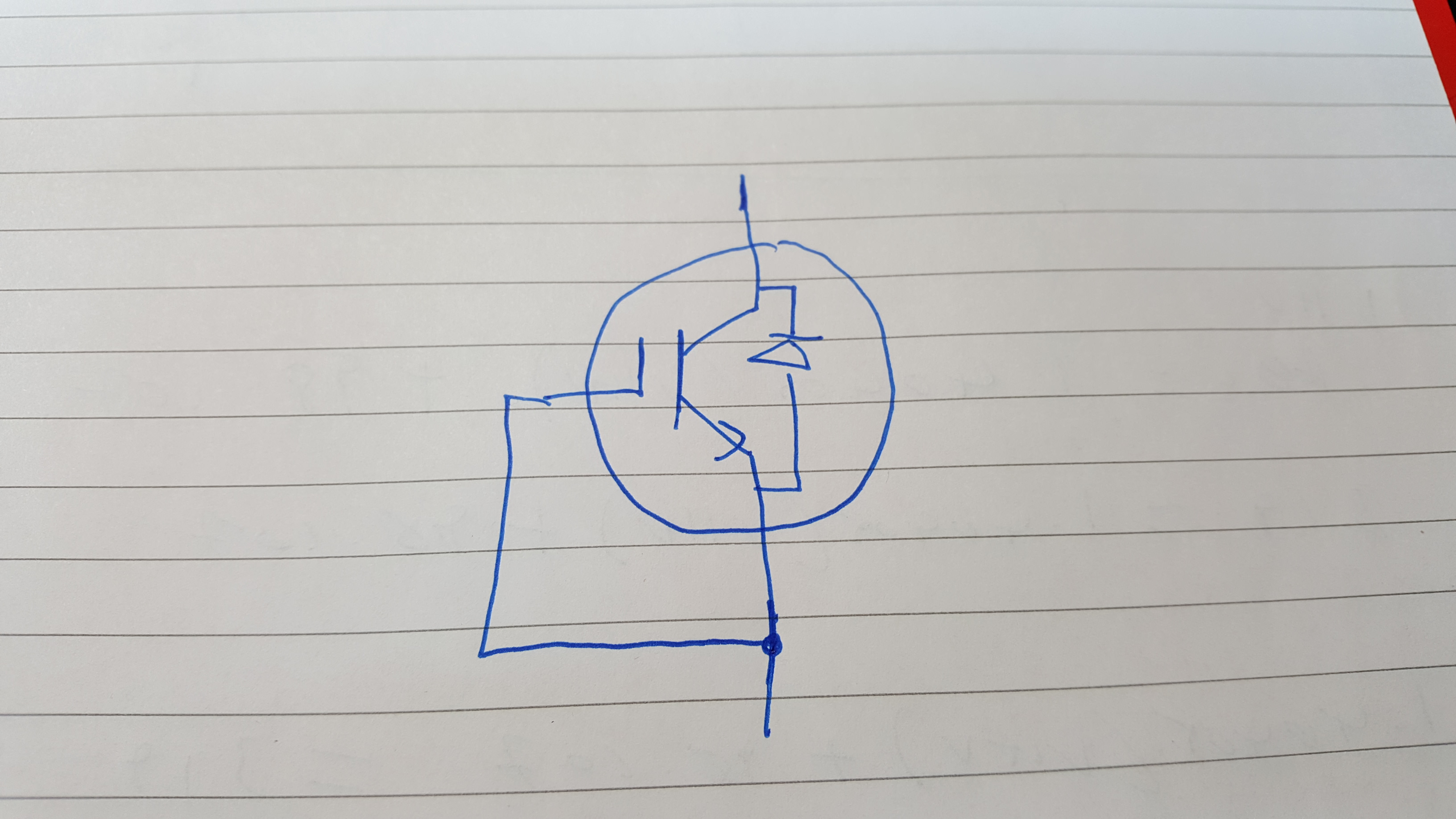

Much as I'd love to join in with a clickbait video of my own I'm too busy getting to grips with the new foc inverter firmware. In the meantime what do you think of my little sketch?

Brilliant!
Ah well, all clear. I see what you mean about the clickbait. Teslaworld is proper weird...

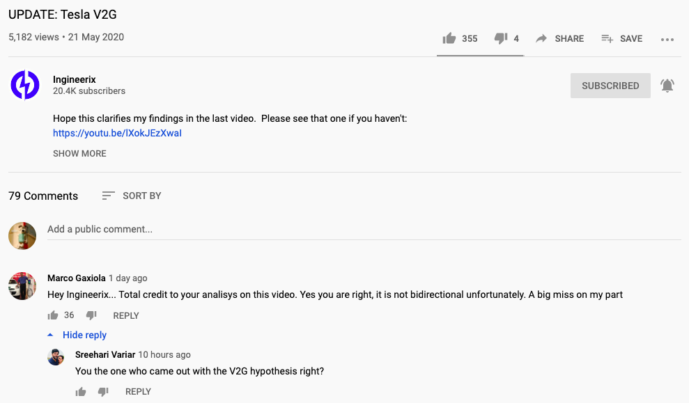

The guy who undertook the PCS analysis and hypothesised V2G capability has now said "it is not bidirectional unfortunately. A big miss on my part" :(

Ok. So how does any of this explain what I observed?

Well of course you must have been hallucinating. No other explanation.
In all seriousness there must have been a hardware change between the parts that these guys have and the charger that you have. Living on the cutting edge :)

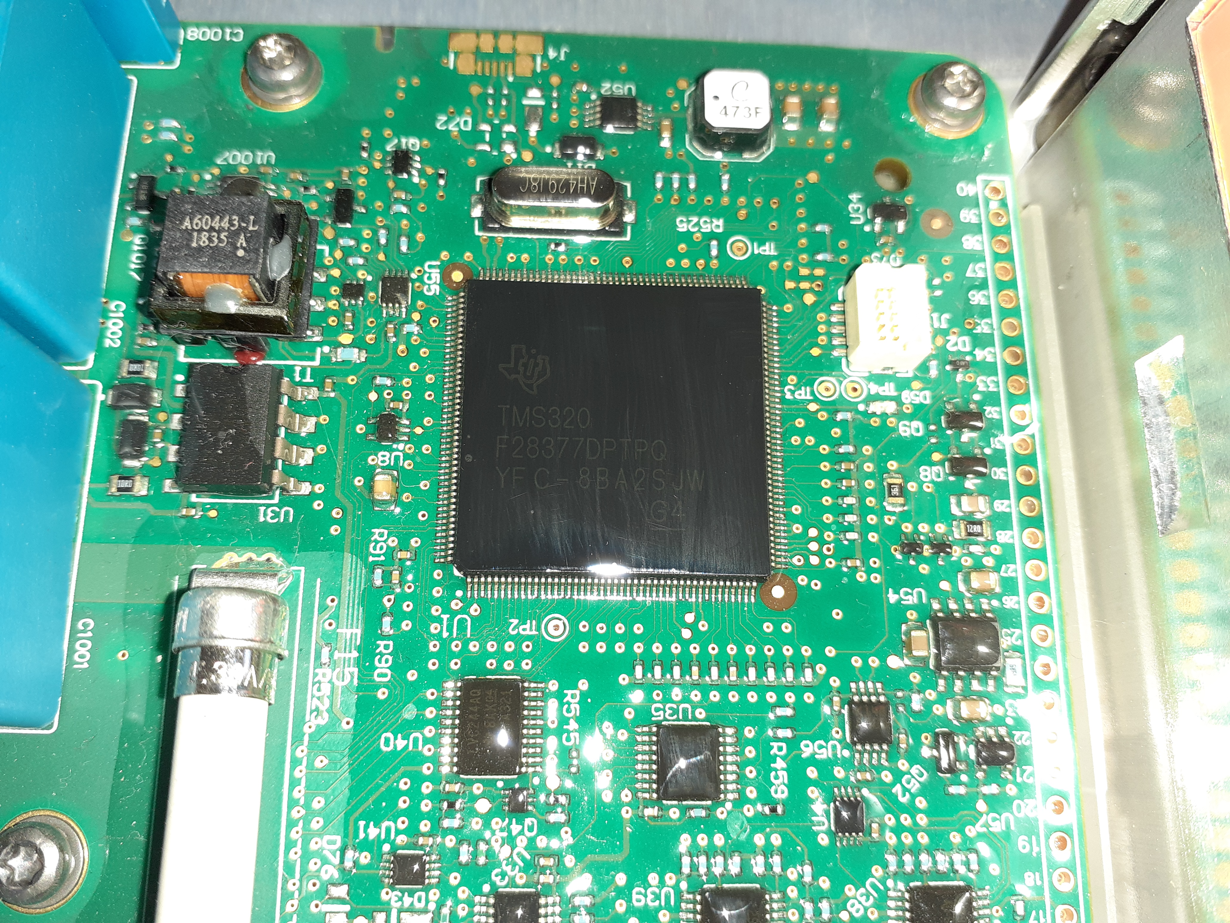

Can anyone take a hi-res picture of the PCS or otherwise tell me the part # of the TMS320 chip(s)? BTW, there should be two CPUs on the PCS. I assume one handles charging and the other DC/DC but I don't know that for sure. All I know is that it has two CPU cores, either both on one chip or there are two chips on there.

collin80 wrote: Mon Sep 07, 2020 1:47 am All I know is that it has two CPU cores, either both on one chip or there are two chips on there.
I think it's one chip (see video)... i'll try and take a photo when I'm next in the workshop :)
muehlpower
Posts: 807
Has thanked: 18 times
Been thanked: 186 times
Re: Tesla Model 3 Charger
Post by muehlpower »
There is only one processor
collin80
Posts: 118
Been thanked: 15 times
Post by collin80 »
muehlpower wrote: Mon Sep 07, 2020 11:50 am There is only one processor
Awesome! Thank you. That indeed is dual core!

I'm glad I could help. If you need more pictures or information, I have a Europe and a US version here.
