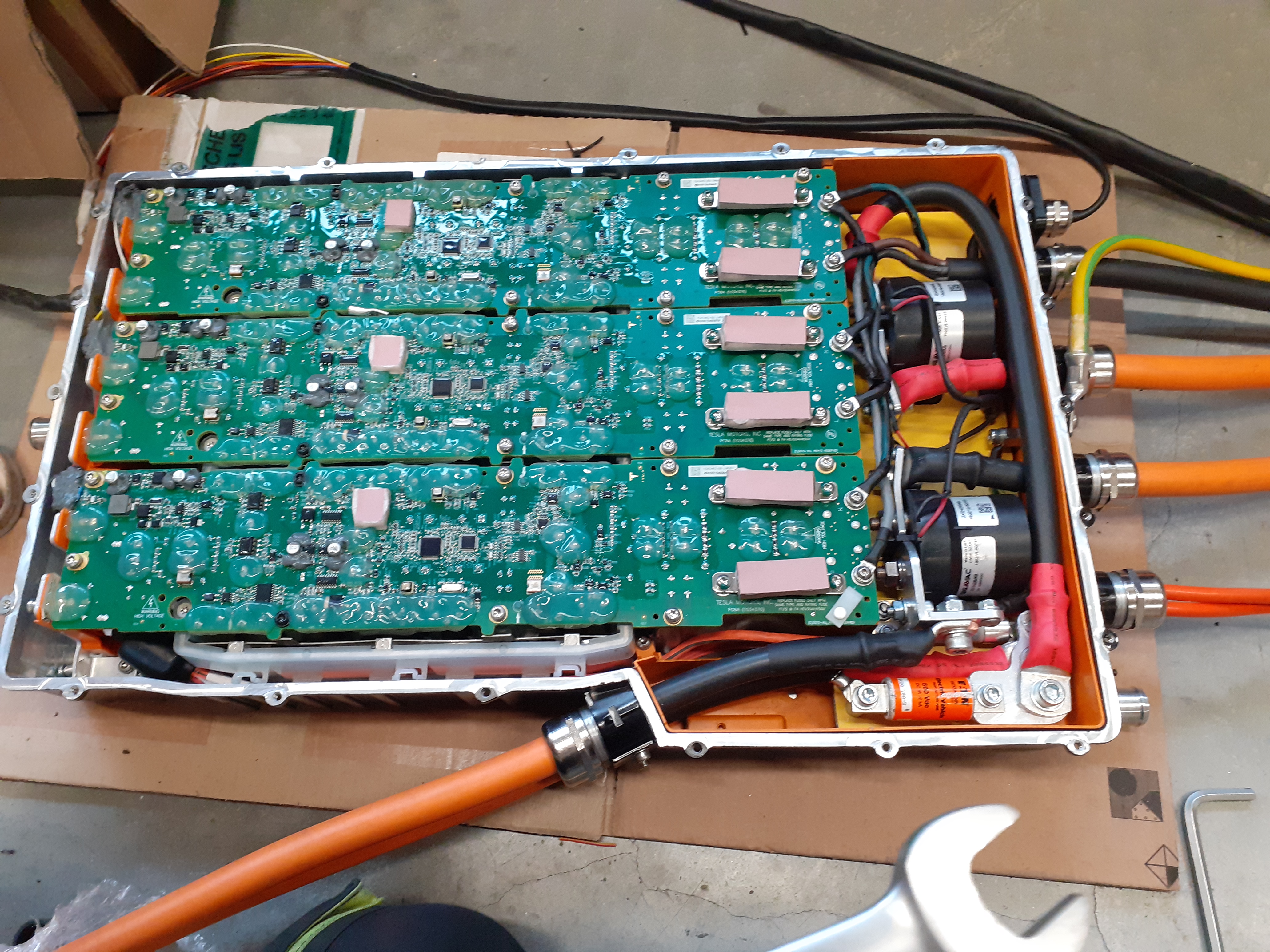

muehlpower wrote: ↑Thu Jun 03, 2021 9:32 am
The Contactors are controlled by PWM, as jou can see at the OSZi, so it would be fine to use contactors without economizer, like the original Tesla model 3.
The first prototypes for voltage measurement are ready. In the screenshoot "DC spannung am Stecker" compared to "Bat Spannung Akt." measured by the ISA shunt. It seems the LIM only works on voltages above 200V.

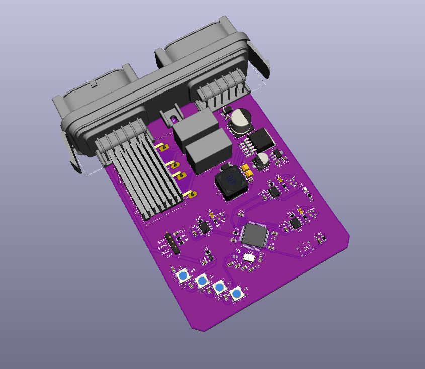

Update for anyone following along. Been spending some time getting the dual Volt BMS portion implemented and I think I've got that all squared away. Need to do some more charge/discharge cycles to verify the balancing is working correctly.
I also need to do Rev2 of the board. I undersized the 5v LDO and the output current is OK at 12v, but nose dives when input voltage goes up to 14.5 with the dcdc on. That sends it into this spiraling doom of thermal protection.
Another thing Im going to try doing is getting rid of the HV board connection and getting that input off an ISA shunt over CAN. Ill then take that signal and PWM off the 5v voltage bus to output the correct voltage scaling to the LIM. This limits the amount of HV wiring and should give the LIM everything it needs.
I also upgraded to two to-247 package 15ohm resistors for the LIM contactor circuit. The smaller smt were warm but OK with the heat sink, the larger package and direct application of a heat sink should be a more robust solution.
Will upload the revised design and what I have for dual Volt BMS code. I started porting Damiens VCU LIM code over to ST HAL compatible C. Its not yet functional as I need to deal with the fixed point stuff and port the CAN RX handling..but it does compile which is a first step.
New layout. Open to feedback if my PWM voltage to the LIM is a stupid idea as well.

You then need an extra ISA shunt, which must also be connected to the HV line. So it needs as much HV cabling as my solution. I put everything in the charger, so I don't need any external HV lines.
The two thick cables on the right go to the charge port, the two on the lower edge to the battery. The two little orange ones supply DC/DC, A/C compressor, battery and cabin heater.
Re: BMW LIM based CCS2 Controller
Posted: Fri Dec 03, 2021 7:08 pm
by FJ3422
jon volk wrote: ↑Fri Dec 03, 2021 5:33 pm
...Open to feedback if my PWM voltage to the LIM is a stupid idea as well....
Will that work ? If I understand correctly, the LIM uses the voltage measurement to verify the pre-charge voltage on the chargerside of the contactors to prevent contactor damage. So that is with the contactors opened. Are the voltage inputs of the ISAshunt not always referenced to the shunt-ground (that is at the battery-side of the charge-contactors) ?
Posted: Fri Dec 03, 2021 7:18 pm
by jon volk
So I should elaborate on my ISA shunt plan. I don't see a practical necessity for the ISA voltage when I have CAN reporting of the BMS. So it would just run the HV measurement off the CCS contactors to the ISA as Im 99.9% sure the current and voltage can be mutually exclusive. Everything is already planned to be in the same contactor box, so there's no external running of HV wires. But again, thats why Im asking for feedback.
If that wont work, Ill need to move to the next larger sized enclosure, which isnt deal breaker, but I like the compact size of this one.
Posted: Fri Dec 03, 2021 9:20 pm
by jon volk
Disregard my ISA tangent. I made it all fit. Still need to do some routing and put the isolation cutouts back.
