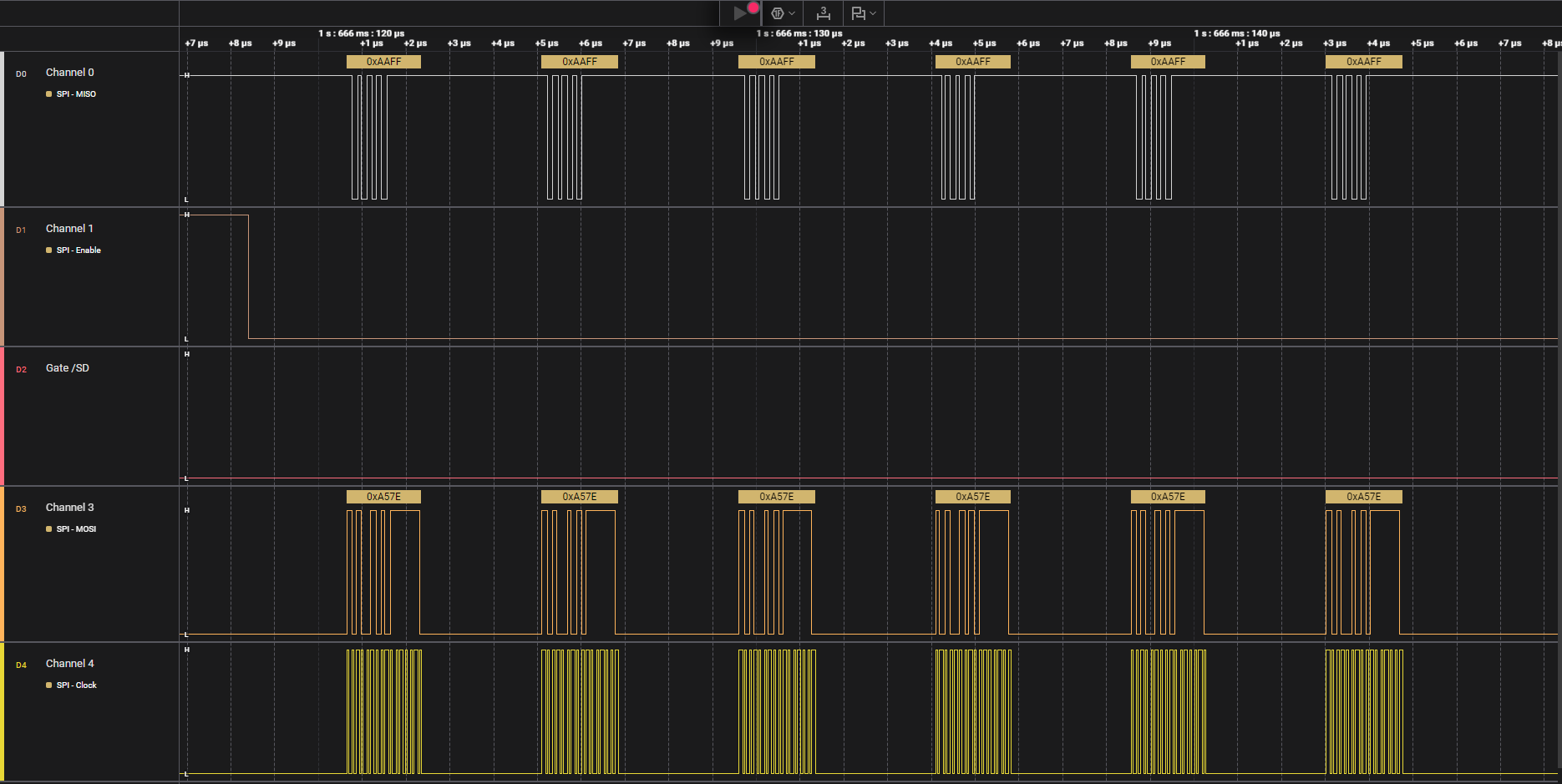

Capture attached. Funny. Am going roofing myself:) Thanks Dave.

I think I've figured out what's going on. The SPI bus is running a bit too quickly. It has to be under 5MHz.
If you modify spi_setup_teslam3() and swap the parameter passed to spi_init_master() from SPI_CR1_BAUDRATE_FPCLK_DIV_8 to SPI_CR1_BAUDRATE_FPCLK_DIV_32. I think this will make it run at 3MHz like the MG (spi_setup()) and hopefully work reliably. I don't think that anything bad will come of running the bus at a slightly slower speed.

Also notable that reading out the registers after writing results in 0xAA for all of them. Perhaps it is indeed a timing thing.

SPI clock at divide by 32. Roughly 2MHz now. Same behaviour.

Clock looks sensible now. I'm still seeing odd values in the SPI decode. For example at 1s 854ms the driver is trying to send 0x9DD6 six times to write CFG2 register but this is decoding as 0x0DD6 and 0x1DD6 sometimes. From the behaviour this looks to be a capture artifact.
From what I can gather the initialisation is completing successfully and is reading OK status values from each of the STATUS1,2 and 3 registers (it returns 0x000C in all cases). I'm surprised it is posting GATEDRIVEFAULT or GATEDRIVEINITFAIL errors.
I have a gate driver test program for the tesla board that successfully initialises the gate drivers and runs for a few seconds before turning off the gate drive PSU and logging the power good pin and gate driver fault status. This shows the PSU fail and then a gate driver fault be reported shortly after. Perhaps doing something like this would be useful.

Just to be sure: sampling clock frequency of the saleae is high enough? And SPI mode is the same for controller, gate driver and Saleae?

davefiddes wrote: Sun May 18, 2025 9:49 am Clock looks sensible now. I'm still seeing odd values in the SPI decode. For example at 1s 854ms the driver is trying to send 0x9DD6 six times to write CFG2 register but this is decoding as 0x0DD6 and 0x1DD6 sometimes. From the behaviour this looks to be a capture artifact.
The analyzer settings in the decoder are set to CPHA=0 whereas the bus communication is CPHA=1. Therefore the data is sometimes misinterpreted, even though it is valid.

davefiddes wrote: Sun May 18, 2025 9:49 am From what I can gather the initialisation is completing successfully and is reading OK status values from each of the STATUS1,2 and 3 registers (it returns 0x000C in all cases). I'm surprised it is posting GATEDRIVEFAULT or GATEDRIVEINITFAIL errors.
No, it is returning 0x08 on STATUS1, 0x04 on STATUS2 and 0xE4 on STATUS3 (but the higher bits are unspecified).
0x000C is the CRC of the NOP command that is sent on readout from the STM32.

also set the analyser to CPHA=1.

Capture with pwm on.

All looks happy (really this time) assuming no fault errors being logged.
Amusingly you can see in the trace just how hard the STM32F1 has to work when generating PWM as there are some odd looking gaps between writes to the chips. This is fine by the protocol as I understand it, it's just the minimum that matters and keeping the CS asserted until everything has been clocked through all the chips.
I think the reason you are not seeing PWM on the output is because the ~SD~ pin is still de-asserted. Stick a call to TeslaM3GateDriver::Enable() in an if at the end of TeslaModel3::Initialize():
