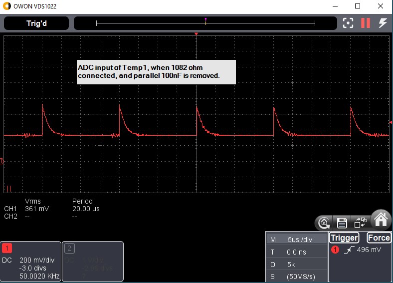

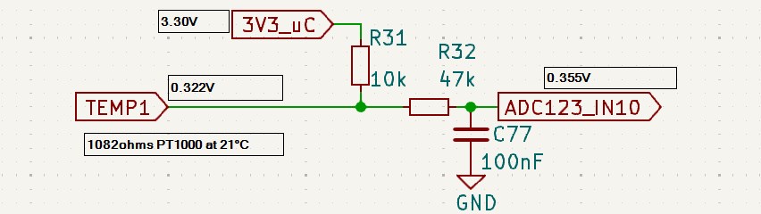

Re: Develop a QCA7000 board?
Analog input problem:
In the user thread (https://openinverter.org/forum/viewtopi ... 744#p88744) it was discovered, that the ADC value for the temperature inputs are quite off, which leads to temperature error of ~40K.
I can reproduce this issue on my desk. When connecting 1082 ohms to the temp1 input, I measure 322mV on the divider, but the ADC input of the controller has 355mV. The expectation is, that the ADC input does not drive a significant current, but this is obviously not fulfilled. To be found out: What is the reason for this current? Is it a solution to reduce the 47k series resistor? Or is it a configuration issue?
[Edit] The 33mV voltage drop over R32 disappears if we hold the microcontroller in reset. This means, that the leakage is inside the controller, and not caused by external things like flux on the PCB.
[Edit2] Potential root cause: The sample-and-hold circuit contains a small capacitor. When converting multiple channels, this capacitor is switched from one channel to the next via the analog multiplexer. Each time, a small amount of charge is transferred from one channel to the next. If the multiplexing happens at a high rate, a small capacitor can transfer a significant amount of charge. To be checked: What is the predecessor channel of the temp1? At which rate are the channels switched?
- uhi22
- Posts: 1244
- Has thanked: 244 times
- Been thanked: 684 times
Root cause confirmed: Removed the 100nF parallel capacitor on the ADC input. Now we see each sampling event. Sampling is done in 20 microseconds interval. This is very fast.
This is much faster than needed.
Next step: check the ADC configuration. 10ms cycle is fast enough for our use case. Also check the sample duration.
Done. This increases the round trip time of the ADCs to 252µs. It reduces the voltage drop over the series resistor from 33mV to 2.7mV.
With this change, the PT1000 input on Temp1 look half-way plausible:
1.3°C at 1000 ohms (expected: 0°C)
22.2°C at 1082 ohms (expected: 21°C)
Binaries: https://github.com/uhi22/ccs32clara/act ... 0790467927
A little bit more improvement would be possible by more slowing down the AD sampling, to further reduce the current which is pumped by the sample-and-hold capacitor through the series resistor. But from my understanding this would need a bigger change, to stop using the continuous conversion. Maybe it is possible to configure the ADC list as single-shot and trigger it from a 10ms task or something like this.
[Edit] With the current solution, there is still a cross coupling from Temp1 to Temp2 of 3Kelvin, if the Temp2 is configured as PT1000 at 21°C and we change Temp1 between open-circuit and ground. The voltage drop over the 47k series resistor of Temp2 changes from 4.2mV to 1.4mV in this case.
- Been thanked: 1913 times
Yes indeed the ADC prescaler is already maxed out at 8 in the 72 MHz default config, setting the ADC frequency to 9 MHz. So no more headroom there.
I see some more possibilities but these would need resistor value changes:
1. Lower R32 to 10k
2. Allow putting 2k2 in series with R31 with solder jumper and assume this to be closed for PT1000 or other low resistance probes
3. Lower R31 to 1k2 (like inverter) and increase hardware version number to handle it
1 is most straight forward as it requires no software change at all and can simply be done by piggy-bagging a resistor on existing hardware. 2 would need solid documentation which is perhaps not read and 3 would only work in the next revision, unless people swap in different resistors for R31 and the version resistor
The problem which we have is a different one. Let me explain.jrbe wrote: ↑Wed Jan 07, 2026 12:27 pm What's a double adc read, discard the first, use the second read give for consistency / target? This would throw away the carried charge from the previous channel-itself for the good read.
I would expect the parallel capacitor would have helped, too small?
Could add an opamp if needed.
One usual issue is, that there is a series resistor before the microcontroller, and this slows down the charging of the sample-and-hold capacitor. If this is the case, it makes sense to take two (or more) samples, to get a more precise inrush to the final voltage. And it helps, to add a parallel capacitor, so that the charge for the sample-and-hold capacitor comes from the strong parallel C, instead of the weak series resistance. In Foccci, we considered this issue, by having a 100nF parallel C on the analog pins. This is much more than the some picofarads internal S&H cap. And is not our problem.
The actual observed issue is, that during each sampling, a certain amount of charge is pumped, depending on the difference voltage between the previous channel and the current channel. This amount of charge is small (some picofarads with some hundred millivolts), but it is repeated. A higher external capacitor does not solve this, because it only leads to longer inrush (let's say 5 seconds instead of 1 second), but the voltage will rise, until the current flow through ther series resistor is equal to the current flow injected by the S&H cap. This is what we measured with 33mV over 47kohms. If we half the pump rate, we get half the current, and in turn half the voltage error. So the solution is, instead of pumping each 50µs, pumping at a much lower rate.
Adding an op-amp to create a low-impedance signal path would be also a solution, yes. But since we do not need high bandwidth, the slower sampling is the cheaper solution.

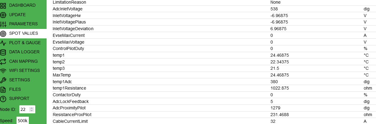

New attempt with 44.122. temp1 is connected to ground with 1k, temp2 is room temperature, temp3 is 40° water bath. temp1 has 0.302V, temp2 has 0.330V, temp3 has 0.341V. Should display 3°, 29°, and 40°!
edit:
My mistake, it was set to NTC. With the pt1000 setting, I get about 5° too much displayed for all three values.
edit:
