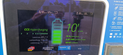

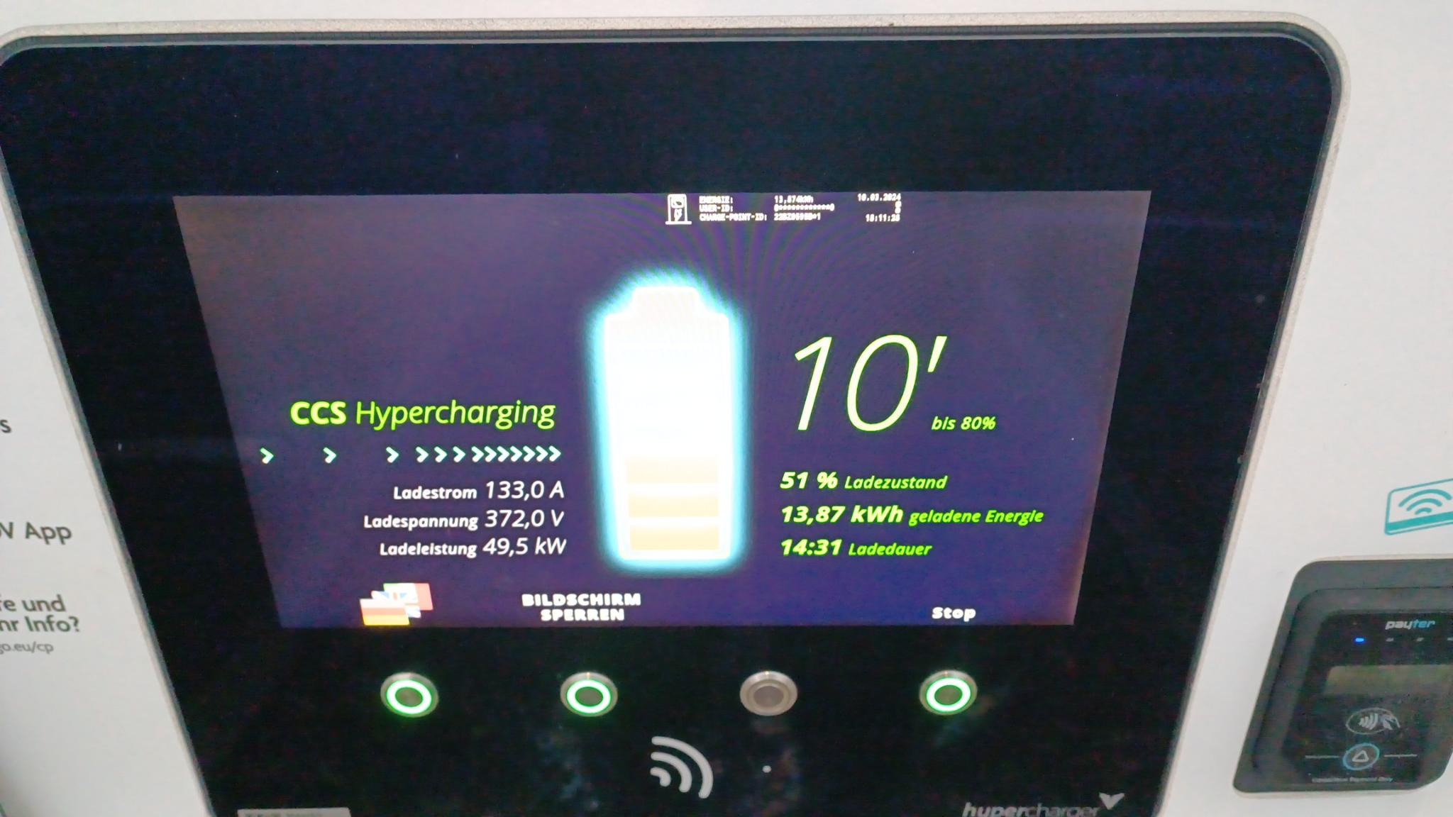

Back from the trip and have some data to share.
I drove the car lightly to the first charge stop and also topped up 9 kWh while visiting Udo (that 3.3 kW OBC is really inappropriate now). I started in the morning with 13°C in the battery and arrived at the one and only quick charge stop with 22°C after 284 km. Again the battery reached 36°C from charging 15 kWh with about 60 kW average charge rate. I throttled it straight from the beginning as I had to leave the car alone to take care of my own business.
The temperature then dropped to 34°C while b-road driving. Then on A49 I drove a bit more spirited with 140 kph cruise control and ended up back home with 40°C in the battery. So 110 kph it is for long range driving until I improve battery cooling.
Temperature is spread evenly across the modules, the warmest one was 41°C and the coldest one 38°C.
I'm no longer 100% sure what it is that starts to smell during a quick charge session. It could also be my 50cm extension lead from the MG charge port. Will check that at some point for signs of over temperature. So maybe I don't need to drop the battery for just that. It seems impractical to charge at 100 kW anyway with a lack of battery cooling.
Next longer trip is to Augsburg via Frankfurt, 550 km. That probably needs 2 charge stops and will supply us with more data.

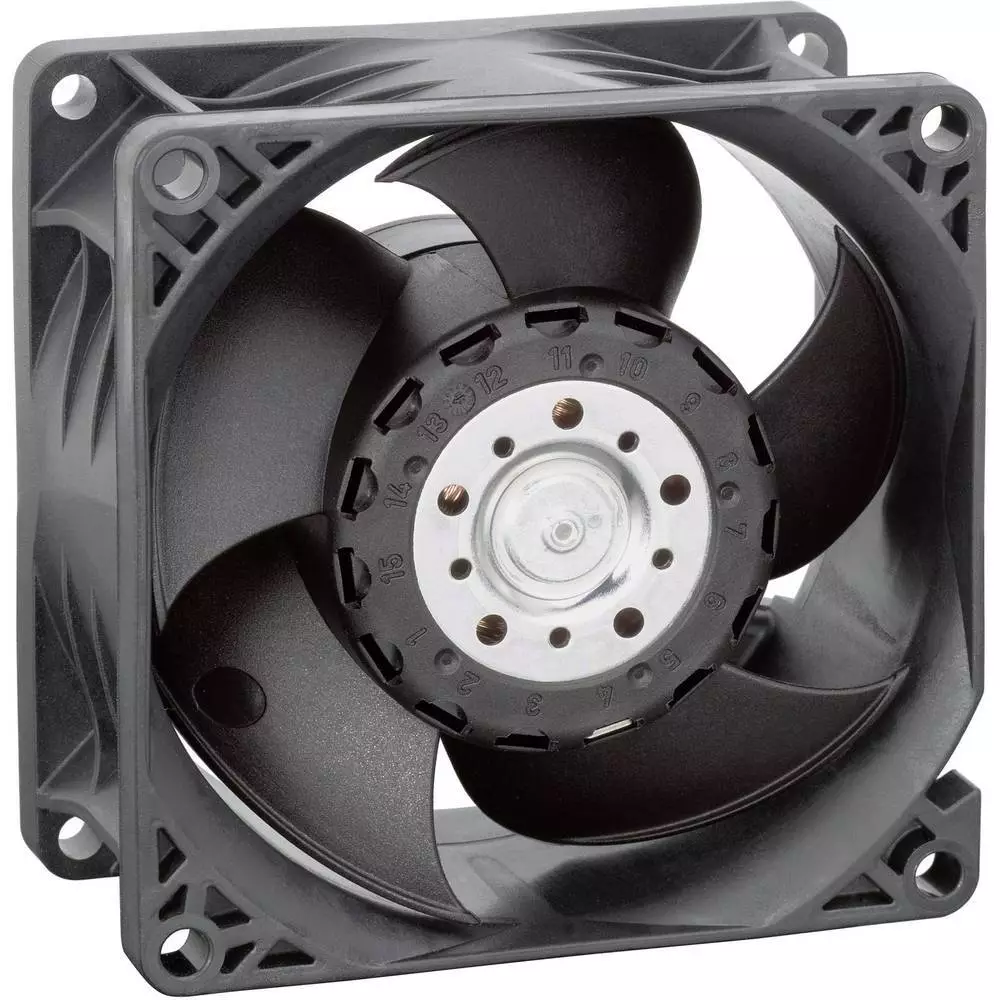

Maybe you can install couple of the ATV fans to blow air across the assembly during charging AND driving? I noticed a lot of difference if i removed the battery box lid while driving. temperature actually wend down 6deg!
The reason to use those is they are waterproofed and resistant to outside use.
This is the fan i am thinking of using in my boxes. It draws about 0.6A at 14V.
https://www.aliexpress.com/item/3301573 ... 1802tPuJlT
This blowers would also be worth trying especially as you can more efficiently direct the airstream over modules...
https://www.aliexpress.com/item/3302106 ... ry_from%3A
I also have this one, but even though it blows quite good it draws 2.5A!!!
https://www.aliexpress.com/item/1005005 ... ry_from%3A

Re: [DRIVING] VW Touran powered by Nissan Leaf
I have such a fan installed inside the battery case.
https://aliexpress.ru/item/32797575257. ... 3931858497

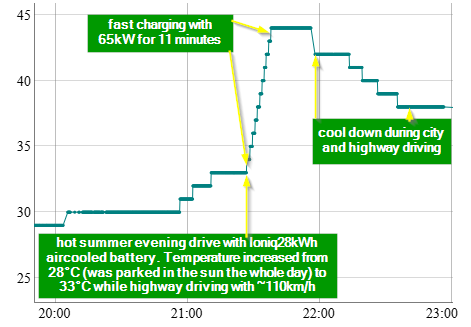

Maybe getting some stick on temperature labels will be good for your testing
It "logs" highest temps.
https://uk.rs-online.com/web/p/temperat ... ls/0285914
Good suggestion! Was thinking about some 1-wire sensors but this is even easier.

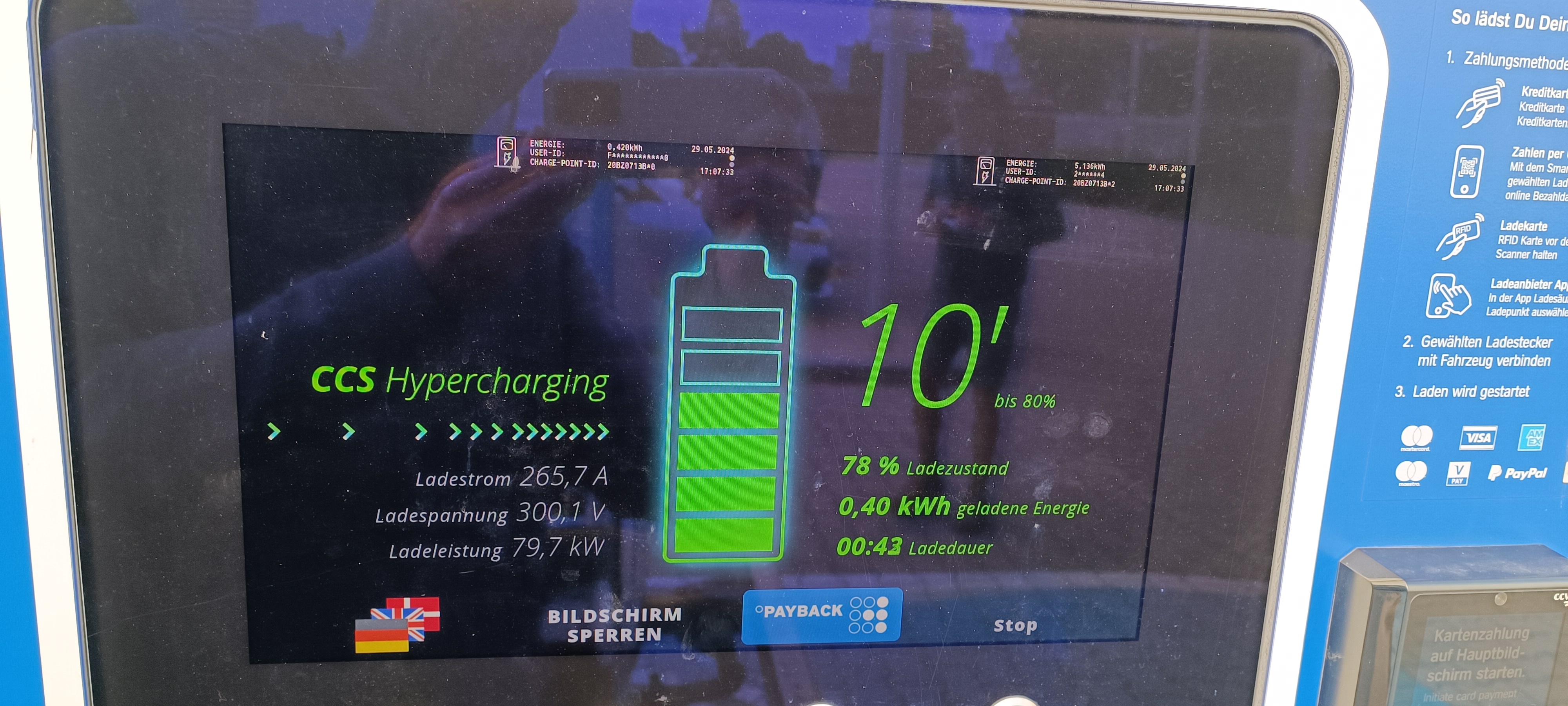

Yay, road trip reporting time
Another 1000 km covered going to Augsburg and back.
Key takeaways
Went for another charge stop about 200 km later and added 18 kWh in 20 mins before rapid-gate. Charged another 10 minutes before arrival because I wasn't sure of the accuracy of my SoC calculation and we thought it was a bad idea to test it at night and freezing temps
On the return trip I did a nice 28 kWh charge session in 30 minutes heating the battery from 18 to 40°C. After that it hardly cooled down because consumption was rather high. Rain, headwind, 3°C ambient and high-ish speed (120 kph) did not help. So the second charge session heated the battery to 50°C and completely ramped down charge rate to 0 already at 45% while I was eating a burger.
So instead of going straight home I had to insert another 5 minute stop once the battery had cooled down a bit.
I have also moved the derating point for the discharge current from 50°C to 52°C so the car is still somewhat drivable after overheating from charging.
More on the event that we intended will be published in the Events section

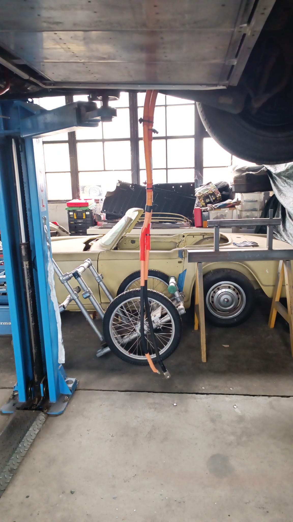

Not sure where this post fits best as it is kind of a road trip, EV improvement and CCS mix.
So, I went to Hamburg to meet Mathieu who has done various conversions like the Mustang and Toyota Land Cruiser. Plan was to get CCS up to speed on the latter and fix a few things on Touran.
I wanted to make it to Hamburg (300 km) on a single charge but 40 km before my destination and with 18% left I chickened out and plugged in for a few minutes. When I arrived the battery had time to rest and let the SoH estimation run: 100.5%
That is with 155 Ah configured (158 Ah is spec). So the 18% were accurate and I could have made it on a single charge. Also I didn't start at 100% but 91%.
Anyway, I met Mathieu the same night, we updated firmware on his Foccci and went to Ionity which hadn't worked previously. Now it did: Now he can use up the 1500 kWh that he won on the 2022 e-cannonball
The next day we fitted a pull-up resistor to 5V to the PP line and now Tesla also worked: There was no lack of spectators, Tesla staff from the adjacent Tesla service center.
Then we changed the CAN mapping to use 9 bits for the current request to be able to charge at more then 255A which also worked: We saw 300A briefly but the battery was too full.
On Touran I redid the extension cables from the CCS port, they are 50mm² all the way now. Then I cut open the battery box a bit more to reach the upper battery pole bolt that I suspected wasn't tightened. We made a special T30 tool and I gave it a slight twist. It should be at around 10 Nm now which is spec for an M6 bolt.
Finally I fitted a fan that is supposed to flow air in through the inner two BMS cable holes and exit through the outer ones. I stuck some corrugated tube into the outer ones as an air guide. Indeed there is a small air flow when running the fan. To be tested.
On the way back I drove in heavy rain and encountered 3 accidents. With improved confidence I emptied the battery down to 9% or 3450 mV per cell. Perfect balance down there, just 3 mV delta, likewise at the top. So they are really well matched.

On the hardware side I fitted a larger fan: 14000 rpm, 40W, 230m³/minute.

The temperature increase while just moderate driving is surprising. Maybe there is still unintended resistance in the module connections (oxide, missing screw torque?).
For comparision, my also air-cooled Ioniq, which has a quite low temperature increase while highway driving in summer. The blower only started while fast charging.

Well actually those plots sort of align. I add 10 °C by driving 250 km with a taller and heavier vehicle while you add 5°C by driving how many km? Also it looks like the Ioniq battery also collects most heat towards the end.
What's way better in your case is the cool down.

It was around 120km in my case. I was hoping, that the way bigger battery has much less resistance, so that the heat produced with guessed 20kW highway cruising is negligible. Are there any data sheets available for the ID battery regarding the resistance and heat capacity? This would allow some simulation, and comparing with the measured data.
