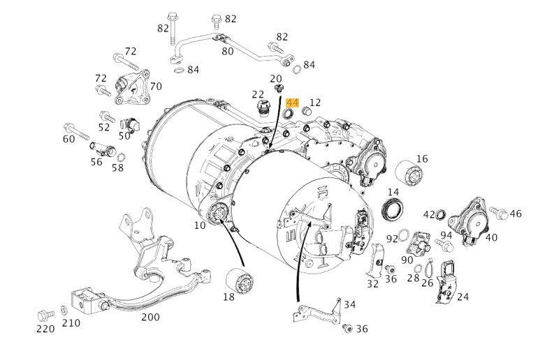

Slightly odd but my drive unit seems to have a cooling pipe that I can't see on other LDU's. It is a small bore (about 4mm OD) stainless pipe that comes out of the top of the coolant outlet (part 90 on the pic) and goes up and into a small hole on top of the ldu. On other ldu's I've seen the hole in the coolant outlet is blanked off and the hole in the top of the ldu isn't drilled.
Does anyone know anything about this? The main reason I ask is that the thin stainless pipe has puled out of the small brass olive that seals the end and I was wondering if it needs replacing or some sealant or something. Then I looked online and can't find it shown on any Tesla part fiches.

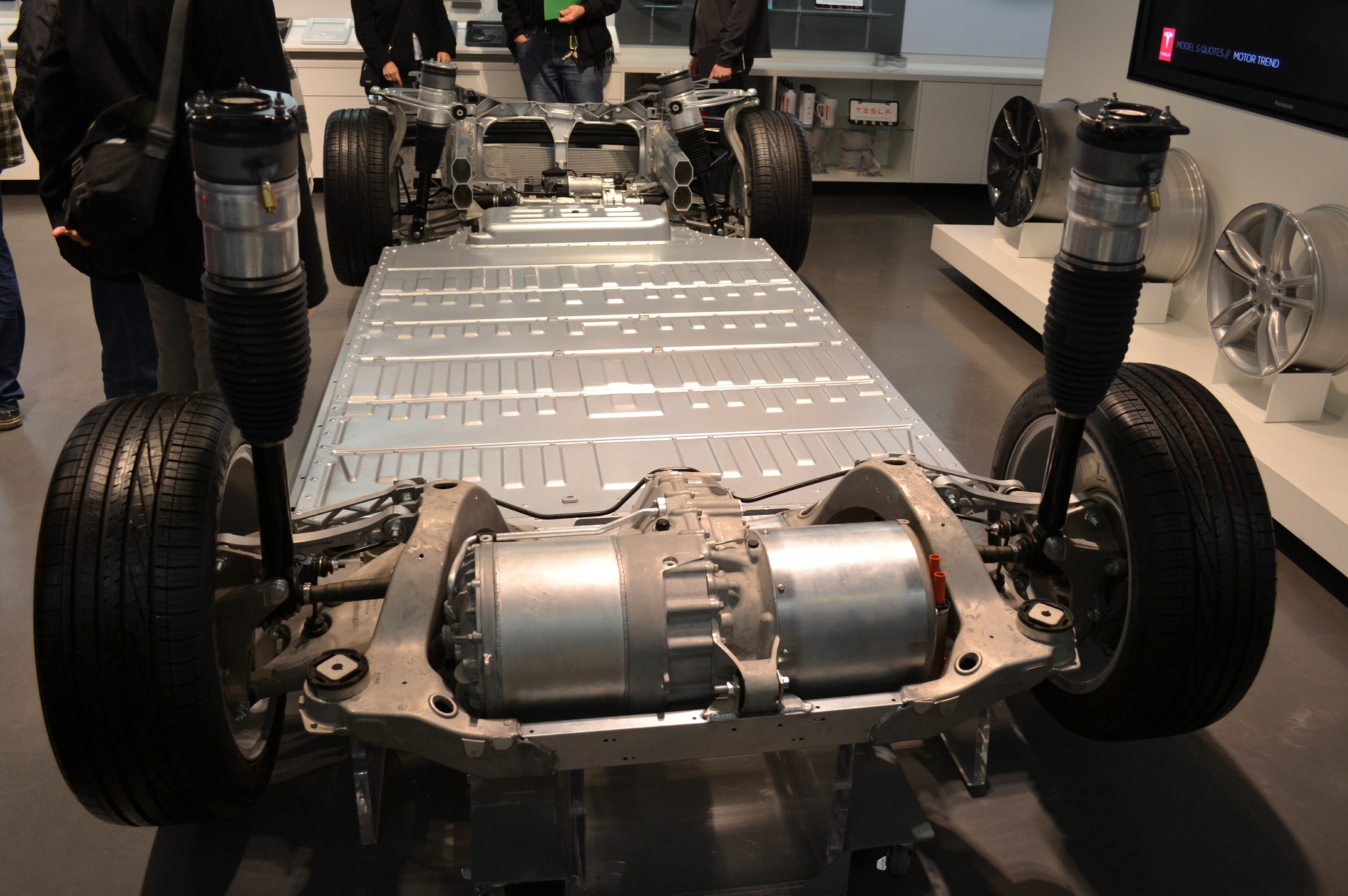

Actually, I managed to find a picture on the Tesla Model S wikipedia page that shows the pipe I am on about. You can just about make it out directly above the rear mount in the picture and snaking around towards the inverter side.

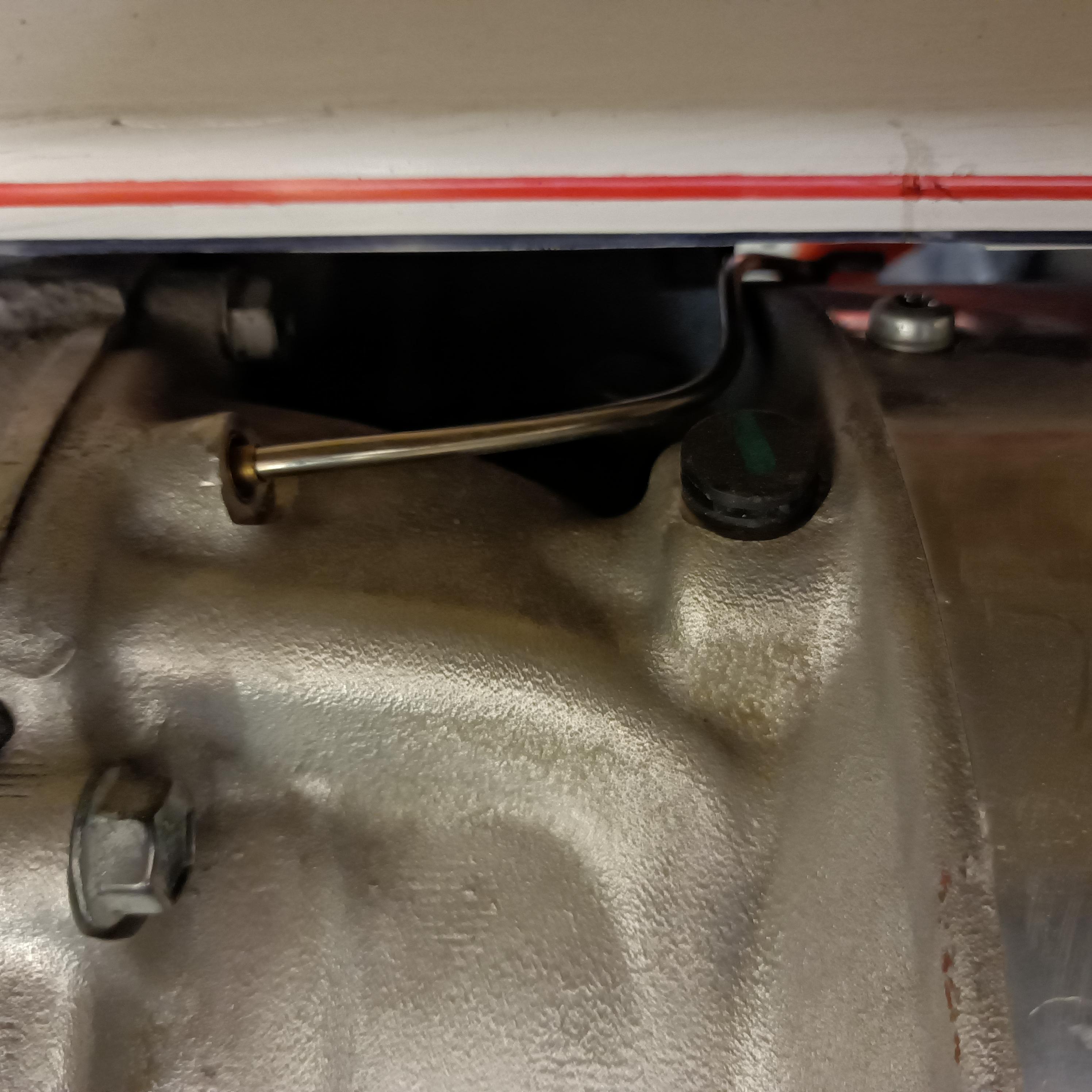

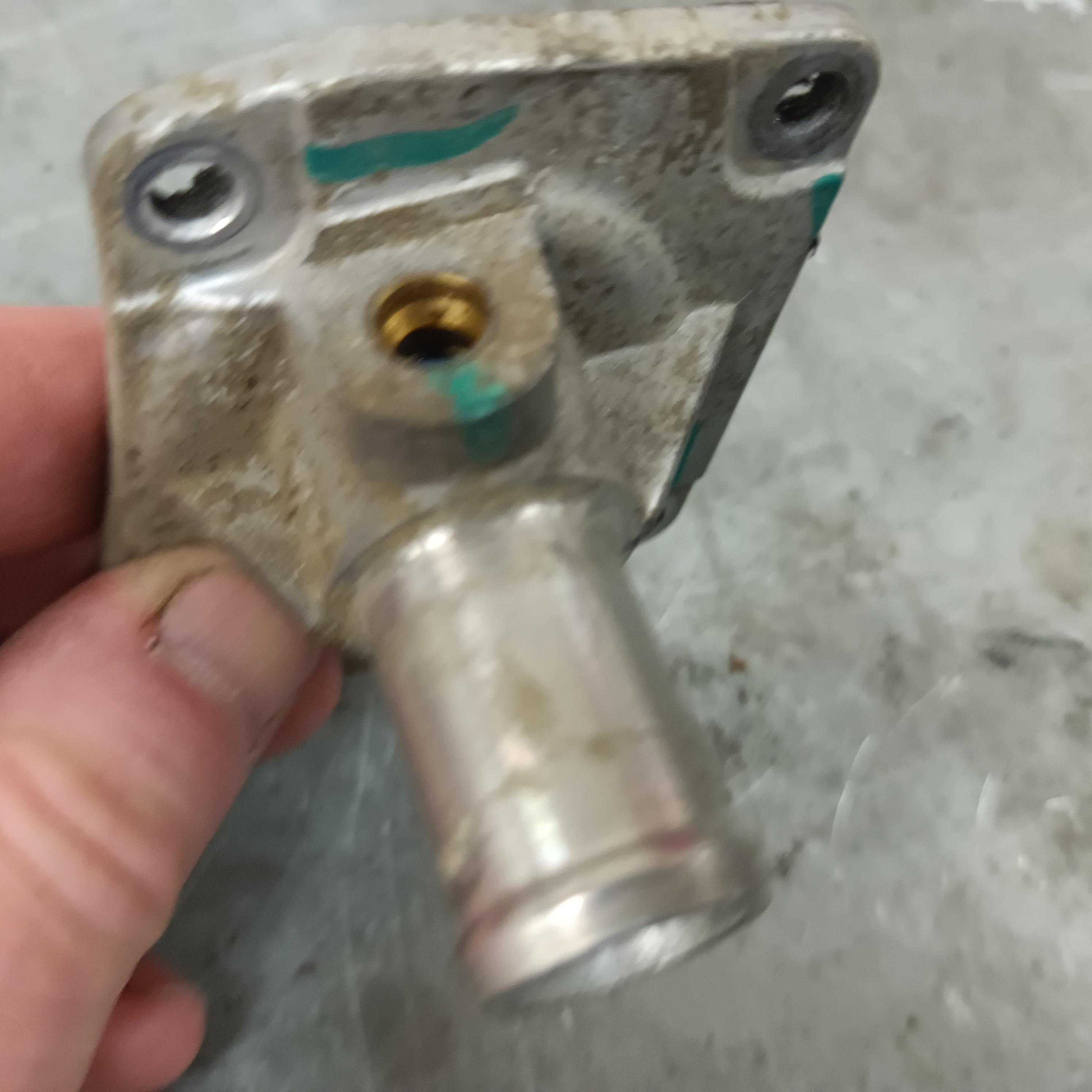

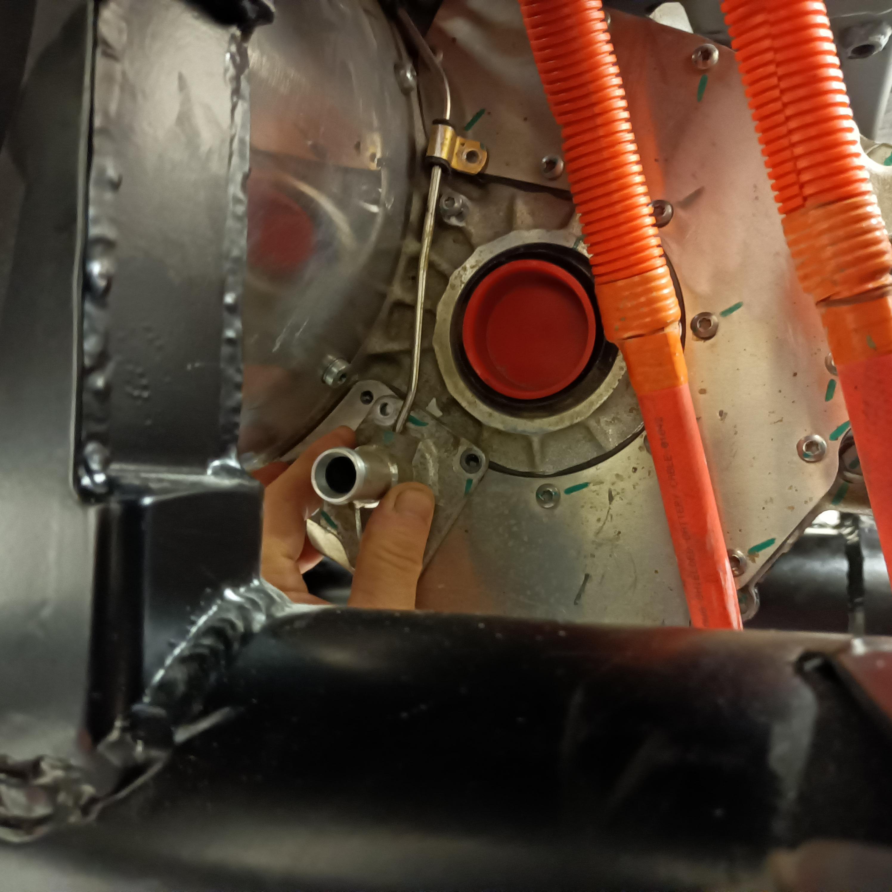

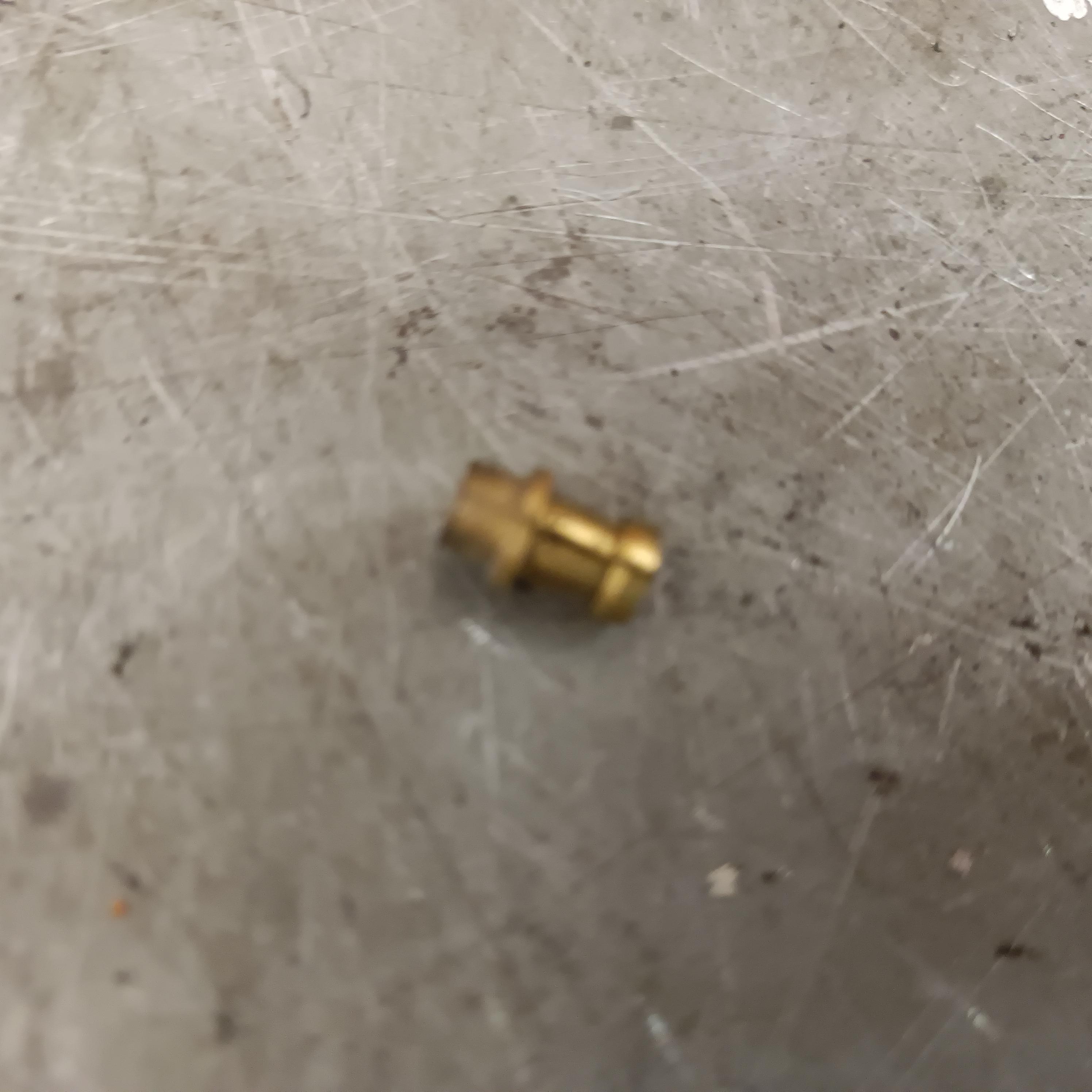

Post by mtrehy »
HI Charlie,
It's not that pipe. I took some pictures of it:

Post by muehlpower »
I have 3 of these motors and none have this line. I think it's to get the air out of the system. Is your motor a very early one, e.g. from 2013? Maybe it wasn't installed later because it wasn't necessary and it cuts costs.

Post by Roadstercycle »
I've never seen that setup either and I've dealt with a lot of LDU setups. I agree it could be a very early unit.
