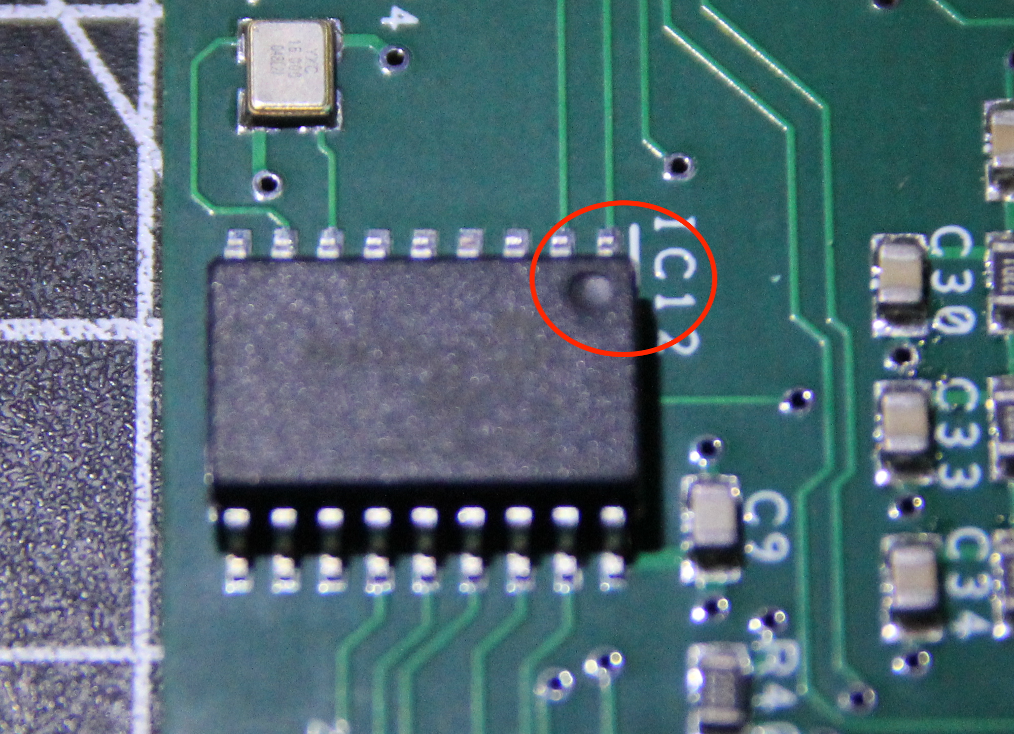

Posted: Tue Sep 06, 2022 10:06 am
by 4markowen
Just double checking before I start soldering the tricky little chips that came with the kit.
IC14 being the hardest to see, but there appears to be a notches to how I've orientated and placed it?
IC12 looks more straightforward and was confirmed earlier, but just wanted to double check.
Check twice, solder a few times, swear a lot
Here's to ruining my eyesight and making sure I don't inhale those solder fumes...
