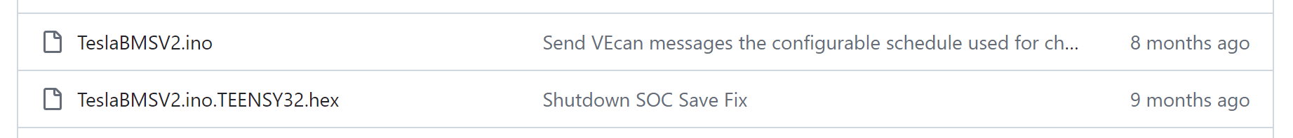

alexbeatle wrote: Thu Apr 04, 2024 2:42 am Hello.
My first time upgrading the Tesla2BMSV2 firmware.
Why are you compiling? There is a .hex you can upload. If you compile your own versions then giving support on any issues is not really possible due to library changes ect.
Re: Simp BMS
Posted: Thu Apr 04, 2024 4:12 pm
by alexbeatle
tom91 wrote: Thu Apr 04, 2024 8:52 am Why are you compiling? There is a .hex you can upload. If you compile your own versions then giving support on any issues is not really possible due to library changes ect.
ok. Learned something new. I'll try the .hex file. Is it the most up-to-date? Shows a month difference between the project and the .hex.
Re: Simp BMS
Posted: Thu Apr 04, 2024 4:18 pm
by tom91
Yes it is, only gotten something in it someone wanted to do. Specific to their usecase, it is not an update from me. The .HEX is from me.
