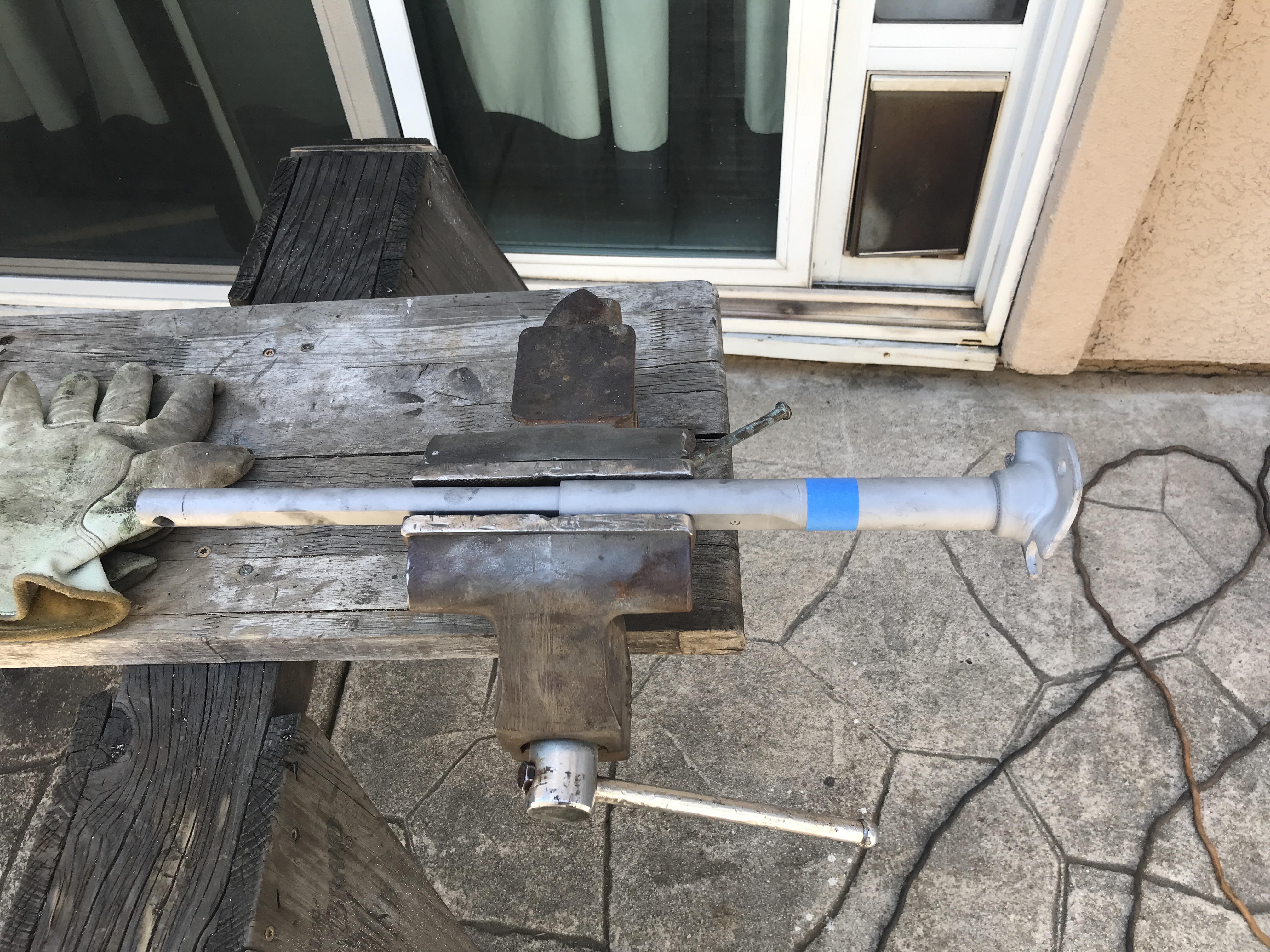

and after all that if I had to do it all over again I would not waste my time pulling it apart I would just cut it right at the join of the two cylinders, in order to expose the shaft
Posted: Wed Jul 06, 2022 3:59 am
by Gregski
alright so gears are turning in my head, this might could work

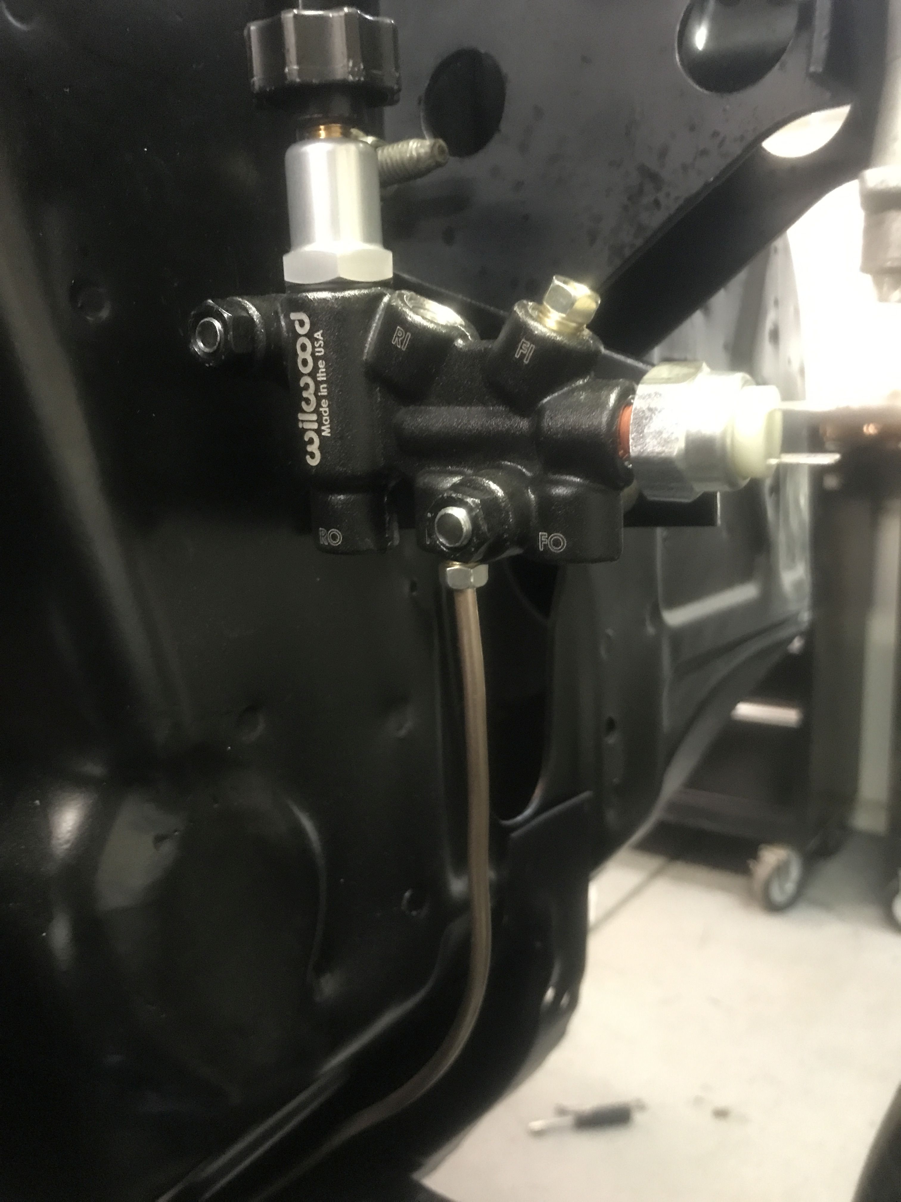

on this episode of Midnight Auto, we finally [start to] tackle the brake lines

Gregski wrote: ↑Tue Jul 12, 2022 5:34 am on this episode of Midnight Auto, we finally [start to] tackle the brake lines
Must admit that I initially installed the brake lines that way.
However, I now believe swapping them would be the correct and preferred way with rear drum brakes.
If you swap them most fluid displacement will go to the rear in.
But I’m curious what you and others think since in the end you want most stopping power from the front discs but that is up to the valve to handle and residual pressure valve to support.
Posted: Wed Jul 13, 2022 4:03 am
by Gregski
larsrengersen wrote: ↑Tue Jul 12, 2022 7:57 pm
thank you for that feedback, really appreciate it, I think swapping those lines shouldn't be too difficult if need be, I believe that Honda CRV came with drums front and rear

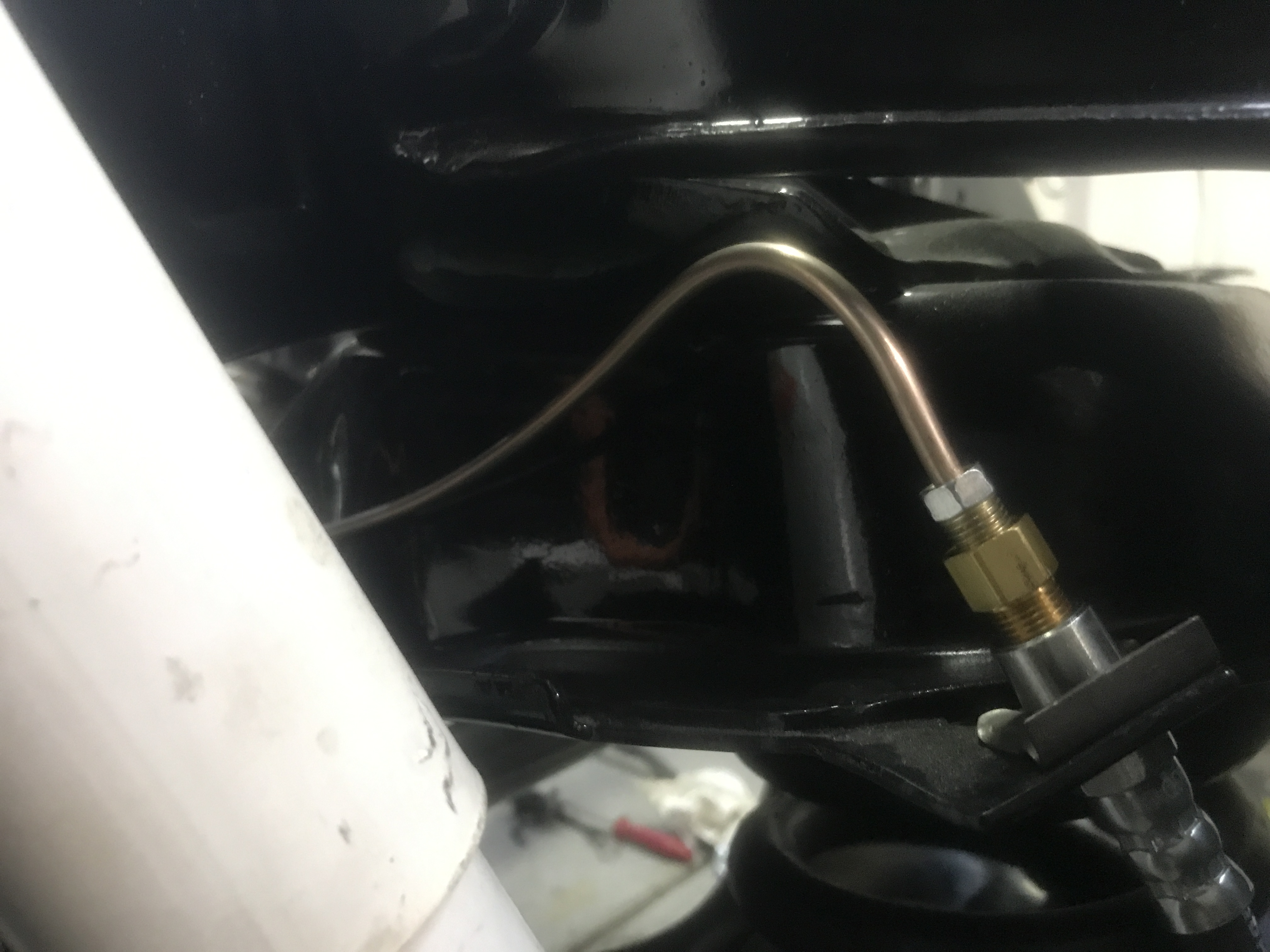

Posted: Wed Jul 13, 2022 4:10 am
by Gregski
plumbing brakes like a Boss!
nice sweeping curves
Posted: Wed Jul 13, 2022 4:12 am
by Gregski
yeah I forgot to put a fitting on my best run, don't judge me
did I mention the nice sweeping curves
Posted: Wed Jul 13, 2022 4:13 am
by Gregski
I think once I clamputize them they won't look so wild
and I ran out of line, I guess 15 feet was not enuff, so I gotta buy another spool to do the rear drum brake line run, not all the way back to the rear axle just to the transmission crossmember

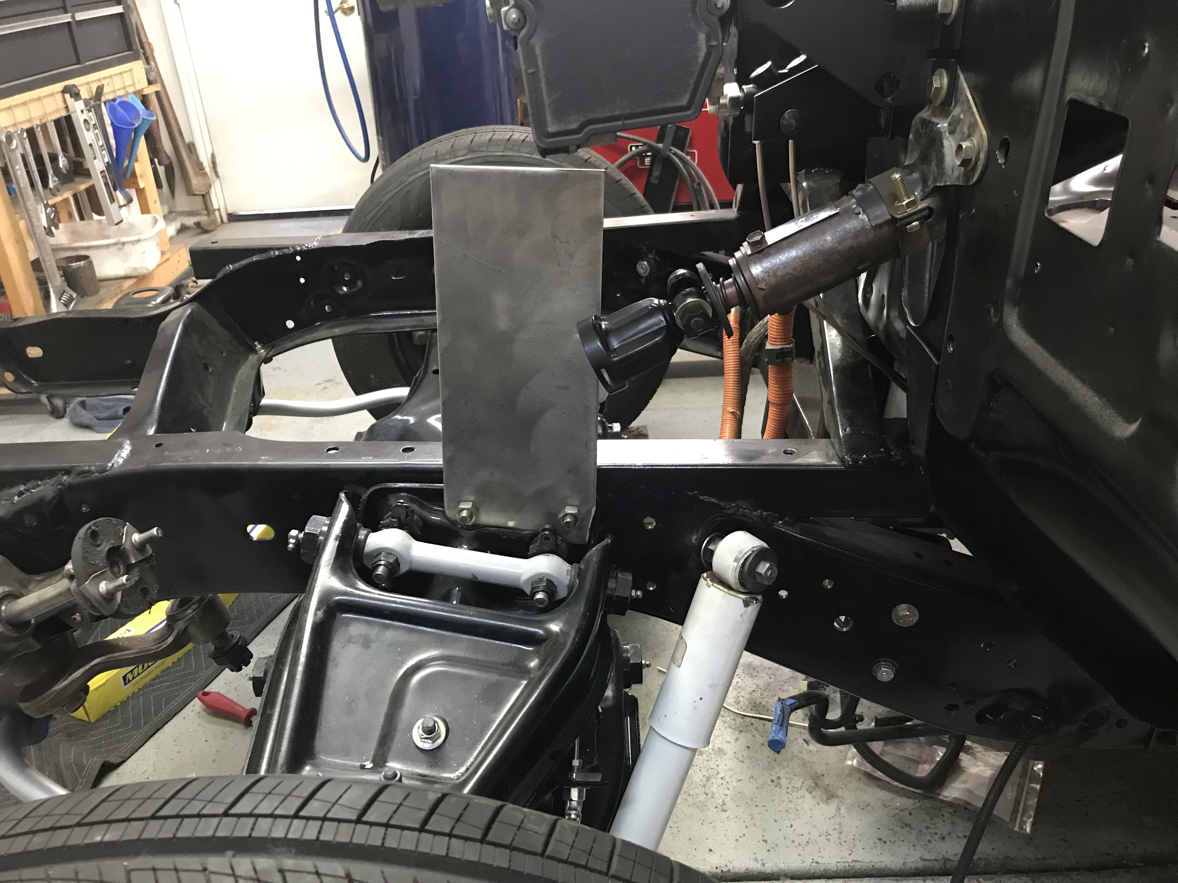

so I decided to install the new old steering column in just for mock up of the Prius electronic power steering
now we can determine the distance the Prius power steering mechanism needs to fill from the Chevy point A to the Chevy point B type of thing

I'm playing catch-up on your project, with the rear driveshaft, why not use the fixed carrier bearing then take your rear shaft to a drive line shop and have them build a sliding 2-piece driveshaft with your driveshaft ends? Like a lot of front driveshafts are on 4x4's. That's how I'm envisioning doing mine. Fixed carrier bearing then sliding 2-piece driveshaft.
Posted: Sat Jul 16, 2022 2:28 am
by Gregski
TheSilverBuick wrote: ↑Sat Jul 16, 2022 2:16 am I'm playing catch-up on your project, with the rear driveshaft, why not use the fixed carrier bearing then take your rear shaft to a drive line shop and have them build a sliding 2-piece driveshaft with your driveshaft ends? Like a lot of front driveshafts are on 4x4's. That's how I'm envisioning doing mine. Fixed carrier bearing then sliding 2-piece driveshaft.
these trucks came with proper drive shafts, I just had to find one, if you get the proper one then all you have to do is have the front half shortened and the Lexus three prong flange welded on it
the advantage of going my route is that you keep the durable / strong GM OEM center bearing support bracket / cross member in it's current factory location
hope that makes sense, and I know ZERO about four times fours, lol

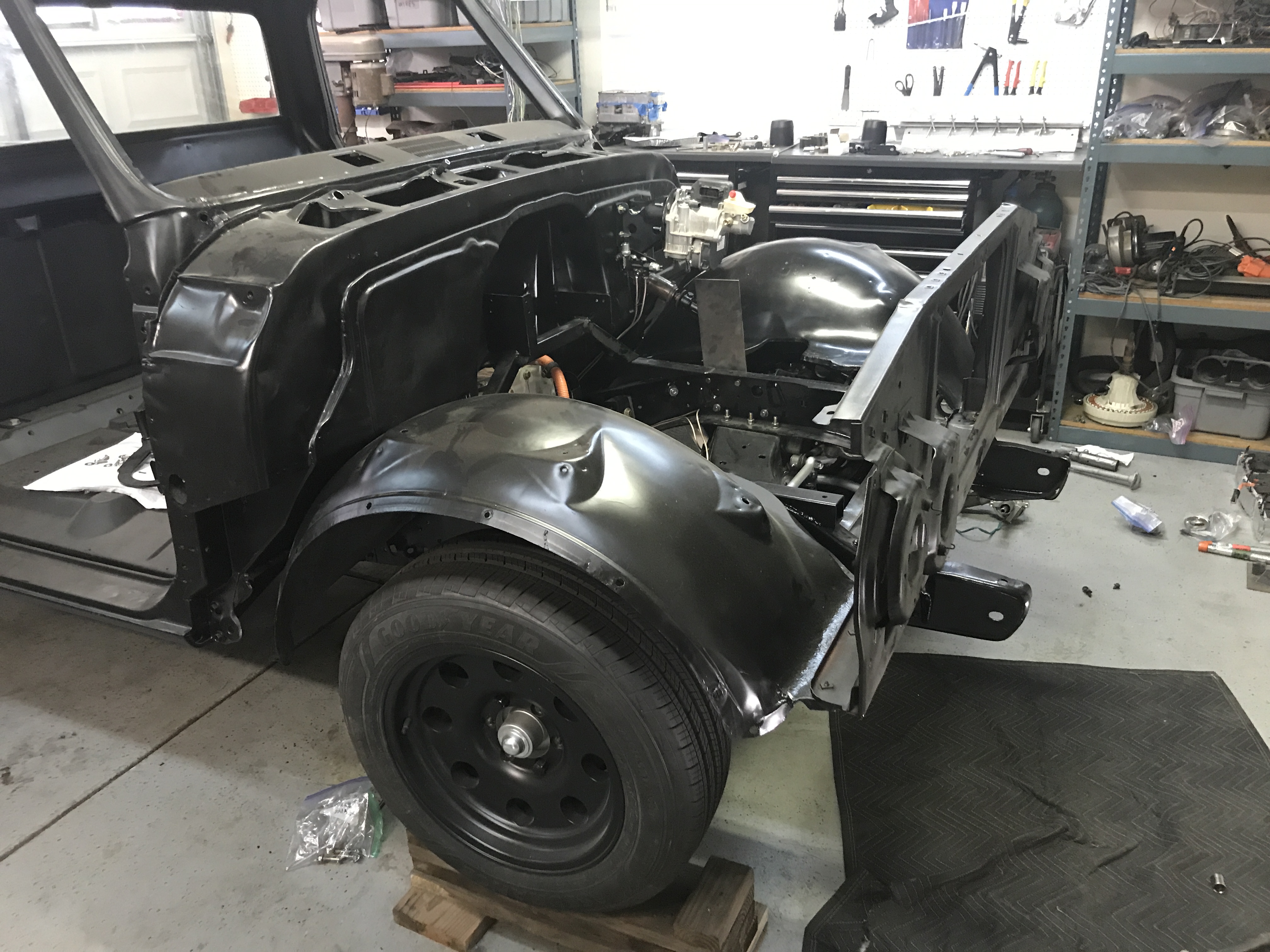

big day today, hope to accomplish quite a bit, install brand new steering linkage, and get the radiator core support and inner fenders back on, among 7 million other little things, you know how it goes...

so with a help of a friend got the steering linkage on, the inner fender, and the radiator core support
