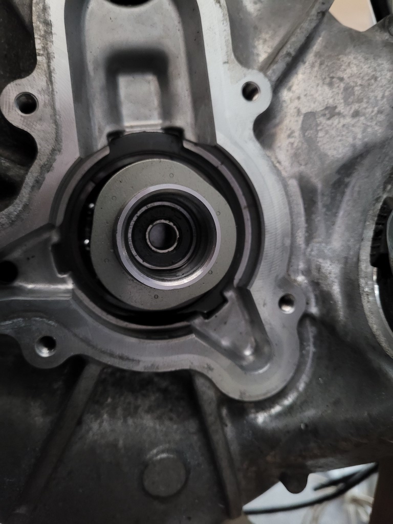

I have two of questions about offsets:
1. The Tesla resolver is not a rotating exciter but a fixed one. There are 10 equally spaced coils in a ring. I can't tell which are exciters and which are the resolver and how they are connected.
- 10 gives only odd combinations of e.g. 2 exciters and 2x2 resolver?
- This combination should do something with the offset?
- Also a bit uncertain when the exciter sinus current peaks should cause max resolver current.
2. What sampling window wrt the exciter sin wave? I guess symmetrically around it's max?
That's the key bit of information. The odd (sinusoidal) shaped rotor acts as a variable transformer and couples the excitation to the sine/cosine coils depending on the position.
Johannes has a great introduction to how this works. It's only 20min long and well worth a watch.
fbo wrote: Wed Feb 23, 2022 10:50 am - This combination should do something with the offset?
The offset I was adding yesterday was to do with the phase lag caused by the conversion of the analog filter that converts the square wave coming out of the MCU to a sine wave. The reason for aligning this with the PWM is so that we get the results of the resolver position that corresponds to the current readings at the same moment in time.
The coupling between exciter and sine/cosine should by at its max at the peak of the sine wave. The sampling window should be tiny in comparison to the freq of the signal. What we are interested in is the instantaneous magnitude of the sine and cosine signals. Aiming for the peak of the sine wave just gives us the best chance of getting the largest (and thus lowest noise) signal.
TI have clever examples in their motor control code that samples all over the exciter wave form and applies digital filters. I'm sure this is wonderful but it's a lot more complex and the existing stm32_sine approach works in a lot of motors...

Posted: Thu Feb 24, 2022 1:38 pm
by fbo
Just sharing this picture.
https://ieeexplore.ieee.org/document/6953227
Exciter and resolver coils are placed in the same tooth! Exciter are in every tooth. Just unclear if the Tesla resolver has alternating sin and cos coils or all 3 coils integrated into each tooth.
1 pic explained everything and more than 1000 youtube videos glossing over actual key info. This one pic contains all the missing information I was lacking for the past 2 weeks to understand how the resolver works. I thought it had to be like that but no evidence found until I saw that pic.
