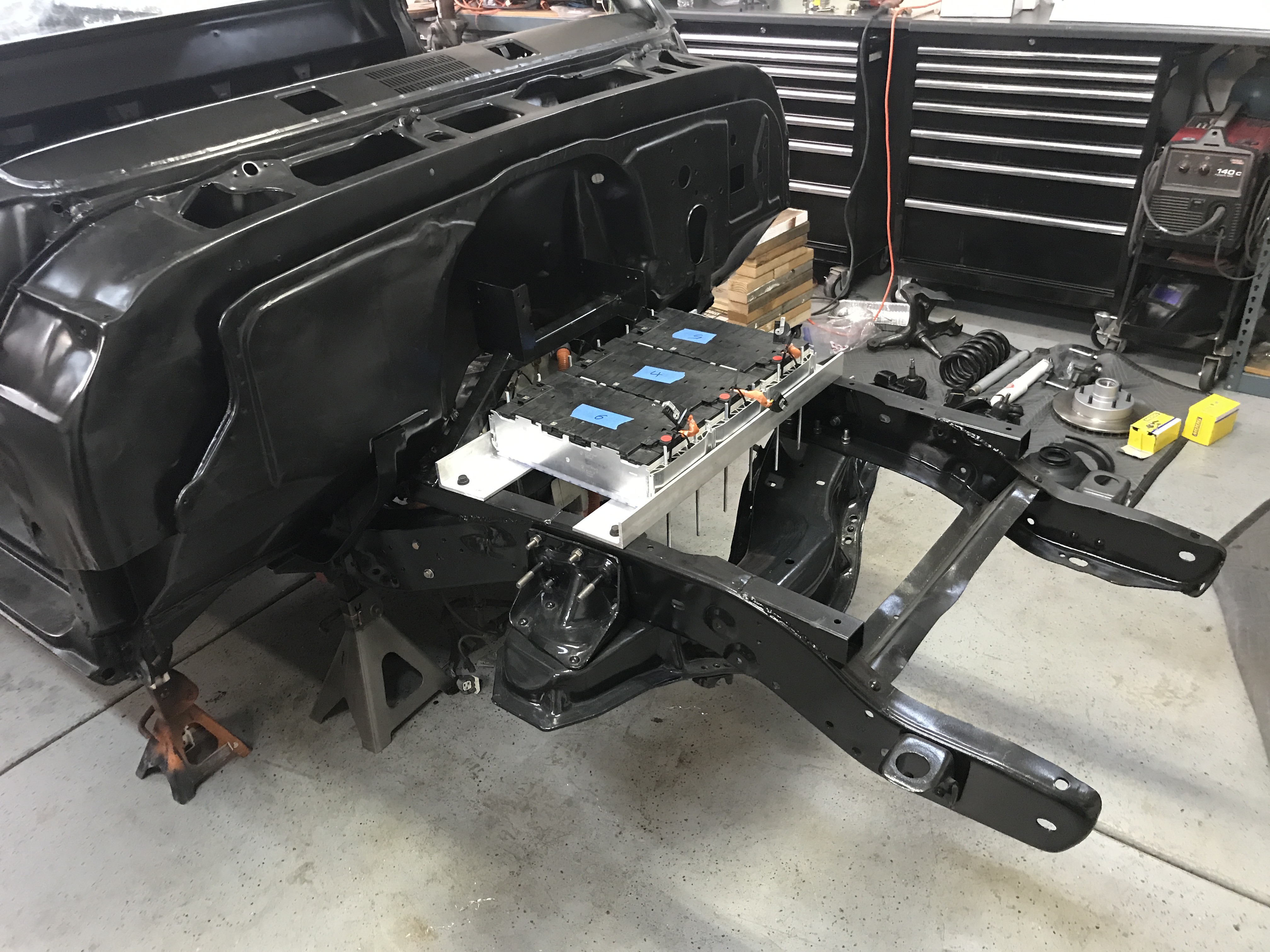

happy to report the final assembly has commenced, with the help of a few friends we got the drive shaft mounted, the transmission mounted, the cab mounted, and the "engine" crossmember installed, we could not go any further since I am still waiting on the control arm rubber seals, yes $3.00 parts, lol

and here she is back on her feet

Matt mentions it as well: use the brake line that was originally used. However, that can be a challenge. Most classic cars use 3/16" or 4,75mm (or 5mm) and Tesla (and I also expect Honda in your case) uses a larger diameter. So I recommend to use an adapter.
Are you going to upgrade the brake switch on the Wilwood with a pressure transducer?
Posted: Fri Jul 01, 2022 1:28 pm
by Gregski
larsrengersen wrote: Fri Jul 01, 2022 7:53 am Matt mentions it as well: use the brake line that was originally used. However, that can be a challenge. Most classic cars use 3/16" or 4,75mm (or 5mm) and Tesla (and I also expect Honda in your case) uses a larger diameter. So I recommend to use an adapter.
Hi Lars thank you for taking the time to post this, (folk's this gentlemen did the awesome iBooster write up on EV Create which can be found here: https://www.evcreate.nl/category/brakes/)
honestly I am learning as I go and following your write up as much as I can and as much as I understand it, as far as the brake switch I have not thought about that yet, so I am completely open to suggestions and appreciate any and all advice, especially from you, please and thank you

I swear it was the hottest day of the year that day and I was laying upside down on sharp gravel drilling out rivets to get the stabalizer bar support brackets off the frame, it was so bad I decided to get two of them

so yeah I was little bit concerned about the EV ending up lighter than the original, so I decided to add an anti swear bar
