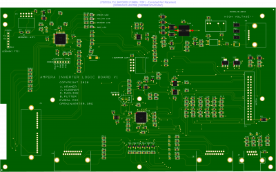

Board layout done.
Ampera_V1 - Schematic.pdf
(507.82 KiB) Downloaded 882 times
Ampera_V1 - PCB.pdf
(343.96 KiB) Downloaded 899 times

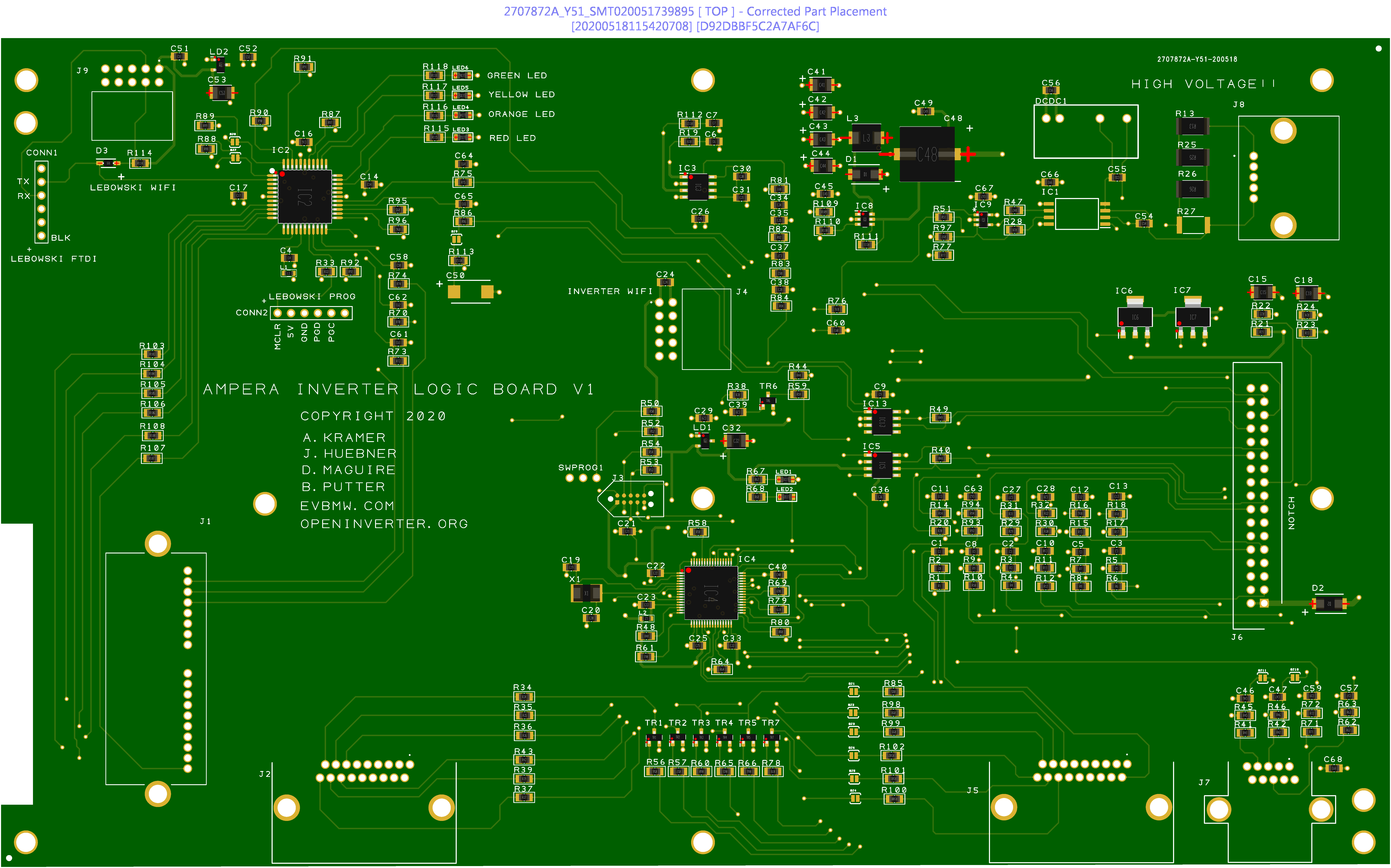

Arber, on your rev 2.3 board, what are you controlling? I see:
Precharge out
Temp out?
Overtemp out
Error out
Brake out
What are you doing for contactor control with this board?
Posts: 4000
Been thanked: 1114 times
Re: VOLT/AMPERA inverter single controler dual IGBT drive
All done and on order at JLC.
Resources on Github :
https://github.com/damienmaguire/Ampera-Volt-Inverter
I'll send a board to Arber and mdrobnak once the prototypes arrive.

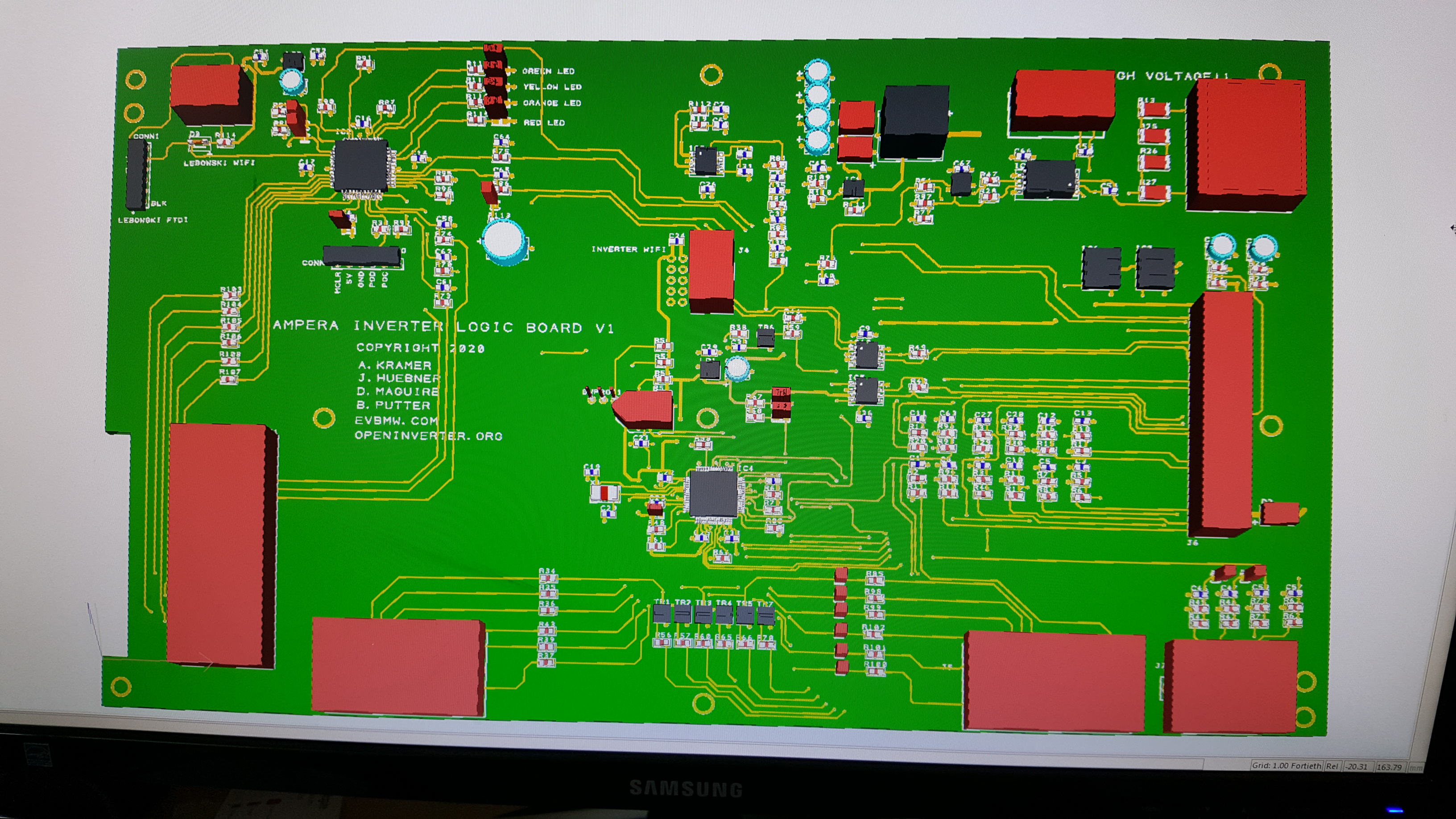

Really nice!
I have a lonely Outlander motor here wanting to have a date with the new main board.
I also can provide AC compressor to test the 3rd stage. However Damien I hope you provided 5 or 6 pin programming connector. I totally forgot this because I use DIP version of dsPic30 i programm the chip directly through adapter. I have Pickit3.0.
Yep it has the pickit programming port:)

I also see you add some details to serial port for wifi link. Can you explain diodes? This is something i didnt use yet. And i tried much to get serial across wifi gterm.
EDIT: OK i would definitely add two small relays for precharge and DCSW lines. I dont trust darlington array to live through everything DC contactor load can give. You can also use one relay side to keep Lebowski in reset until precharge is done.
I also hope your DCDC for voltage sensing can survive shorting? I use this one exclusively. Murata NME0505SC.
I had several opamps shorted when testing and DCDC survives.

The diodes allow the 5v dspic to drive the 3v3 wifi module without damage. I use the NCV8402 driver for driving contactors. Its a short circuit and thermal overload protected low side driver designed for automotive applications.
Yes the dcdc is short circuit tolerant.

Jack Bauer wrote: Mon May 18, 2020 8:04 am The diodes allow the 5v dspic to drive the 3v3 wifi module without damage. I use the NCV8402 driver for driving contactors. Its a short circuit and thermal overload protected low side driver designed for automotive applications.
Ah i see! This is then open drain device? So connect 12V to contactor and other side to the board. Good.
Posts: 4000
Exactly. And if you do something silly like put 12v on it it just shuts down.
