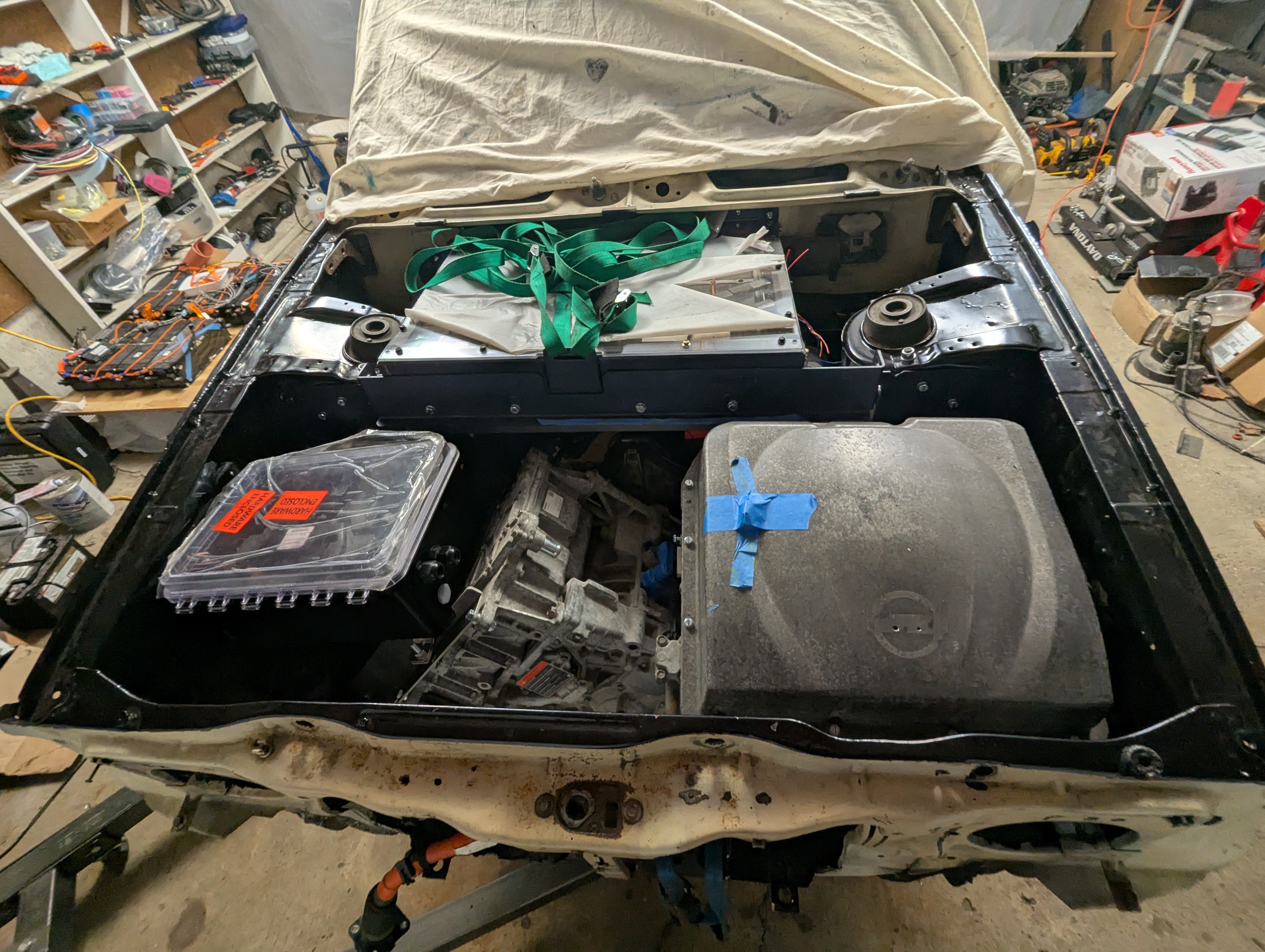

The redneckifiction of my garage (gararge as they say around here) is complete. IOW i built a plastic tent around my car workspace so i can work through the winter via space heater more comfortably. After a full day with the space heaters maxed out i got to 45F when it was 32F outside. ugh. it's going to be a long winter!
Then i had a call with Walter of WDR BMS fame and we started to get my BMS set up. It went really well except for realizing i think i killed another Hyundai Ioniq 5 battery module. When i was measuring cell voltages my probe touched two neighboring pins on a voltage sense connector. I didn't know not to do this because the cells are fused and now the module might be bricked :( A $200 FAFO. To reduce the timeline i'm going to get the car running with 12 modules (3 packs of 4 modules) instead of all 16. That way i don't have to source 2 more modules or build the 4th pack yet.
Then i got the first battery box built! I used a rolling pin mathod to get the thermal paste to the right height to barely touch the bottoms of the cells. I think my spacing worked out a well as i could have wanted. When i rest the module on the paste there's a .01-.03" gap between the mounting surface and the module. This gives a teeny bit of pressure on the cells, just enough to make them touch without deforming the pouches i hope. When i lift the module back up you can see a tiny bit of paste stuck to the cells and the very faintest outline of where they touched the thermal paste. I learned from the hyundai technical service manual that this paste gets installed as a 2-part mix, therefore i'm guessing it's much softer when the modules are installed at the factory than it is now. Hope i get some ok heat transfer out of this complex design i've made.
Next i started to install my motor mounts. that's going ok and the motor is now supported in the engine bay without a crane for the first time and that feels gooooooood! Gonna have to take them out for painting before final install.

Got everything installed for the first time! This is just temporary for fabricating the motor mounts and getting cable and hose lengths. Now it all has to come back out for painting the motor mounts. It's a bit of a messy look, but so psyched i got it all to fit with 1/4 of the batteries under the hood! The motor is clocked at 45 degrees which makes a lot of odd shapes for fitting everything else in. My 3D scanner lied to me a little bit and I have to mod the battery box mounts to bring it an inch lower and half an inch forward.
motor and PDM
motor, PDM, and PRA
motor, PDM, PRA, and battery box!
