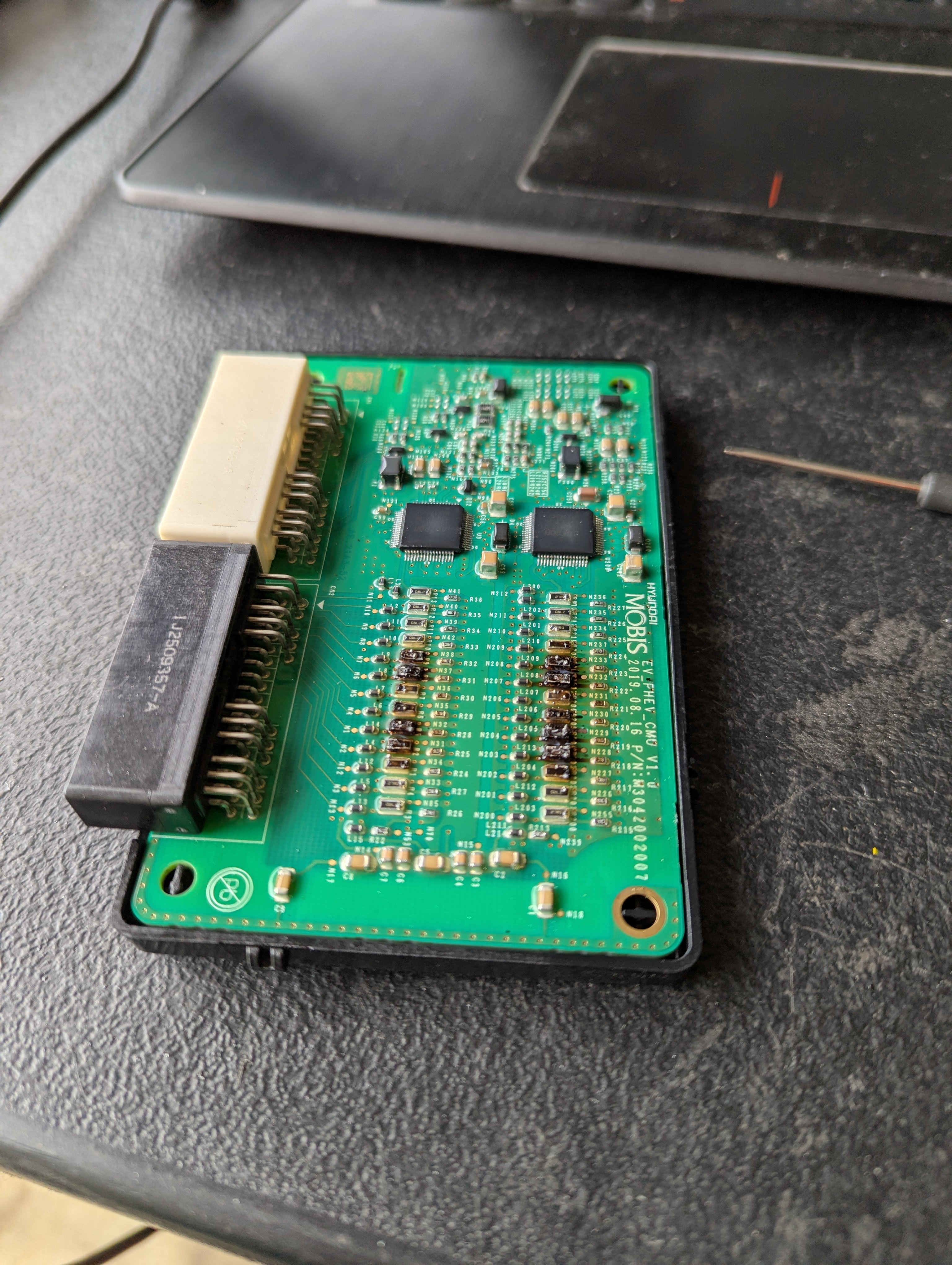

nononononoonoononnnnoonononononononoonononononononoonononononononononooooooooooooooooooooo i let out some magic smoke :(
Looking for some advice.
Setting up the WDR Automisering BMS today and it was going great. I downloaded the BusMust CAN GUI to confirm the CAN dongle works. I figured out how to download and open the WDR GUI and it seemed awake. Then i disconnected 12V while i plugged the Ioniq CMUs into the battery modules. First the orange CMU harnesses were plugged into the front and rear of each module then each CMU was connected to the large black connector on the harness in the order of 1-2-3-4. Then i smelled the magic smoke and about 10 seconds later saw a swirl of smoke coming out of the CMU connected to 2 where the yellow arrow is. AHHHHHHH! I frantically managed to unplug all the CMUs in about 10 seconds. The other 3 were cool to the touch and the hot one is smoked as you can see. The modules all measure between 23.84-23.87V.
Possible causes I can think of:
1. My first thought was that somehow HV leaked onto the LV wiring, but i don't think that is the case because i didn't see where anything was touching that that could have happened. The only way i could see that is if the exposed shielding of the twisted and shield pairs touched a battery terminal and somehow brought that into the circuit, but the shield aren't grounded anywhere yet and i would consider this pretty unlikely.
2. I assumed that the CMUs and BMS are inactive until powered on and i press go. After connecting everything up i was going to connect 12V and open up the GUI to read cell voltages and thought there would be a command to balance the cells if i wanted to. Now I'm wondering if the balancing is passive and when i connected the CMUs the balancing process began. I wasn't planning to balance the cells so i didn't reconnect all the modules. I highlighted with red lines which modules are connected and as you can see all 4 modules in the second set are connected AND the bottom module is also connected to the top module of the 1st set. I think the CMU began balancing 3 modules at 24V with one module at 48V.
3. The large grey deutsch connectors i made that made to string the CMUs together were only loosely fitted. For some reason i didn't push the plugs into the receptacles all the way so maybe some pins were only barely touching while other pins weren't touching at all. Only CAN is going through these connectors so idk how that could have caused a failure like this.
4. The CMU harness was connected "backwards". If the module plugs closest to the CMU are connected to the negative side of the string of 4 modules and the plugs furthest from the CMU are connected to the positive side of the string, would it be problematic to connect the harness backwards? Sets 1 and 2 are connected with the CMU closest to the negative module and sets 3 and 4 are connected with the CMU closest to the positive module.
Glad i still have all my fingers, toes, and modules! I wasn't wearing my HV gloves since i wasn't planning to doing HV stuff and that is a lesson learned.
Any help is appreciated!

other lesson learned: whenever you get the feeling things are going well and you're doing great it is a surefire sign something is about to go wrong! That's happened three times in a row.

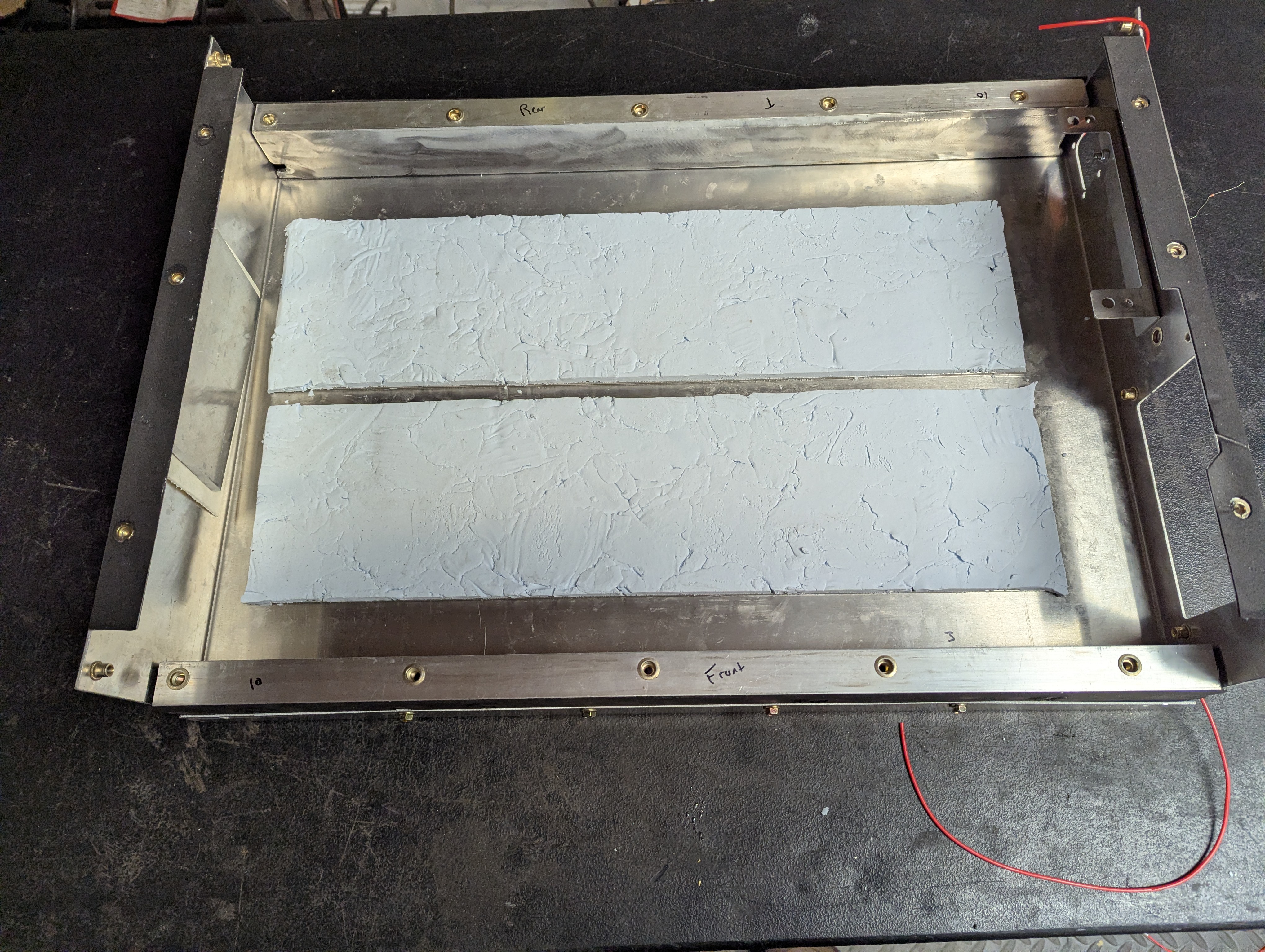

Then i got the first battery box built! I used a rolling pin mathod to get the thermal paste to the right height to barely touch the bottoms of the cells. I think my spacing worked out a well as i could have wanted. When i rest the module on the paste there's a .01-.03" gap between the mounting surface and the module. This gives a teeny bit of pressure on the cells, just enough to make them touch without deforming the pouches i hope. When i lift the module back up you can see a tiny bit of paste stuck to the cells and the very faintest outline of where they touched the thermal paste. I learned from the hyundai technical service manual that this paste gets installed as a 2-part mix, therefore i'm guessing it's much softer when the modules are installed at the factory than it is now. Hope i get some ok heat transfer out of this complex design i've made.
