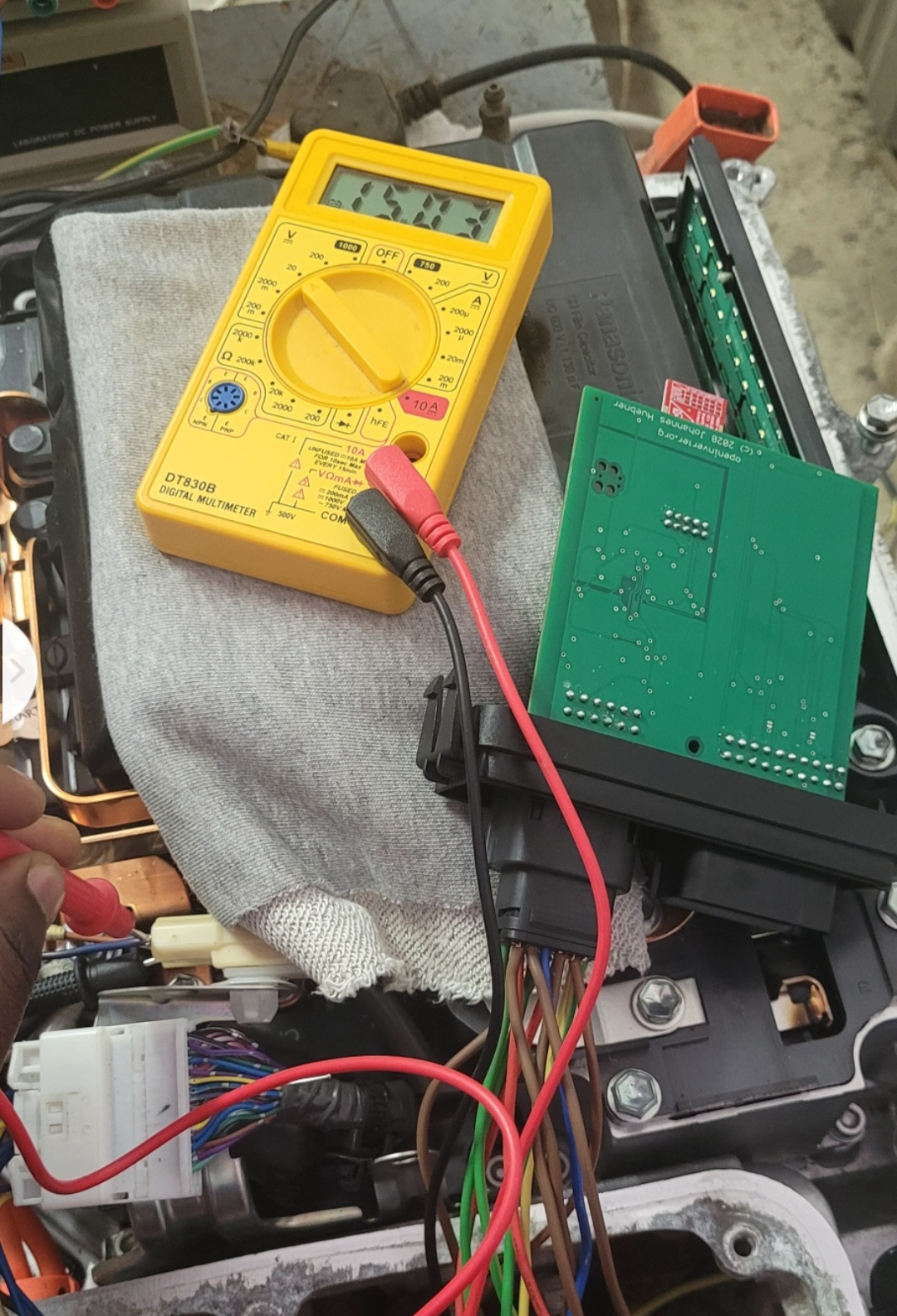

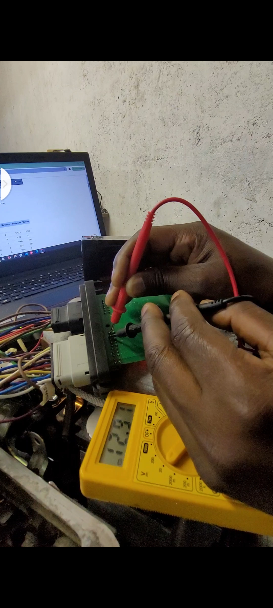

MattsAwesomeStuff wrote: Sun Feb 23, 2025 3:47 am Carefully flip the OI board over. CAREFULLY use a voltmeter or probe pin 28, 29, and 30 (small connector, the row closest to the edge of the board) when you think the inverter is on. See what you get for voltages and or waveforms. Don't slip and short something.
If you've got voltage on those pins, then it's a wiring problem. If you don't have voltage on those pins, then it's an OI hardware or software problem, or some other wires aren't hooked up correctly to allow the OI board to engage, and we'll chase those down next.
I flipped the board and tested like you said.what I did first was I set my Voltmeter to dc and and first tested pin 19 amd 20 which is "19 battery negative" and "20 battery positive" and I got 12v input and then I move my positive Voltmeter terminal to pins 28 29 amd 30 to see if I get any reading. Why negative terminal was still on pin q9 which is our battery nagative and on doing that, on pins 28,29 and 30 I didn't get any reading.
I also used the scope to check the waveform when I put in the normal settings on the vcu of boost 20000,default forward and manual start ON fslipspnt 1 and ampnom 70. The waveform didn't change, it showed the same waveform I got when I installed power the vcu.

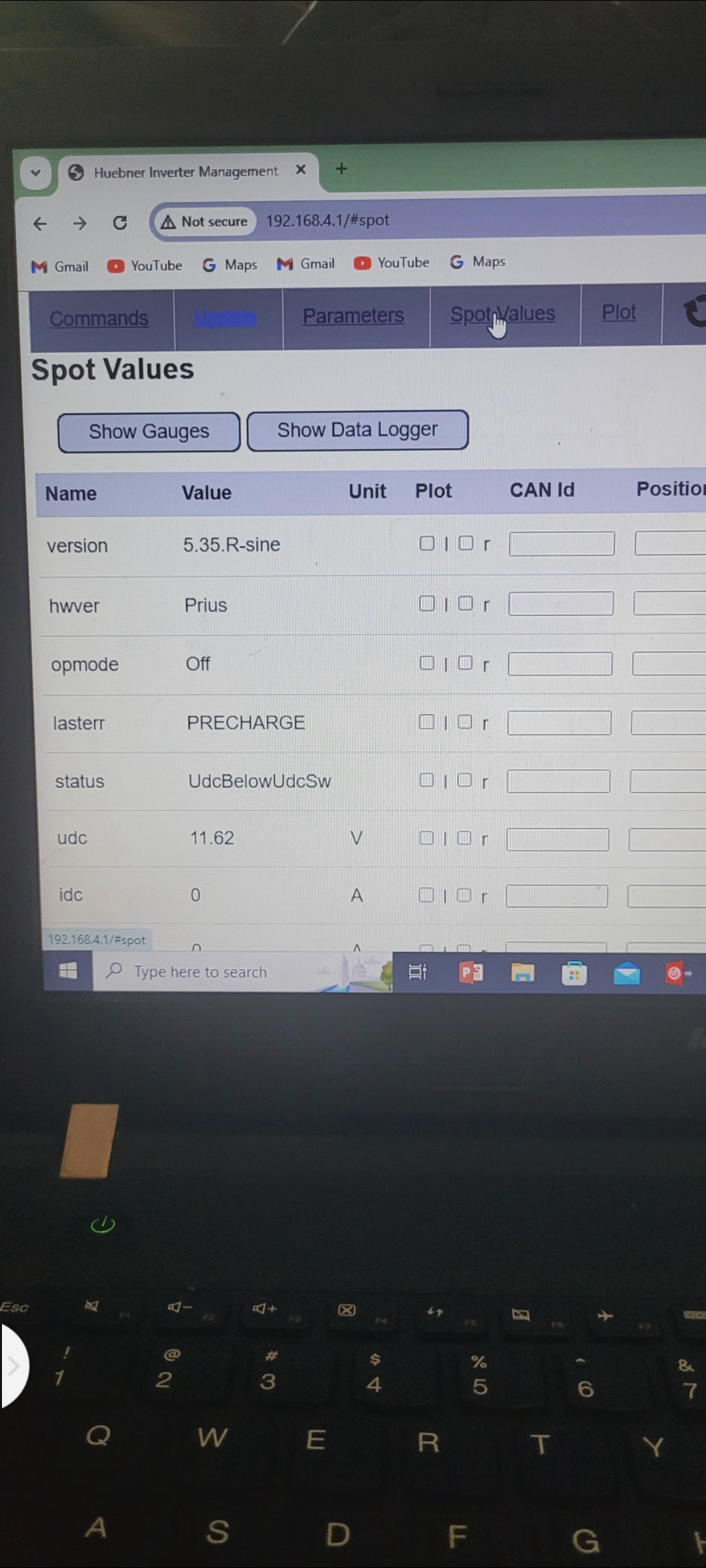

MattsAwesomeStuff wrote: Sun Feb 23, 2025 3:47 am If you can log in and get the OI interface to load, and it pulls up a list of parameters, then you have at least powered the OI controller properly.
I heard you mentioning logging in. Where do I log in for me to get this list of parameters that the OI will pull up a list of these, so I can be sure also if the OI controller is also powered correctly??

voti wrote: Mon Feb 24, 2025 10:05 amI heard you mentioning logging in. Where do I log in for me to get this list of parameters that the OI will pull up a list of these, so I can be sure also if the OI controller is also powered correctly??
Erm, just logged into the wifi that lets you pull up the OI webpage.
The parameters are on the OI interface there. If it creates that table with all the values, you've accessed it correctly and the wifi can communicate with the controller.

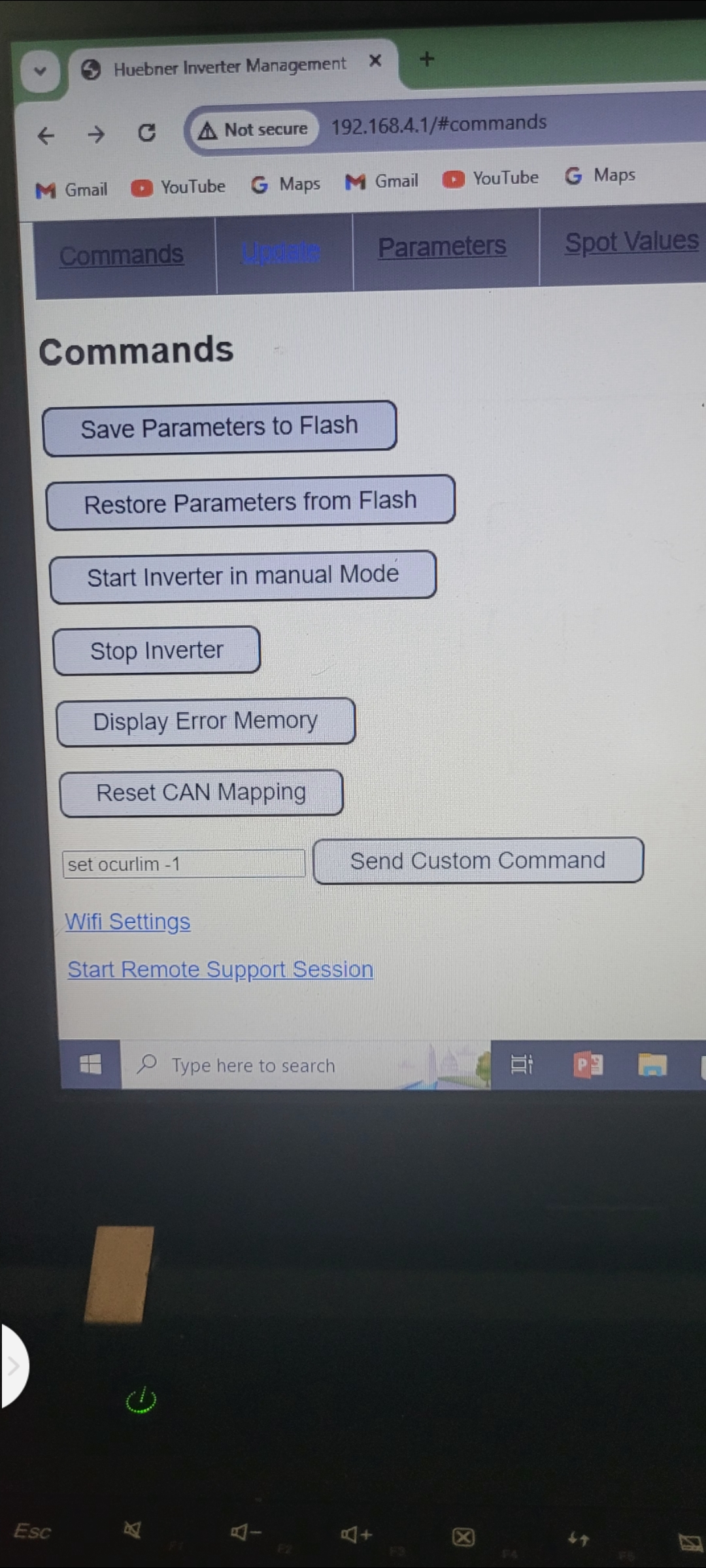

Ok, there needs to be more methodology here. I have attached the manual again.
Answer the questions asked here, do not test anything else. If any step fails you can stop there as it is pointless to continue. Fix the problem until the test succeeds, then continue.
When I say "inverter" I mean the Prius inverter. When I say "controller" I mean the openinverter controller
Three major things need to be done right for getting the inverter to pulse:
- The grounds of inverter and controller must be joined up
- MSDN must be pulled to 12V, verify this on the inverter side. That is pin 25 on the inverter connector
- All three PWM inputs must make contact to the controller. With the inverter turned on and the controller turned off make sure that Pin 28, 29 and 30 on the controller side read 15V
Good, so now we have the most important connections made. Time to power up the controller.
- Do not connect anything to the inverter phase outputs
- I suggest powering both controller, inverter logic and inverter HV DC with a current limited lab power supply (can be the same for all 3) without any fuses or resistors that can get in the way. Set the current limit to 3A, voltage to 15V
- Use most recent software 5.35 and set ocurlim to -1 (disabled)
- Put inverter in manual mode with fslipspnt=1, ampnom=1
- Verify that opmode reads ManualRun
- Connect your scope probe ground to ground of your lab supply and verify that Pin 28, 29 and 30 of the controller show a perfect rectangular wave form
- Now verify that you see the same perfect rectangular wave form on the 3 inverter phase outputs

johu wrote: Sat Mar 08, 2025 10:19 am Three major things need to be done right for getting the inverter to pulse:
The inverters ground is the one on the i9 connector and the one for the MCU is pin 19?
Let me confirm if I read this right, "
With the inverter turned on and the controller turned off make sure that Pin 28, 29 and 30 on the controller side read 15V"
Does this mean that I should disconnect the car interface on the control board and only leave the inverter interface connected.
Next I should flip the board and check for 15v on Pins 28,29 and 30 ?
I did that and please see the attached pictures. I first tested the input voltage input on the i9 and it read 15 then I tested the pins 28 29 and 30 against the negative terminal of the i9 since I disconnected the car interface which has ground.
Please confirm if I did this corrct so I can move on

voti wrote: Sat Mar 08, 2025 11:29 am The inverters ground is the one on the i9 connector and the one for the MCU is pin 19?
inverter pin 16, controller pin 32
voti wrote: Sat Mar 08, 2025 11:29 am With the inverter turned on and the controller turned off make sure that Pin 28, 29 and 30 on the controller side read 15V
yes
voti wrote: Sat Mar 08, 2025 11:29 am Does this mean that I should disconnect the car interface on the control board and only leave the inverter interface connected.
yes

johu wrote: Sat Mar 08, 2025 10:19 am Use most recent software 5.35 and set ocurlim to -1 (disabled)
Please help me locate ocurlim to -1 (disabled).
On Matt's parameters ocurlim appears to be under inverter options but when I check on my web Interface I can't find it. Check attached picture
And also where do I find opmode?
Posts: 6969
Has thanked: 455 times
Been thanked: 1771 times
Re: EV Conversion using prius gen 2 inverter/transaxle
Ok, so far it looks good. It seems I have hidden ocurlim. In "custom command" enter
set ocurlim -1
To set it anyway

voti wrote: Sat Mar 08, 2025 3:57 pm Please guide as to what I should do next because at this stage I'm confused
There is a place in the openinverter interface, near the top, to type in manual commands (and then hit enter). This is an alternative way to changing parameters or starting and stopping the inverter.
What Johannes is asking you to do is to type into that interface:
set ocurlim -1
And hit enter.
"set" is the command to change a parameter, "ocurlim" is the name of a parameter" and "-1" is a value that ocurlim can have that will disable it from limiting your current.
Also, this is the first time you've had voltage appear on 28, 29, and 30! I'm not sure how that happened, but, that's great news.

MattsAwesomeStuff wrote: Sat Mar 08, 2025 6:30 pm Also, this is the first time you've had voltage appear on 28, 29, and 30! I'm not sure how that happened, but, that's great news.
I was also excited when I got the readings. Like I said earlier, I tried to confirm all the wiring one by one like you said I should do. While I was confirming the wires, I cut small pieces of wires and put them in the cable connectors so that when i connect it to the board they make contact. I don't know if you geg it but yeah, I guess that is why when I flipped the board the first time you said i should test the Pwm pins, when I was testing the pins, I saw an increase in current draw due to some Cables making contact which were not.

OK. I typed in "set ocurlim -1 " on the input field next to send custom command, And I hit enter. Then I put in your parameters and started the inverter in manual mode. I stopped it and checked spot values and I found opmode value to be Off. I started the inverter again but nothing changed.
I closed everything and reopened the web Interface. I first set the ocurlim -1 then on to fslipspnt to 1 and ampnom 1 like Johannes said.
I started the inverter in manual mode and checked the spot values. Opmode was off. Even when the inverter was started it was still off. Please see attached.

Ill advise there. Don't hit enter but hit button "Send custom command"

johu wrote: Tue Mar 11, 2025 5:41 am Ill advise there. Don't hit enter but hit button "Send custom command"
And what about opmode. How do I turn it on ?
