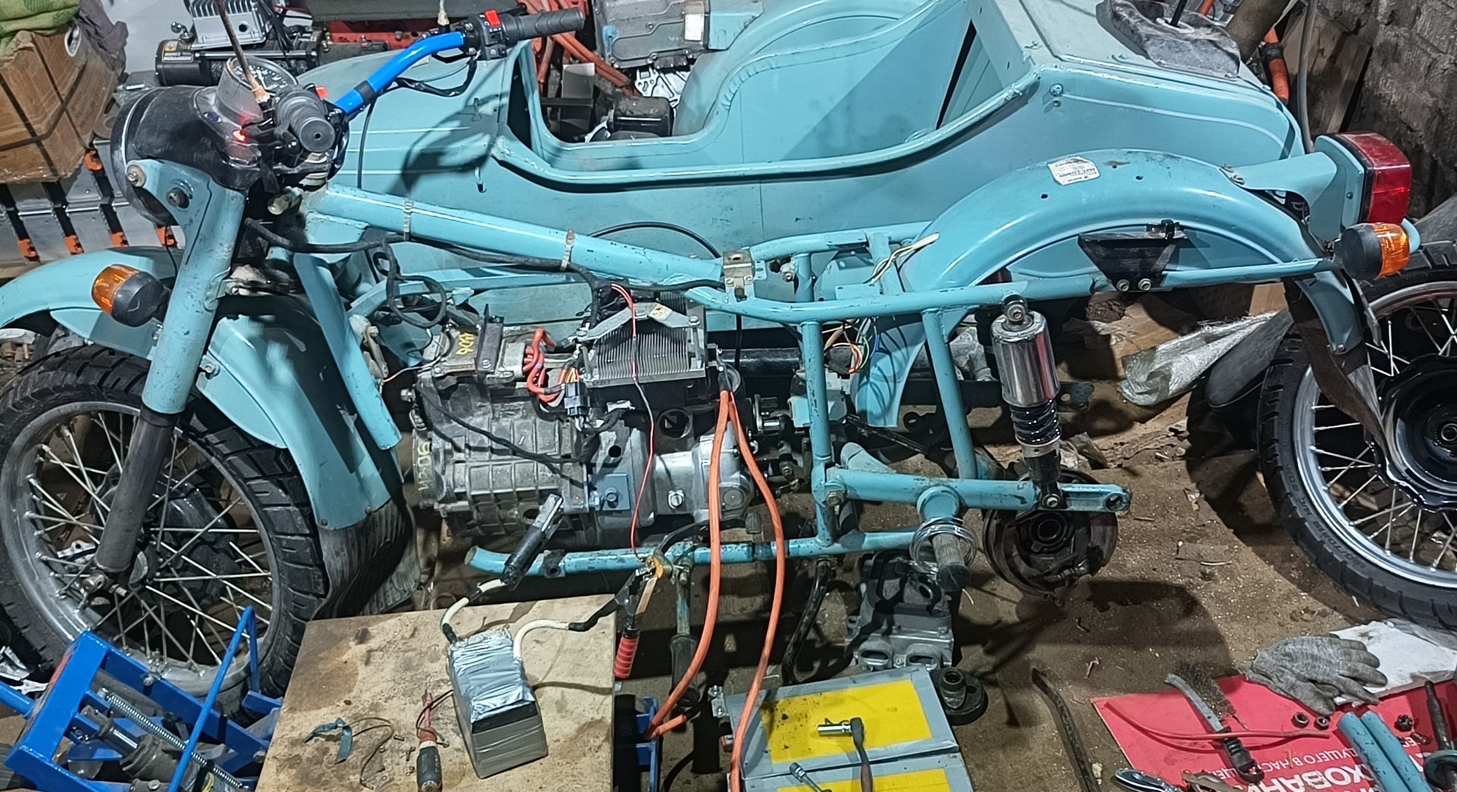

so. the correct syncofs was 600.
when the fwcurmax is -210, the motor does not stop (syncadv = 10), setting the syncofs to 1100 stops the motor perfectly at syncadv 10
. next, I returned the syncofs to the correct 600 units, and syncadv = 15. the motor did not stop. I increased by 5 and then by 10 units, and only at syncadv = 100 did the motor start to stop!!! this is probably a very big offset.
for understanding: the battery voltage in this experiment is 45 volts, the load on the motor shaft is 0 (gearbox only)
. I conducted the experiments on an electric motorcycle that I am currently building with a rear Outlander motor and a Honda ima inverter.
params_Ural.json
(1.61 KiB) Downloaded 497 times

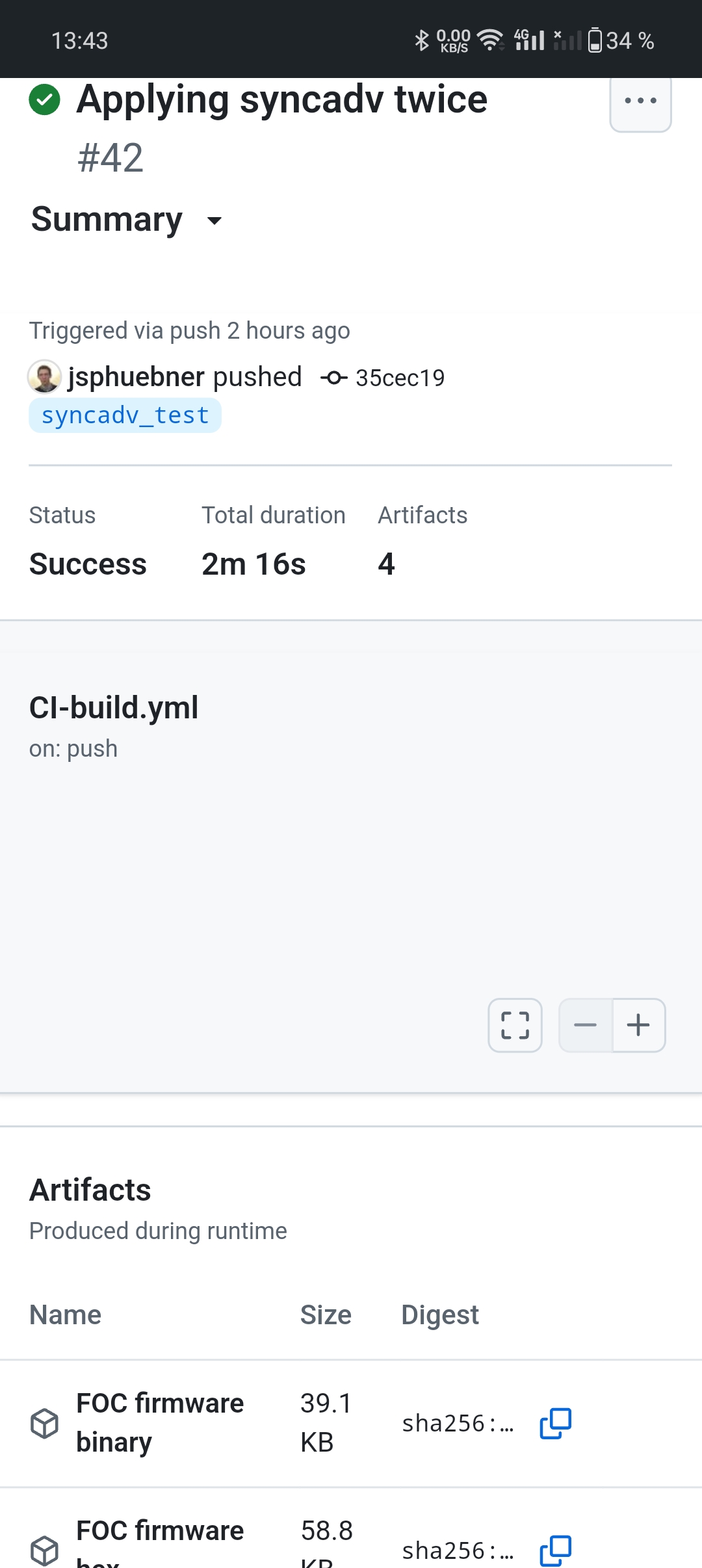

Here is a test where syncadv is applied for forward transform and applied 2x for backward transform. I'm too afraid to test it with full 400V ;)
https://github.com/jsphuebner/stm32-sin ... 4215111311

it is not possible to download the .bin file
evil neodymium :twisted:
Posts: 6968
Has thanked: 454 times
Been thanked: 1771 times
Re: Inverter Firmware 5.35.R
You need to log in to github

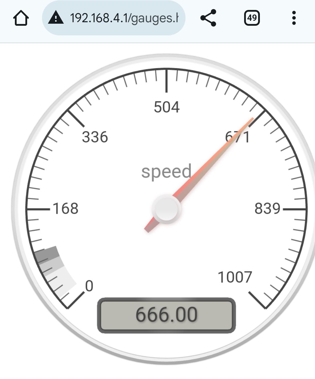

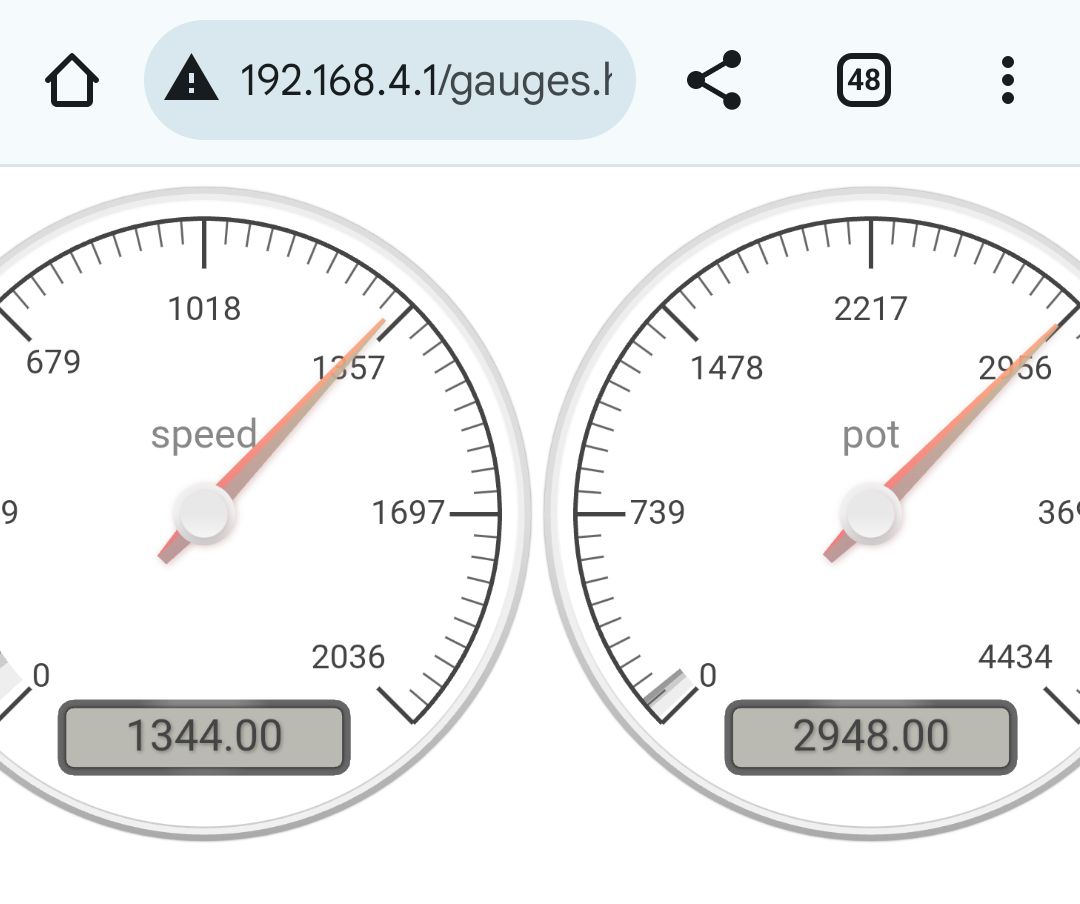

I was able to check so far at low voltage, but even now, with syncadv = 10 and fwcurmax = -210, I accelerated the motor more than twice from the base speed and it is super stable, lowering the throttle position is incredibly smooth, like never before!!!
special thanks for the high charging current !!!!
I think it's a victory.
in the coming days, I will test this on a car with a 300 volt system.
Base speed:
accelerated speed:
