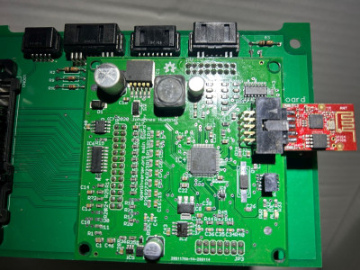

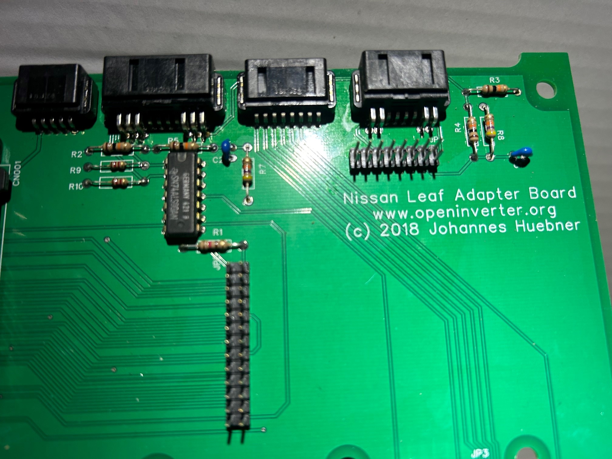

hi there !
i'm backafter a long time! and i would like to know if there is a change log for the version of the board?
i have this card to fit inside my nissan tower will i have to do some upgrade ?
thanks
thanks

Re: Mainboard V3 FAQ
Will work a treat!
The new version has the ESP32 and uses the Mini Mainboard for easier manufacturing but does the exact same thing
