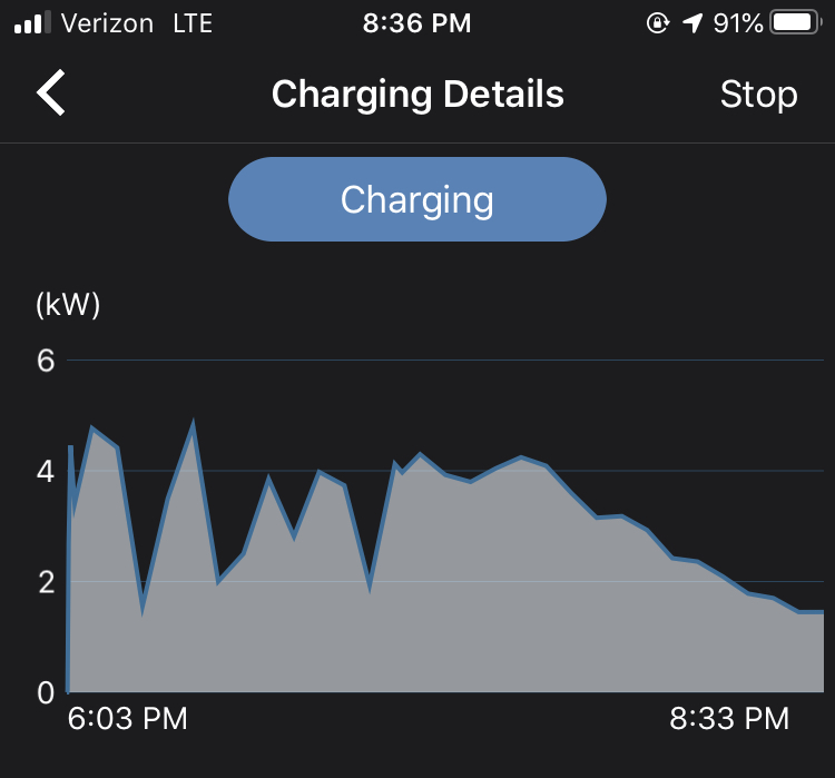

jon volk
Posts: 574
Location: Connecticut
Re: Gen 2 Charger V5 Software Development Thread
Post by jon volk »
It seems the pilot signal may need work. Generally everything seems to be working but both my evse and charger will get clicky spasms on occasion. It seems the evse will shut of briefly, then modules start clicking off/on, then evse clicks on....repeat 2 or 3 times, then were good for a while.
I dont fully understand (nor looked in depth yet) at the pilot signal requirements vs. what is being read.

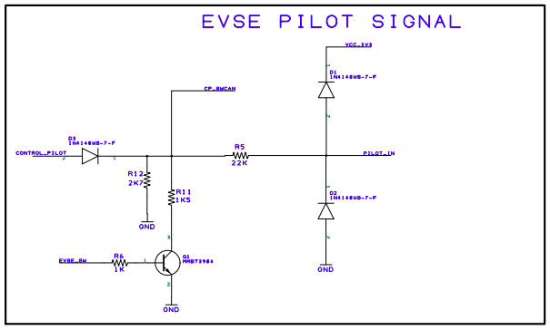

Kevin Sharpe
Posts: 1339
Location: Ireland and US
Been thanked: 8 times
Post by Kevin Sharpe »
jon volk wrote: Wed Apr 29, 2020 7:49 pm I dont fully understand (nor looked in depth yet) at the pilot signal requirements vs. what is being read.
I had a very quick look at the hardware/software and we may have an outstanding issue with the pilot State B (Ready) to State C (Charge) transition control circuit. This line is commented out in V2, V4, and V5 software;
//digitalWrite(EVSE_ACTIVATE, HIGH);//pull pilot low to indicate ready - NOT WORKING freezes PWM reading
I know some EVSE actively check the pilot signal and may get upset if they don't get the correct levels. I also note on V5 that R11 (1K5) in parallel with R12 (2K7) is a 964R load as opposed to the 882R required by the standard. I'll check the tolerances in the latest documents when I get a moment.
jon volk
Posts: 574
Post by jon volk »
So in an effort to bypass any pilot read, I swapped the following code in based on the high value read from my EVSE to give a steady state input to the controller. I am still getting intermittent performance from the charger. It will not give a steady output over time and it seems to only be operating on two phases of DC output despite all 3 LEDs being on and AC registering on each input. I attached a serial log but did not have a chance to try and get a CAN log as well.
 else
    //accurlim = (micros() - pilottimer) * 100 / duration * 600; //Calculate the duty cycle then multiply by 600 to get mA current limit
    accurlim = 52400;
Serial log.xlsx
(17.84 KiB) Downloaded 341 times
jon volk

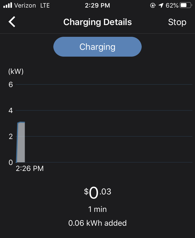

Posts: 574
Post by jon volk »
I upped the static accurlim value to the max of 65535 and get a current reading at the evse of 32amps. Module 2 in the monitor still shows 0 DC output current.
jon volk
Posts: 574
Post by jon volk »
Just sort of thinking out loud. In looking at my serial log, is it possible the DC current is must a comm error? The module current request in the log is 8733. When all 3 modules show AC current of 8.7 amps, the EVSE will read approx 24 amps of current so it would seem all 3 modules are consuming power. I am still unsure what is causing them to turn on/off now that the pilotcalc is set to a static value.
*edit* I did just remember I never halved the timer for the CAN messages after splitting them. Perhaps the modules are timing out?

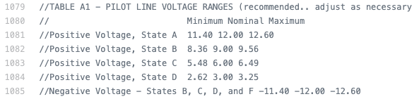

Kevin Sharpe
Posts: 1339
Kevin Sharpe wrote: Wed Apr 29, 2020 9:02 pm I know some EVSE actively check the pilot signal and may get upset if they don't get the correct levels. I also note on V5 that R11 (1K5) in parallel with R12 (2K7) is a 964R load as opposed to the 882R required by the standard. I'll check the tolerances in the latest documents when I get a moment.
I've checked the IEC61851-1 standard (see attached extract) and can confirm the resistors are defined as 2K74 and 1K3 with a +/- 3% tolerance.
Looking at the OpenEVSE source code (here) it can tolerate a pilot signal with a 250-600mV deviation from nominal (see attached source code snippet),
When I get access to the workshop I'll measure the pilot signal levels and confirm operation of Q1.

jon volk
Posts: 574
Post by jon volk »
It looks like the modules were indeed timing out. I halved the CAN timing instance and it seems to be rolling at a pretty steady 32A of AC current. I have to assume my "0" module 2 signal is some sort of error since the AC request current and actual consumption at the EVSE all aligns. Im guessing there can be some scaling done as the pilotcalc value is at the max but we are still falling short of 10kw it seems.
Due to the STM32 stuff being a little more in depth than a simple .ino file ill work on getting a github account going for ease of sharing.
Serial log CAN timing halved.xlsx
(18.15 KiB) Downloaded 295 times
