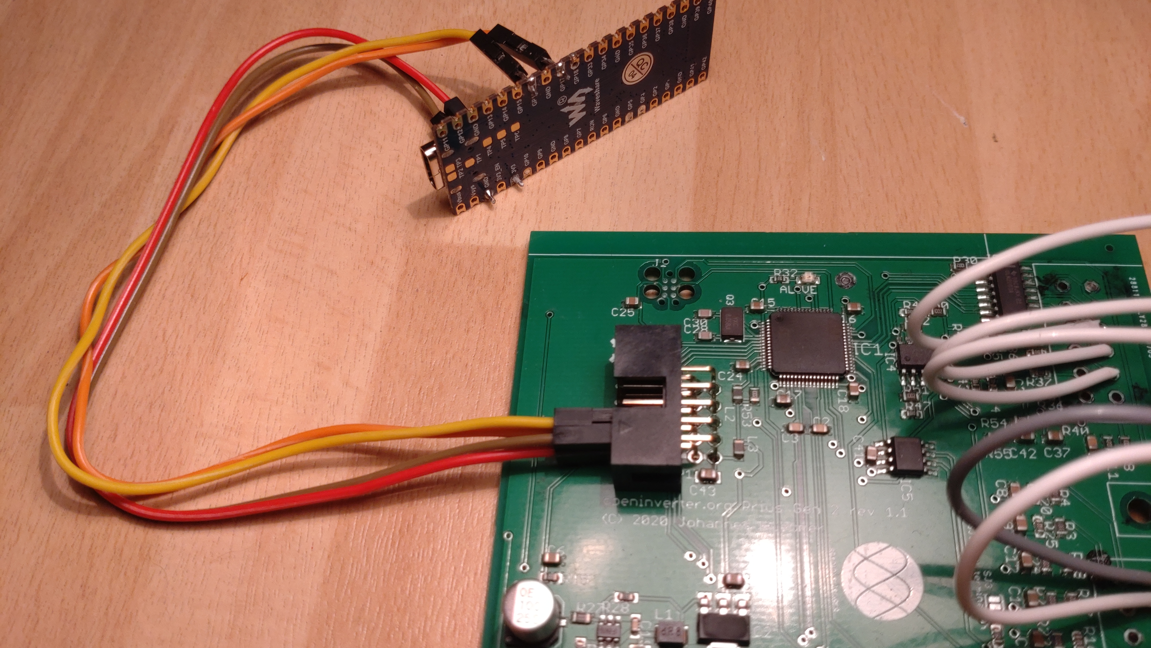

For the moment, I am using the output USB port of my computer for power directly to my ESP32S3 USB C programme port.
I have Pins 16 and 17 as TX & RX. For the moment I am not even connected to my Adapter Board.
I can Upload/Delete files through the update Buttons, so I started uplaoding all the DATA files again. For now, I still keep getting the USB message of device not recognised each time the UI refreshes. The files seem to replace the previous ones that were initially downloaded, and adds them at the bottom of the list- don't know if that really helps.
If I try to upload a firmware (foc.bin), the UI says Download Complete, but is frozen in this state.
Edit - I also noticed he ESP is not connecting to my WIfI Network, I have to connect manually. Don't know if this helps iether.

Really a pity. Some ESP are more crappy then others, maybe you can try whether an other one feels better. Power supply may be one issue. They need a lot of current for WiFi, and if the capacitors are too small they run into strange effects. Maybe add some 100n ceramic Cs and 100uF elcap.

Powering the module from USB can work if USB provides stable voltage. The message you quote seems to indicate it is not. So power it with a lab supply. Which module are we talking about anyway (picture)?
Also I much recommend staying on the well trotten path of platformio. With that set up all you need is
Of course I recommend using Linux as Windows makes the platformio/python part even harder. Can be a simple USB media live linux distro

Thanks Johu. I'm on a windows computer and just about figured Arduino, and I have a Due dev board.
I tried python & commands through windows , but that is also not an easy beginner setup.
I connected the Esp32 to the 3.3v pins for the original ESP8266 on prius adapter board. The connection does not reboot doing it this way, however I still get the Red warning message.
I have tried to connect the TX\RX (pins 16 &17l on the ESP32 to the TX|RX (pins 2 & 4) on ESP8266 breakout on the adapter board, but no difference.
I'm thinking of going the hardwire way, but that again is another deep dive plunging down rabbit holes scénario.....
Frustration, because I feel I'm close to solving this issue, and would like to document so we have a concise up to date solution that can go into the wiki.

I had some frustrating experiences with such jumper wires and in the meanwhile I'm back to soldering. Sure with good quality connectors there is no issue, but the cheap jumpers which I got were best placed into the trash bin.

Also at this point I want to stress that reflashing never actually solves a problem. If you have a working device once it will not change afterwards. Most people who think they solved a problem by reflashing also changed something else along with this.
If something works intermittently electrical issues like poor wiring or power supply are key culprit

The jumpers are soldered into the board, but I could replace them if there's a doubt.
My issue at the moment is around connection between Esp & STM.
If there is doubt about the ESP board, is there a "simple" way to say put the web interface on my arduino due and connect that to my adapter board?

The soldering on the waveshare board pins doesn't look great. Id start there. GP16 and GP17 you can see around the pins

Oh well. I went to unsolder and replace the wires with proper automotive pins. Looks like I cooked one of the pinouts on the board! The 3.3V. I'll just bin it for all the time spent. Will order a new one

I went over the pins again, as it was really bugging me. There seems to have been goo splashes, and the circuit board looks to not be damaged. So replaced all 4 wires with proper automotive cables and pins. Connected up with the same Esp-Stm coms message. Could the fact that the adapter board has a very old firmware as apposed to the Esp be causing adaptability issues?

are you sure that the uart is on pins 16 and 17 ?

#define INVERTER_RX 3
#define INVERTER_TX 1

This is where I took info.
"Hardware
The web interface has been initially designed to run on ESP32-WROOM-32E boards.
The connection to the inverter are on Pin16 (Rx line connect to inverter Tx line) and Pin17 (Tx line connect to inverter Rx line)."
So I will go and check if Esp32S3 dev are the same pinouts

The pins were changed to 1 and 3.
https://github.com/jsphuebner/esp32-web ... b11195abb7
Probably to line up with the Voltlog CanLite hardware.
https://github.com/voltlog/CanLite/blob ... e-revD.pdf
Your board does not have a pin 3. So probably be easier to change the code to pins 16 and 17.

Thankyou @Bigpie & @manny for the final pointers ! Pins 16&17 are moved to 1&3, and on different boards.
This highlights again the need for up to date links & info "for dummies like myself". I'll put these findings with links into the wiki as it ties up with other threads.

EDIT - MODIFY CODE FOR RX &TX PINS TO 16 & 17 !!
16. Reset ESP32S3
17. Connect ESP32S3 Pins to Initial Connector for ESP8266 on Adapter board: NOTE - Pinouts are inversed when looking at Adapter Board
1: 3.3v on ESP32 to Pin 1
2: Ground on ESP32 to Pin 2
3: GPIO 16 on ESP32 to Pin 3
4: GPIO☺7 on ESP32 to PIN 4
18. Apply 12v to adapter board & User Interface should be visible.
