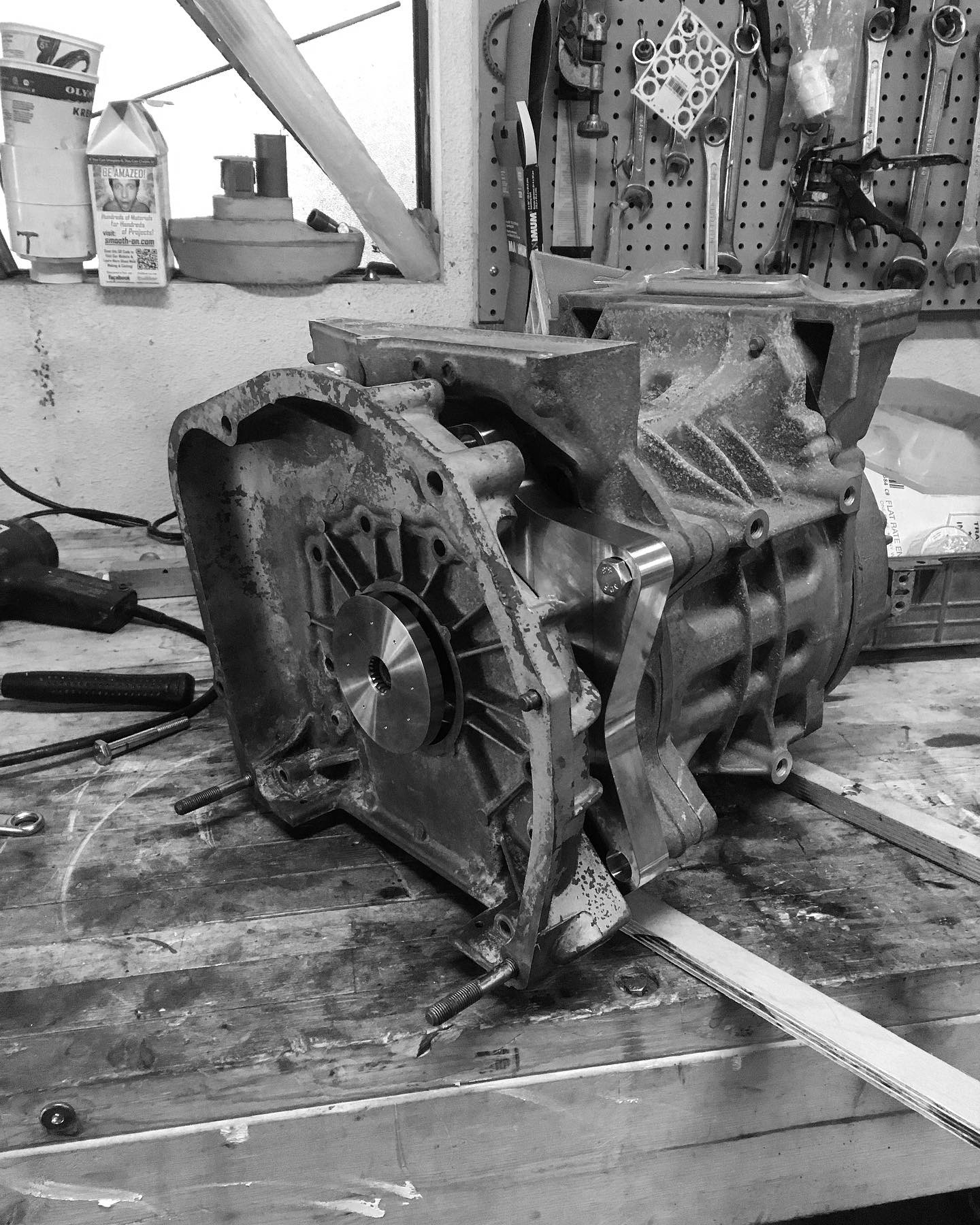

Now I’m back in full swing, things are coming together quick!
ampseal connector wired in to adapter board, mounts to the 3D printed file made for the Prius inverter. Few tweaks to make in the design, befor the fibreglass abs print.
adapter plate is done. Came out great!
Need to pick up the coupler bearing still.
then coupler gets mounted and locked in with A snap ring.
I picked up a used rotex off eBay for 40$. But it’s aluminum and a Gs28/38 ...so no dice there.
Either will find a steel gs38 then pressfit/weld the 4mt clutch center. Or get some steel plate laser cut.
With the plate method I’ll get a few made and can have a coupler for the modern awd subi tranys as well. Which will be almost a direct swap, other than a few minor mounting brackets.

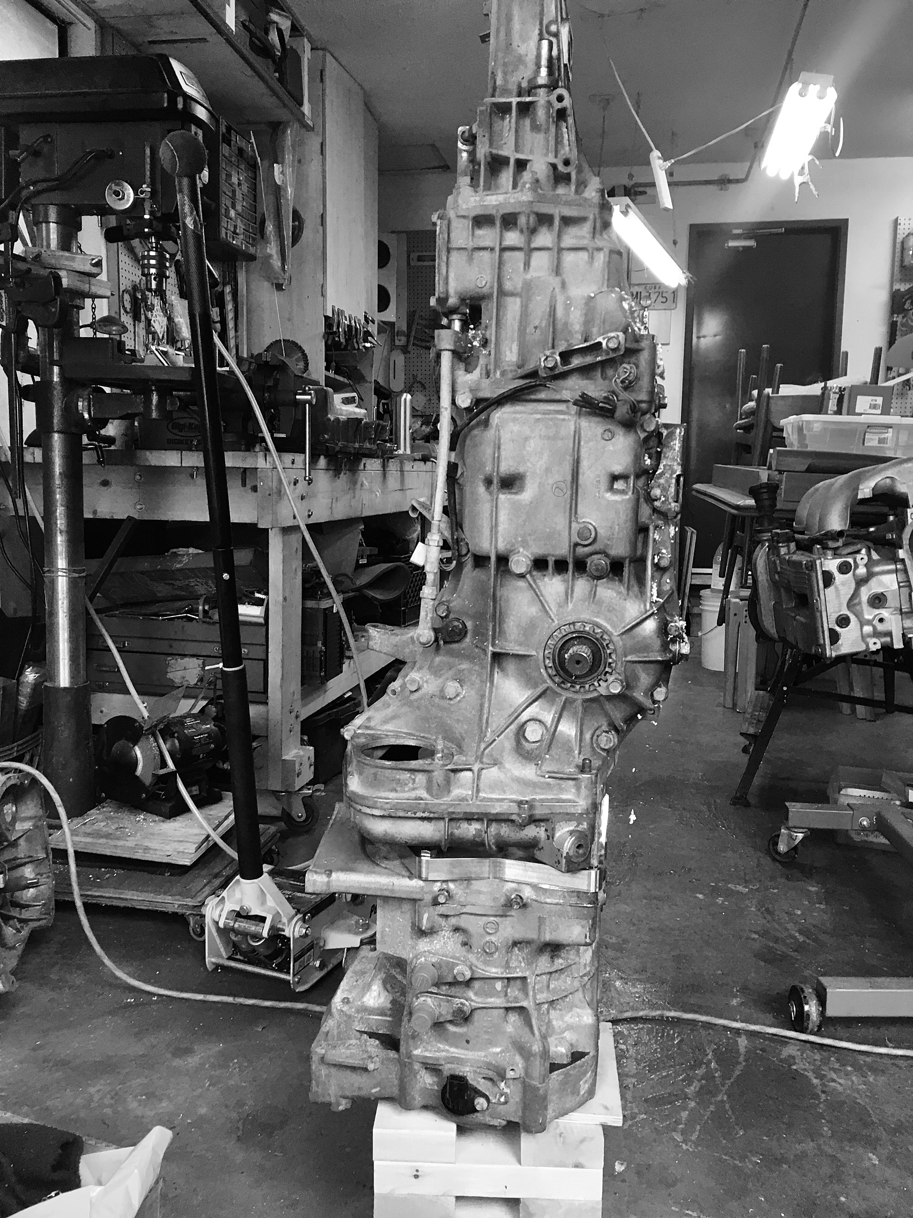

-picked up some Prius inverters, Ford Siemens, and Hyundai hsg motors for cheap. Various projects here. looking at doing a hybrid assist with the hsg..
-getting things set up to potentially start offering leaf motor adapter plates along side the couplers I have available.
-trying to hunt down a cheap leaf gearbox to start designing some 930 stub flanges.
And now have my eyes pealed for a 2019 + Subaru crosstrek hybrid trany, as they are quite similar to the gh450h gearbox’s.

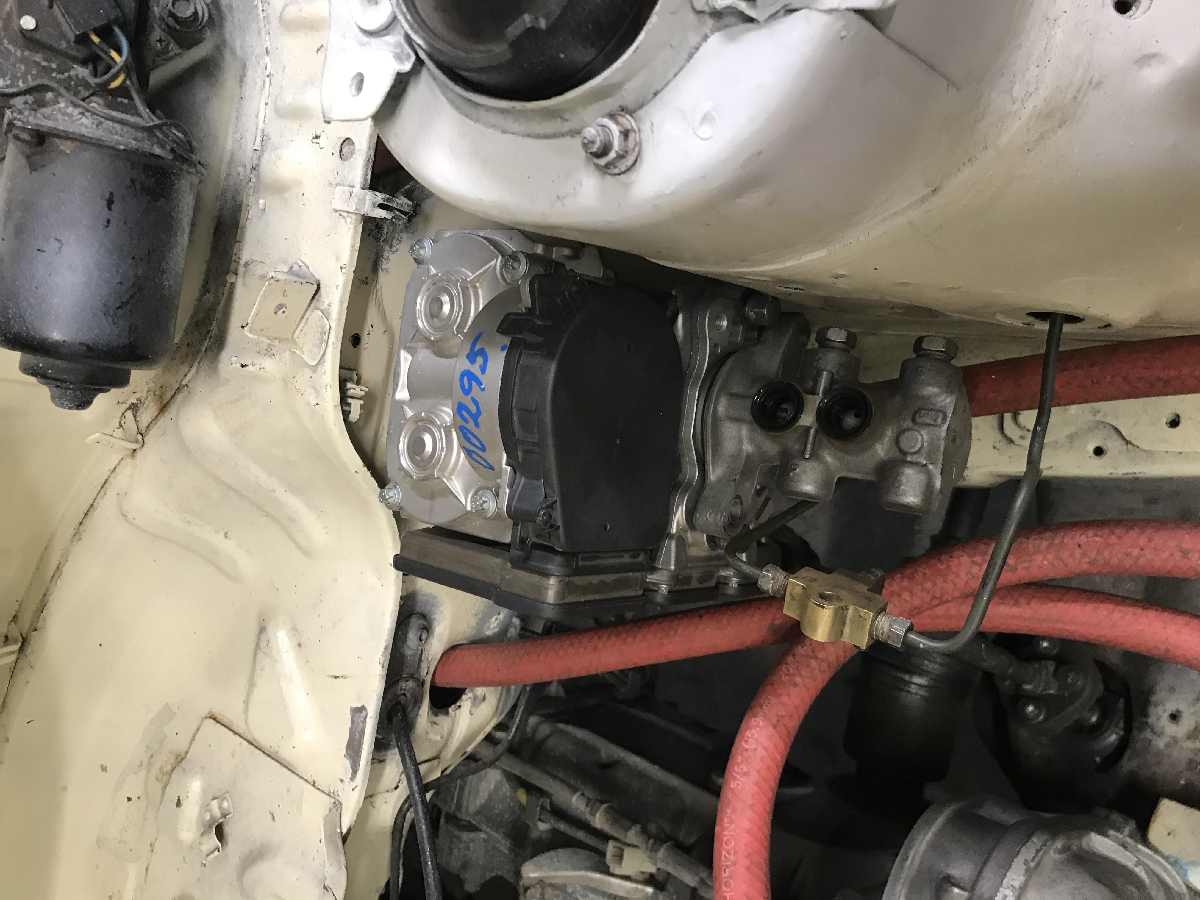

Re: 1983 Subaru BRAT
Posted: Fri Oct 15, 2021 7:47 pm
by Bratitude
Chevy volt gen1ibooster bolted right in, after drilling 2 holes and rearranging the booster assembly. Tight fit!
After some digging it looks like both gen1 and 2 ibooster use the same main connector, “1928405762 26-WAY BOSCH CONNECTOR” but different pressures transducer connectors.

spent on time on the lathe and whipped up some brackets for mounting the ibooster.
instead of using the volt’s master cylinder that came on the ibooster, I made an adapter for a Subaru one.
This keep the hydraulic ratios properly matched, and no custom brakelines!
That fancy machined aluminum look
Everything on the ibooster was metric m8x1.25 threads.
The pushrod from the brake pedal is m10x1.5 thread. Just used a coupling nut and threaded shaft to the brats original clevis.
I had to existent the internal pushrod(the one that pushes the master cylinder) in order to get the proper pedal-to-master cylinder engagement. I just used a 60mm m6x1.0 socket head cap screw.
