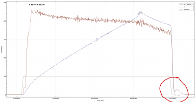

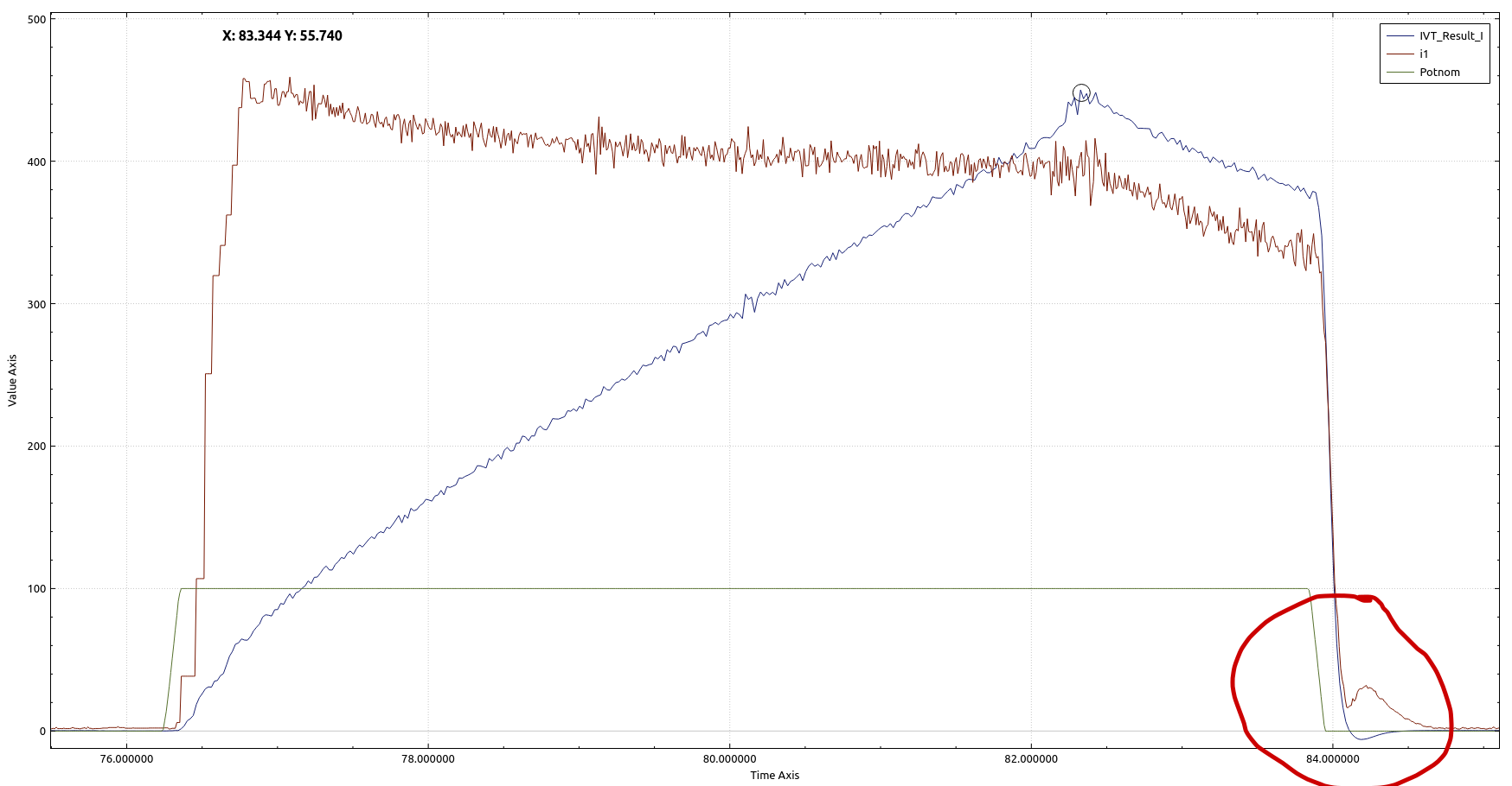

muehlpower
Posts: 807
Has thanked: 18 times
Been thanked: 188 times
Re: How to not kill a tesla drive unit
Post by muehlpower »
I assume the time scaling is seconds. Then it looks like the peak is less than a second. Maybe catphisch can confirm this.

Anyone have any idea what size capacitor to use for a long enough delay? I can't quite make out the above graph-it's too low res.
muehlpower
Posts: 807
mane2
Posts: 263
Has thanked: 50 times
Been thanked: 61 times
Post by mane2 »
I don't understand that graph, but with my 4-5 second duration I was referring for how long regen current could be generated (before full stop) if you're driving like 60-70km/h and all the sudden main contactor opens. But if you cut the 12V from motor/OI controller too at that point, it might go to neutral faster and does not regen for that long.

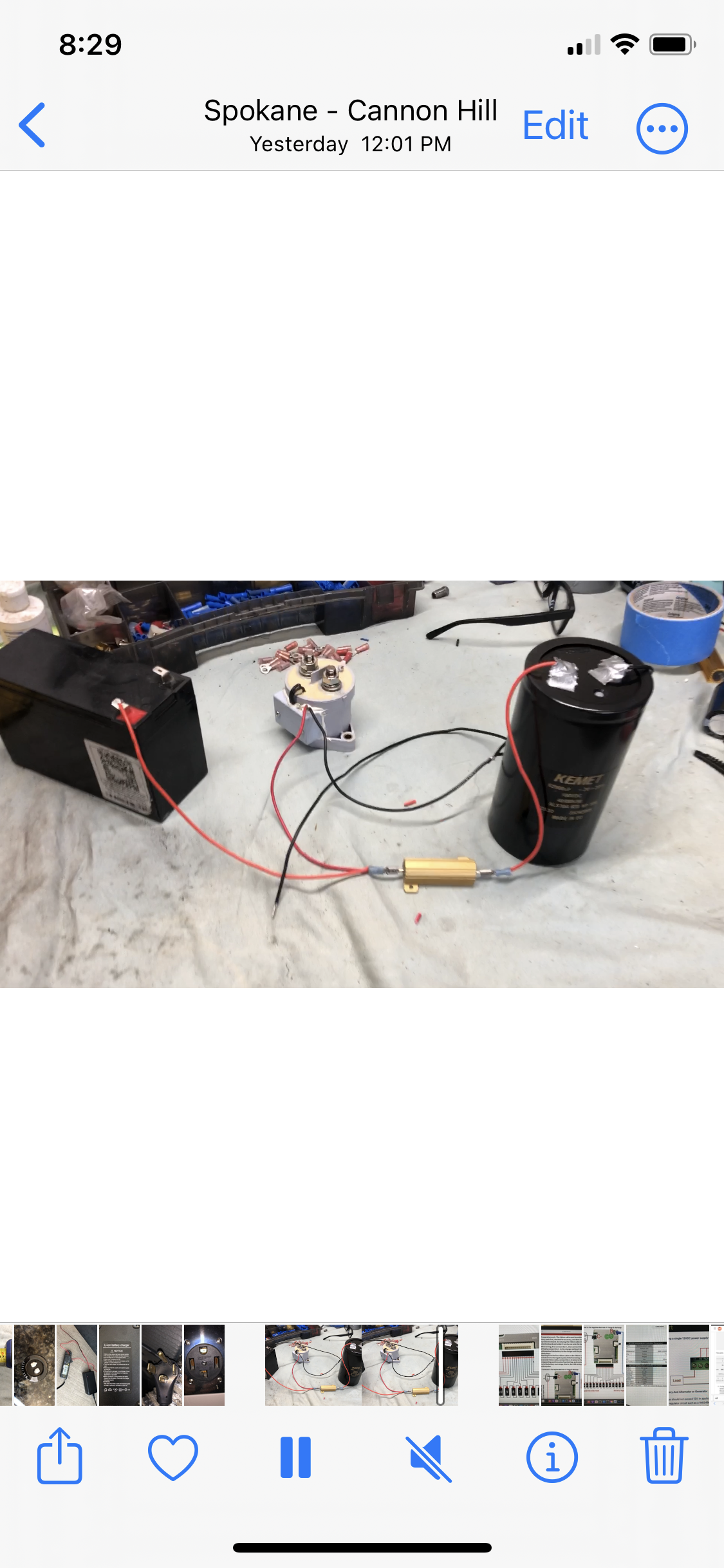

In my testing so far, a 50 watt 5 ohm resistor and a 62,000uf cap delay the off by about 2 sec.

I’m still trying to fully understand this and cover all my bases before testing. If I have “DC on” option, killing the contractor while driving should protect the inverter as long as it still has 12v? Like blowing a HV fuse etc? If so wouldn’t it be a good option in most builds to have a panic switch that immediately drops the main contractor(bypassing the capacitor if used) and if desired, a capacitor/resistor in the circuit in case of sudden loss of 12v to the inverter?
