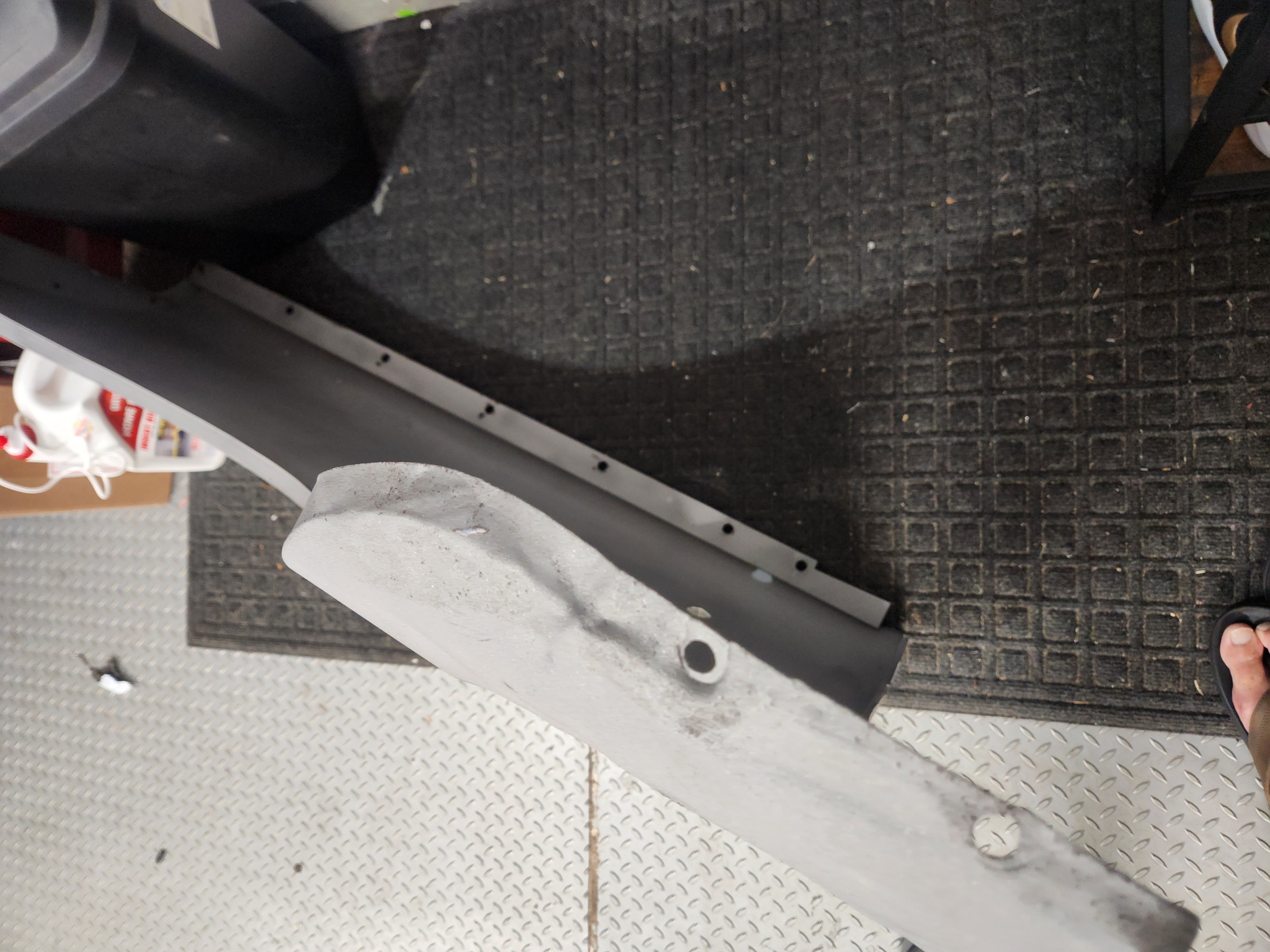

Picked up my body panels from the sand blasters yesterday evening and they look great! Need to inspect thoroughly today and get a coat of primer on ASAP as I swear I can see these browning before my eyes. Lots of dings that will need to be worked out, but only one or rwo rust-through spots that need patching.
Re: [WIP] 1964 Scout LS600H conversion
Posted: Thu Aug 29, 2024 4:36 am
by robertwa
I primed my panels tonight, front and back to keep the rust gremlins at bay. In hindsight, I should have gone with a white or black primer as the grey was so similar to the color of the sandblasted finish. it would have been nice to have seen a contrast when chasing the wet edge. No prizes for perfection here, it was a race to get coverage, but happy overall how it looks. Will revisit the dings and stuff later.

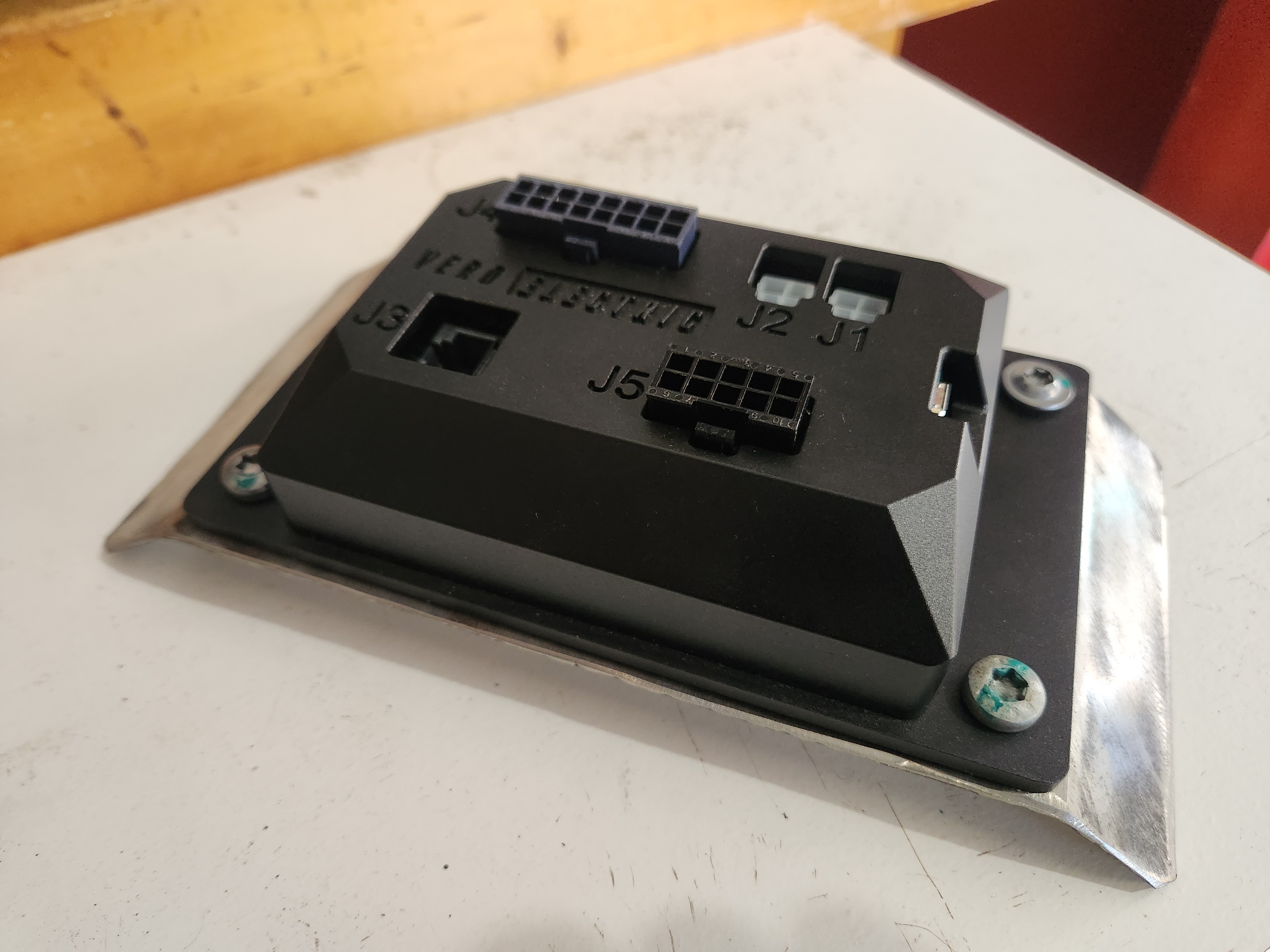

With the engine bay wiring mostly done, moving back now under dashboard. I'm using a VeroBMS (SIMPBMS based) and electing to mount under dashboard. After drilling holes in firewall to mount my steering ECU, I realized it is better to weld mounting brackets than drill so many holes, so made up a bracket and welded into place. Also tidied up the new wiring loom and wired in the steering ECU control line into switched power and BMS into perm 12V.
Nextion display fits right into the radio space, not sure yet if I will 3D print an enclosure, or get a smaller display and put in the ashtray hole below
A couple of things I don't yet know is if SIMPBMS can read ISA shunt current info via CAN from Zombie, or if I need a separate current sensor, and, since the BMS is on perm 12V, if I can control it so the Nextion display is only on with T15 Ign power. I can run the 5V feed to Nextion through a relay if needed, but not sure if a setting already exists

robertwa wrote: Tue Sep 17, 2024 3:13 am I don't yet know is if SIMPBMS can read ISA shunt current info via CAN from Zombie
Couldn't they both read the packages if they are on the same CAN?
Posted: Wed Sep 18, 2024 1:44 am
by robertwa
marcexec wrote: Tue Sep 17, 2024 12:54 pm Couldn't they both read the packages if they are on the same CAN?
Yes, I read up on this a little more today, and emailed Reider from VERO BMS. Looks like I can configure BMS to read the shunt. Will need to rerun the CAN lines through the dash, which probably is a good thing since I may end up with CAN speedo etc anyway.
