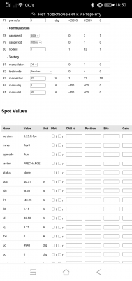

Re: IPM Motor - Auto-setup
no. I disassembled the part where the gearbox is. there's just the motor and that's it. I also have the ability to slowly rotate the motor with my hands.
So what is the correct order of my actions for testing?
thank you for your contribution to the software of this project))
it's just described everywhere that the motor will rotate slowly. this is what I expected, not paying attention to whether the system writes any messages. it definitely switches to the startup mode, since when any ID current is indicated, the sound of pwm operation appears. a little later I will return home and continue these experiments

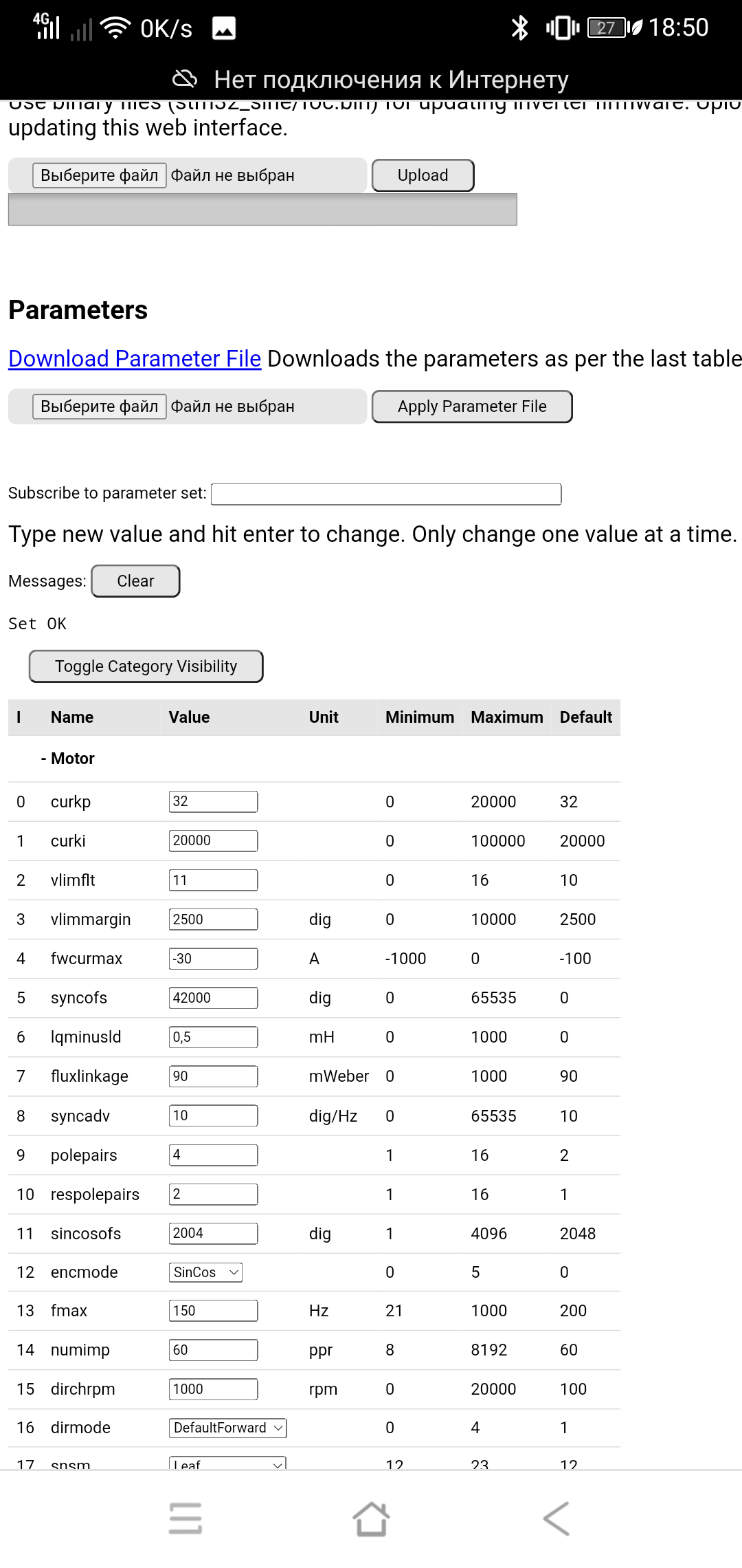

in general, either I'm not doing it right, or it doesn't work. I reached 50 amrer manual id current, the motor did not move, only squeaked louder. at the same time, the battery current has increased to 4 amps, and the motor current can be seen in the screenshot. after each new value, only the message "set ok" appeared, but none of those messages that should indicate the correctness of the connections. in the rotation check mode, the motor also does not rotate. if I add the position of the throttle stick at any moment, then the motor starts to rotate as usual. at the same time, the system does not issue any messages.

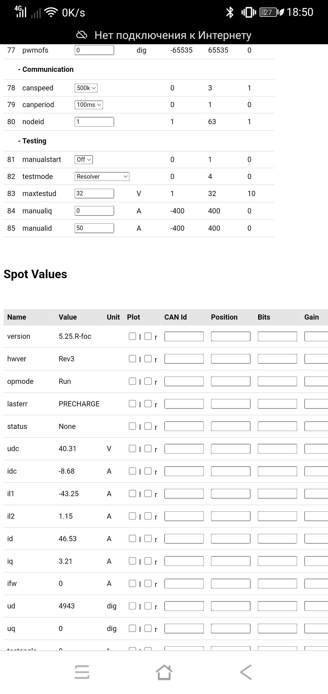

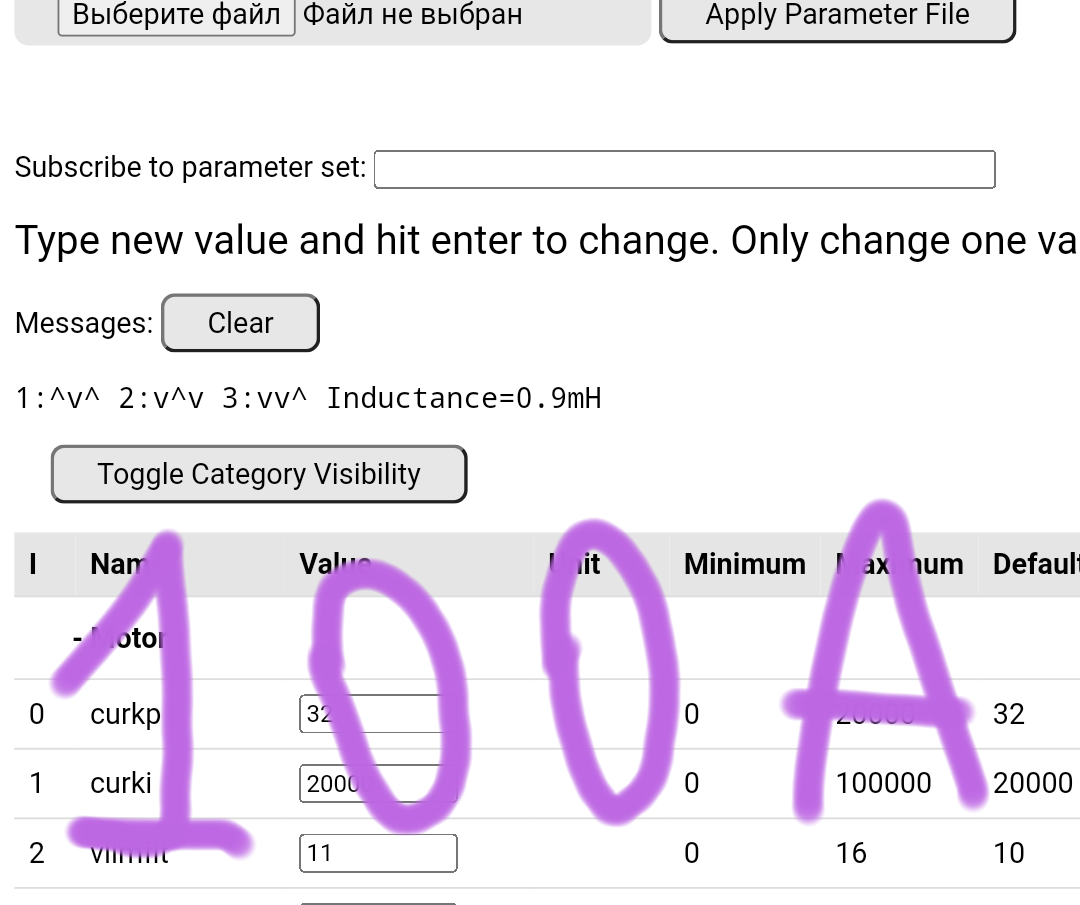

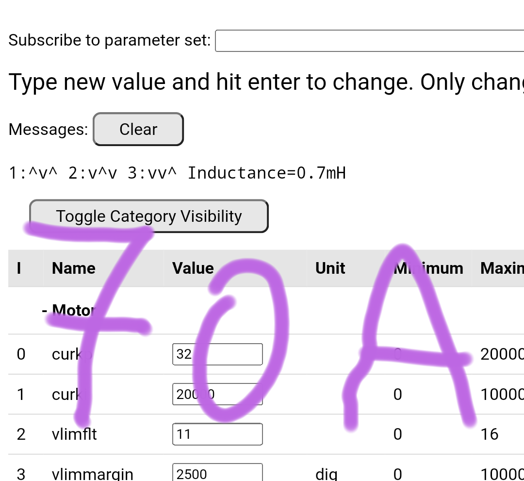

so. I realized my mistake. I started the inverter in manual mode in the usual NEW way, which Johu added instead of the old one that was not working. and it was necessary to launch the OLD version with the button at the top. However, there was no rotation in any of the modes, although in the bidir mode the motor oscillated back and forth. However, I did not figure out how to get graphs by phases and sine/cosine of the chip.

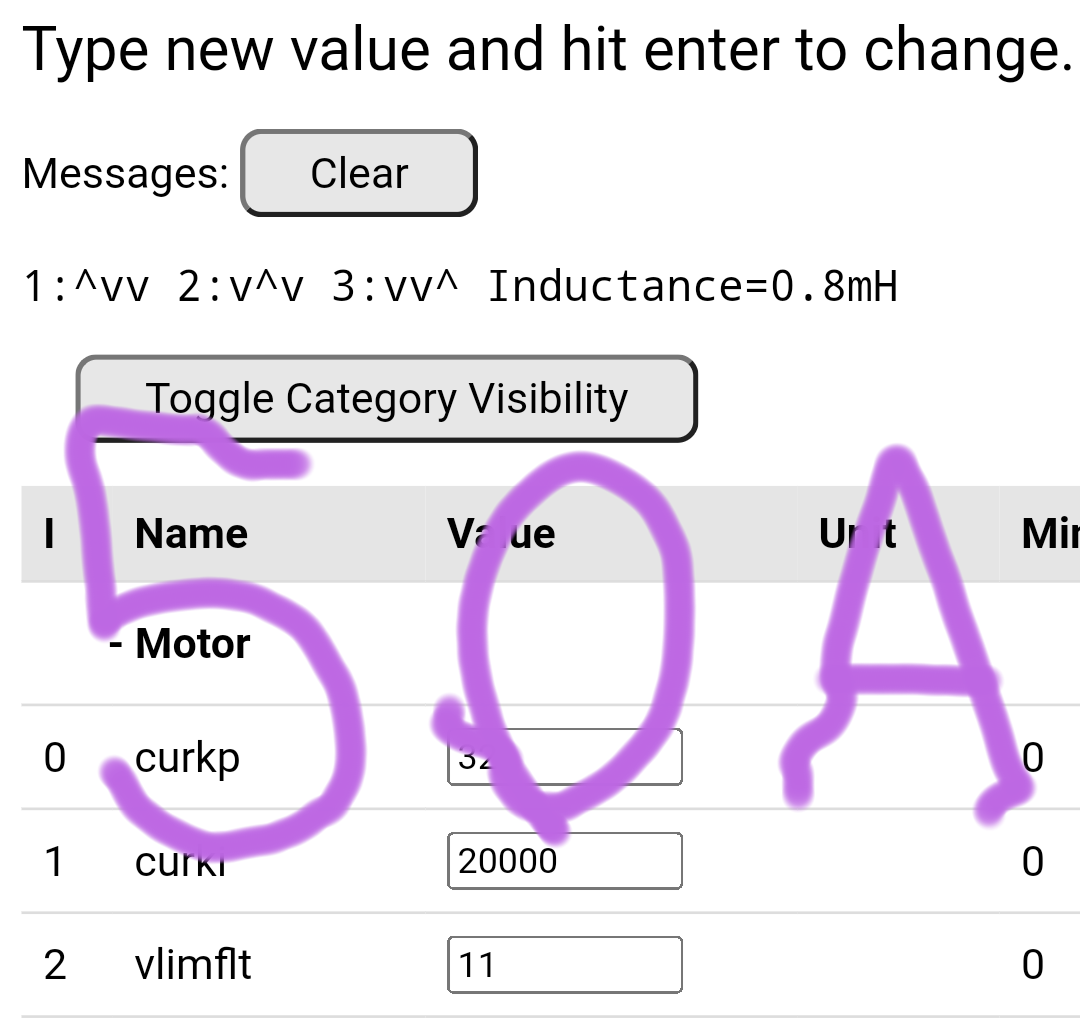

here is such a strange answer I received in the phase check mode at a current of manual id = 20 amperes
the first test is for 50 amps. he slightly shifted the position of the rotor and subsequent tests already showed the phases differently. Question: depending on the position of the rotor, the phase test gives different values, how do I know that the phases are connected correctly or incorrectly?
The phase check test doesn't use manual id at all so it shouldn't make any difference. I think it's the rotor position that makes the difference (changes the magnitude of the individual phase currents a little)
Looks like I may need to adjust some of the thresholds in the code, just need to figure out which
Edit - actually your last test gave the pattern for correct CT phasing, the inductance is believable too
Just need to work out what thresholds are needed to get repeatable results.
Edit2 - Might be worth manually adjusting the rotor position and rerunning the test a few times to get an idea as to how often you get the correct ^vv v^v vv^ sequence

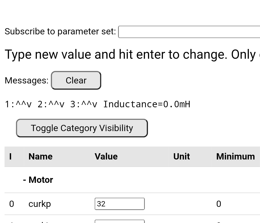

I have turned the rotor again and now it is no longer possible to run the phase check with any current. there is always an overload message. in normal mode, the motor still works adequately.
Looks like the thresholds that work on the HSG motor I have here are a bit marginal on yours. I may need to add some more debug/monitoring code to work out what's going on, or add more parameters to allow some adjustment.

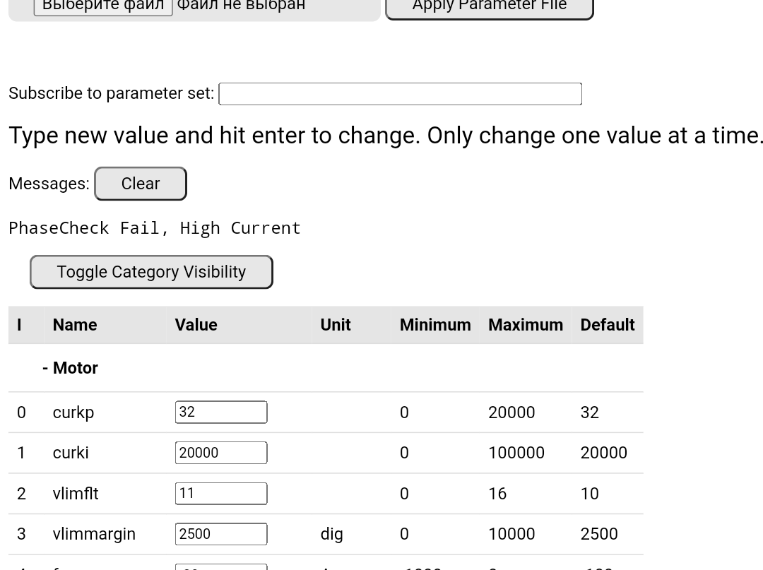

I must have broken everything. after trying to start the rotation mode, I always get an overcurrent message when trying to check the phases. even restarting the controller did not give a result. I scrolled the motor through the steps of the entire revolution and always when checking the phases with any current id, I receive an overload message. in normal mode, the motor still works adequately.

Udc is reading right isn't it? If it's reading low then it could cause that problem.
