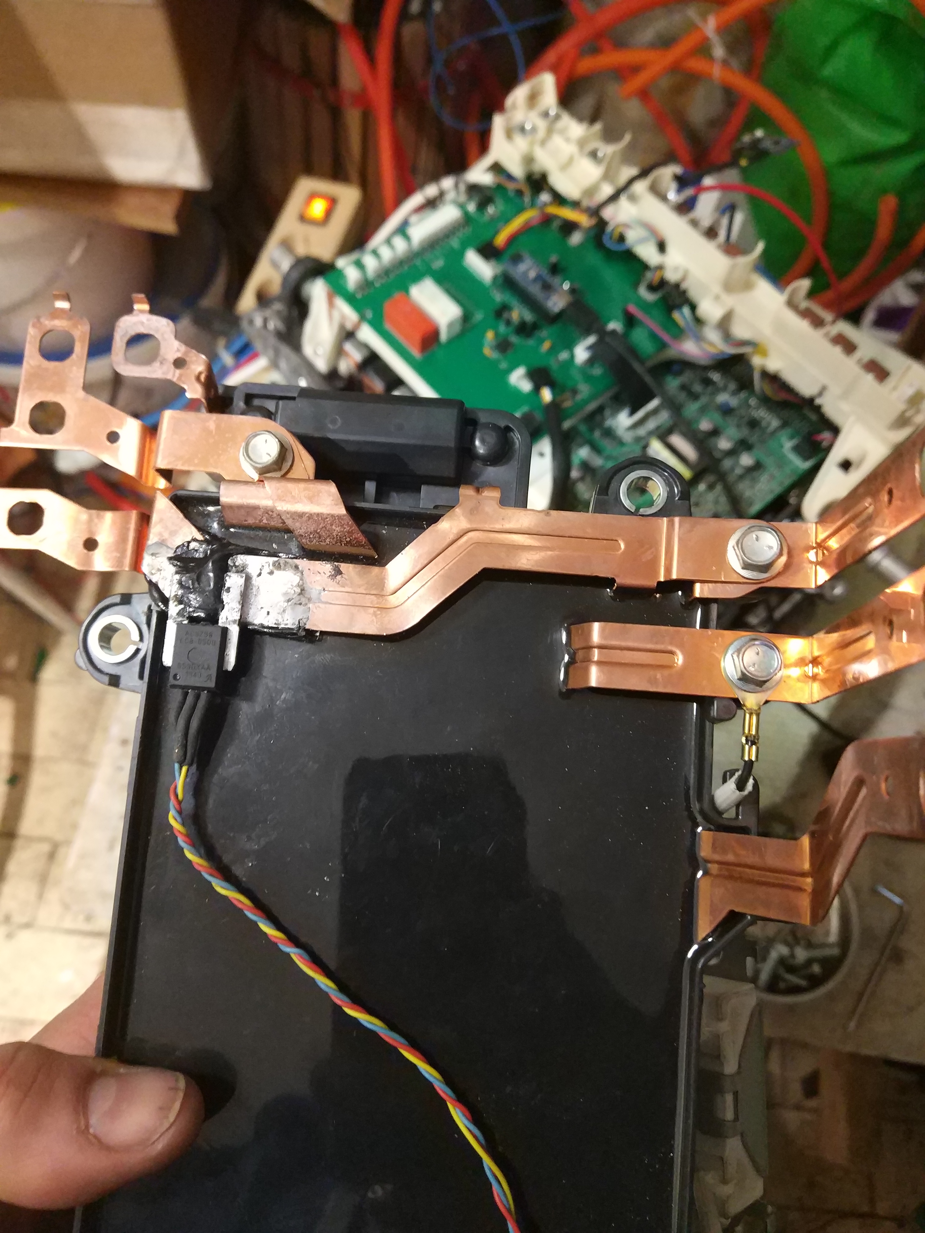

I succesfully connected battery and mains together to Prius inverter with my interface. Both voltage readout and reporting works through UART.
I made a simple current sensor setup. I soldered my 50A sensor to positive rail and then cut this rail and glued an isolated material underside it. Current sensor reporting works, i tested it with 12V 25A load.
I was not succesful in ordering charger to start providing 5A to 280Vdc battery from 320V rectified mains. I think i have setup my interface with too many safeties. One of them (UVLO) is acting up.
EDIT1: DOH! it is really simple. Charger doesnt work because i didnt connect BMS and EOC pins in a loop. This loop needs to be connected in order for the charger to work. Very simple BMS can be used with this loop.
EDIT2: I also noticed -5 voltage regulator is used to provide reference to HV side voltage reporting. Battery side voltage can work with regular 5Vdc.

I am not inclined of using Prius current sensors for charger function. It is on the wrong side and the mechanism which would control output definitely has some phase shift. Not a good idea anyways also for CAN control.
My application is designed around ACS758LCB-100U sensor. I am sure we wont need more :).
What i did is solder the ACS758LCB-100U onto the positive battery track of large cap and then used dremel cutter to cut the track between sensor prongs. Then i reinforced the joint with some PCB plastic sheet and generous ammount of gasket sealant. Sealant hardens and provides good adhesion to reinforce soldered track against vibration.
Charger board design includes space for 3x relays. One AC/DC relay, one liquid pump relay and enable relay for DCDC part and interlock function. This means if i have connected charger then car wont drive as well as charger wont function if car is started.
Another option would be to cut/remove the positive track from the cap and use a 10mm2 cable and 100A rated 5V hall current sensor. It would require some calibration in software but would maybe be cleaner installation. See here how i would cut positive track from Yaris cap and install cable from that bolt to positive battery connection. Current sensor could be some 100A LEM on the side.
