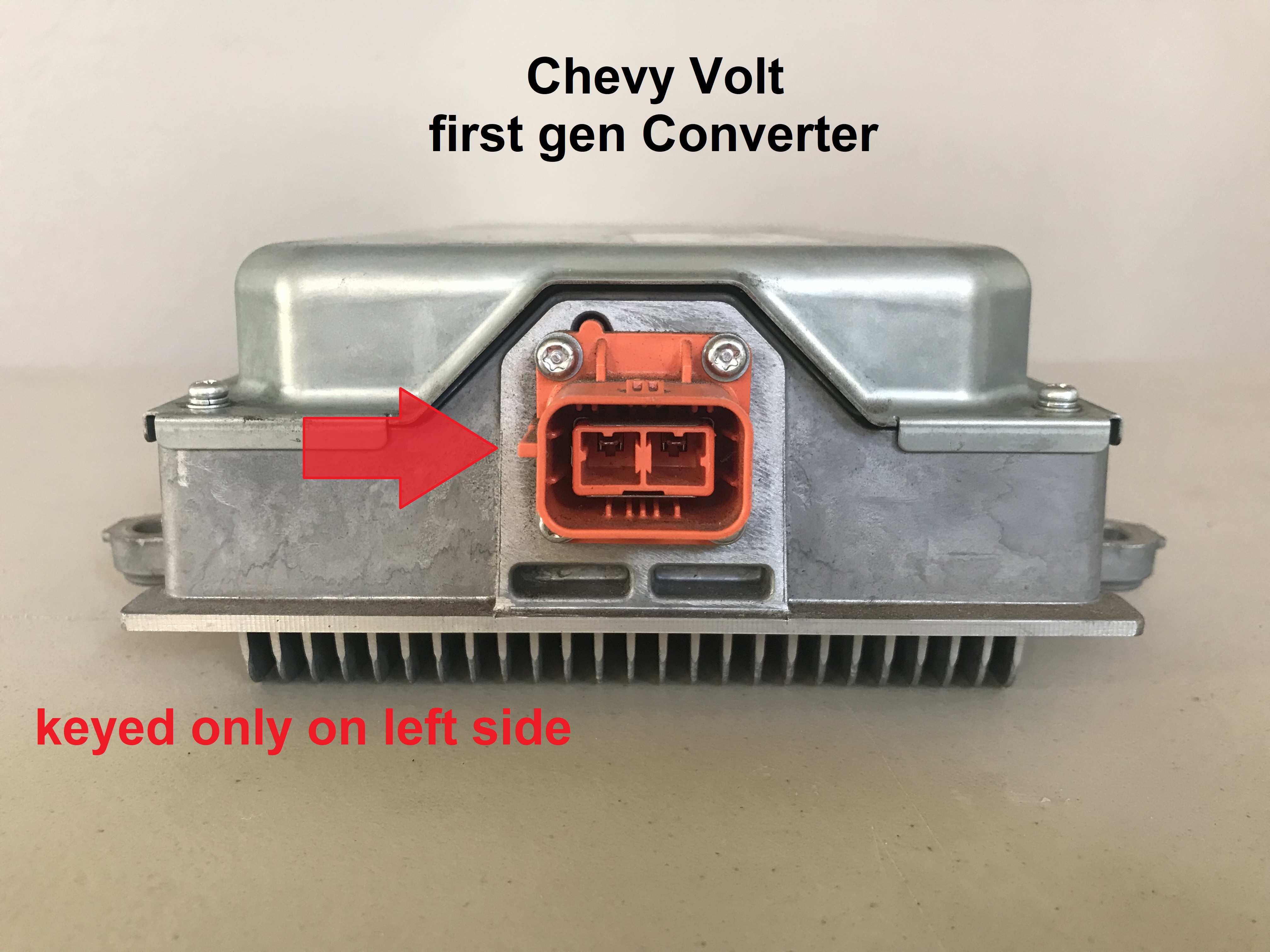

folks what we have here is the making of a Mr. Arber Kramar of LEAFDRIVEBLOG fame Starter Kit, so why don't you lean in a bit closer and set your eyeballs on this there second gen DC-DC converter orange (pronounced: high voltage) plugulator
Note how the orange square(ish) plug is keyed? One protrusion/notch thingie on the left, whilst a double on the opposite side?

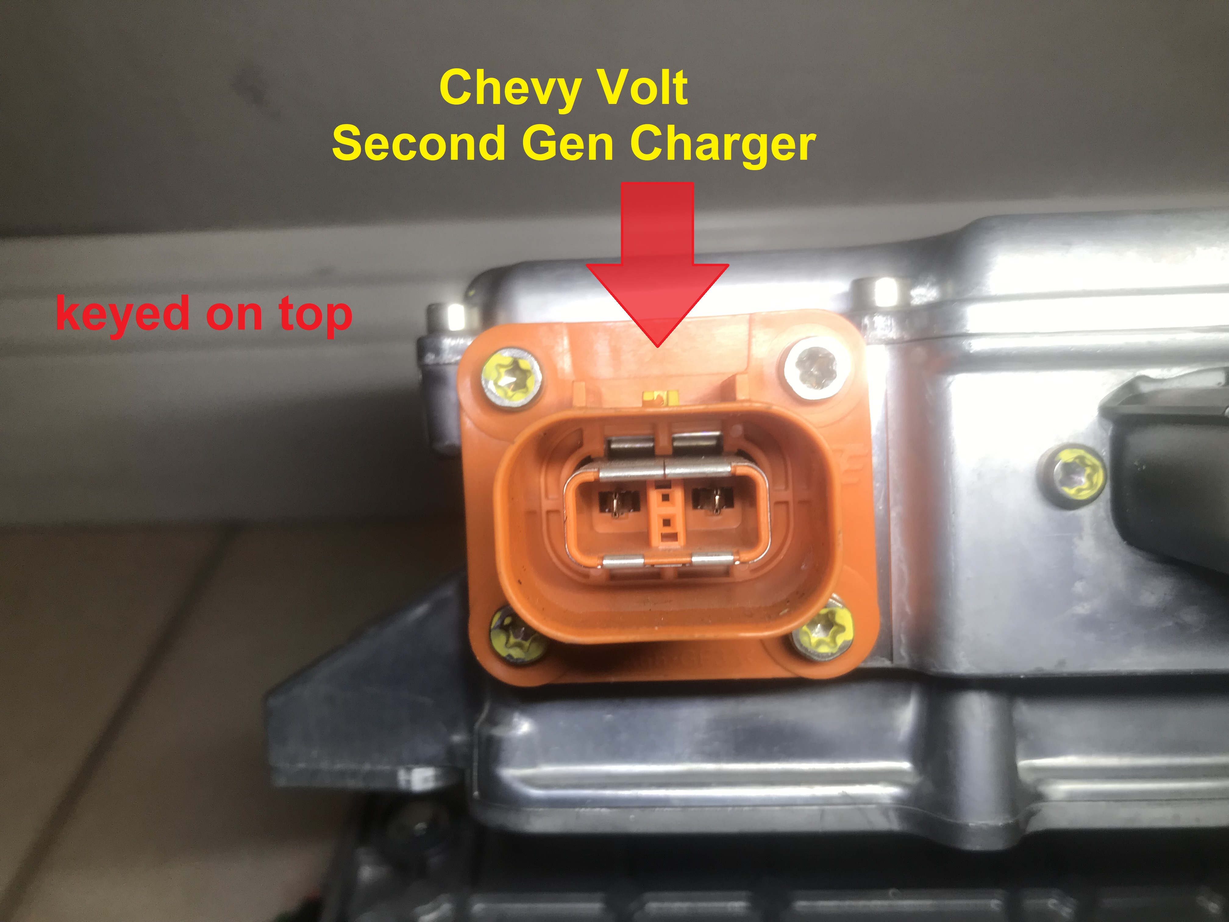

now let's stare and compare that to the orange (high voltage) plugs on the second gen charger
I believe this one below runs to the high voltage battery pack
and this side is where the charge port plugs in

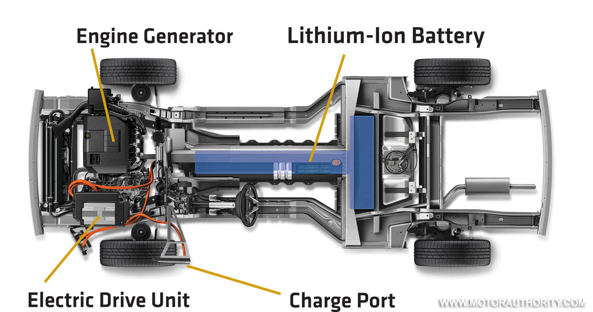

so I thought this diagram picture thingie was cute and worthy of cluttering up our thread, oh it also pretends to show where the charge port actually lives on the first gen Chevy Volt
um ok...
ok, call me crazy, but where the hewk did that charge port door go?

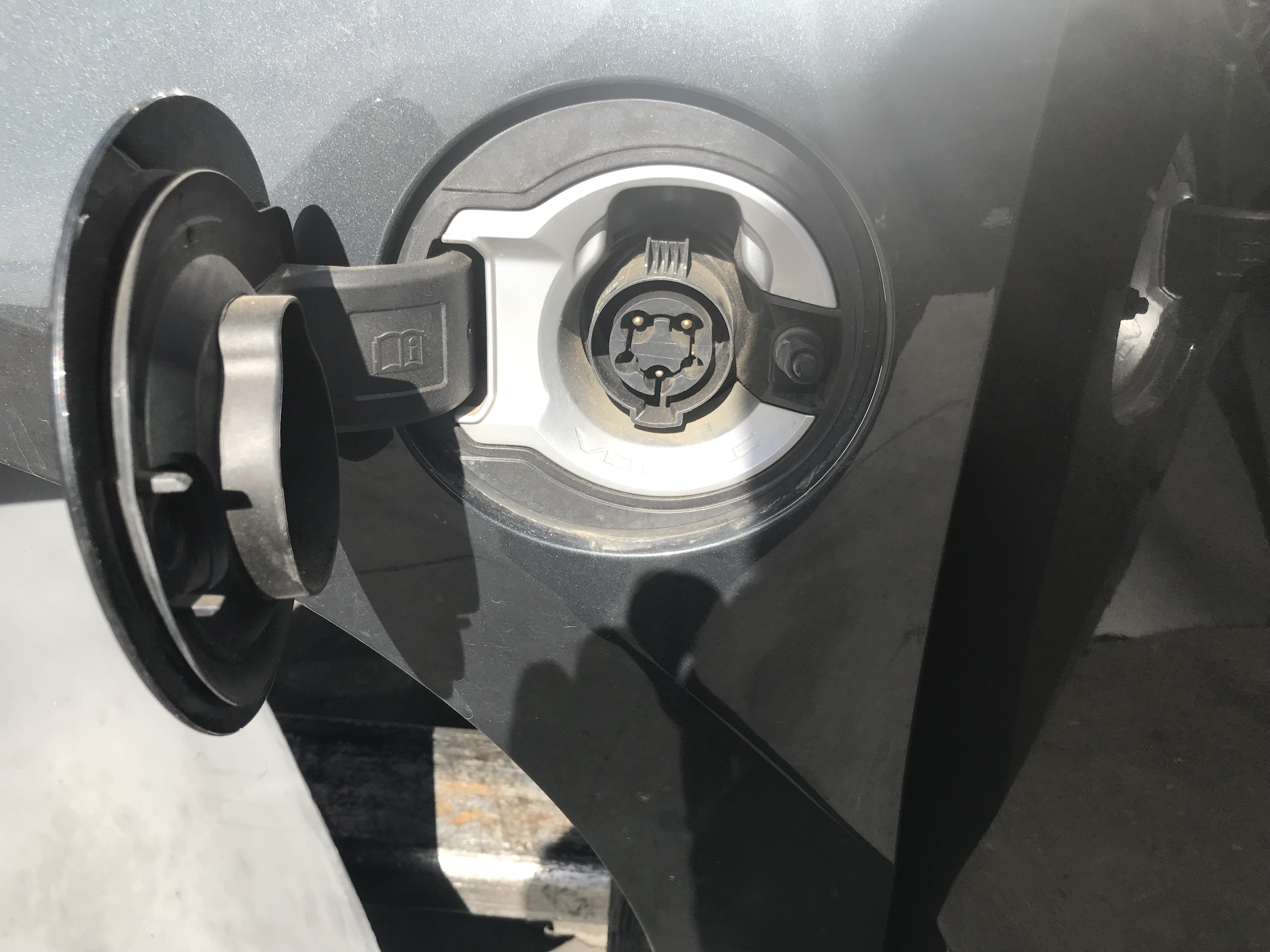

I also asked them for the charge port and its orange tail, please be advised, unlike all the other orange "two nostril" cables, this one has three nostrils!
ask and though shall receive

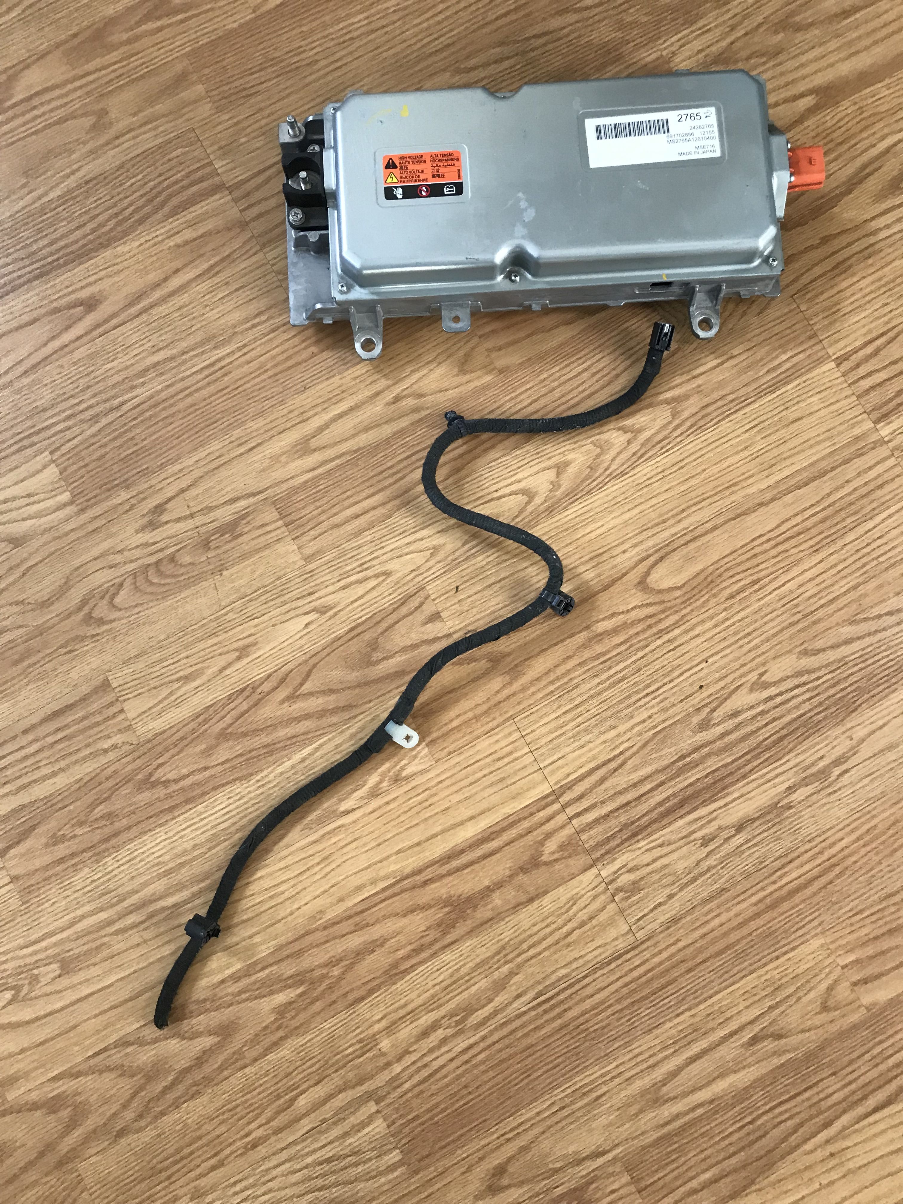

Re: I bought a Chevy Volt Gen1 DC-DC Converter - Now What?
Posted: Sat Mar 05, 2022 3:07 pm
by Gregski
so I am happy to report the fraternal twins have been reunited as I just scored a Chevy Volt gen 1 (2011-2015) onboard battery charger for $280
and I must say the father and son Armenian duo at the wrecker (in Rancho Cordova, California) that sold it to me, are the nicest salt of the earth folks I ever ranned into - Thank You So Much

just want to point out and caution folks that none of the orange high voltage cables are interchangeable between the first gen and the second gen
here we stare and compare the DC-DC converter two nostril ports and see how they are keyed differently

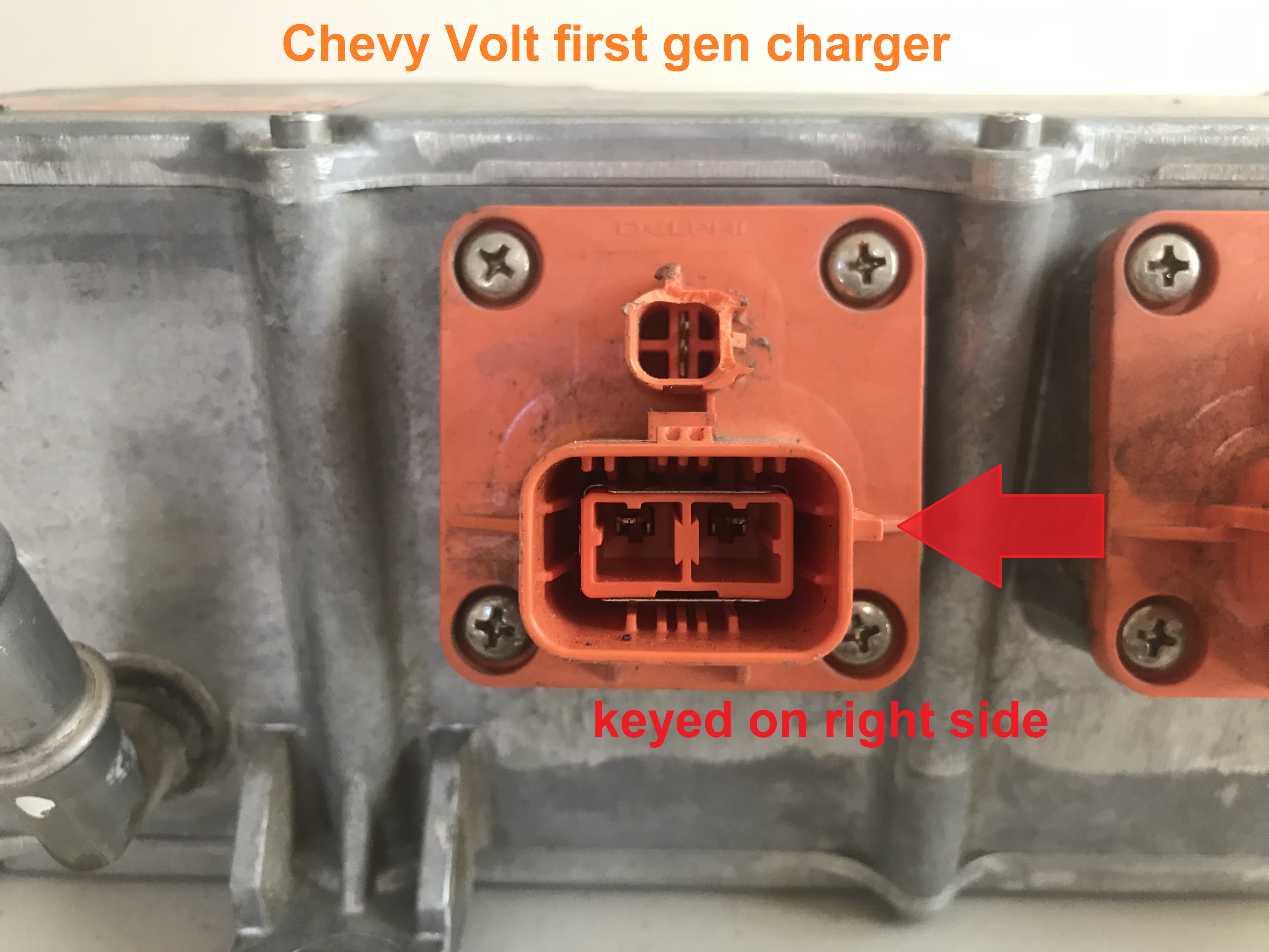

Posted: Sun Mar 06, 2022 2:36 pm
by Gregski
and just for giggles here is the comparison of the orange high voltage two nostril ports of the first and second gen onboard battery chargers
and yes, GM had one job: make every single orange port/connector different... and ... [wait for it] ... THEY NAILED IT !!!

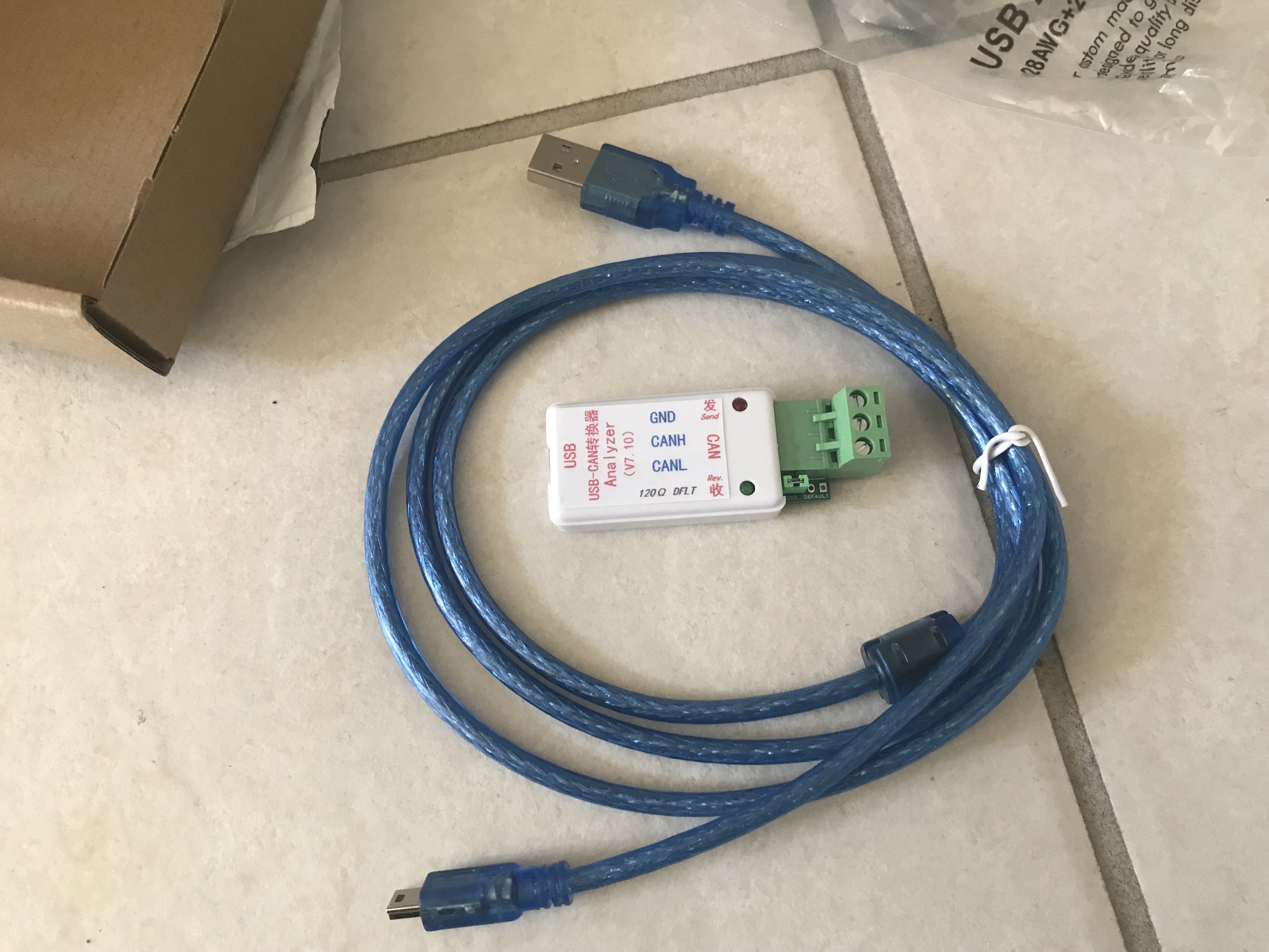

Posted: Sun Mar 06, 2022 4:36 pm
by Gregski
and what do we have here ?
Why it's the first of our CAN Bus analyzer gizmos, which we hope to compare and contrast and evaluate and rate
Company: Seeed
Model: USB-CAN Analyzer
Price: $40 (listed on the Seeed website for $25 but by the time you add shipping, tax and license, clear coat, etc... you get the idea plus it would take 20 days to get here)
Source: AMAZON
