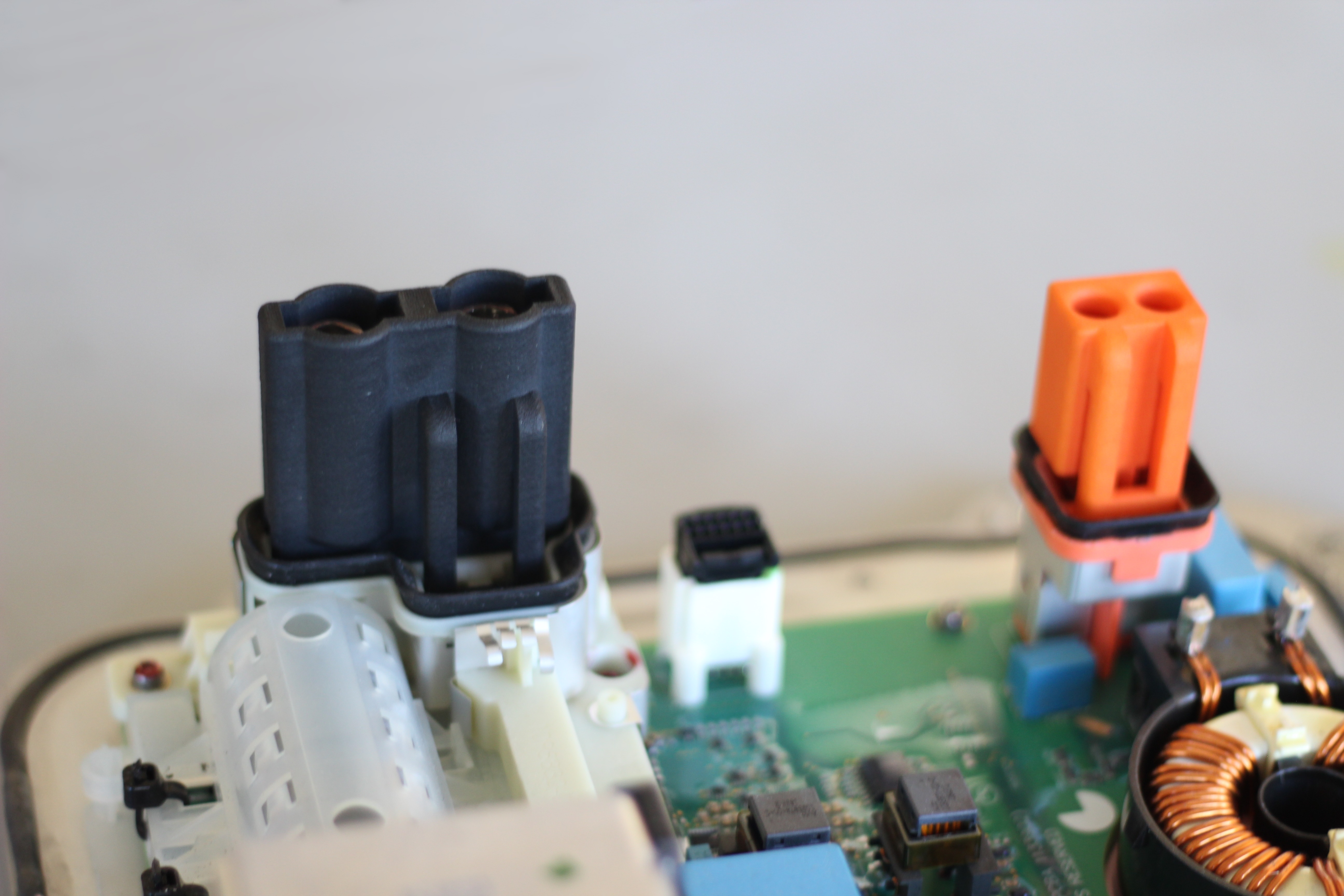

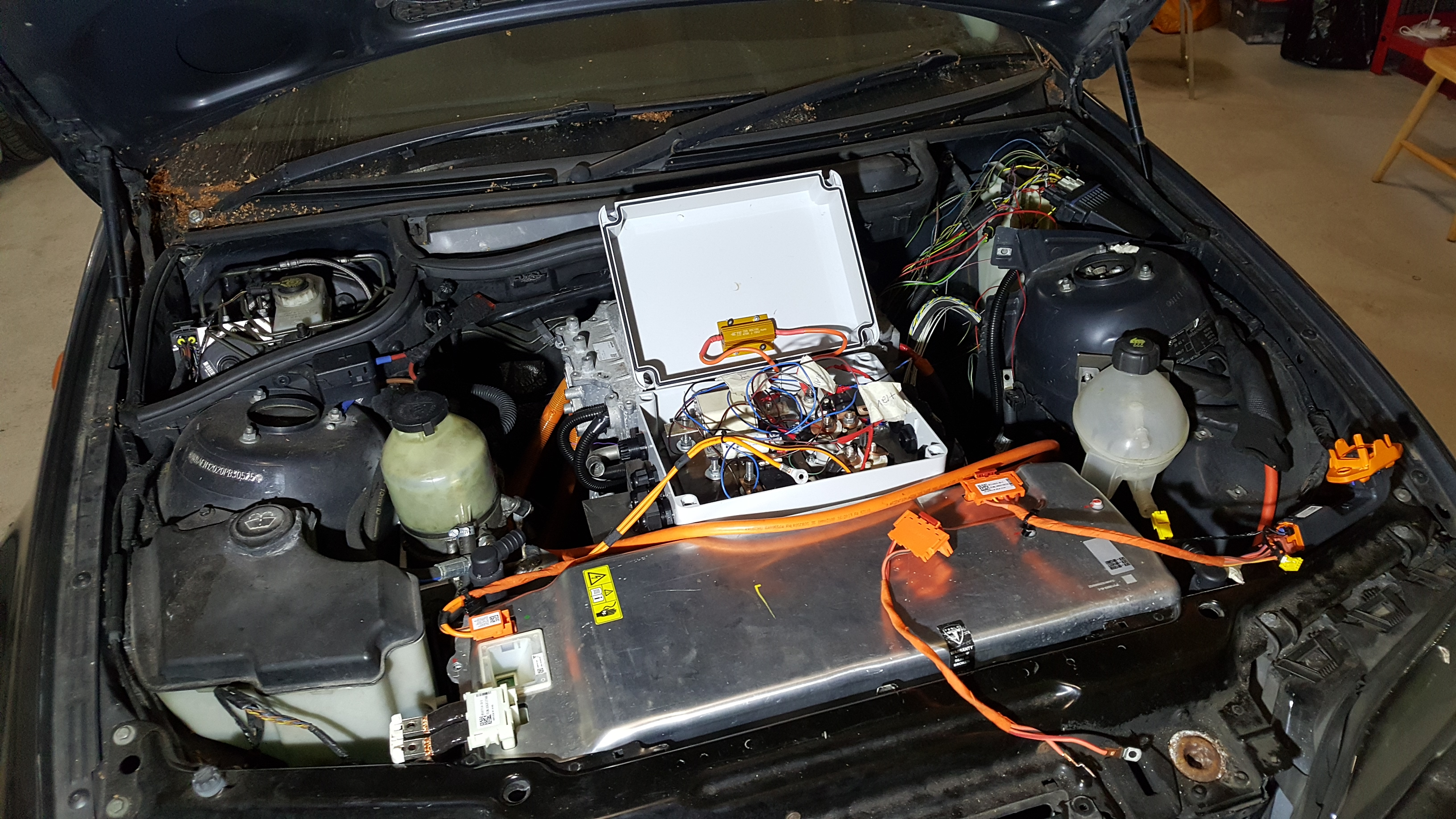

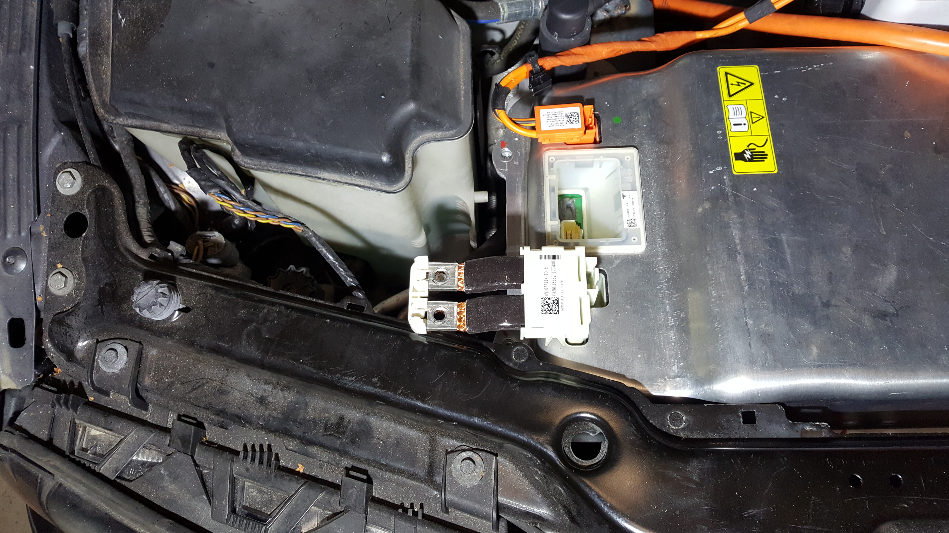

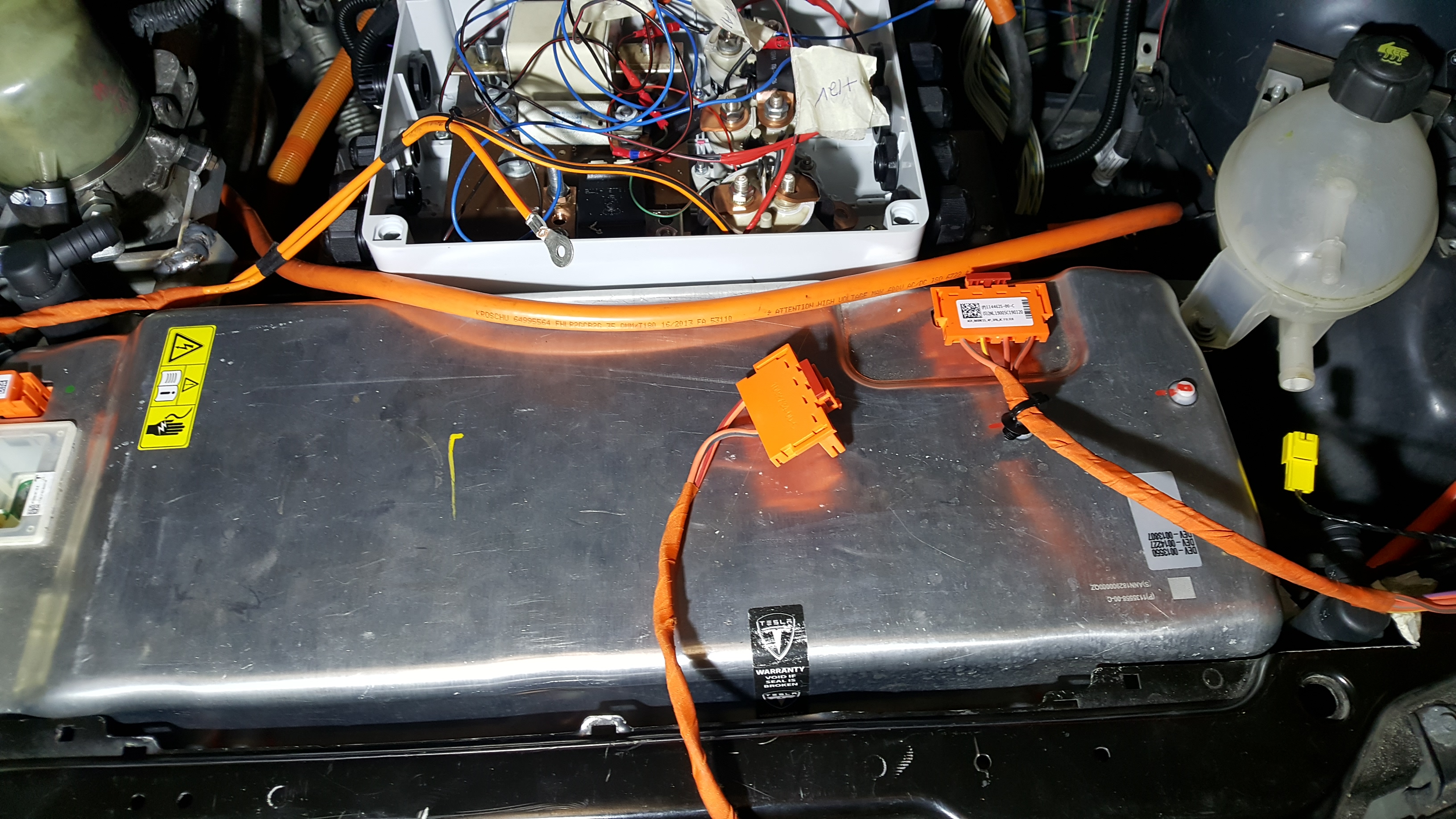

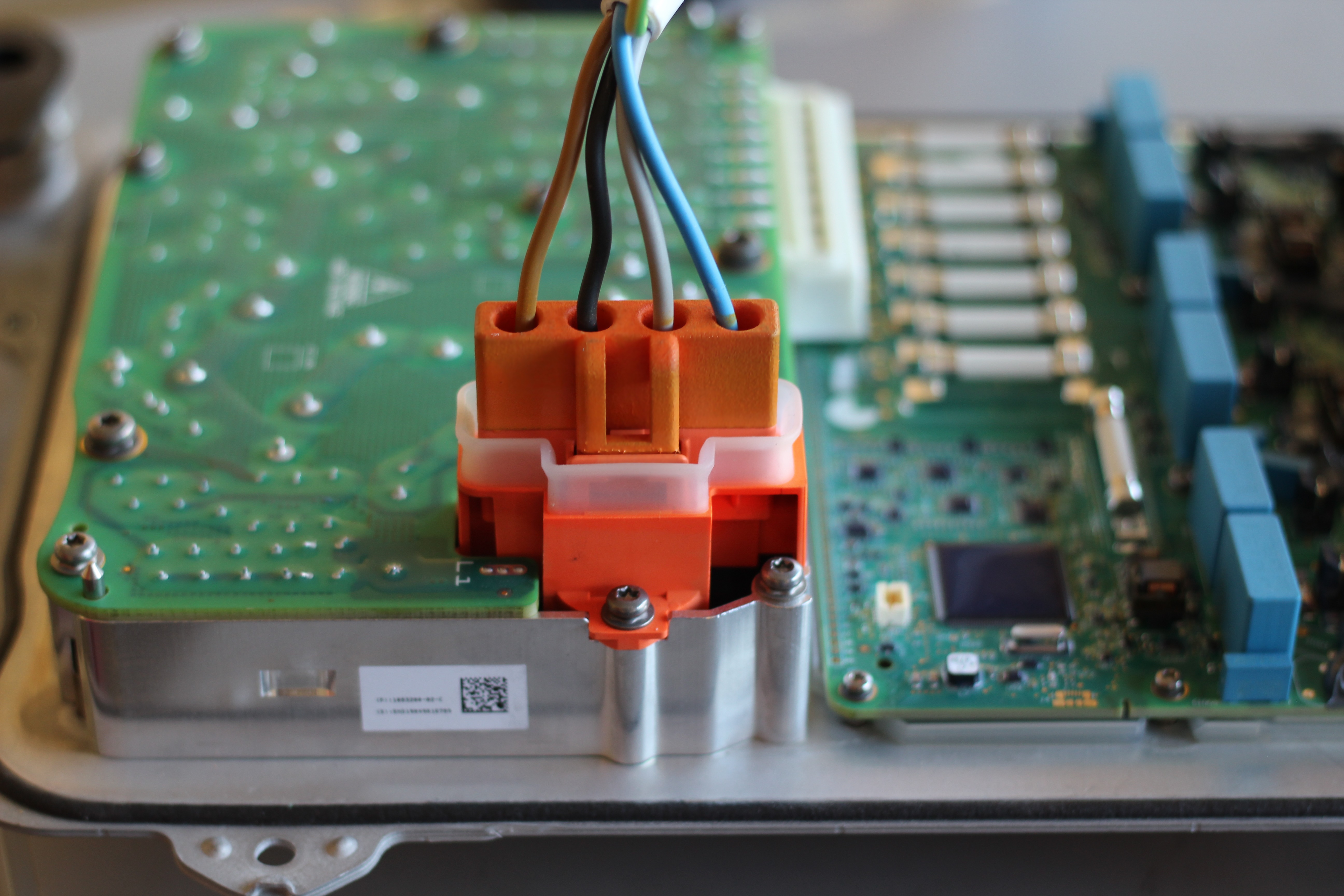

Some good work today. Pcs is mounted and secure as is the high voltage junction box.
Need some help locating two components. The 12v high current plug and a european AC connector plug. As my pcs was US I only have the single phase connector plug. The ones pictured do not belong to me so I cant butcher them:)

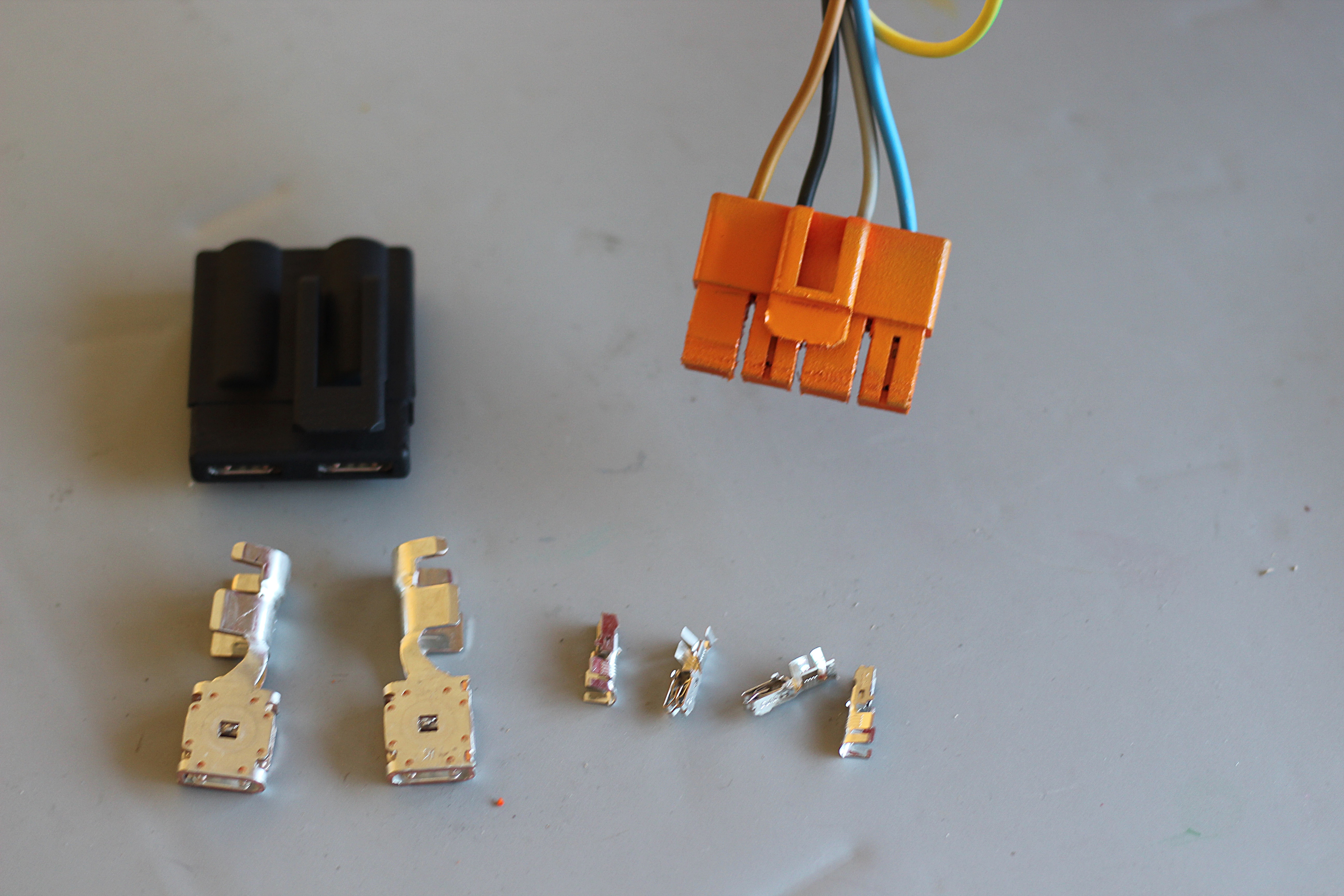

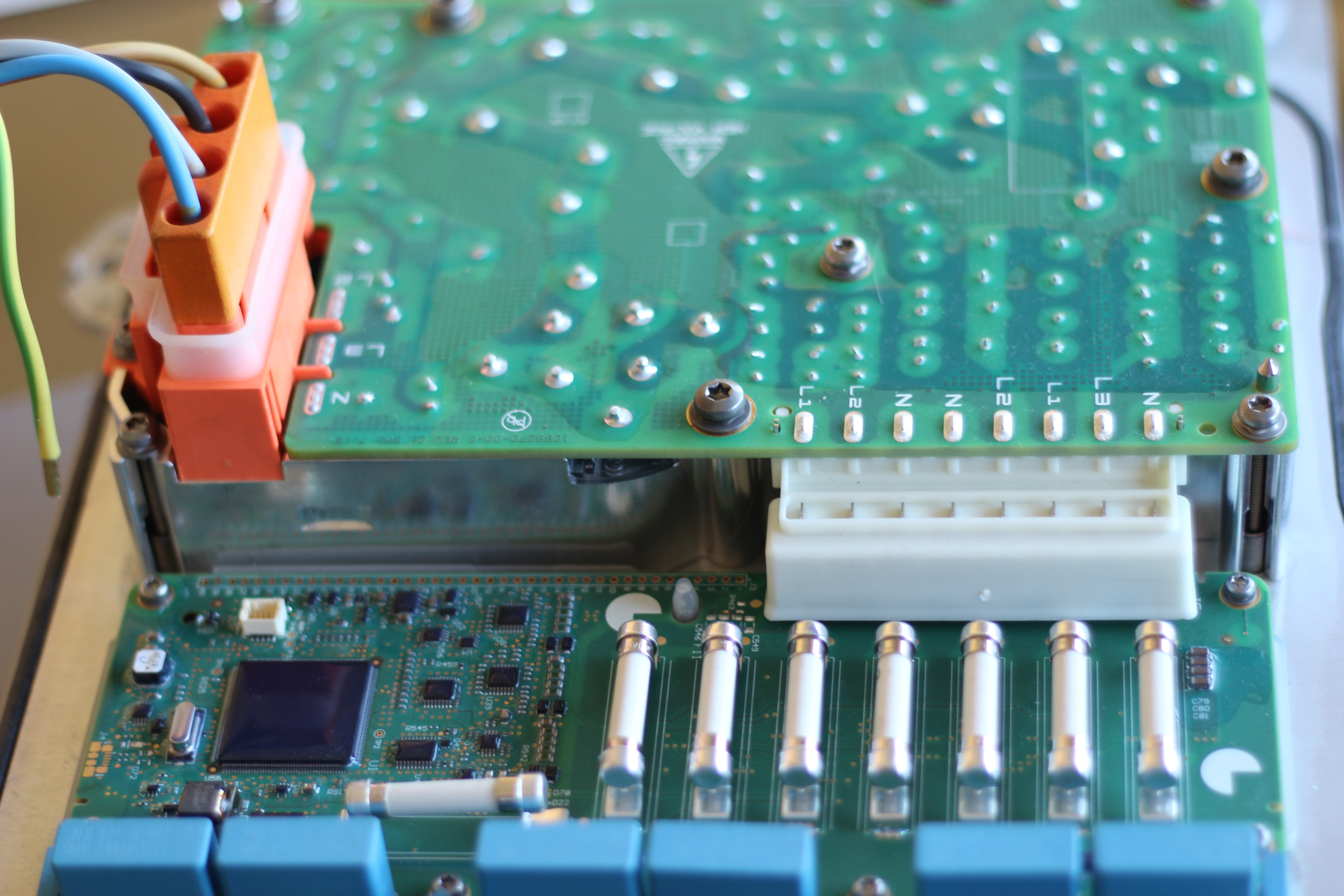

Hello Damien,
I had the same problem. My solution is 3D printing. The contacts for 400V are Uni F630 from MTA, part number 1107940. For 12V Kostal PLK 14.5, part number 23124734300. The connector for the data is from TE connectivity, part number 1318774-1 for white or 1318774-2 for black.
The European PCS looks a little different. The board at the inlet is lower, the lettering is different, and there are two more fuses.

Thank you very much:)
