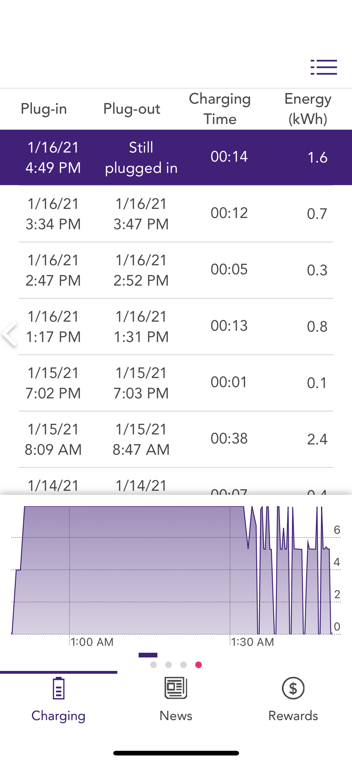

Loaded via the header and I’m seeing 32A, which sounds more like it for the taper. Thanks gents.
Spoke too soon, I’m getting similar behavior to the CAN dropout bug:
In the middle-end of the session here you can see I lowered iaclim until I got a stable charge (16A
, then went to 20A stable, then 25 and the bug kicked in again:

Hmm, could you log the various temperatures? Seems weird the bug would only occur at higher load and after such a long delay.

What’s your cooling setup and charger mounting position as well?
Re: Tesla Charger alternative firmware
Posted: Sun Jan 17, 2021 4:22 pm
by Bryson
Will check out temps today - the charger is horizontal, bled fine, using a D5 pump and a 4x8 radiator with small fans. The exhaust from the fans didn’t feel warm, nor did the coolant reservoir. In the past I ran it without the fans on and got the coolant warm to the touch without any issues. I had stopped the charger (powered down) for 10 minutes mid charge before retrying, so I’m not sure it’s temp related. I also haven’t broken the setup since completing a clean 26kWh charge at 40A.
