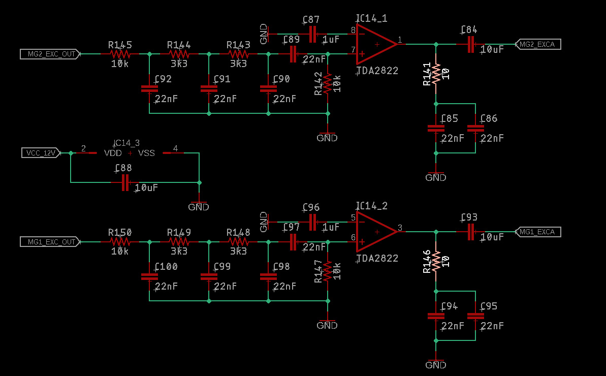

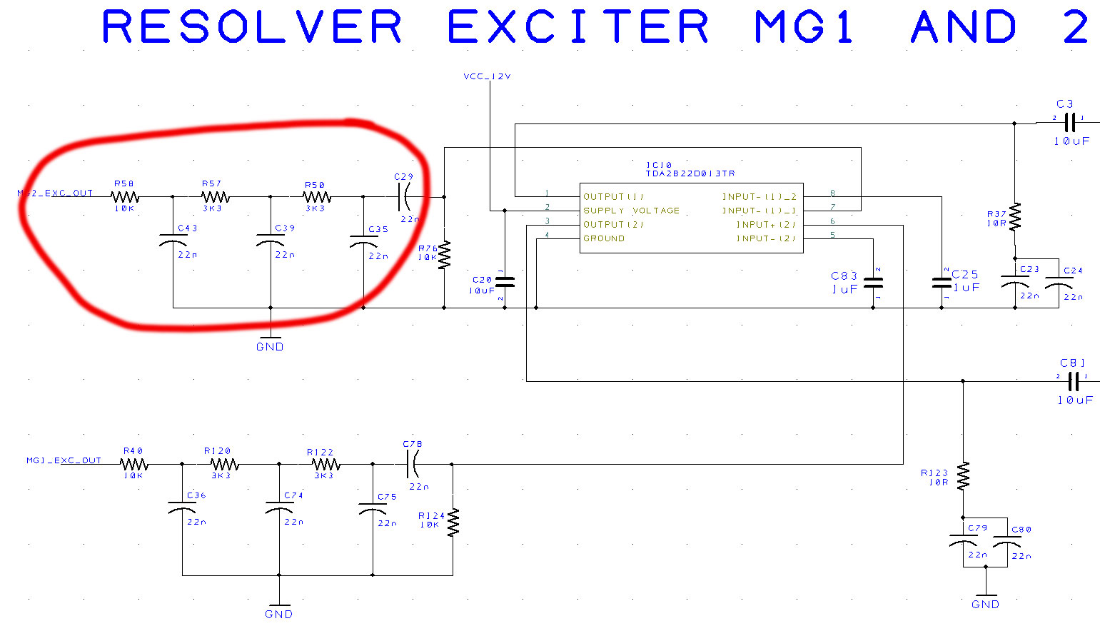

Someone can explain to me what is the purpose of this RC elements in Resolver Exciter. Or point me to a topic where it was discussed/explained?
It's seams to be copied over and over, but I don't understand why :)
Thx.

Re: Prius Gen 3 Dual Motor Logic Board Support Thread
Its a 3 stage RC filter to convert square wave from the stm32 to sine wave for resolver excitation.

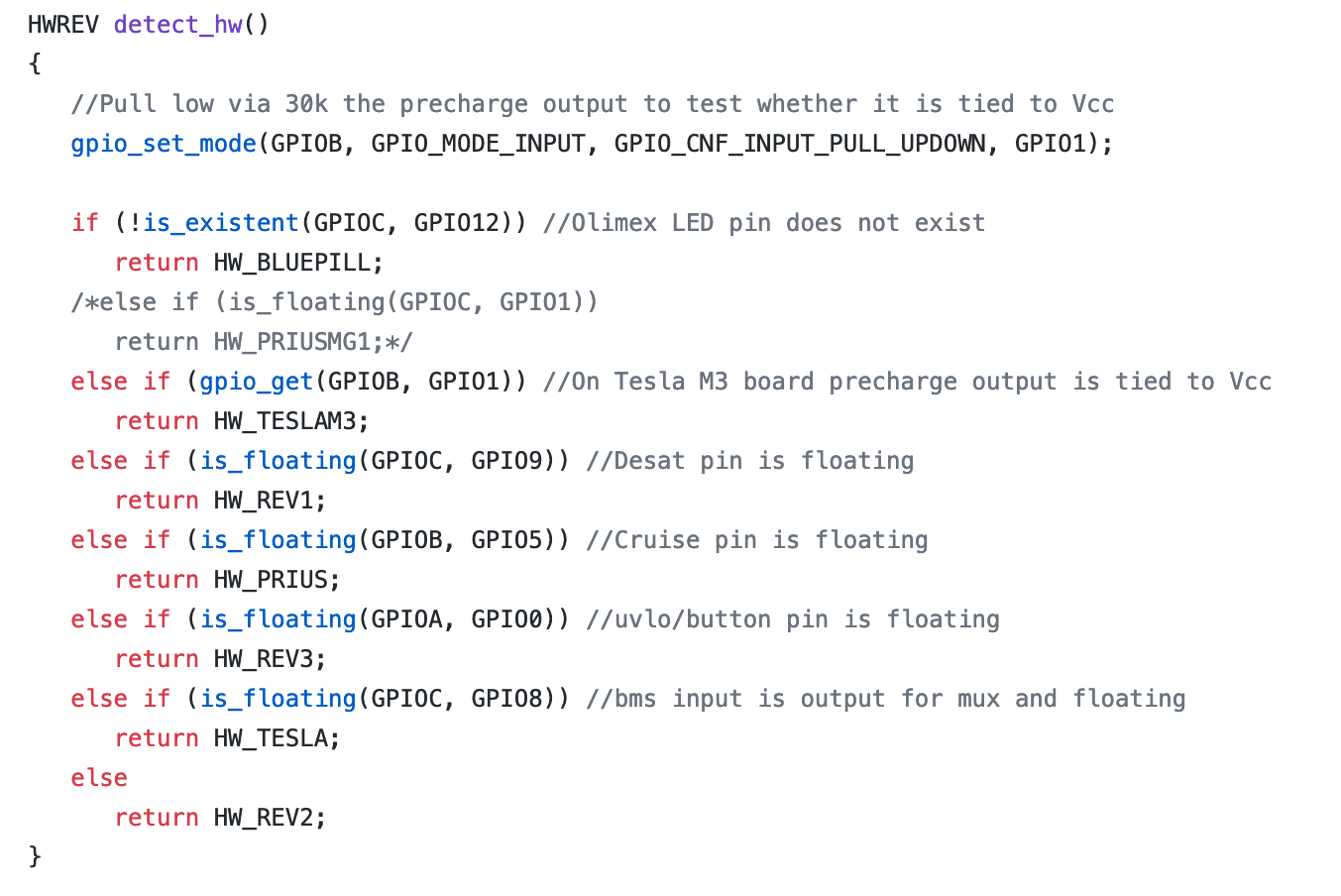

The software can recognize MG1 and MG2
MG2 = Prius
If you look in hwinit.cpp
The program identifies "Mg2/Prius" by checking if output GPIOB, GPIO5 is floating. I had to remove R18 and C9 to get it floating.
I do not know how Damien and others have done.
Johannes has disabled the possibility for the program to identify Mg1 in ver 4.97R. Try an earlier version.
"Removed Prius MG1 detection, wasn't reliable"
Been thanked: 1913 times
Just saw this. MG1 detection won't help, it was meant for something else and is now superseded.
Without resolver the motor won't do much but you can try to spin in manual mode: https://openinverter.org/wiki/Schematic ... _the_motor
CAN problem: only 8 items per message can be mapped, maybe you exceeded that? It will display an according message above parameters when you press TX and all slots are used.
It seems like you pressed TX many times. There is no duplication detection, so maybe you mapped the same data twice.

I have a problem with TDA2822 IC used in resolver circuit. It's warms a little till 11V (40mA), but above 11V it burns instantly.
First, I thought that it's shorted, but it behaves this same only connected to power.
It supposed to take up to 15V, but it's not :D
I know that my batch from Ali is defective, but I wonder if some of you experienced similar behavior.

zilion wrote: Tue Apr 13, 2021 6:02 pm I have a problem with TDA2822 IC used in resolver circuit. It's warms a little till 11V (40mA), but above 11V it burns instantly.
I've found the problem. It was two resistors R141 and R146 at the output that were 10K instead of 10 ohm.
Especially they were at the output it was the last place for me to look.
I'm not wise enough to explain this, why it took so much power to burn IC, but maybe someone is?

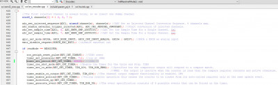

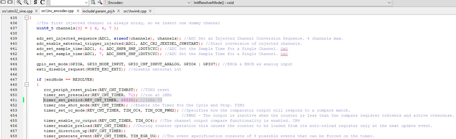

Johannes, I'm trying to understand your code for resolver, and it seams, that you drive excitation at 8Hz frequency.
Probably I'm wrong, but to me it seams so.
The code you pasted just shows the timer initialization. The timer is used to sample the resolver feedback exactly 40us after generating an edge on PD2. The actual excitation is just generated by toggling PD2 on every PWM interrupt. PWM interrupts occur at 8.8 kHz regardless the actual PWM frequency. So the resulting excitation frequency is 4.4 kHz.

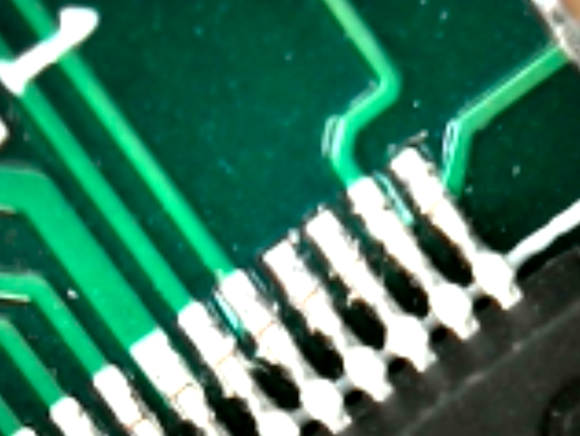

Posted this in my project thread, but posting here to get input from a wider audience.
I'm seeing an issue where my main contactor is not closing. I have UDCSW set to zero. The precharge contactor closes. No errors in the web interface. It seems like the inverter thinks it's closing the main contactor.
The main contactor definitely works. If I manually ground it, it closes OK.

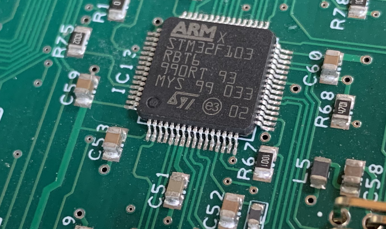

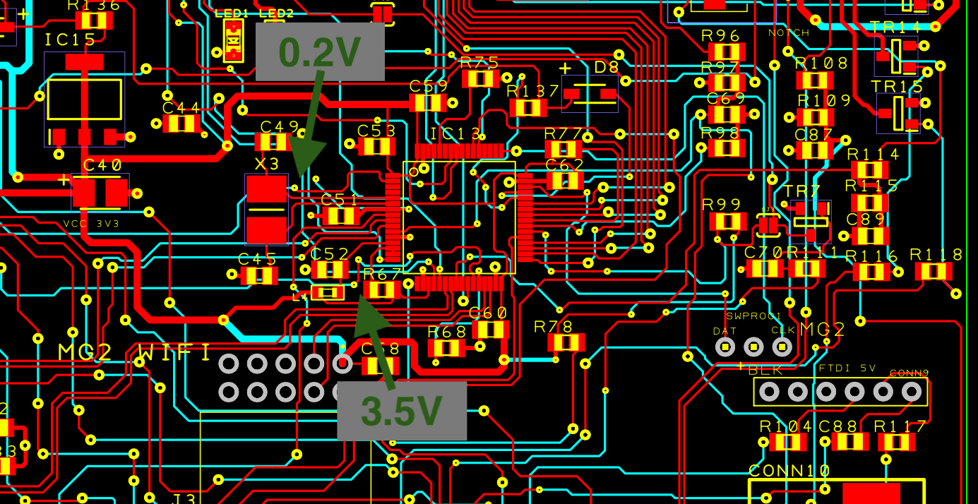

Tracing back from the precharge and main contactor lines, I see there are two test pads near the MG2 STM32F for these. I'm seeing 3.5V on the precharge line OK, but only 0.2V on the main contactor line. Could I have a bad STM32F? Is there something else I should test?
Anyone have any ideas or suggestions here? Am I being dense? Is there something else I should be trying?

chrskly wrote: Tue Jun 01, 2021 4:58 pm Anyone have any ideas or suggestions here? Am I being dense? Is there something else I should be trying?
Look at the 2nd pin of MG2 IC for some solder joints -it could be shorted there.
This line could be shorted by IC1. If it's still down, then desolder this IC1 and then check MG2_DCSW_OUT_2 line if it goes up.

zilion wrote: Tue Jun 08, 2021 5:18 am
Hey @zillion, thanks for the suggestions.
I removed IC1 again, powered up, made sure there were no errors in the web UI (like precharge errors) and then measured the voltage at pin 2. Still 0.2V :(
I had a look with my magnifying goggles and a USB microscope to try and check for any bridging or wonky solder joints. It all looks OK to me.
I also took my tiniest screwdriver and ran it between the pins to clear anything that might be there. Still no good.
So, I'm kind of stumped.
