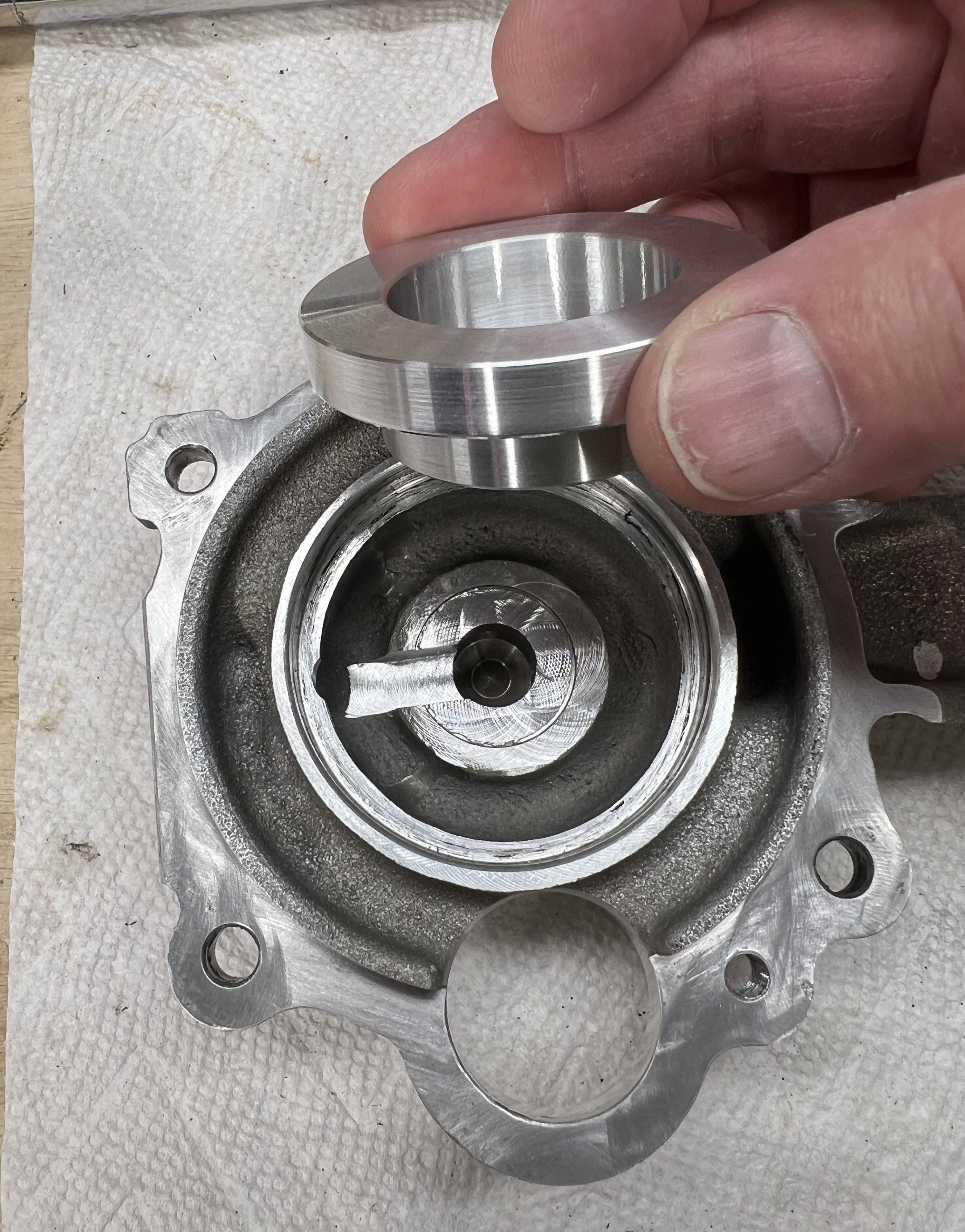

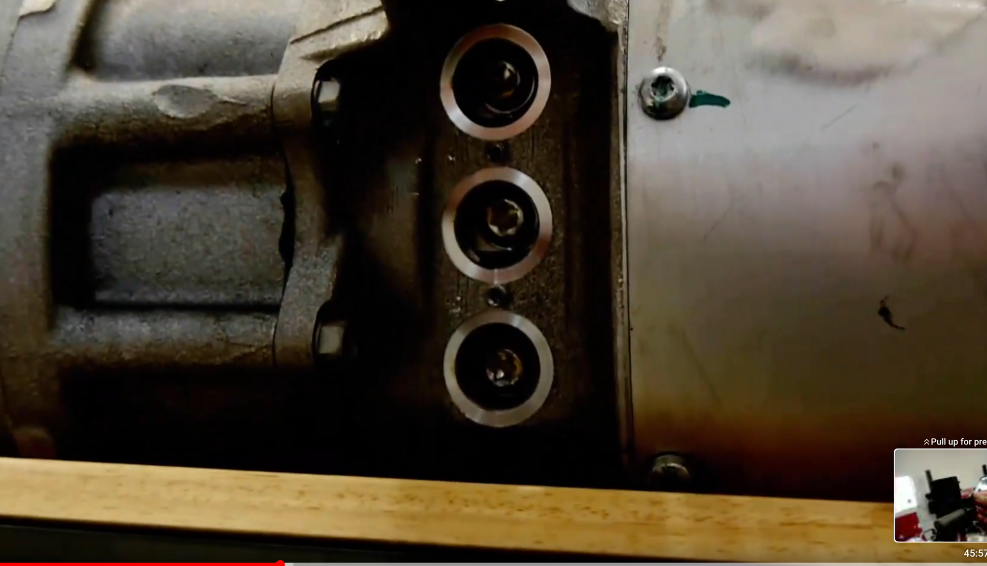

Bit of crossposting: coolant manifold plug of 6061:
https://www.myrav4ev.com/threads/anothe ... post-30941
Teaser:

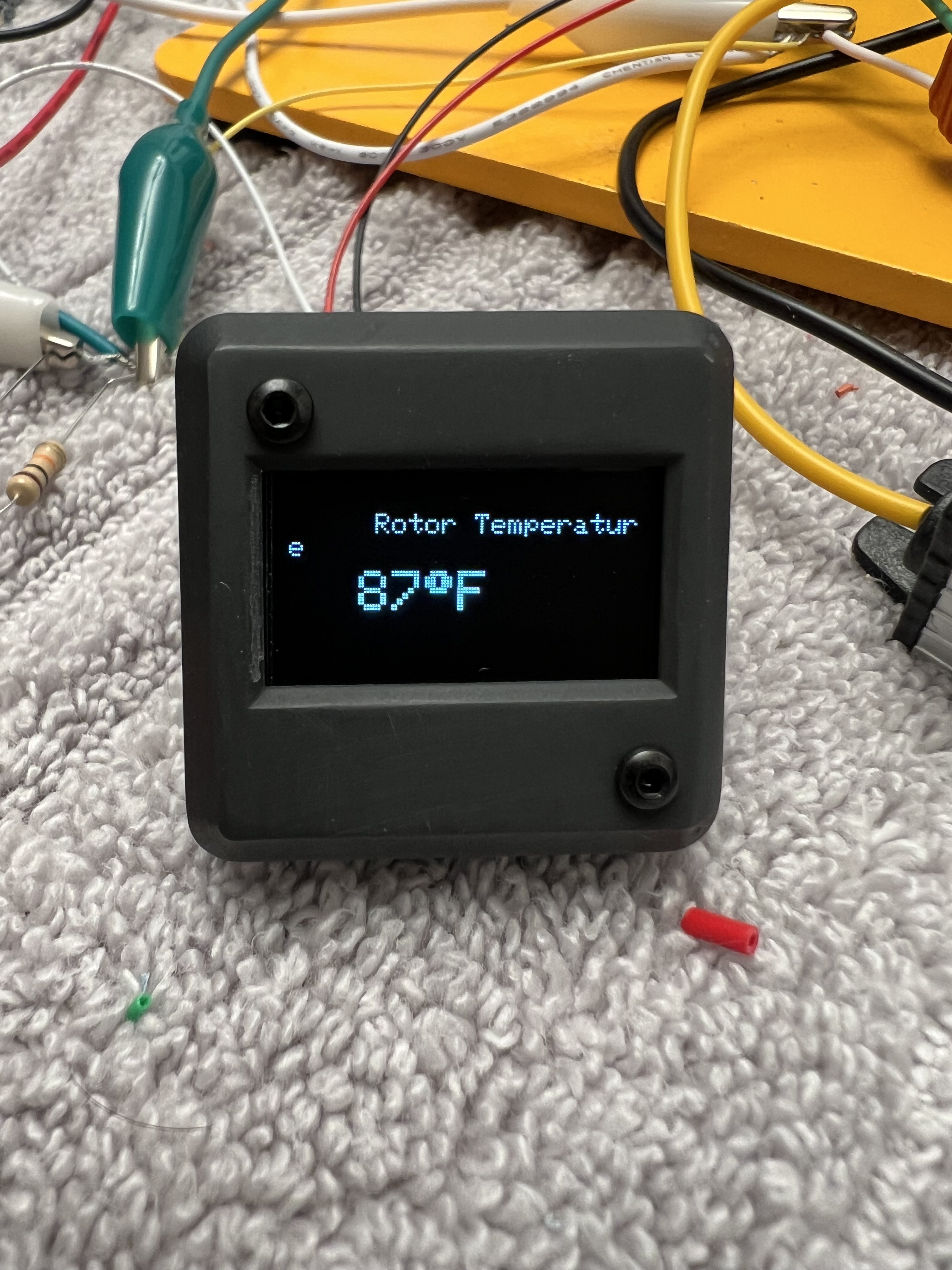

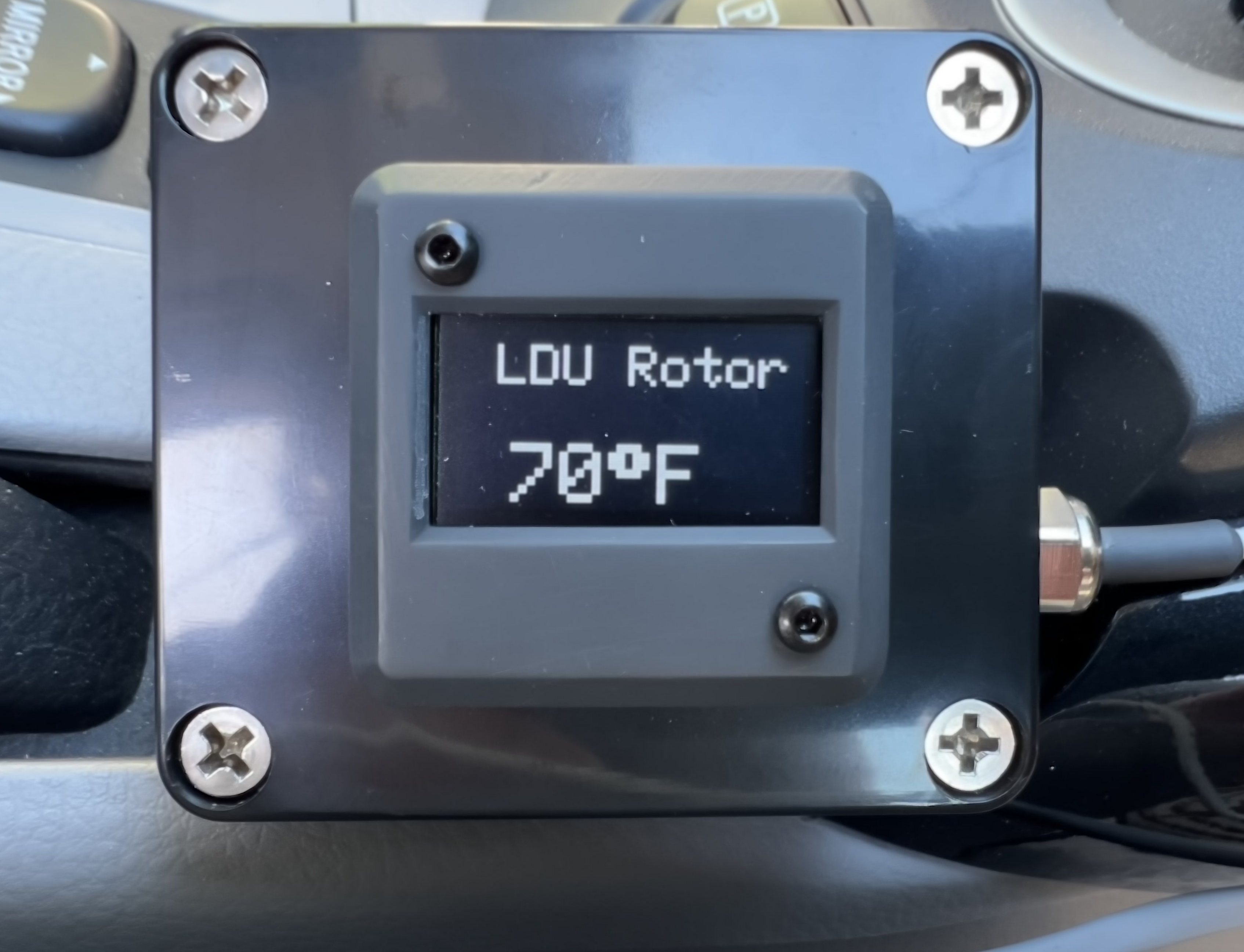

Rotor temperature sensor/display:
https://teslamotorsclub.com/tmc/posts/8230849/

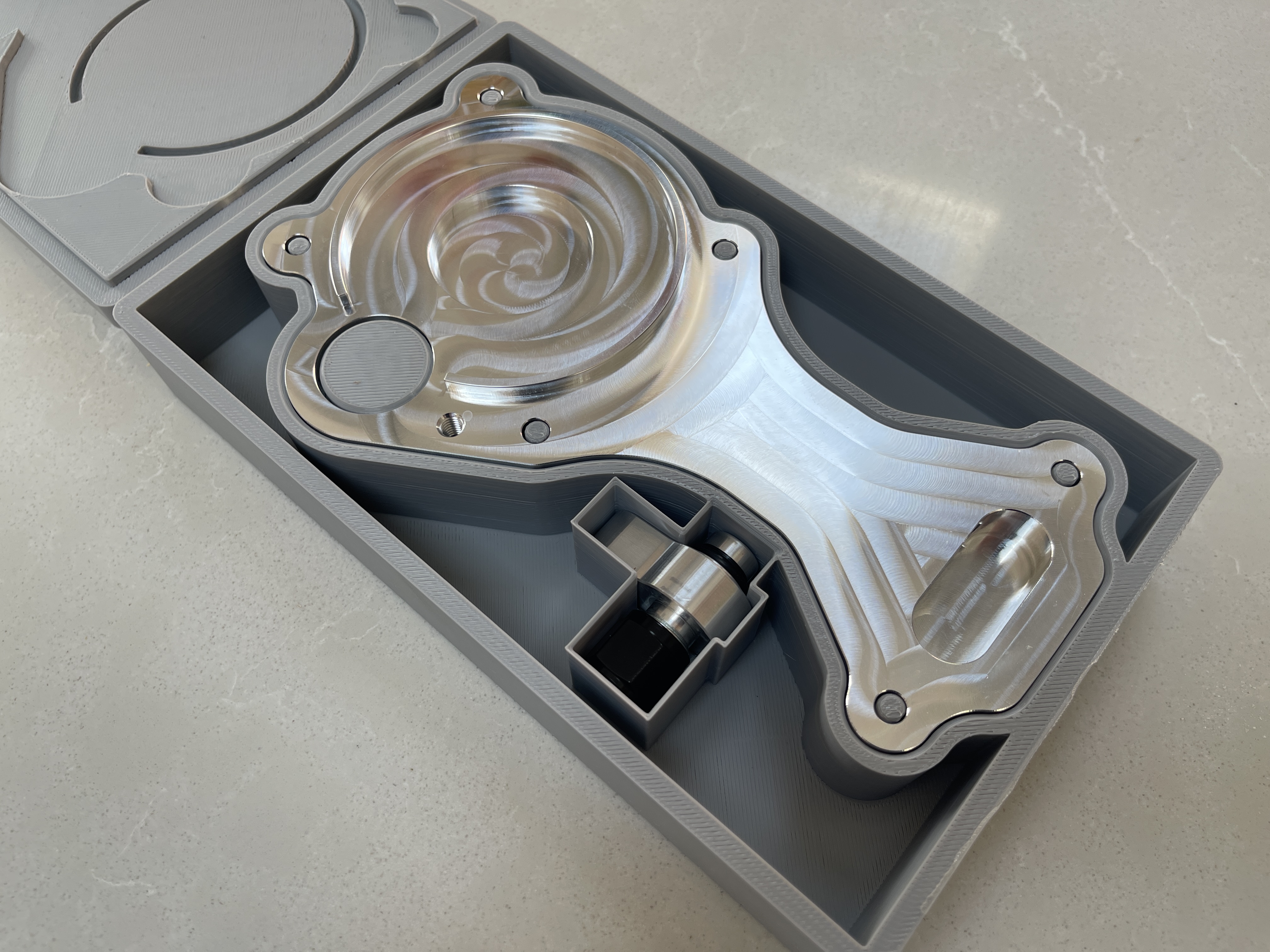

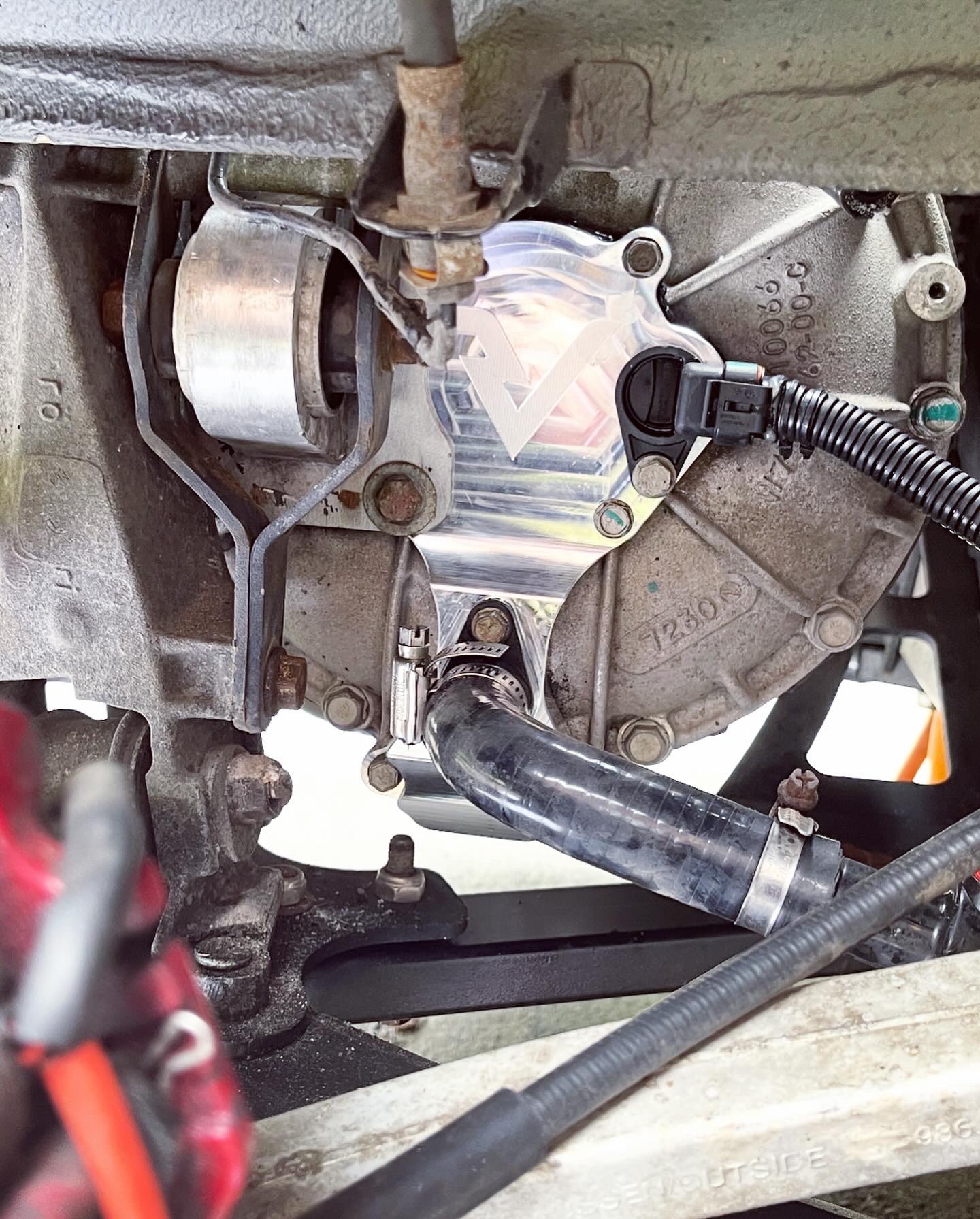

I’ve bitten the coolant delete bullet too. Just fitted this from Revolt Systems in California. My car is used as a Daily, so didn’t have the time to have off the road whilst the existing manifold was modified. Took about 2 hours to fit.
What do you use for seal material (brownish on the maifold)?
And do you have any drawing or cad file for the plug you like to share?
Or possibly if you can sell a plug?

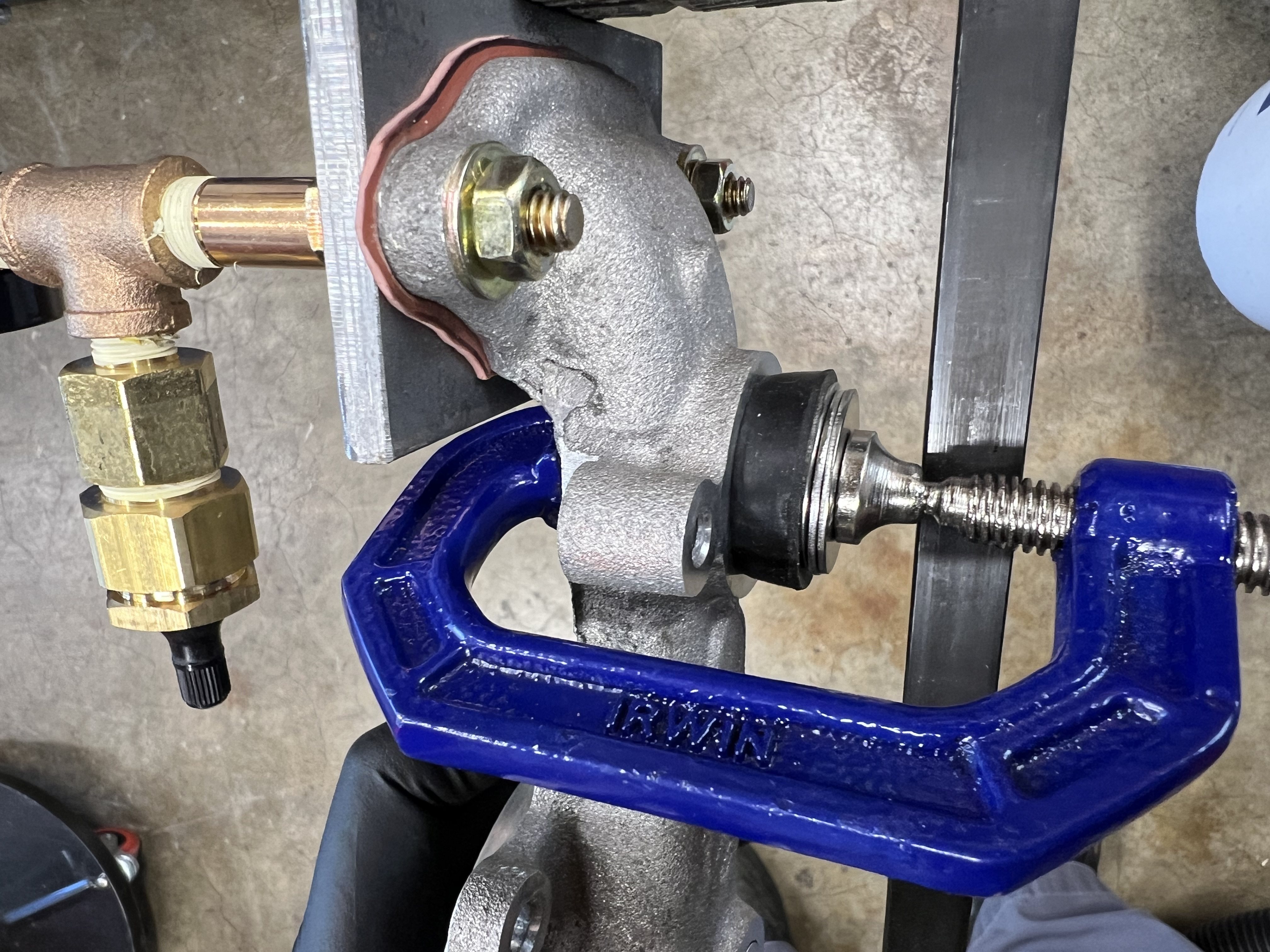

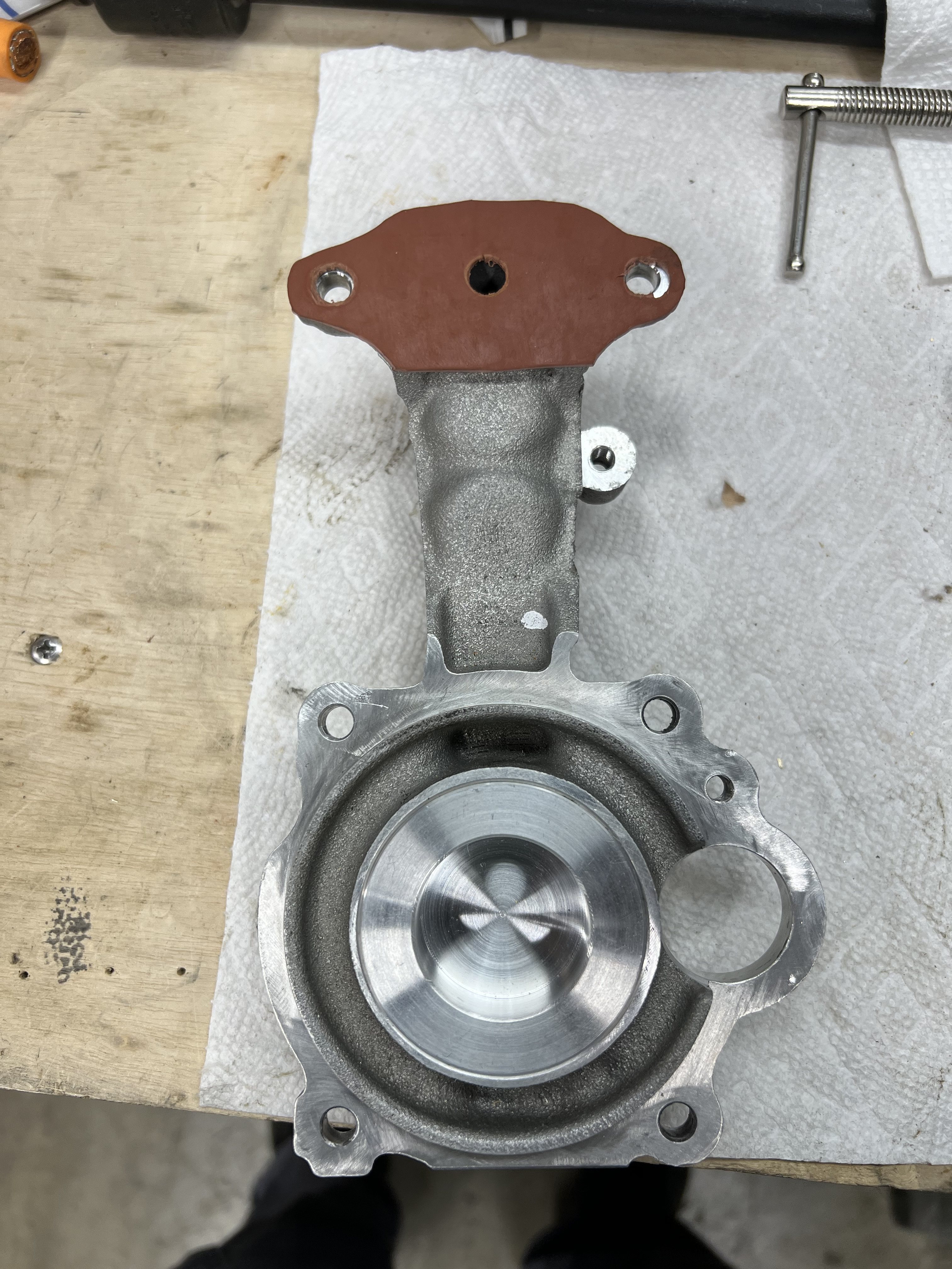

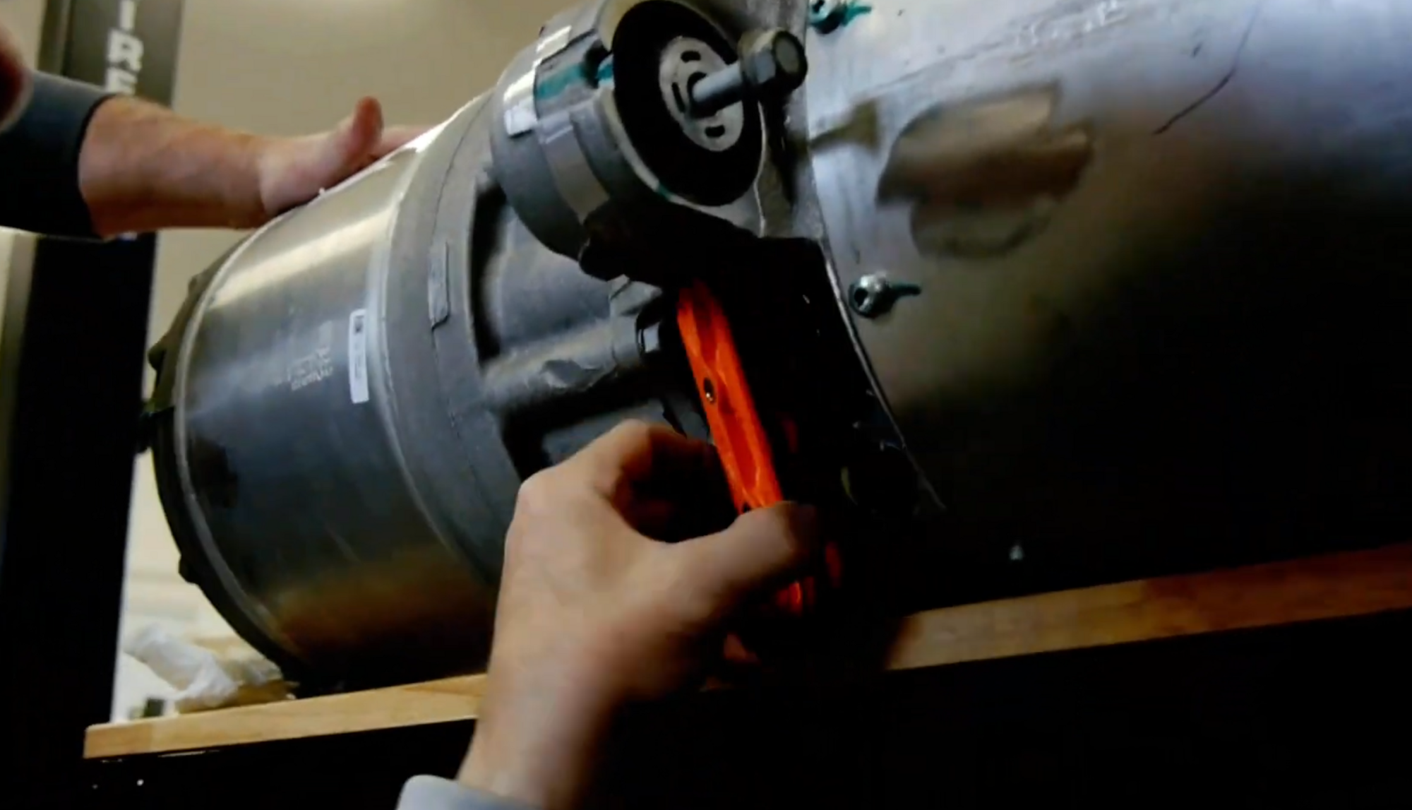

That picture is misleading; if you follow the link, it makes more sense. The red gasket you see above is for the pressure test jig I set up to provide proof positive that the plug would not leak.
The red gasket is not used for mounting to the LDU.
Follow the link, please.
Howard & Mr. Hyde have a batch of SS formed sheet metal plugs coming, that will be cheaper than machined aluminum ones like mine. If you follow that link, you'll read that my two plugs were machined locally by a fellow who doesn't want to get into production; he does only one-off prototype stuff like this.
If there was sufficient demand, I could have a run made by eMachineShop.com . If I bought around (50), I could sell them for about $30 + shipping, but I doubt there will be sufficient demand, and the SS sheet metal plugs will be cheaper; most people will probably want to go that way instead.
I prefer the machined aluminum plug, myself.

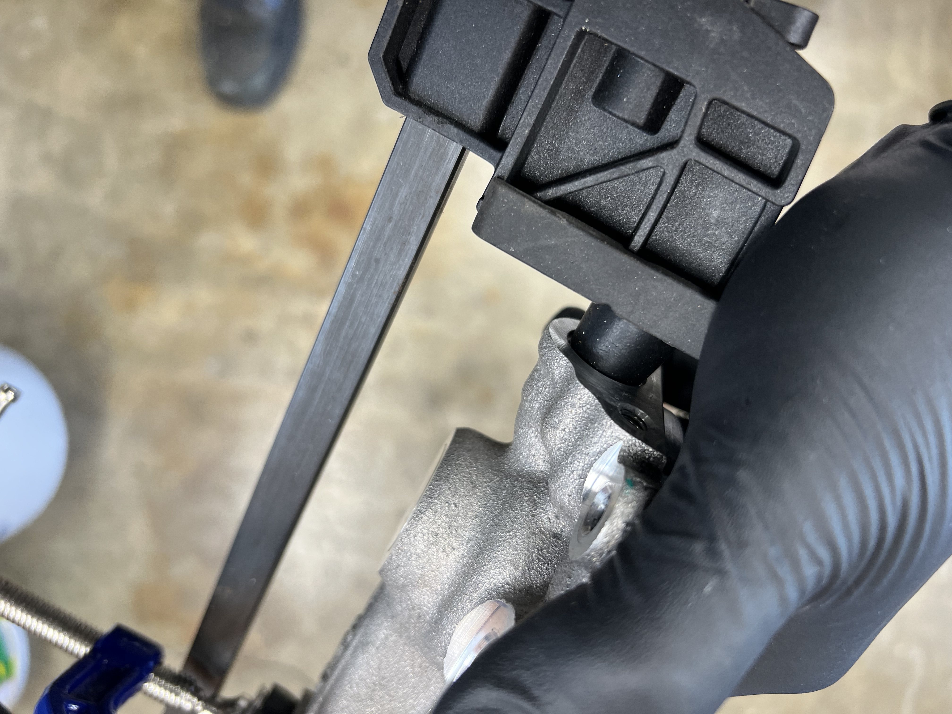

Lots of places do machining. I got one easy quote from one place, got a ballpark figure, and I'm not interested in chasing lower prices or lower minimum quantities. I'm retired and don't need the hassle of retail sales again. I already "sell" pre-assembled ethernet cables for the Tesla Powertrain Diagnostics program used in the RAV4 EV, and that's been hassle enough. Plus the inevitable people who receive something and then don't like it/claim it doesn't fit/claim it ruined their LDU/etc. Not gonna be me.
You know what? I don't care. I am active in three communities around the LDU, and I'm only going to post this info once; it took HOURS -- almost two man-days -- to put the pics and descriptions together, and if someone can't be bothered to run down the pics, I just don't care anymore. Don't want to create an account? I get that. Go do your own measurements on your own LDU and make your own mistakes.
I can't make information barrierless for everyone.
It doesn't matter if I posted on Instagram, X, TikTok, or FB, somebody would complain that "it's too hard" to find the info. I wrote an entire G'damn Wiki on the Tesla GEN1 OBC and still had complaints about this, that, and that other thing. If I put it on YT, I'd get compaints. If I offered to mail detailed specs via snail mail, I'd get complaints. Github? Complaints -- got one just last week from there.
And then there's the people on phones who complain that the pictures are too large and their phone won't render them properly. I've run a hobby website forum for DECADES and have heard it all before, and I'm done trying to accommodate every last person's issue with FREE content.
I spent $50 on Toytota online subscritions and an entire Labor Day weekend a couple of years ago, pulling service content for the RAV4 EV, collected as much as I could and put it in a ZIP file . . . and got complaints that it was "too hard to find things".
In the past, I tried to maintain info in multiple locations, and it just multiplies the work. If you miss an update on one site, you field questions/corrections well into the future, and you just can't maintain multiple data stores. It has to be one place, I chose my one place (the RAV EV is the community I'm most active in), and it'll have to do.
Yup, could be done with an o-ring seal instead of Loctite 640 . . . but I discarded that idea fairly early on a year ago. A mechanical retainer would be required, as you noted. And there's no need to ever remove the plug for any reason, so why bother with installing a failure point (o-ring)? Gluing and pressing it in is adequate and has no downsides over an o-ring seal.

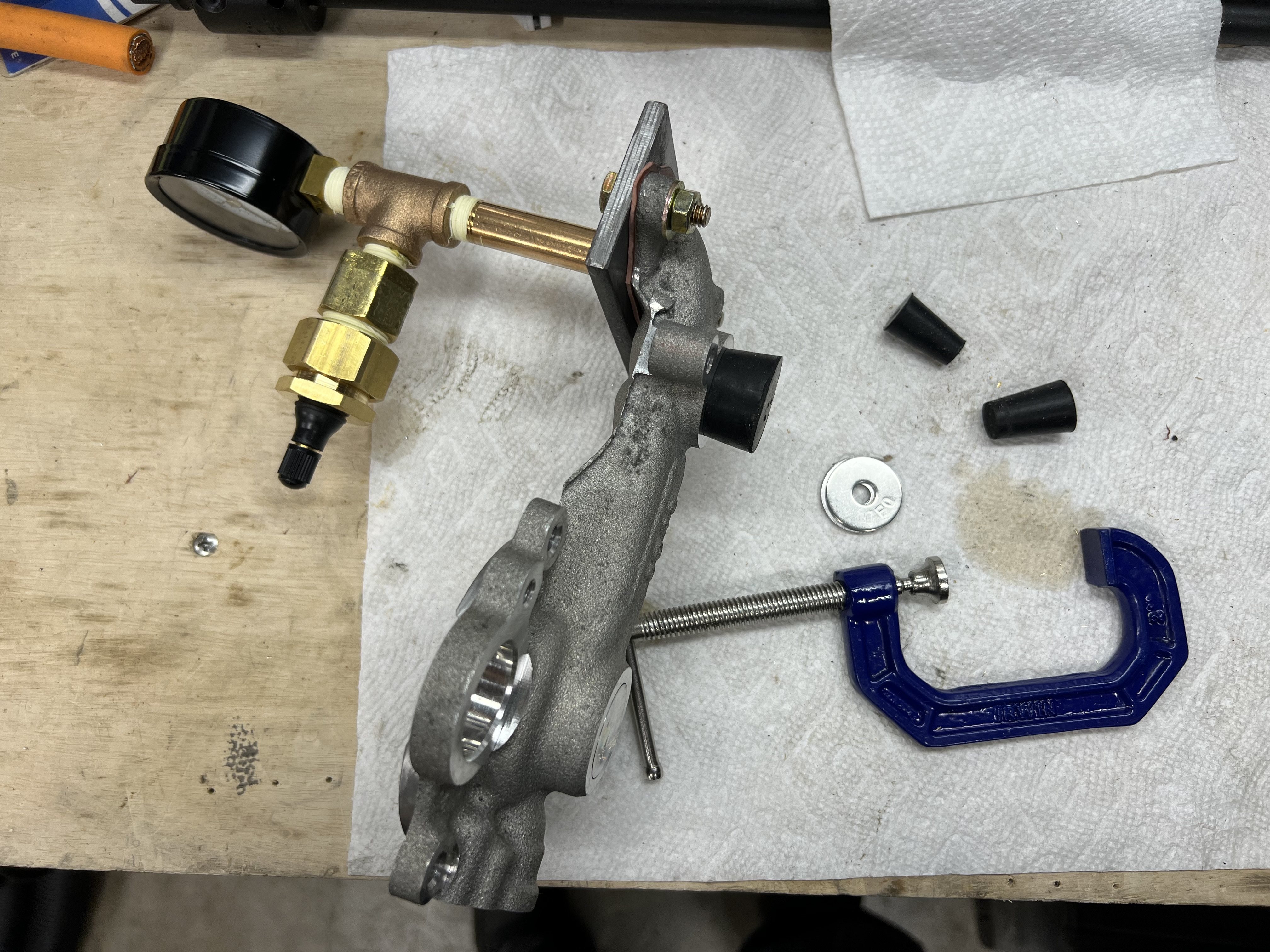

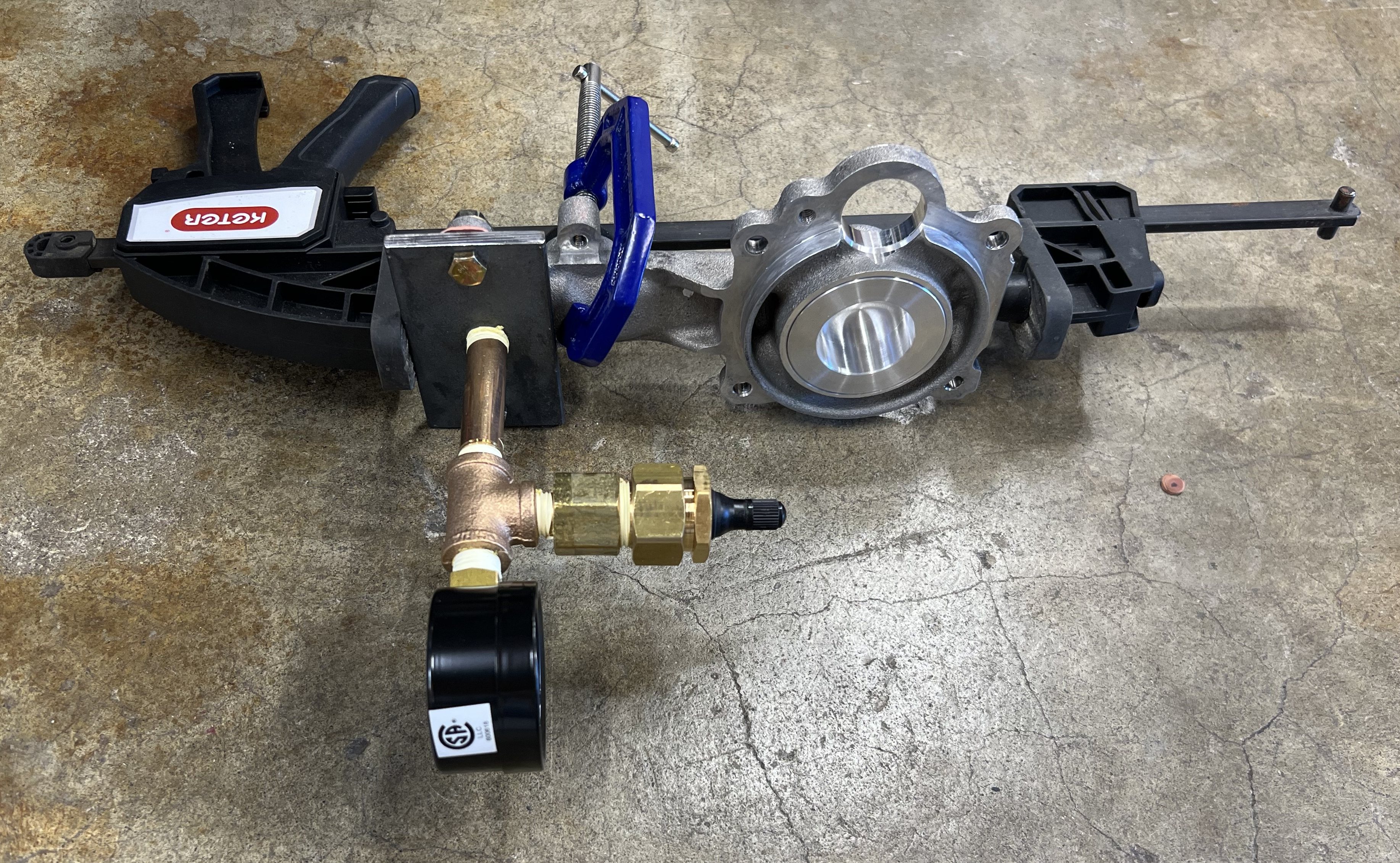

The second plug, .005" oversize + Loctite 640, passed 30 PSI for two hours with no leakage. 30 PSI pressure differential is at least ten times what that plug should ever see, so I was satisfied with the result.

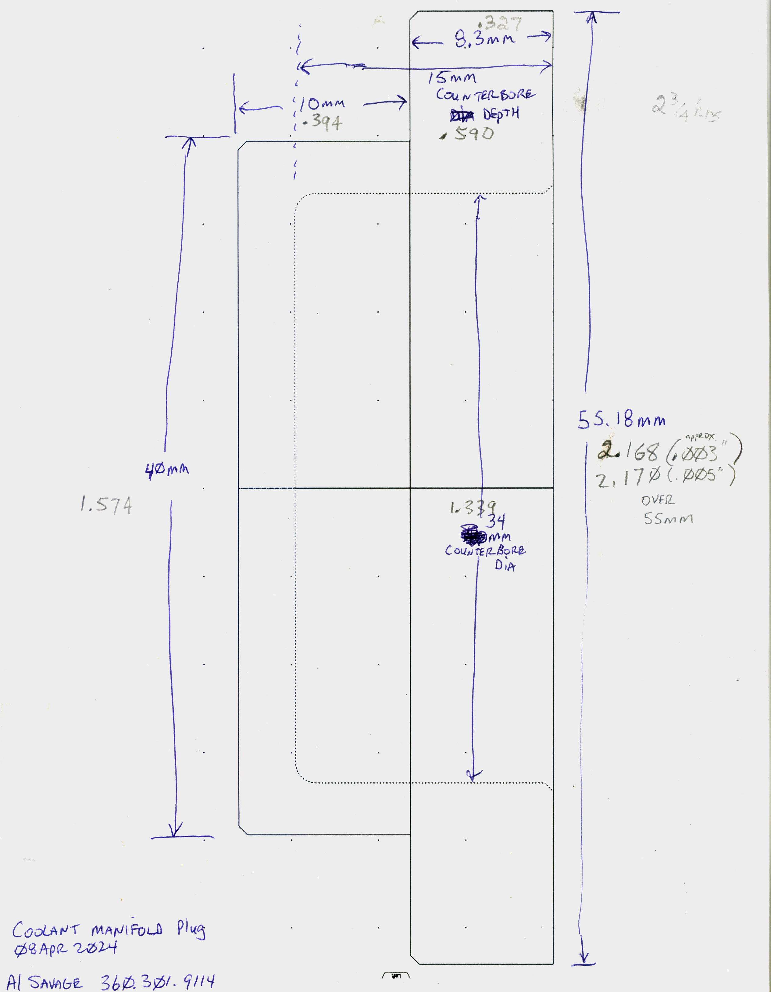

I found a drawing (yours?):
Are these the dimensions you used? (you mentioned .005 oversize which would equal 0.127mm so perhaps reduce 55.2 to ~55.1mm)
I have a contact that can help me mill and lathe so I will go and try this.
Plan to seal the cap with loctite 638 or 648.
Are there any risk of leakage on the other side (where the "tube holder" is pressed in) or does this has a tight fit from factory?

That's not mine, though roughly the right idea. Some of us batted around several sets of dimensions. You'll notice that there's no counterbore dimension on that drawing, and it's 2mm too shallow IMO. And I wouldn't normally specify outside radii such as that; from an engineering standpoint, I prefer chamfers on outside 90° edges, and radiused corners on inside ones.
This is the drawing I handed to my lathe man. mm in blue ink, inches in pencil. Scale is correct.

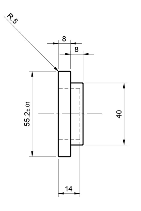

I believe that the SS formed sheet metal plugs coming are 55.2mm (.008" OS) and are designed to deform & crush into place, similar to a seal cage. I am skeptical that that much interference fit is needed/desired in a more-solid 6061 plug, so I started with .003" OS, and while that would have worked fine, I liked the fit of .005" OS better. I have a "feel" for this, but while I worked in a mechanical engineering department with real engineers, I'm not one myself, and am more of a cut-and-try man when it comes to this kind of thing.
Also, the lathe man agreed that .003" would be "enough", so I let him convince me
And, with the lightly pressurized system in the LDU, and an appropriate sleeve/bearing mounting compound, it would be.

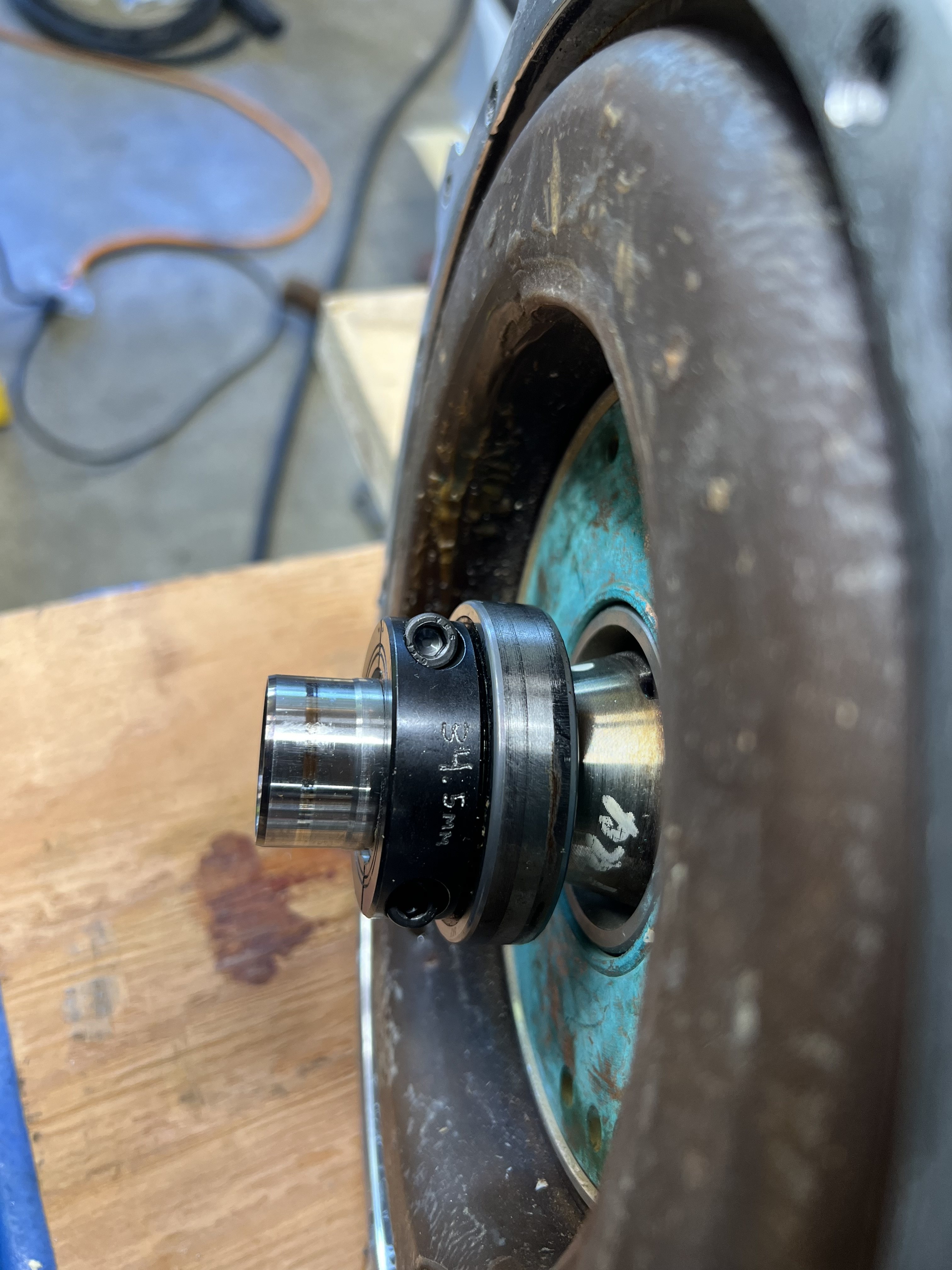

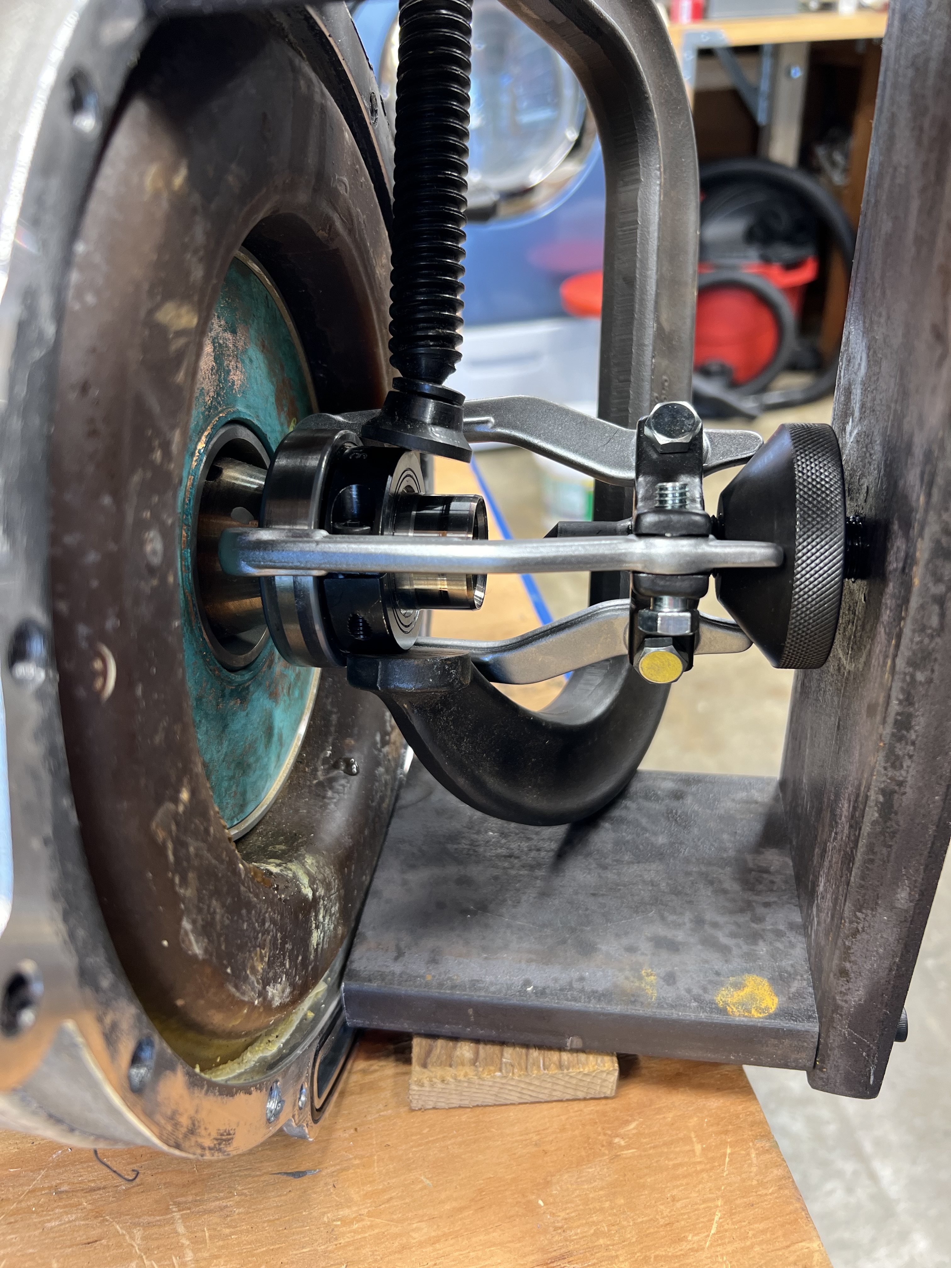

While machining a part such as this is relatively straightforward for those with the skills to draw it and with CNC, what will impress me is when somebody will start offering the various formed o-rings for the LDU. AFAIK, these are currently unobtainable, and having bespoke formed o-rings made isn't as simple as handing a drawing and a slug of metal to your local machinist . . . or is it?Boxster EV wrote: ↑Sat May 04, 2024 3:37 pm I’ve bitten the coolant delete bullet too. Just fitted this from Revolt Systems in California.
I was verrrry careful handling mine, knowing that if I damaged or lost one I'd be unable to replace it.
- Boxster EV
- Posts: 489
- Location: UK
- Has thanked: 57 times
- Been thanked: 50 times
Yes, they are seemingly unobtainium. I have a couple of spares that I managed to source from broken drive units. I also ran a very light bead of high performance RTV over contact surface to make double sure it sealed.asavage wrote: ↑Wed May 08, 2024 1:41 pm While machining a part such as this is relatively straightforward for those with the skills to draw it and with CNC, what will impress me is when somebody will start offering the various formed o-rings for the LDU. AFAIK, these are currently unobtainable, and having bespoke formed o-rings made isn't as simple as handing a drawing and a slug of metal to your local machinist . . . or is it?
I was very careful handling mine, knowing that if I damaged or lost one I'd be unable to replace it.

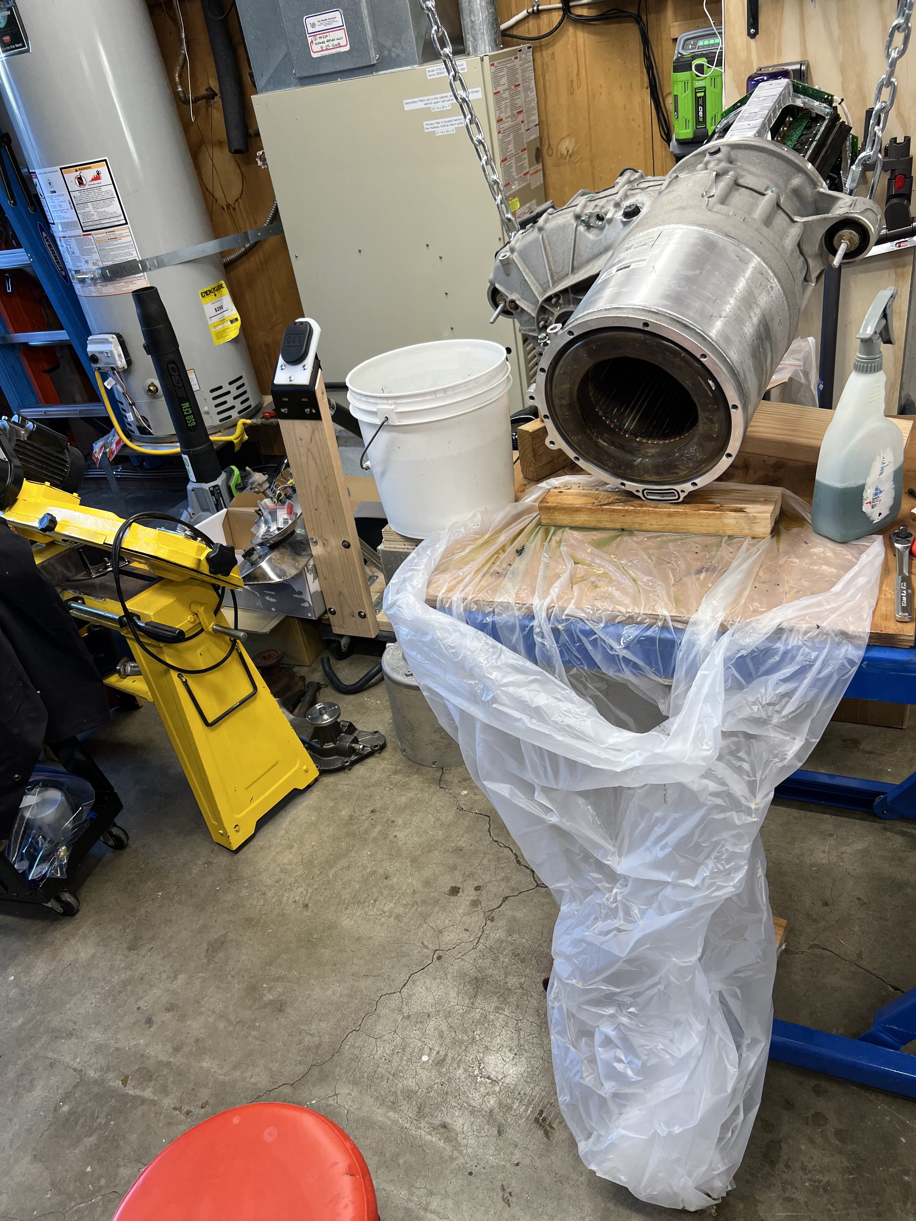

Hi there,
I've owned a 2014 P85D since 2019 that recently had coolant ingress at around 70k miles.
LDU P/N: 1025598-00-P
LDU S/N: T13E0015996R2
About a year ago, I used the Ceimin yellow triple lip seal - 30x55x8 apparently renamed to OD55 CTLBDYW-3965 and this 6007-2RZTN9/HC5C3WT SKF bearing for ~$110 each from Acorn. I also drilled an M6 size drain hole (tapped and then fitted a barb) and ran some clear tubing to drain/contain coolant. There was no coolant or residue present on the inverter side, only the rotor/stator side.
The good news: After reassembly and driving a few hundred miles over the past year (haven't driven it much due to the bad news coming up), there hasn't been any coolant leakage out of the drain hole. Good news as long as drain hole works as intended.
The bad news: The vehicle still sometimes throws external isolation alerts when it is still (gets down to about .5MOhm, otherwise stays around 1-2MOhm). I'm an ex-Tesla service technician, and the only low isolation is at the LDU, about 1MOhm instead of >4.
My main question is, how can I resolve this low isolation if the stator is epoxied? I did not remove the rotor (which I admittedly should have done). Is it likely that the rotor needs to be removed and fully cleaned?
I didn't see a way to attach images, so I uploaded to imgur.
Thanks!

Interesting that the isolation resistance is variable. Why are you certain that it's the LDU whose resistance is changing? Given the history of the Model S I would have thought that other components would be more likely to yield variable isolation (external cables, especially: a little rainwater or through the car wash with worn connector seals, and Poof! The iso goes down.).AlphaTango11 wrote: ↑Thu May 16, 2024 3:57 am The vehicle still sometimes throws external isolation alerts when it is still (gets down to about .5MOhm, otherwise stays around 1-2MOhm). I'm an ex-Tesla service technician, and the only low isolation is at the LDU, about 1MOhm instead of >4.
Are you relying upon the Tesla's diagnostics for those numbers? Or, is the variability of the LDU isolation resistance being measured by, say, a Fluke 1507 Insulation Tester or equivalent? While a DMM will spot the worst of low iso stators, it isn't designed to test the isolation resistance while under HV, and that's why Tesla specs testing using a "megger". I own a 1507. It applies 500v to the stator (or whatever I'm testing) and measures the leakage/decay time with voltage applied; a DMM doesn't do that.
(ref. Tesla's Isolation Testing document SB-10052460-6095. Not for you, but for others who will stumble across this thread later.)
Do you disconnect the LDU's HV cables and test the iso resistance of the LDU itself?

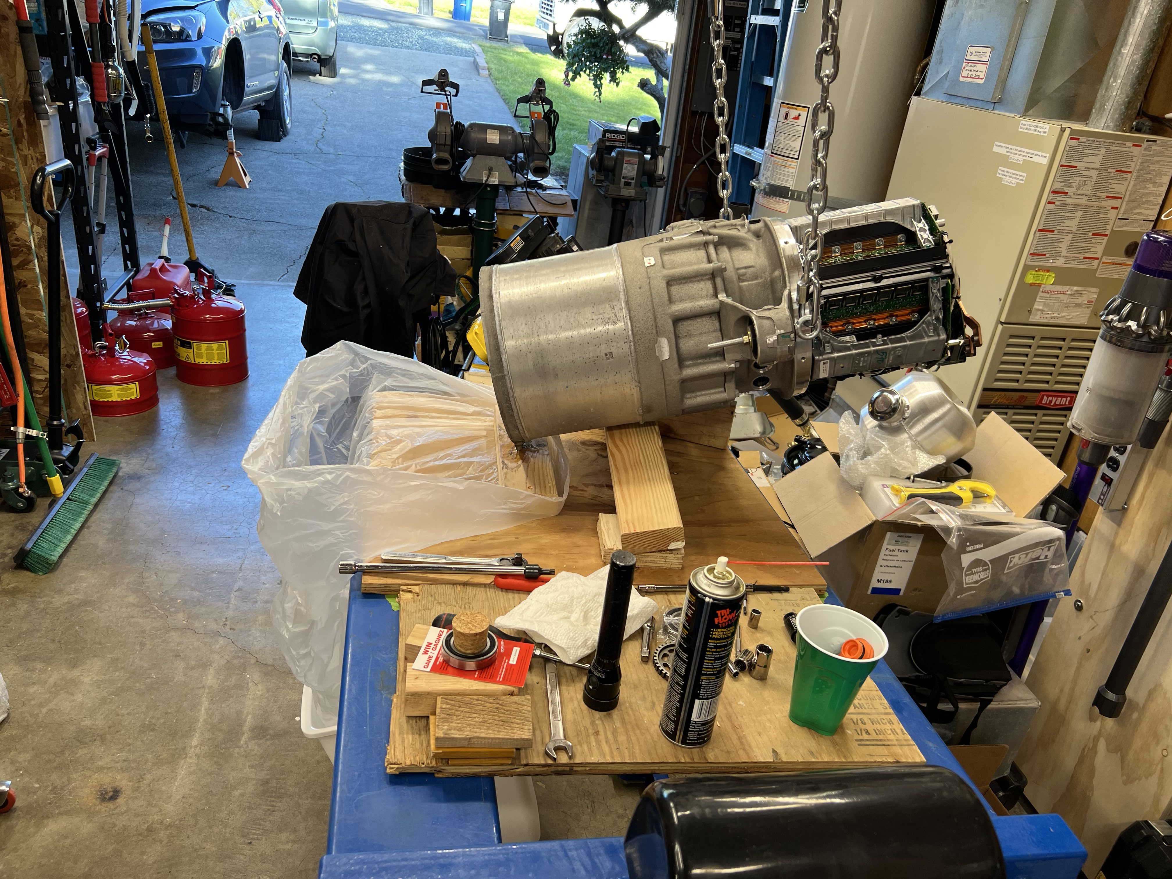

A couple of things here.how can I resolve this low isolation if the stator is epoxied? I did not remove the rotor (which I admittedly should have done). Is it likely that the rotor needs to be removed and fully cleaned?
Cleaning the rotor isn't going to change the measured isolation resistance, because there's no electrical connection (at 500v or less) to the HV portions of the LDU. I mean, we clean the rotors, of course, when we have them out, but do they need to be cleaned? No.

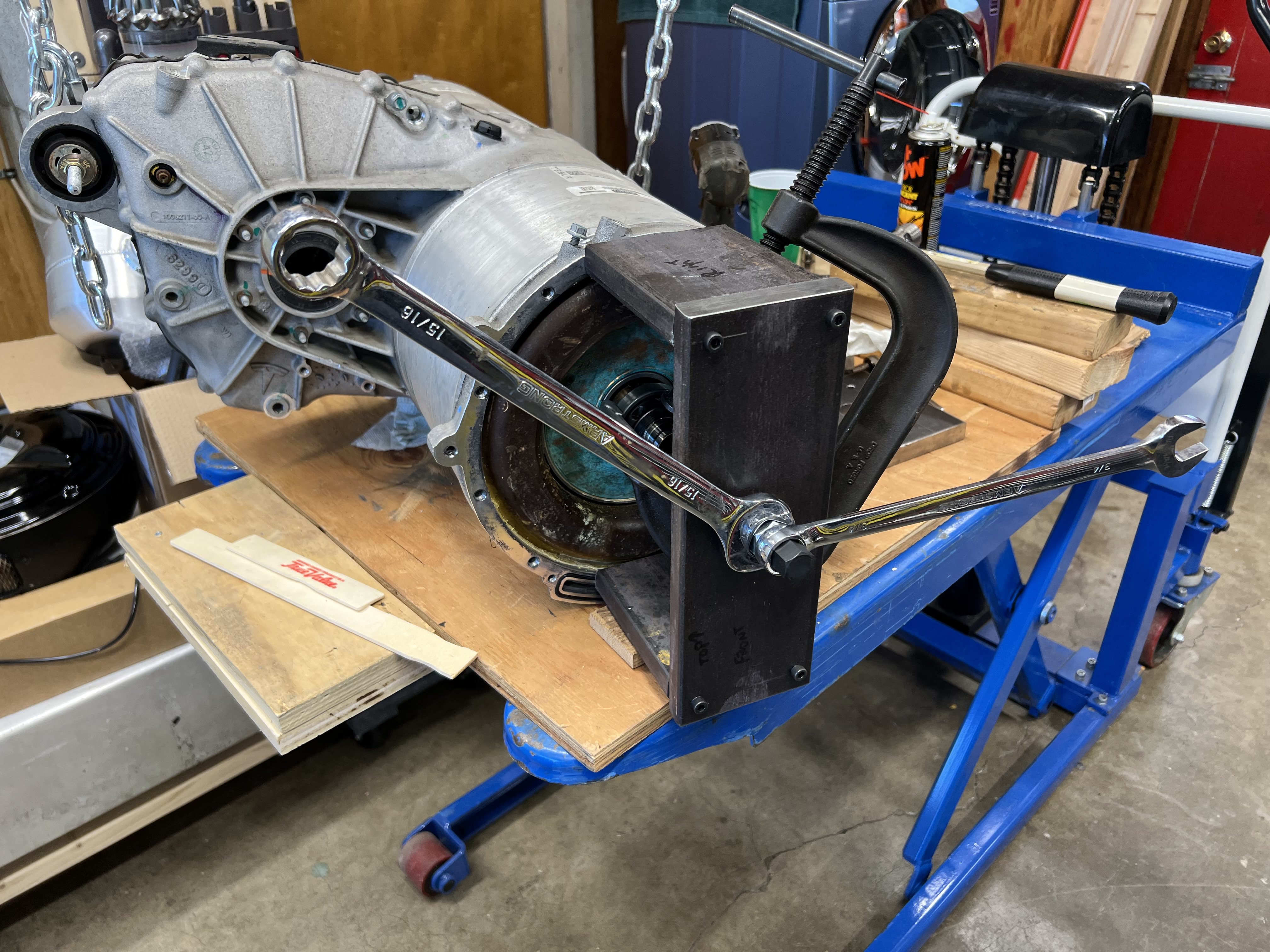

Removing the rotor wasn't a walk in the park for my recent LDU repair; I fabricated a fixture setup to allow enough pulling force to remove the rotor with the inside bearing remaining in the case.
It wasn't simple or easy, but other than replacing the inside rotor brg., it allowed me access to as much of the stator as is possible. I was able to use a water-based cleaner and surfactant to remove all the coolant and corrosion byproducts from the exposed stator laminations, "wash" the exposed surfaces, blow warm air on the stator for a day, then douse everything I could with IPA (99%! not 70%!) to further dilute any remaining water that stubbornly wouldn't evaporate.
Spraying IPA on a warm stator isn't exactly the safest of operations, and ventilation is really, really necessary. But IPA will merge with and dilute any water that can be accessed, and then it evaporates with a minimum of airflow and warmth.
Having said all that, a user reports having three unsalvageable LDUs with shorted (low iso) stators right now; not all low iso stators can be "dried out". There are shops that are removing the stator from the case and rewinding/repotting them, but I have almost no info on this myself; you can readily find more on YT, etc. but I don't think of this as an economical path in the US at this time; it's certainly less expensive to find a less-soaked/higher iso stator/gearcase, than to try to rebuild a wet stator here.
A point that others I've discussed this with seem to overlook is that any water inside the LDU, stays in the LDU upon reassembly. It won't magically evaporate and migrate outside. For purposes of imagining water in an LDU, it's sealed. Yes, it has a couple of vents (one on the ATF/gears case; one on the stator/inverter case) but aside from thermal expansion/contraction of a couple of liters of air, no air exchange occurs, so ANY moisture left in the stator cavity etc. will remain there, further corroding things and degrading the iso resistance.
You have to dry it out, to the best of your ability, before reassembly. It will not dry itself out later. I suspect that by not pulling your rotor and cleaning/drying as much as you could access, you may have been recycling old moisture in your LDU.
It's possible that, as a member with no posts, the forum software may restrict your ability to use the Attachments feature. I know from personal experience that you can't add your Location to your profile until after you have posted at least once.I didn't see a way to attach images . . .

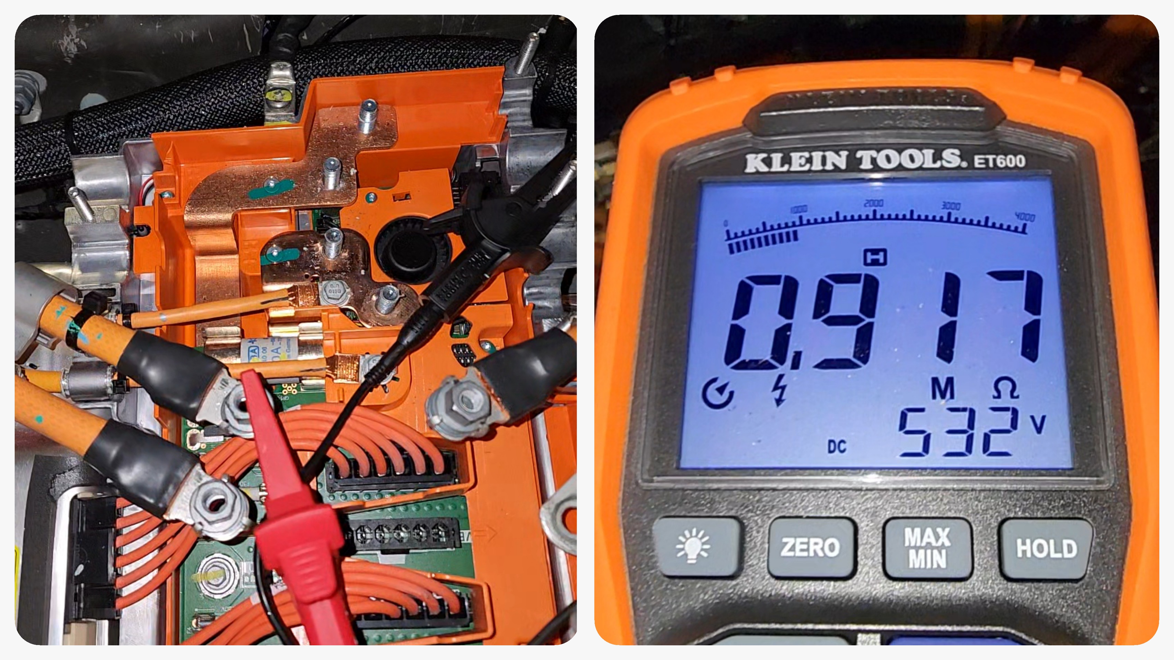

All good points. I have ruled out all other HV components through various means (primarily direct measurements using an isolation tester at the rear HVJB, but also keeping drive rails off (but contactors closed) and checking A/C compressor, PTC, coolant heater and watching isolation, which stays stable and healthy).
Of course I should have checked the drive unit directly, but by the time I had purchased a proper tester instead of using a DMM, I had already put it all back in.
Note that in these pics, the HVB was not installed in the vehicle (rapid mate had a crumbling seal, so I fixed that at the same time as the drive unit).
Right. I guess I was afraid of dried coolant on the rotor somehow coming into contact with the stator windings/laminate, but it would quickly be deposited elsewhere anyways once in motion, I guess. As techs we were told that extreme contamination can cause low isolation (of course anything can conduct at sufficiently high voltage), but obviously the rotor is never supposed to be energized anyway.asavage wrote: ↑Thu May 16, 2024 3:12 pm
At this point I suppose I need to check the stator windings resistance to ground directly (good access available at the orange center cover), remove the rotor to actually clean anything on the stator laminates, and then recheck after significant drying. No point in reinstalling the motor if the windings have unrecoverable low isolation.
I will say that the car drives fine, but I'm sure it's somehow bad for the inverter or windings (or my safety?). The performance is unaffected and the car hasn't ever refused to close the contactors for things like 12V support or vehicle entry.
All I know is that the low isolation resistance is hard to duplicate in motion, but can be duplicated occasionally when the car is stopped or nearly stopped (1-2mph) while the vehicle is in Drive.
I'm thinking that some of the bottom windings only have low isolation resistance whenever sufficiently high voltage is present to conduct across any contamination, but my assumptions may be flawed (Maybe all phases of the windings are ~0V when vehicle is stationary unless throttle is applied?)
I've also never seen low isolation alerts triggered while drive rails are off even with contactors closed, which I assume is because the windings are not energized until the drive rail is on or throttle is applied, but I don't know if that is true.
I monitor isolation while in drive through the vehicle's diagnostic reports over Ethernet (soon I will have a good CAN adapter), and the isolation measurements themselves typically have a ~30sec refresh.
You have to dry it out, to the best of your ability, before reassembly. It will not dry itself out later. I suspect that by no pulling your rotor and cleaning/drying as much as you could access, you may have been recycling old moisture in your LDU.
It is entirely possible that there is too much residual moisture, as I only air dried it for a few weeks as I waited on all of the parts and got side tracked with other projects, but it seems some stators are capable of becoming unrecoverable.
So to summarize, the vehicle is reporting constant low isolation (1MOhm) that sometimes (unsure exactly why) gets even lower and triggers alerts (250-500kOhm). I will plan on checking all phases properly and going from there.
Thanks for the informative response!
- asavage
- Posts: 385
- Has thanked: 369 times
- Been thanked: 119 times
IDK the spec on your MS (you have a GEN2 Rear HVJB and OBC, so it's Jan2014 or newer) but the GEN1 spec (during testing) is 1.8Mohm min. for the entire HV system (with the contactors open ie the HV battery not being under test) -- see pg. 6 of the Isolation doc. I linked above (again, this is for others following along). So, testing just one part and getting that low reading . . . is bad.
Thanks for showing your test methodology. This tests the HV leads to the LDU but not the stator because, as you noted, the stator is not actually in circuit when not powered by the IGBTs. That 0.9Mohm is quite troubling. I venture to guess that there's an issue with those leads to the LDU themselves, which is a failure point I've seen mentioned elsewhere sometime in the past. Corrosion at the plug-in EMC shields grounds/glands? This is good news, yes?
Yes, you can test the stator windings at the 3-phase HV wiring at the center of the gearcase, under that orange cover with the "do not disturb" iconography. For others (sorry for the poor lighting; these are found images, not mine):
My experience on mine was that testing could be accomplished without removing those bolts and isolating the stator leads from the inverter leads; almost no change in test results occurred when I tried both methods. The access to these isn't horrible on the RAV4 EV, but IDK what access is like on the MS with the LDU in the car. As yours is on the bench, this'll be easy for you.

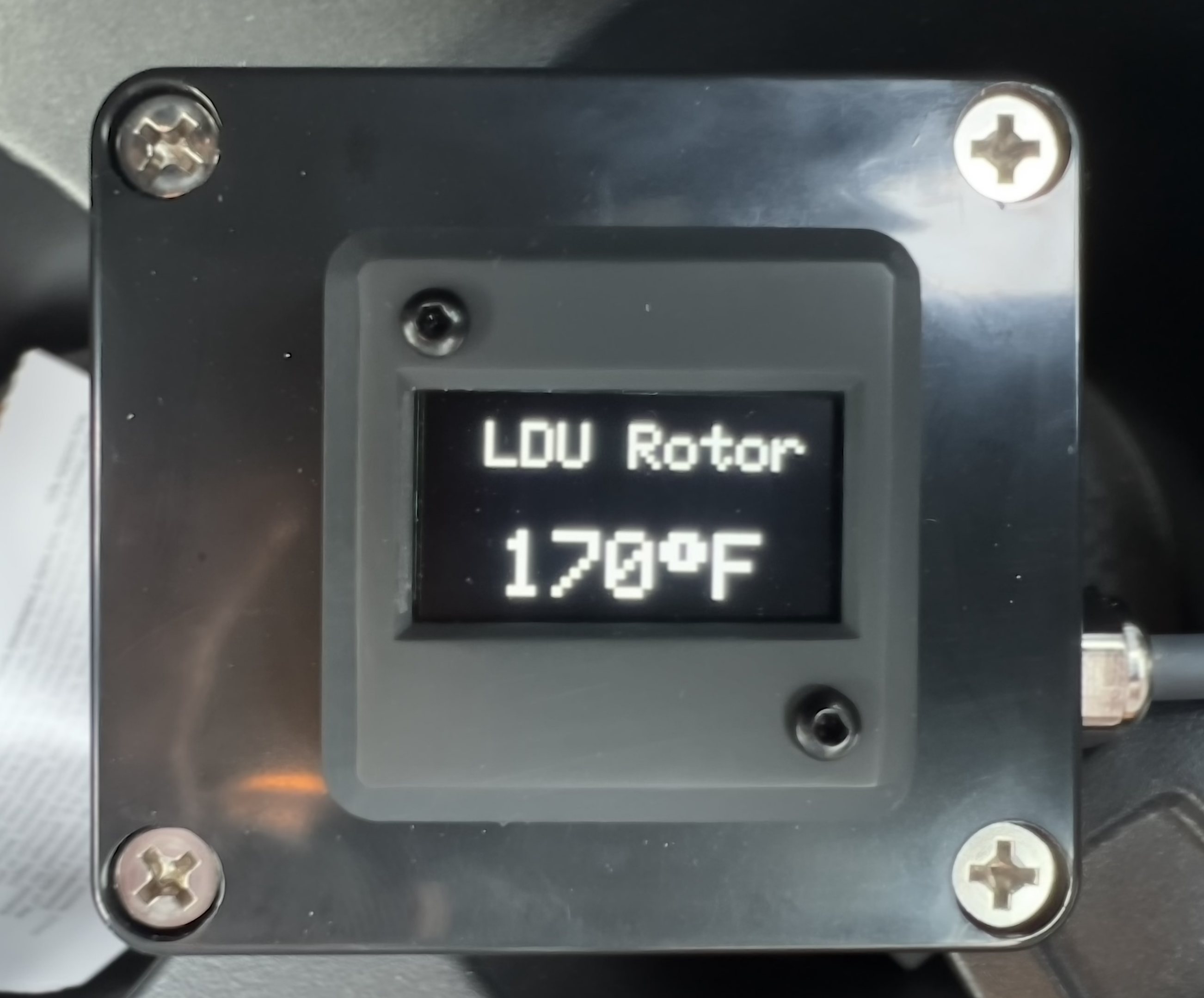

LDU Rotor Temp Monitor update
Last night, I got a first run in with the temp monitor working. It's still a lash-up, things taped down to the console, running off a power tool battery, etc., but real readings. Summary: the highest reading I saw on a 30 mi. drive was 182°F (83°C).
At rest after sitting all night:
Back home in my driveway after 30 mi.:

Have you noticed any adverse effects of not having coolant running through the rotor? I have purchase all the parts to replace my failed seal and add a drain hole, but I am leaning towards buying the REVOLT Coolant Delete product and eliminating the problem altogether. Any comments?
- asavage
- Posts: 385
I have around 400 miles on my RAV4 EV (which is not a Model S, but close) since I went dry rotor; I have seen 203°F on a 45 mile highway drive in 60°F ambient. It drives the same. So far, so good.
