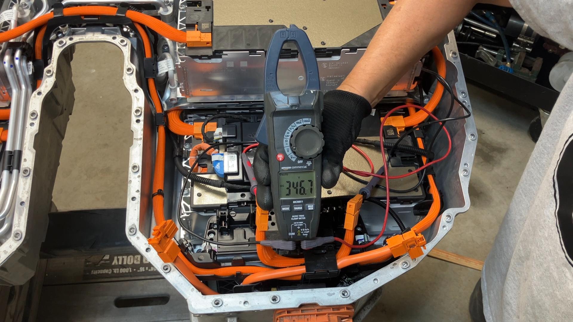

Post by Gregski »
BMW 530e 12 kWh Battery Pack Voltage Reading
also before discovering Open Inverter dot org, I started documentizing these packs on I bought a BMW 530e hybrid battery pack - Now What? [mea culpa]

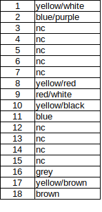

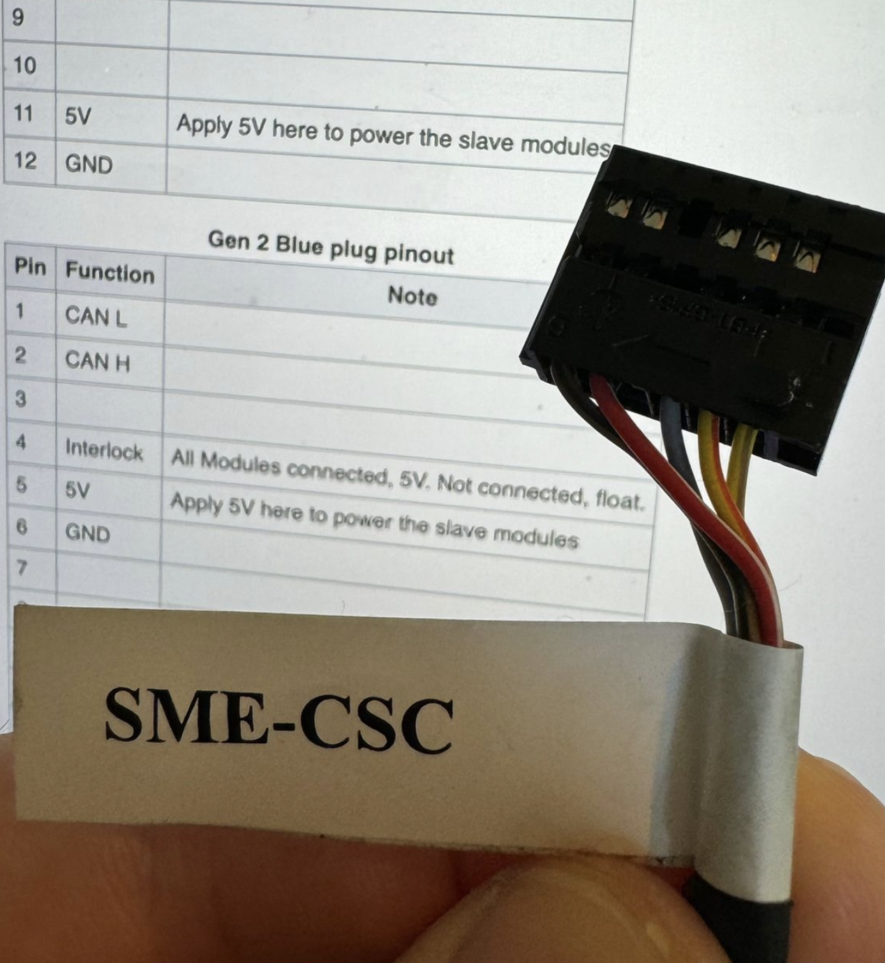

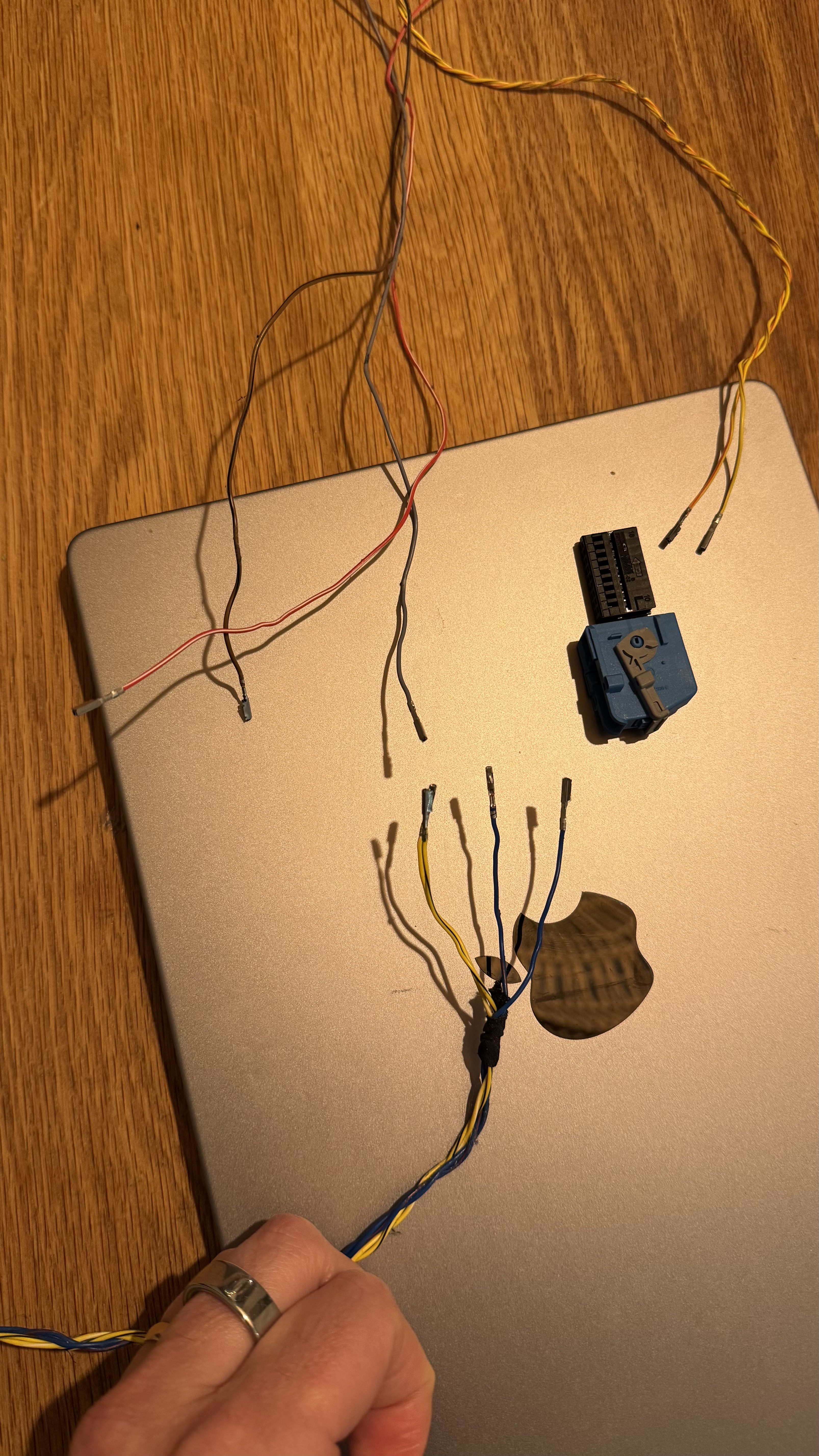

Help! As newtis.info site is gone and I couldn't find any wiring info related to BMS module wiring, could someone help me how to connect the wires into BMS Master plug. (BMS Module 0). This is X5 G05 pack with white master board and 12 modules (24kWh). In the picture, PIN1 is bottom left.
SME-CSC (ecu side) looks like this (gen2)
And here are all the wires that need to go into that blue plug.
This happened because I accidentally disassembled the wrong blue plug, I was planning to unplug wires from the ecu side plug :|

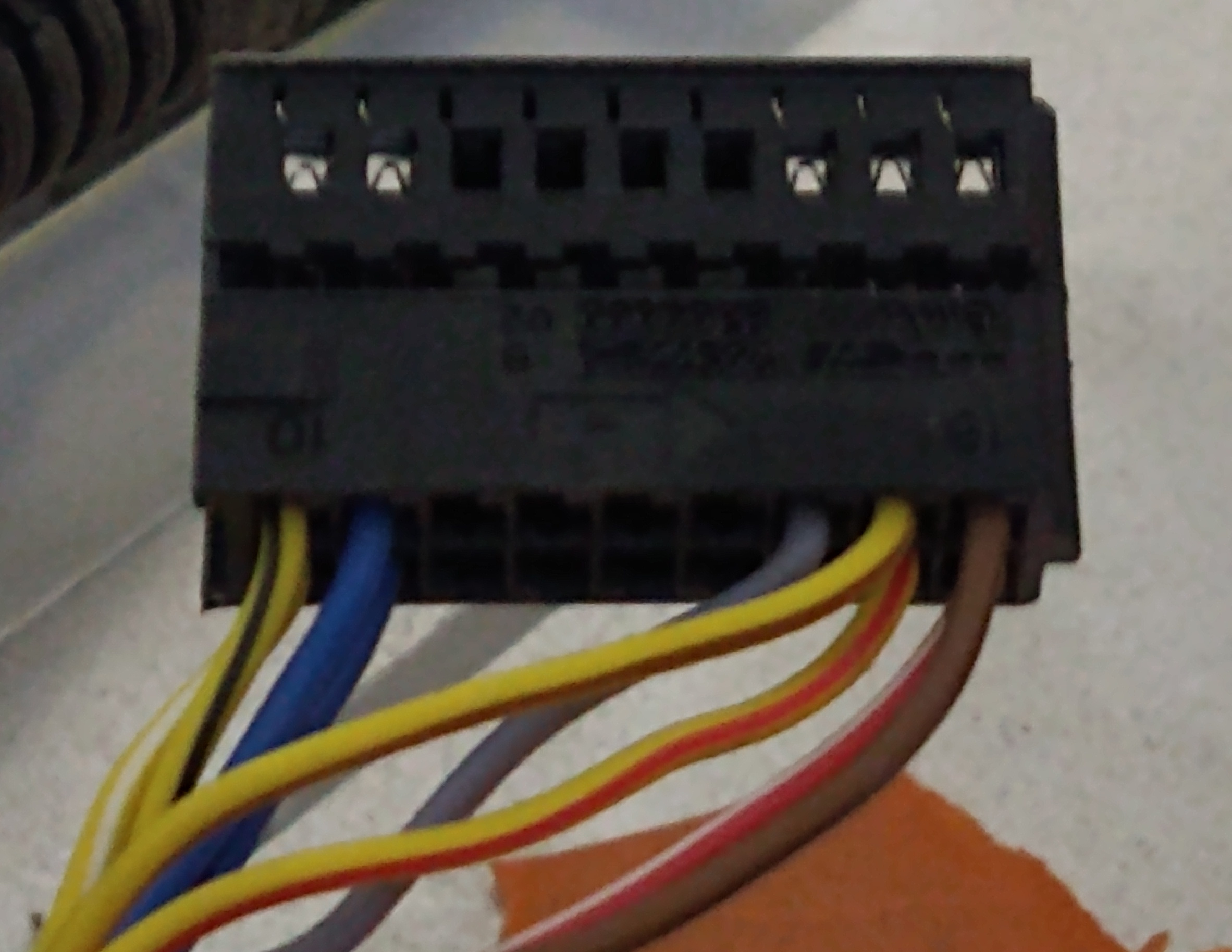

Post by royhen99 »
This is what mine looks like with the blue shroud removed.
mane2
Posts: 263
Has thanked: 50 times
Been thanked: 61 times
Post by mane2 »
Oh! Thank you so much @royhen99!
